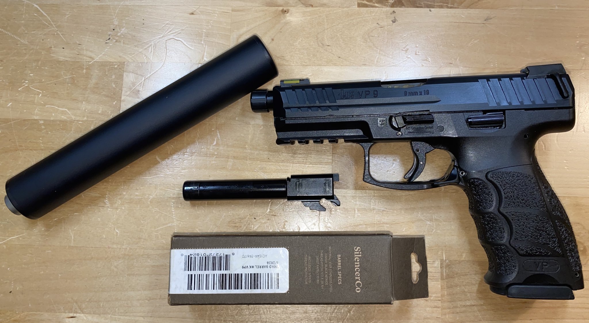

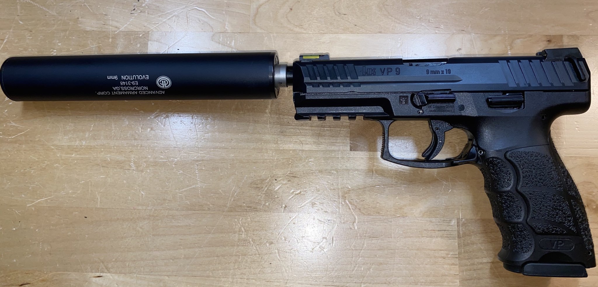

No ammunition related problems with my similar barrel setup to the OP's.
IMG_2565HK VP9 with SilencerCo Threaded Barrel ACC Suppressor 04.01.22 copy.jpg
IMG_2569HK VP9 with SilencerCo Threaded Barrel ACC Suppressor 04.01.22 copy.jpg
IMG_2574HK VP9 with SilencerCo Threaded Barrel ACC Suppressor 04.01.22 copy.jpg
Reactions: kthomas
