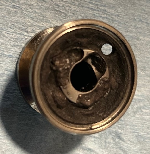

    I’ve had a 22 lr can blast baffle sitting in Hoppes for almost a week. The carbon on the back of the baffle wiped off, but the crud on the face is just laughing at it.

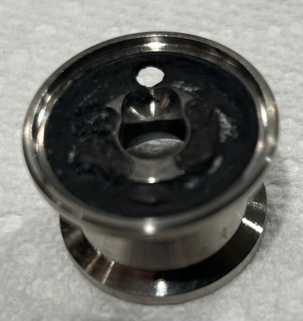

    At least one week soaking in Hoppes no 9…
    An additional 8+ hours soaking in CLR…

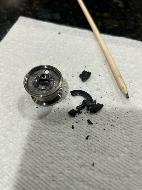

    But, a few minutes prying with a bamboo skewer…
    Ok, now soak it for about 30 minutes in CLR to get the last residual off of them. And don't go 5,000 rounds between cleanings... 😂 I clean mine between 300-500 rounds through them.
    Also, what kind of nasty-ass ammo you shooting through that thing? Damn it's crusty with some massive buildup!

    Mostly CCI SV, with a bit of Federal Auto match for flavor. It’s a rimfire can, so it’s expected to get pretty filthy… It’s back in the bath as I type this…

    I shoot CCI SV exclusively, and mine don't get remotely near that caked up in 500 rounds. I let it go between 750-1,000 once, and it still wasn't anywhere close to that bad. What brand can is that? That baffle design looks like a lead trap...

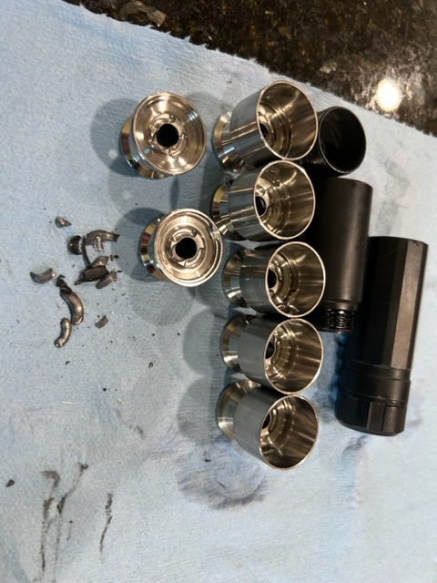

    Just a follow up on this… My son and I took this suppressor (AAC halcyon), a FN 502, pistol and 400 rounds of CCI SV ammo out for some plinking. Looks like we shot 340 rounds through this can before cleaning. I dunked the baffles into CLR for 2 days (b/c) I’m forgetful), and I picked the remnants of build up out of them today. The moral of the story is that some cans, apparently, build up fouling faster than others. And, titanium baffles don’t care about CLR…

    Pro-Tip... Before reassembling it, you can always get some aerosol welding nozzle kleen spray, and spray it on the baffles (do this outside, as it's VERY strong). Let the stuff dry on the baffles, reassemble, and then your next go around, the lead and carbon should wipe away, or just pop right off with little to no effort. Works well for me.
