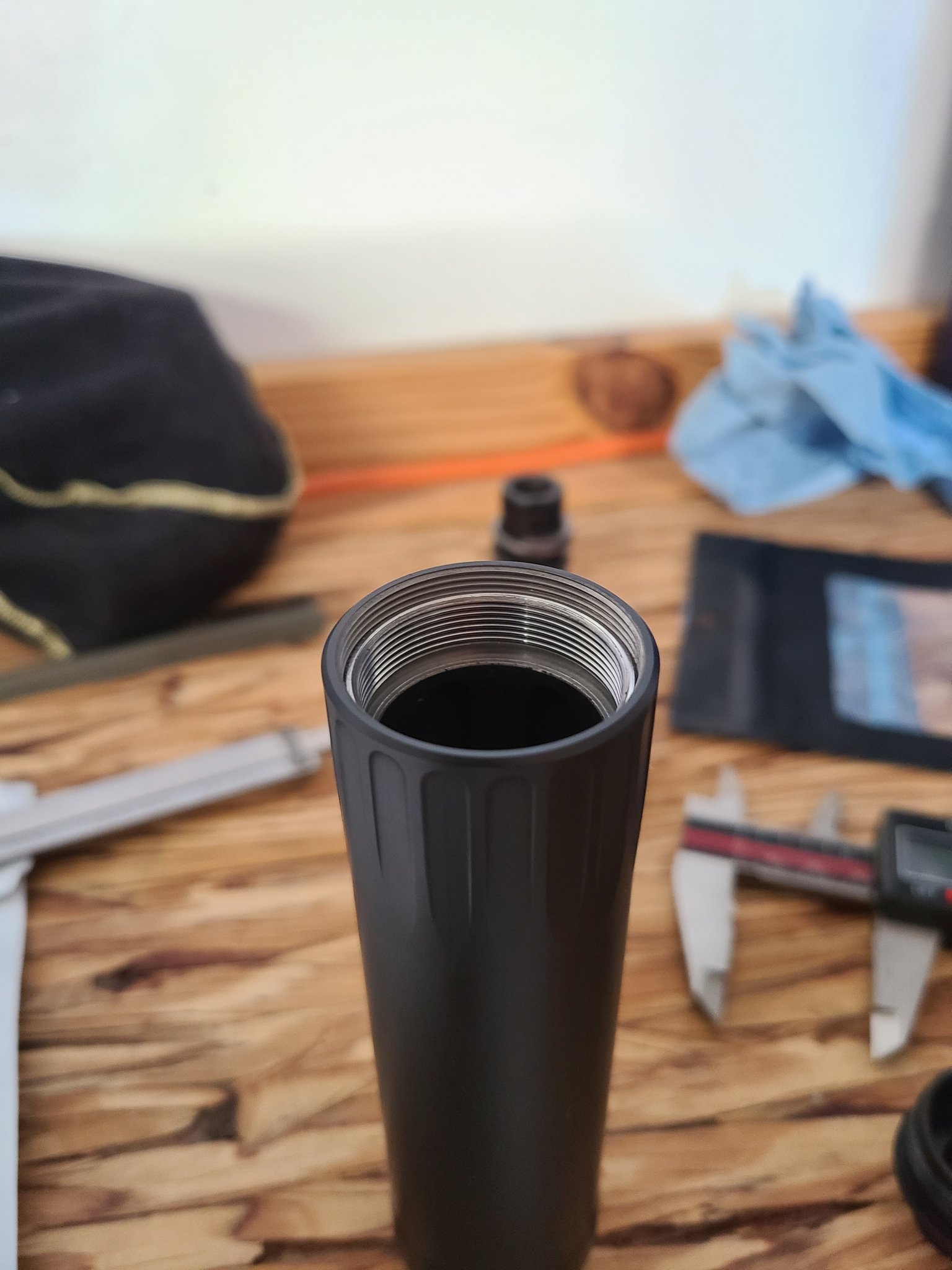

Bought a rearden atlas alpha for my OSS Rad 9. When threading it into the can I only get about 2.75 rotations before it is bottomed out and tight. Is that enough thread engagement or should I be looking for another option?

Yea it is a 1.375 diameter pistol can. I called rearden today and they said it was borderline on being enough engagement. The thread pitch is correct 1.125x28.
Rearden said they were aware of this issue with the Rad 9 and a few other suppressors and would be coming out with a mount made specifically for them soon.

Everything is in spec. The problem is the Rad 9 is made slightly different than most other 1.125x28 threaded pistol cans. The threads are slightly recessed inside the main outer tube as you can see in the picture. The oss mounts recess and fit flush under the outer tube and the rearden mount does not it interfaces on the outer tube therefore not letting it thread very far in. So nothing wrong with either just a slightly different design on the Rad9 making it not an ideal match with the Atlas Alpha. Rearden is already working on a new alpha atlas that will be made specifically to work with the Rad 9.
