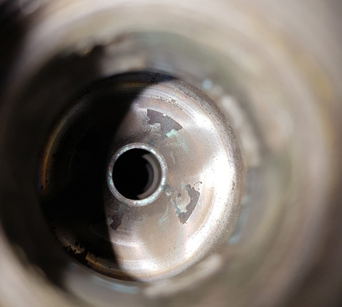

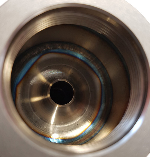

Example pictures attached of one of our SL8i-BL .300 BLK suppressors that has several hundreds of rounds through it already ( both super and sub sonic )
Note first baffle cleanliness between new and used, definitely the least accumulation we have seen starting to gather.
So far the most effective cleaning method has been ultra sonic washing, smart to perhaps starting to do it between for example 1000 – 3000 round intervals, to remove hopefully all or most of the fouling put in that round count.

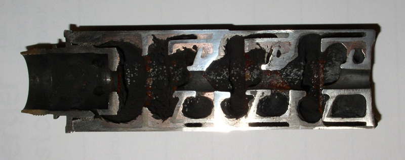

Picture attached of a cutaway suppressor from the same testing batch, with c. 13500 rounds of M193 through it.
Barrel length was 16” in this case.
Note that this particular suppressor is not dirty at all in the bullet channel edges and the customer reported still very good accuracy, but the issue was the weight increase and effect on sound/flash performance.
