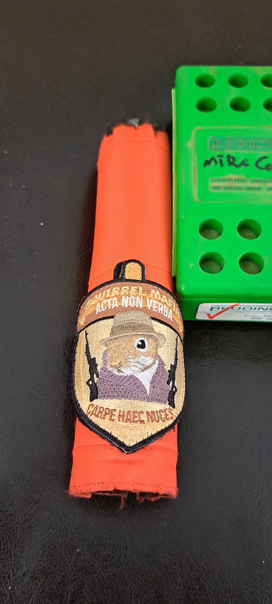

While I was trying to decide which cover to buy, Rebecca took this lure cover, changed the location of the velcro and sewed a bit of welding blanket into it.
That was three years ago...
Yep, it's been down range quite a few times, but it still works.
After her effort to build it for me. I couldn't in good conscience buy a commercially built one.

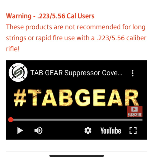

Those covers look awfully thin. And it says right on the page…
I would look to the HAD from Rifles Only if shooting longish strings of fire (like more than 10 over a couple of minutes). And even then, the cover will get HOT. It (all suppressor covers) is an insulator, and all of the heat you put into the suppressor eventually needs to get out. The truth seems to be that most suppressor covers are intended for precision applications. A 30 round mag is going to dump a ton of heat into a can, then into the cover…

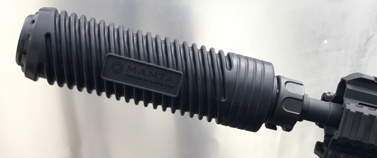

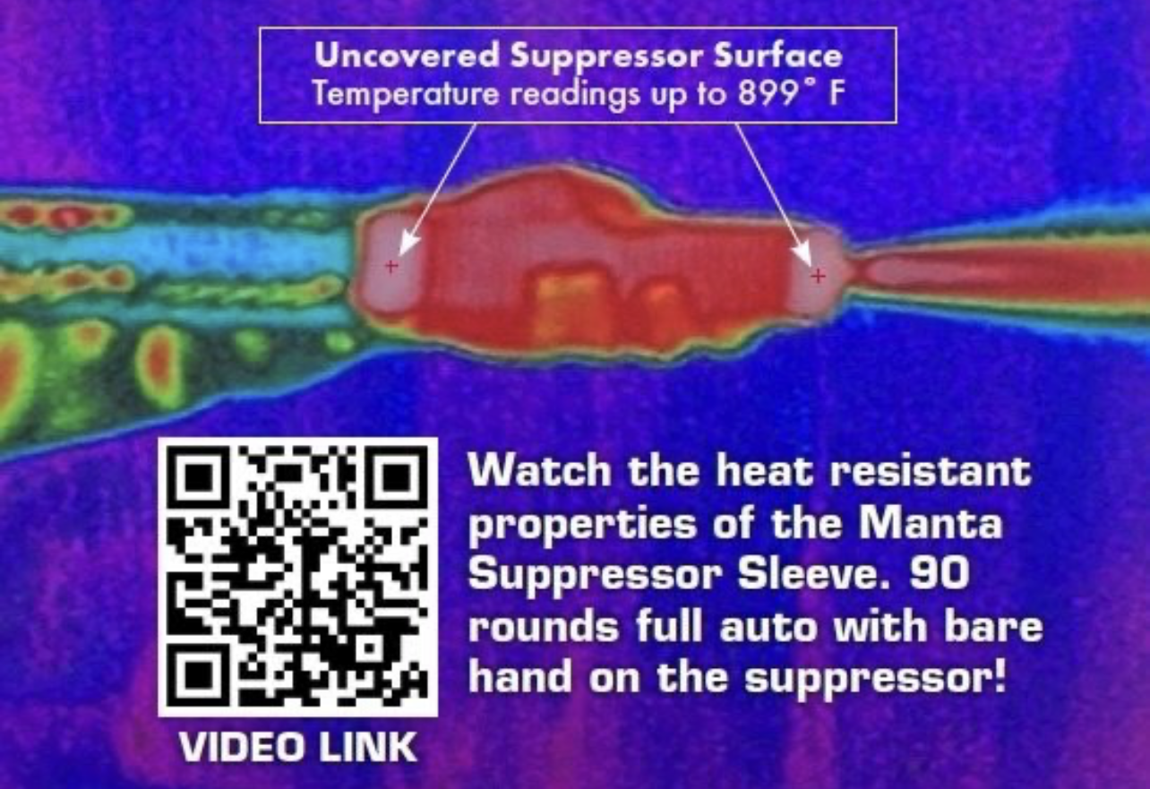

For heavy semi auto use I've been happy with Manta Defense:
It's much more secure than my Rifles Only HAD and also a much better insulator.
