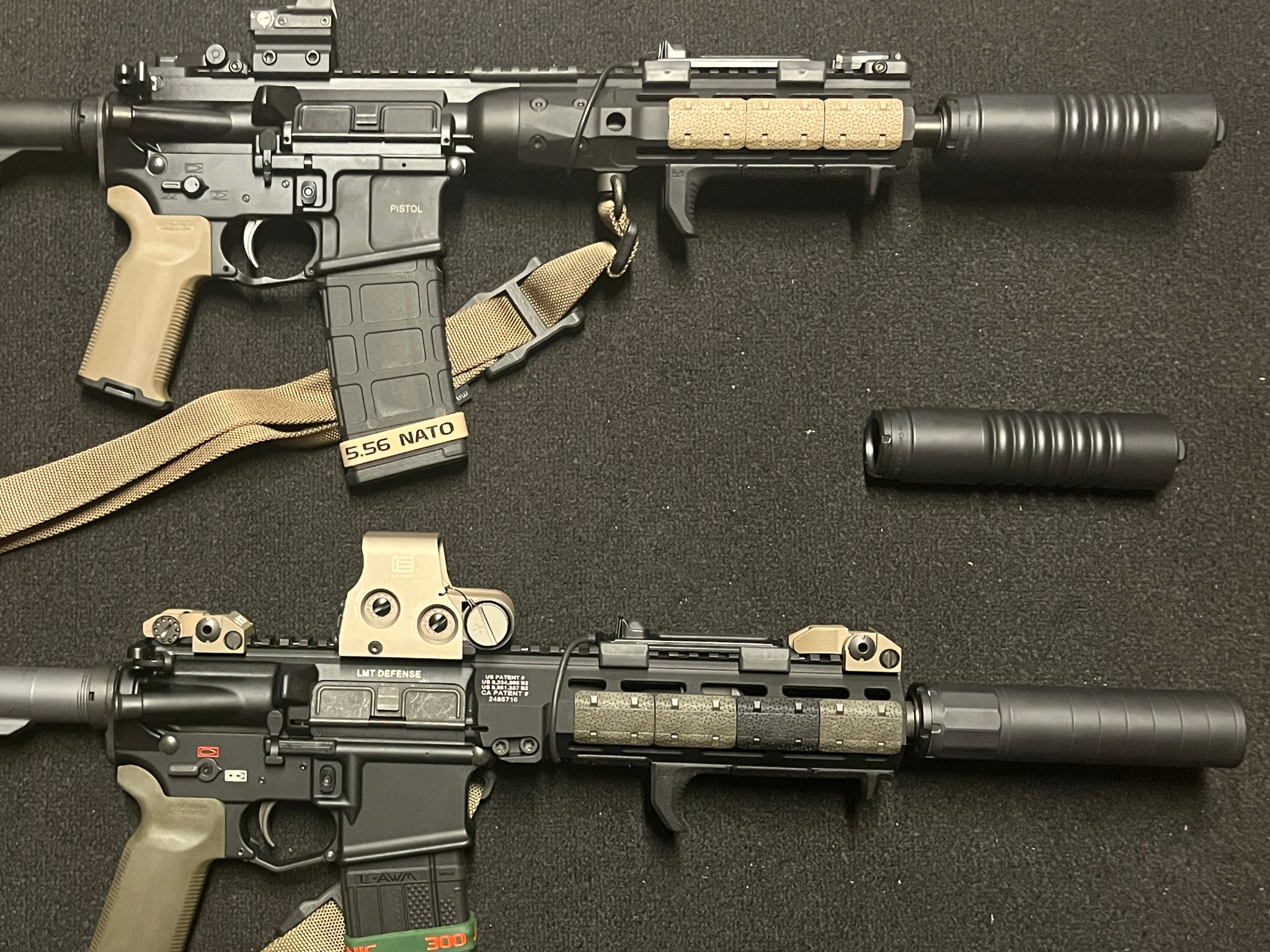

If you can get over the looks, the AB A-10 Warthog 7 is great and inexpensive. Comparing to my Griffin Armament Explorr 300 is interesting. They are nearly identical in length and weight. The AB is 1.625” diameter, GA is 1.5”.
Subjectively, the AB has better first shot sound, GA has better second round sound. After that, it’s hard to tell them apart. The GA is nearly twice the cost of the AB.
If you have specific questions or want specific pics, let me know.

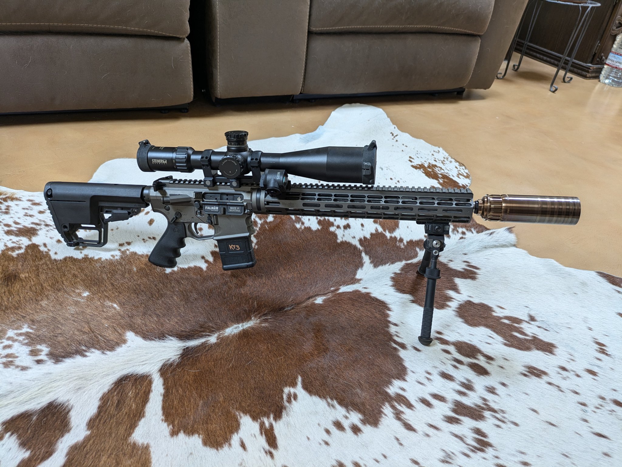

To muddy the waters even more, my Abel Co Biscuit .30 sounds exceptionally well on my AR15's.
Took it out to the range today on my SPR setup and kind've took for granted how great of a combo it is.
It's fairly low back pressure, so it doesn't produce excess gas out of the ports like conventional suppressors. About 6" with adapter. Built for hard use and precision. Stout with its all 17-4 construction. A bit over your budget though. But a great multiplatform suppressor.
