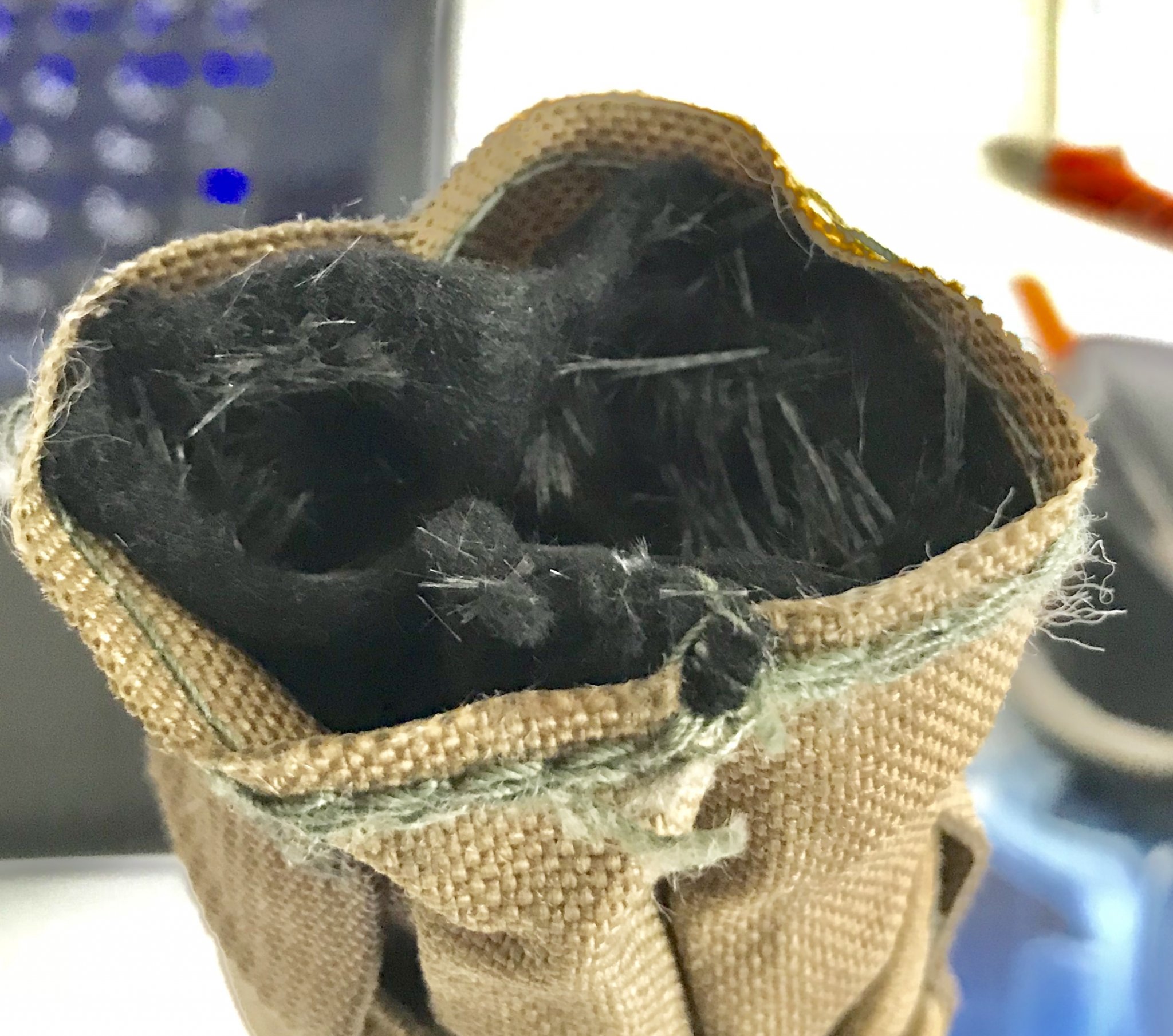

I melted my Armageddon Gear cover using an Ultra 7 on 6.5 SAUM. Was doing load development and decided to end the day with a 10 shot string that wasn't even shot that fast. Maybe a shot every 8 - 10 seconds. Melted a hole through it and destroyed the shock cord. The inside of the cover is now flaking apart. I'm probably going to look for a high heat replacement. I DON'T think that caliber / suppressor is normal use though. So for the OP, I think your decision depends on what caliber and how you plan on using it.

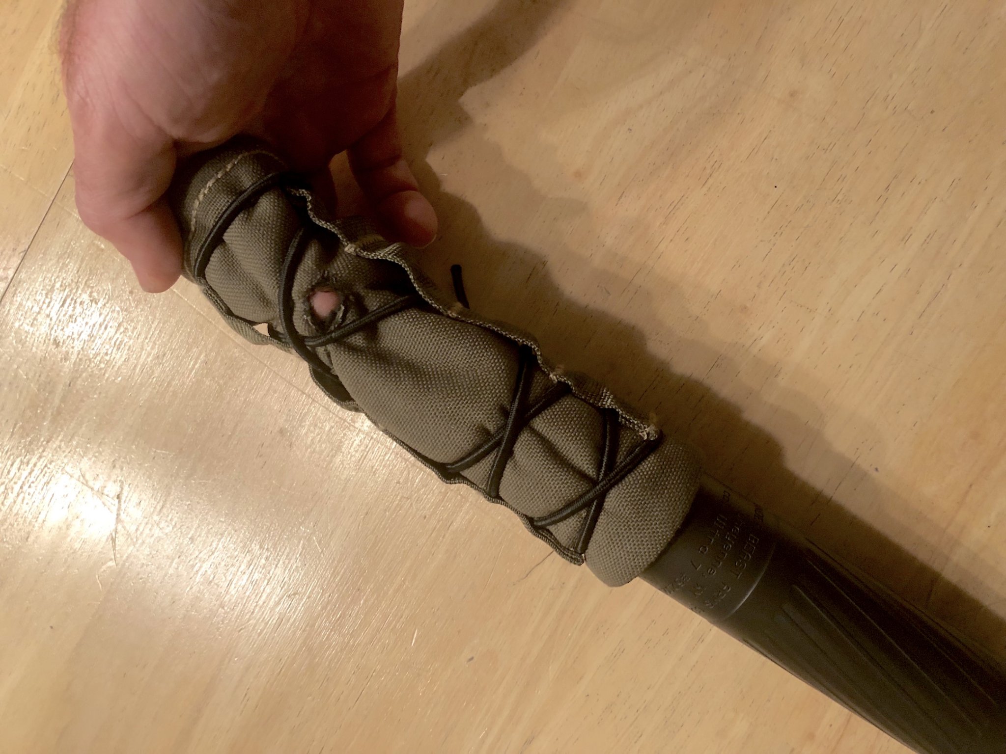

My TAB gear cover has some damage that looks like melting, and wasn’t great at stopping the mirage. I recently got a high heat cover from Black Hills Gear, and it seems far more robust. I saw no mirage from the hot can. The high heat material is grippy so it doesn’t slide around and makes it easy to remove the can from the rifle without charred skin.
I've got a sample size of one, and it didn't hold up. I replaced the shock cord and glued the hole closed, but will still have to replace it soon.
