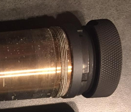

FWIW I've had my Ultra 7 for 6 years now and it easily has 20K rounds on it from a combo of bolt guns and gas guns everything from 223 to 300WM and it's never been cleaned or needed to be cleaned. I've cleaned the threads and mating surfaces of the can and mounts every so often and thats it.

I was worried about my omegas cerakote finish my first time cleaning it but then I realized it has an outside sleeve that you can screw off and then the entire core can be dunked in whatever. I have a tall whiskey glass from some ski resort and the omega core its in it perfectly, fill it up with clr and you can watch it boil up and around and then once the reaction dies down see how much is getting deposited in the glass, its pretty cool.
which omega model? I just took a look and can’t tell if the outer part of any model is a sleeve.
So it's not meant to come off per say. Omegas and hybrids outter sleeves are epoxied on.....
With that said I have clr bathed with a ultrasonic the shit out of mine and cerakote looks fine
Reactions: kthomas
The normal 30cal one. You take the end cap, which is into the sandwiching the serialized sleeve onto the core, off and then the sleeve will unscrew off the front, the sleeves attachment threads to the core are at the back of the can where the spanner wrench goes. Strap wrench/ I use wood blocks in a vice, and then Ill just put the spanner on and smack it with some small fast taps with a hammer and itll break free and unscrew freely.
Ive found I dont need any thread goop or epoxy to reassemble, proper torque holds it together fine.
It still breaks free pretty easy and screws right off the core.
I'm not saying it doesn't but it's not meant to come off easy.... allegedly....per silencerco.
