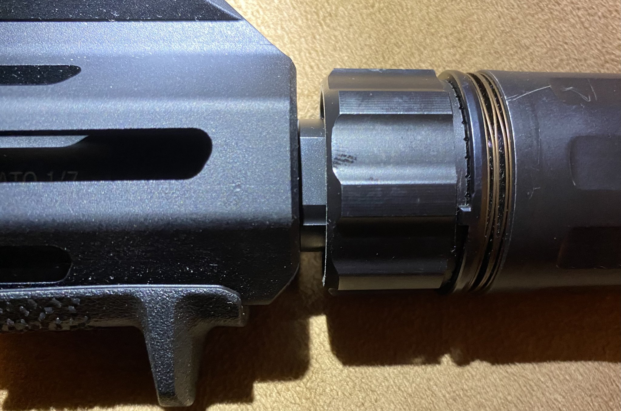

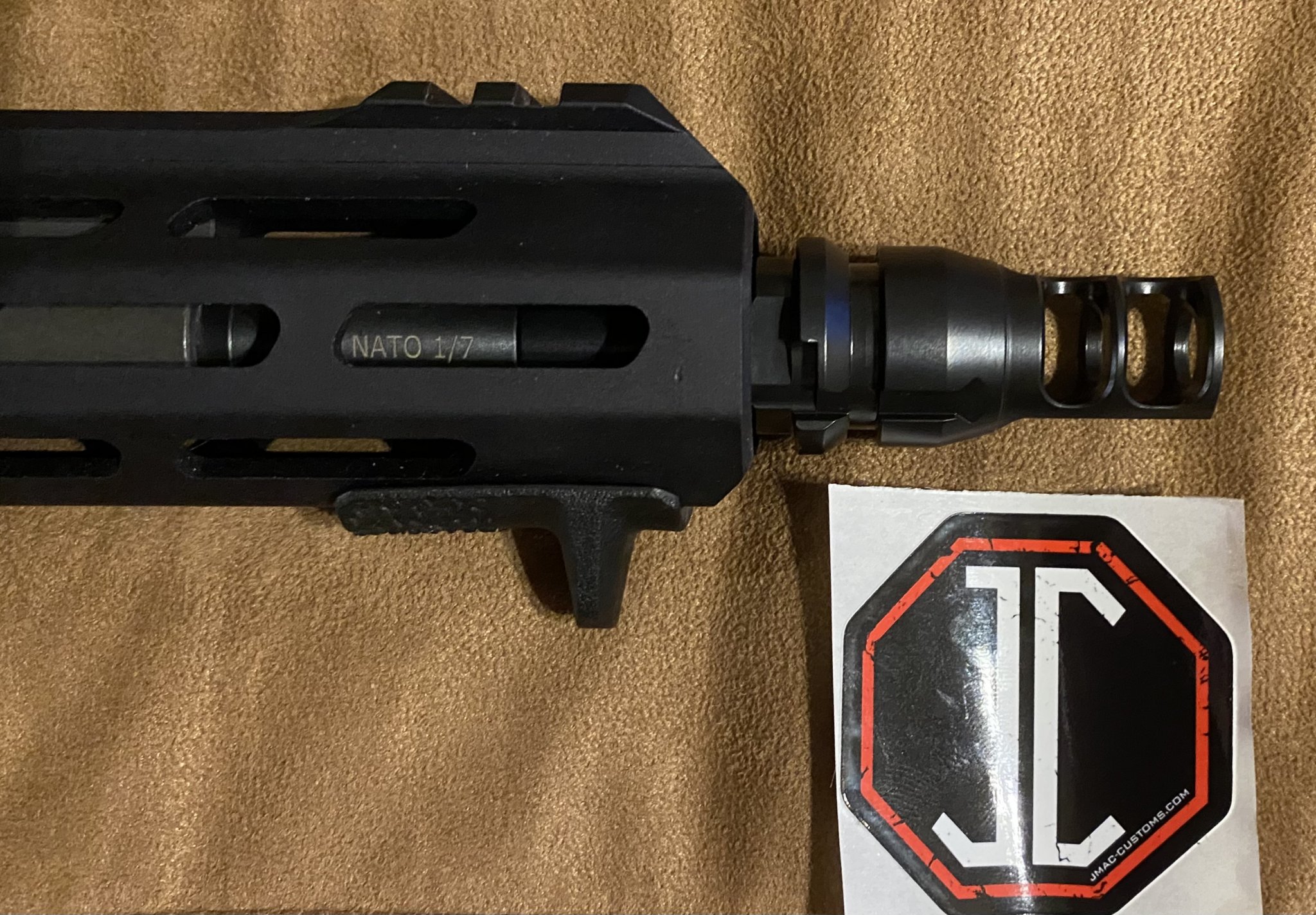

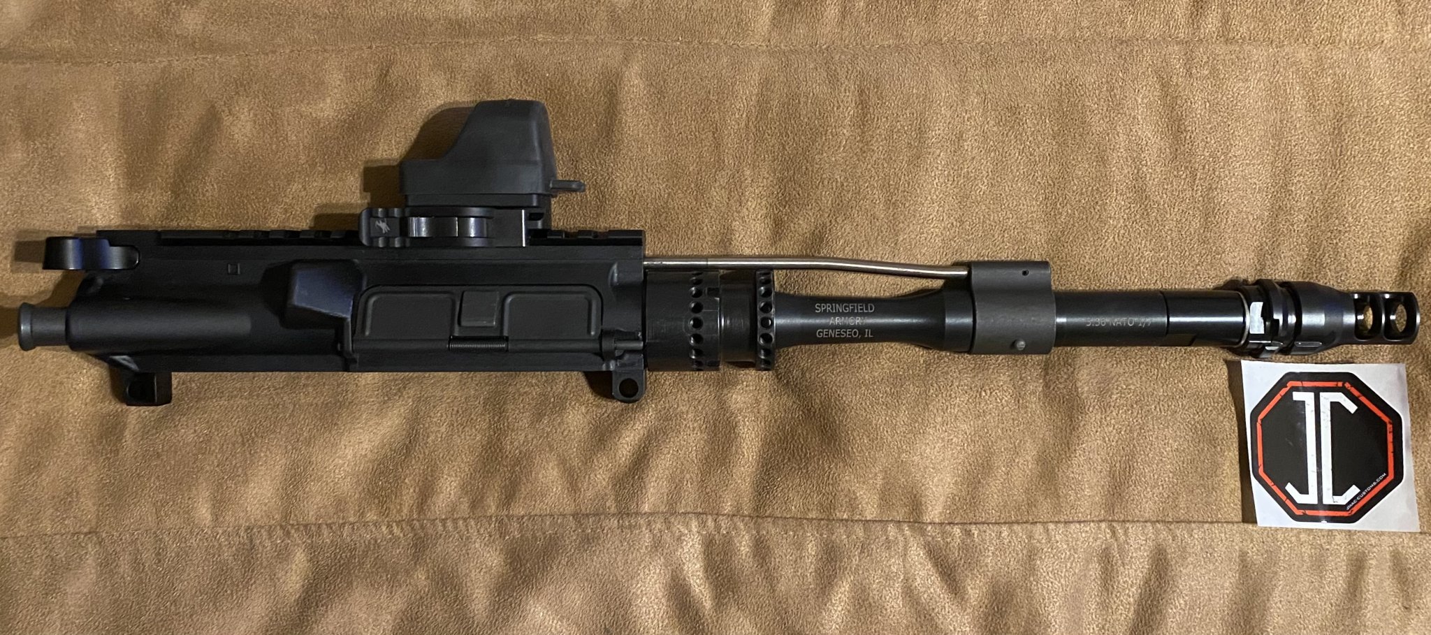

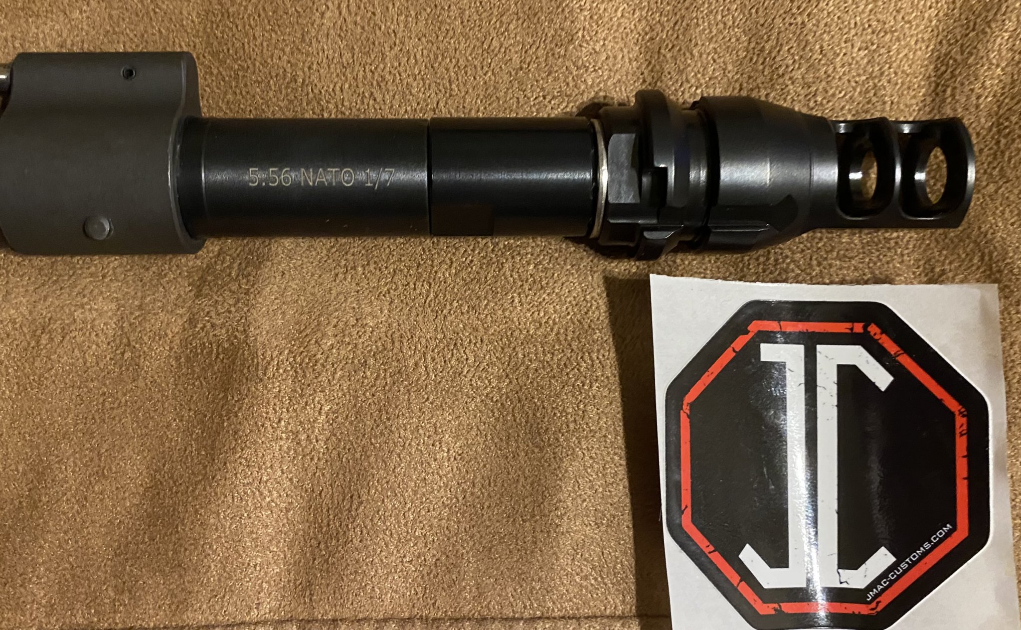

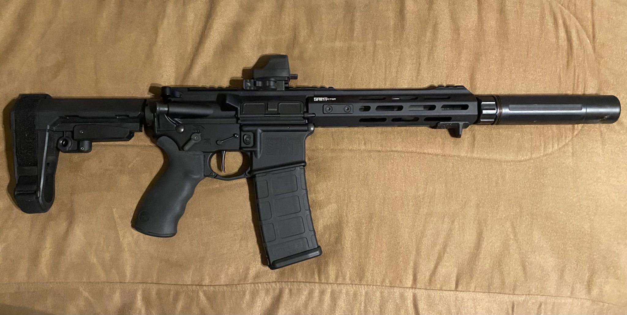

I had to put a 1" adapter on my 7.5" Springfield Saint 5.56 pistol, to be able to run it suppressed, and it turned out perfect. Checked with an alignment rod, and it's dead-on straight. As long as you buy a high-quality adapter and install it properly, and your barrels threads were cut straight, then you shouldnt' have any issues.

I wouldn’t weld anything. Just a good sized drop of Rocksett on the cleaned threads, torque it on there pretty good by hand (just a wrench, no power tools), and let the adapter sit overnight and cure. Then the next day install the muzzle brake, and let that cure for another 24 hours before installing the suppressor or shooting it.
