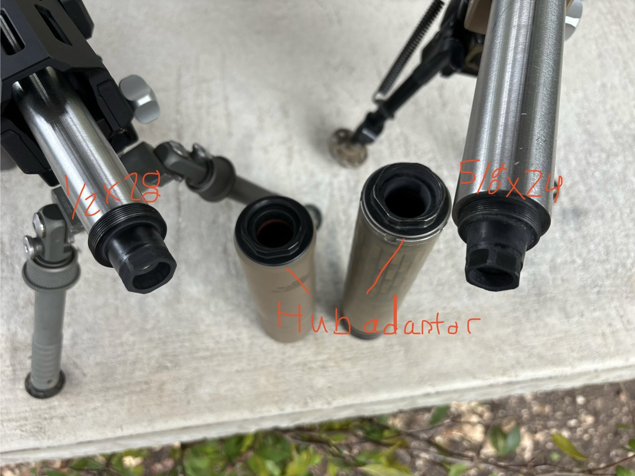

The Enticer S, like a lot of cans that came out of the last few calendar years, is HUB/Bravo (1.375x24, 1-3/8x24, whatever) threaded so the good thing is you have a lot of options.
You'd have to run adapters anyway to direct thread onto 1/2, 5/8 or 3/4 threads anyway. I really like the JMAC 360HD muzzle devices that are externally HUB threaded, they come in a lot of main internal thread patterns including AKs and are overbored. Never had an issue with non-concentricity.
You can also do Keymo or Rearden taper mounts as well, you have a lot of flexibility being able to do HUB adapters inside of the Enticer too. I've only ever used KAC, Surefire, and direct thread JMAC HUB so I can't say much on those other options other than they're typically cheaper.
