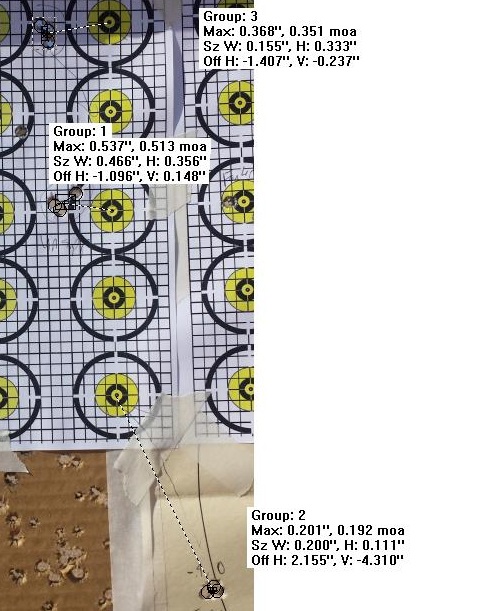

    Its not coming loose and this is the same load I've been using for atleast 2 years now. Same lot of powder in the last year. So it's not the load. I had to recently push my bullet out .01, because I'm pretty sure lands eroded that much. But that shouldn't change anything to do with POI.
    Top 2 are unsuppressed and bottom one is suppressed. I'm gad there was a target to the bottom right or I wouldn't even of seen it! I did a couple more groups throughout the day to confirm.
