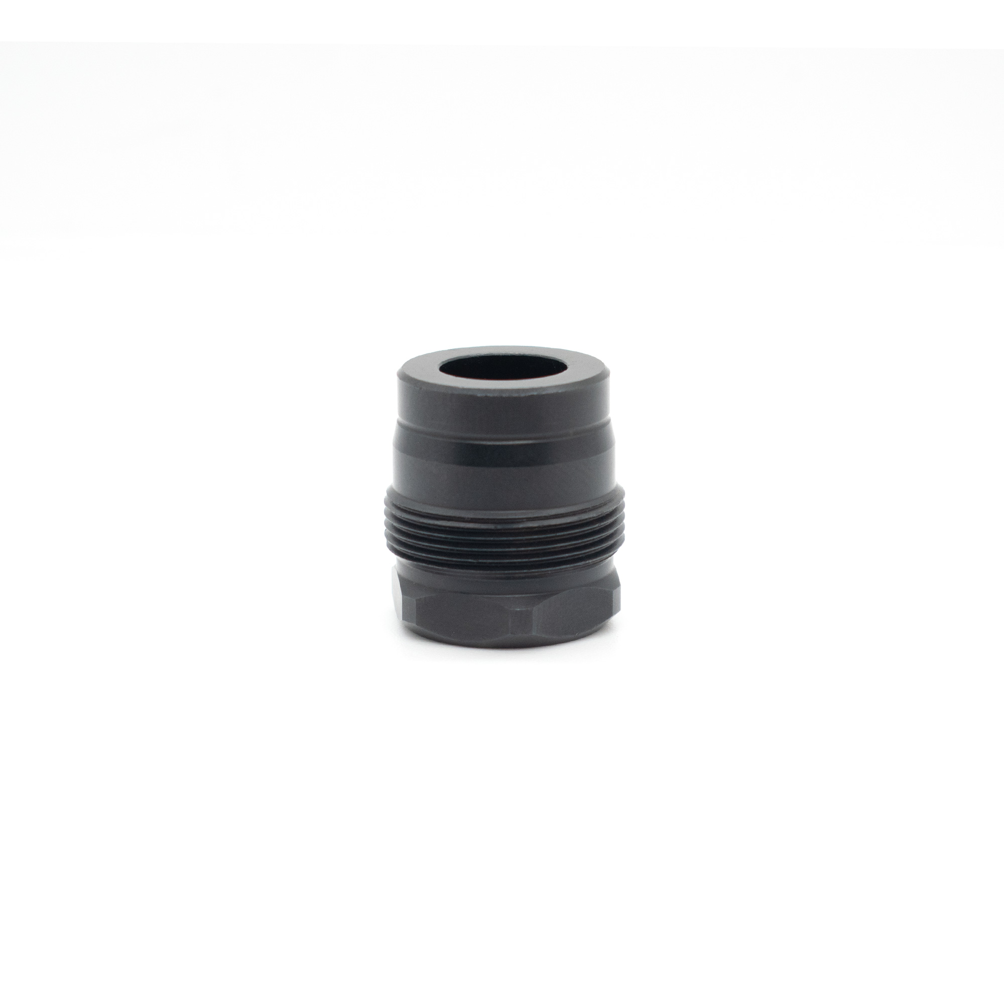

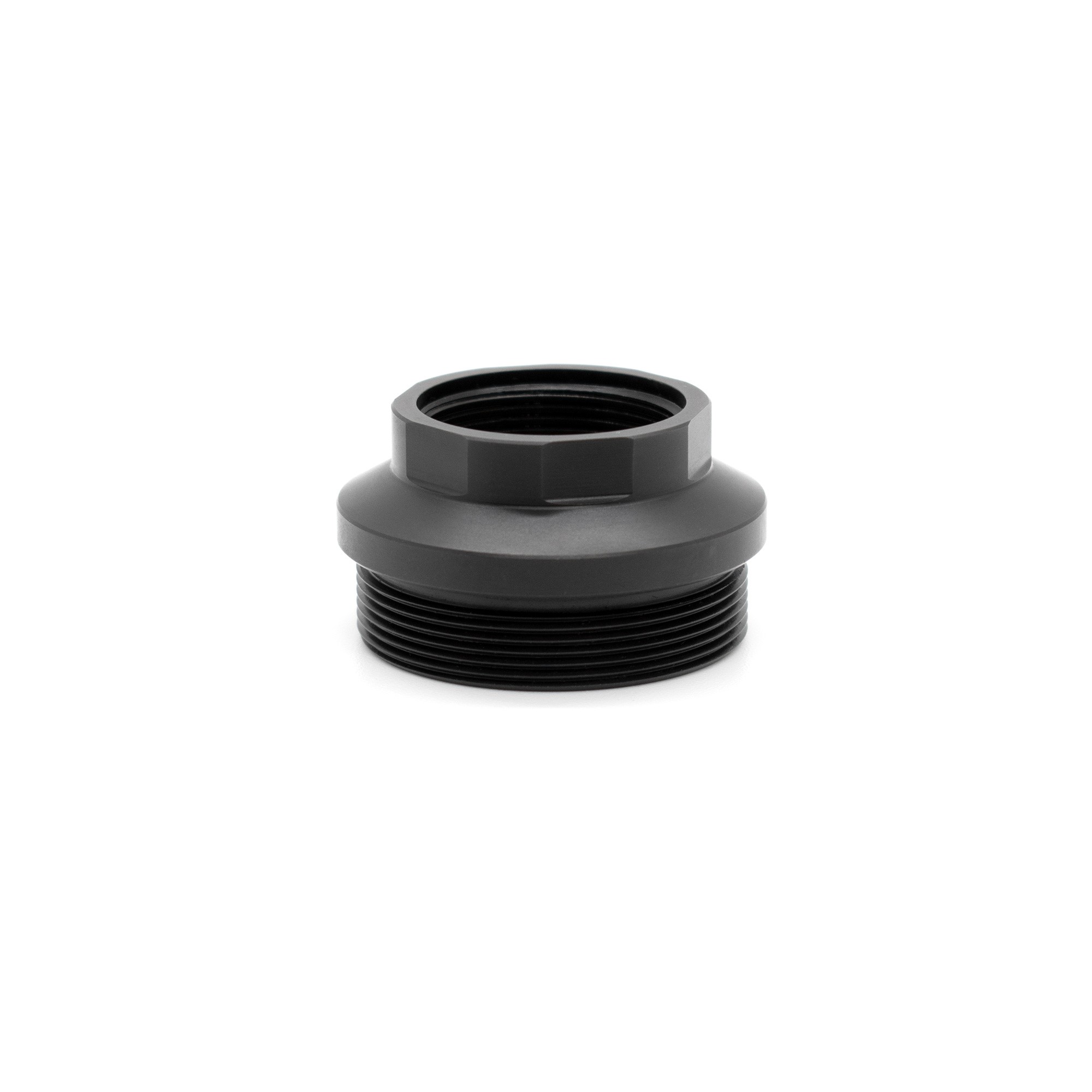

This style of taper mount (same thread and taper as Q Cherry Bomb), is the most elegant, IMO.
If you need an actual brake, then Rearden is definitely the way to go over say the Q Cherry Bomb, which is a horrible precision rifle brake (but great suppressor host).
The downsides to these brakes is that they will have to be timed, either by a gunsmith when the barrel is threaded, or with shims. Not a huge deal, but a consideration none the less.
Yup that is why my favorite options are the Rearden flash hider and liberty baby bell
Rearden even has their minimalist
Once I have a silencer for every rifle many will become direct thread.

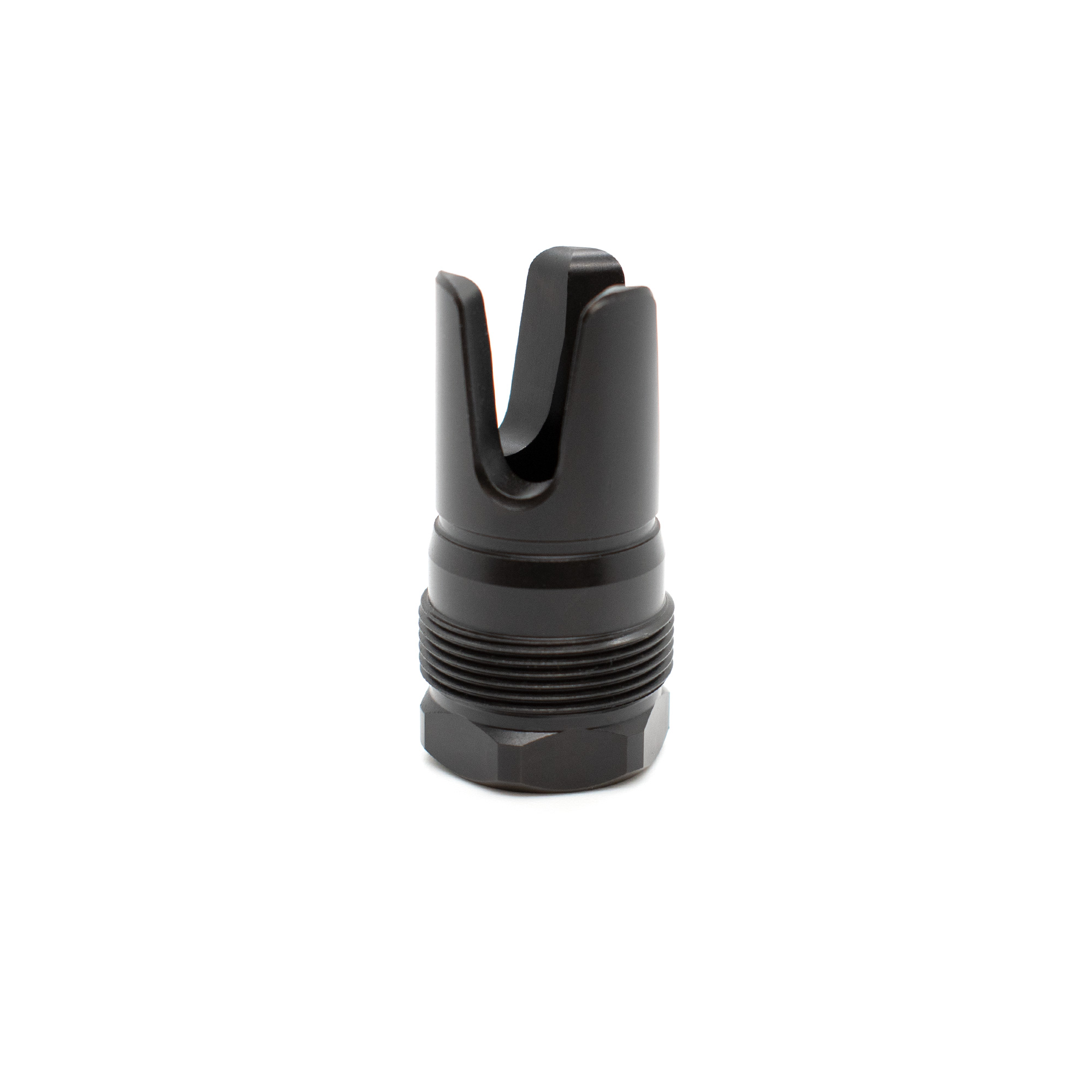

Does the Rearden flash hider mitigate flash enough that you could use it with nods without damaging them?
I have not done flash testing myself. Someone has on a 10.5. So I would say it depends on barrel length and ammo.
video and 4 stills comparing cherry bomb and fhd.
Rearden themselves states that this is a mount first with some flash reduction capability.

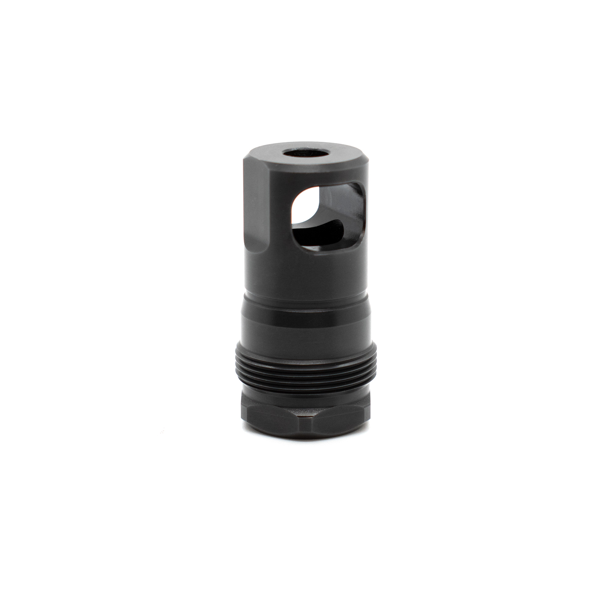

I recently acquired some Rearden SPB's (single port brake), but haven't had an opportunity to shoot them yet.
I plan on going to the range next week, I can provide feedback on how well the SPB works, in comparison to say an Insite Arms Heathen. It's only a single port brake, so I expect it to be around ~40-60% as effective as say a Heathen. I got it as a suppressor host, I'll rarely shoot it without a brake.
What I can say so far is that Rearden MFG products are very high quality, machining and finish on them is excellent.
Any updates on the SPB for recoil?
It's decent, not as good as most of the brakes we are used to of course.
I would say its about 70% as effective as the main brakes we use (heathen, sidewinder, etc.)
Would you say it’s about the same as running a suppressor like the TBAC Ultra 7 or 9?
Also was there any impact on POI shift or precision?
If a person was going to shoot braked a lot and occasionally suppressed, they would probably be better served with the A419 system.
For the inverse/reverse (mostly shooting suppressed), I'm really happy with the Rearden stuff.
Rearden has the new PRS brake which is probably more effective than the SPB - I just mounted it on my rifle but haven't shot it yet. They also have mutli-port brakes as well.
PRS is for the bigger barrels and bores. The A419 does look good but plan to shoot more suppressed
Did you see any impact to POI or precision with the SPB?
Shooting the SPB unsuppressed vs. TBAC U7 or U9?
Hard to compare. The recoil impulse is so different. I also don't have either of those suppressors.
On a 6.5 Creedmoor that weighs 12 lbs, it's extremely comfortable to shoot. But 6.5 Creedmoor is not harsh with recoil to begin with.
Or shooting it unsuppressed with SPB vs any suppressor you have for that rifle.
Reason I ask is that I saw a PRB test on brakes for 308 and 300 Norma Mag. The OPS Inc brake they had was similar to the SPB and had the least recoil reduction of all the brakes (APA and 419 were among those tested) but was similar to the TBAC Ultra 9.
From memory it seems to have a fairly similar recoil to my Abel Co. Biscuit, which recoils more like a brake than a suppressor.
Probably comparable to something like the U9 in reduction in recoil force, but impulse is much different.
