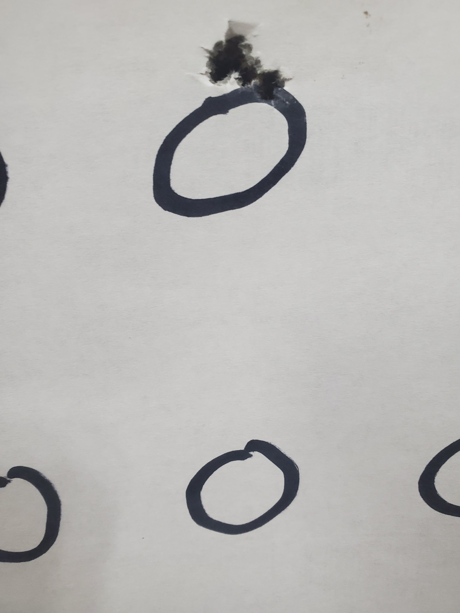

It doesnt effect anything on my two. Remove and reinstall. POI shift is the same every time. The only trouble I have had with repeatability was trying to put the SS can all way on. I have to back it off one click from tight. My TI can I do not. I can tighten it all the way and click the retaining ring over the last half notch usually. Even when not though. Same POI shift and groups don't open up.
Here is 5 though the SS backed off a click. I

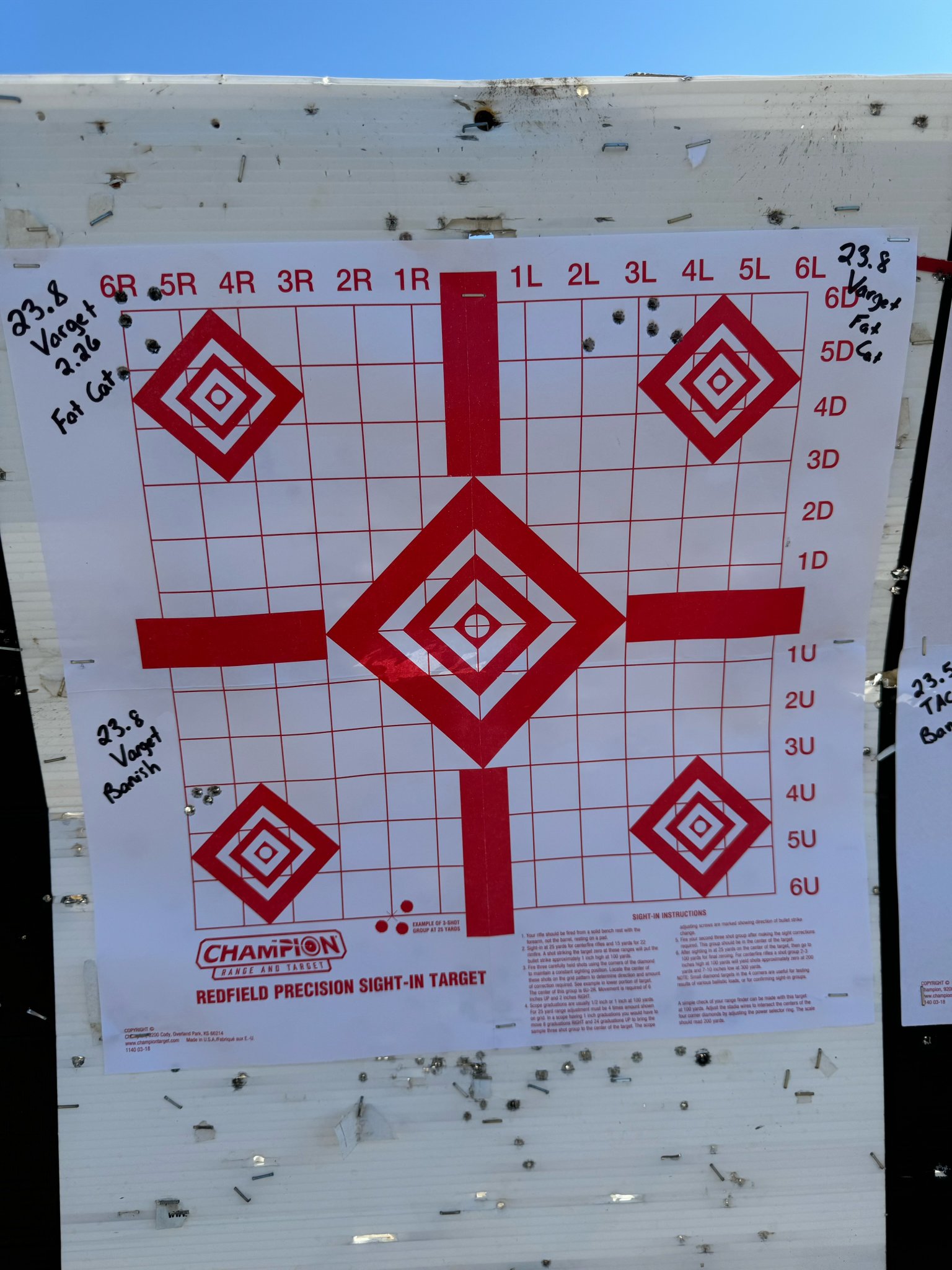

I loaded some of my hand loads last night and decided to go and try both suppressors this morning to see if this was all just in my head. I shot three, five shot groups. I started with the top left and top right with the YHM Fat Cat mounted. I made sure the suppressor was tightened down and secured completely. The bottom left is the same exact hand load the only difference is I had a Banish 30 suppressor attached. The difference is day and night. @hlee
Put the fat cat on a different rifle. Shoot this one with the banish 30...
I loaded some of my hand loads last night and decided to go and try both suppressors this morning to see if this was all just in my head. I shot three, five shot groups. I started with the top left and top right with the YHM Fat Cat mounted. I made sure the suppressor was tightened down and secured completely. The bottom left is the same exact hand load the only difference is I had a Banish 30 suppressor attached. The difference is day and night. To add I’m not intentionally shooting high and left my scope is still zeroed to a previous load lol.@hlee

Barrel was threaded from factory, no baffle strikes, QD was installed as tight as it will go with no wobble in it.
I'd still shove an alignment rod in there to confirm.
Some baffle strikes can be very, very small (slight?) and hard to see....but IME even a very slight strike results in far more shift of POI than you are seeing. Looking in there with a bore scope is often helpful in ID'ing these very minor strikes.
As for "factory" threading of the muzzle...just me, but that doesn't automatically induce confidence. Ah, what factory?
Sorry, I'm low and slow and out of ideas. Best of luck.

Check out the picture I posted this morning. Shows the differences in accuracy when I took the 556 can off and put the 30 cal can on.
It doesn’t appear that one could argue that swapping cans no effect on accuracy in your case.
I’d run the Banish 30 on that rig.

I contacted YHM and showed them my results from accuracy test yesterday and was told that it’s normal to lose that much accuracy and pretty much to deal with it and it was good enough.

While this has not been my experience with the R2 on a 5.56 rifle, it is also a 30 cal can. And, when you put a suppressor on a rifle, you kind of imply that precision is a secondary concern. With that, I’d put the Banish 30 back on that rifle and move forward.
