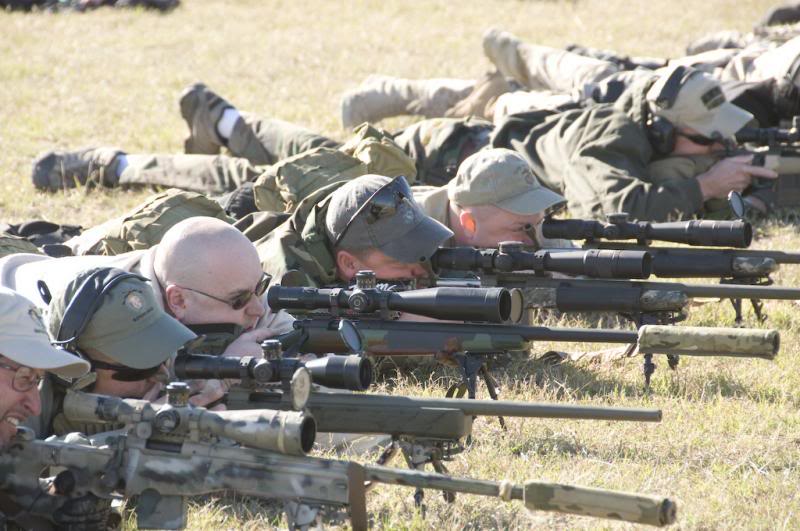

A top shooter told me there’s no advantage of a can since everyone else has a brake blasting at you from both sides. But I’ll try it anyway. Can’t hurt.

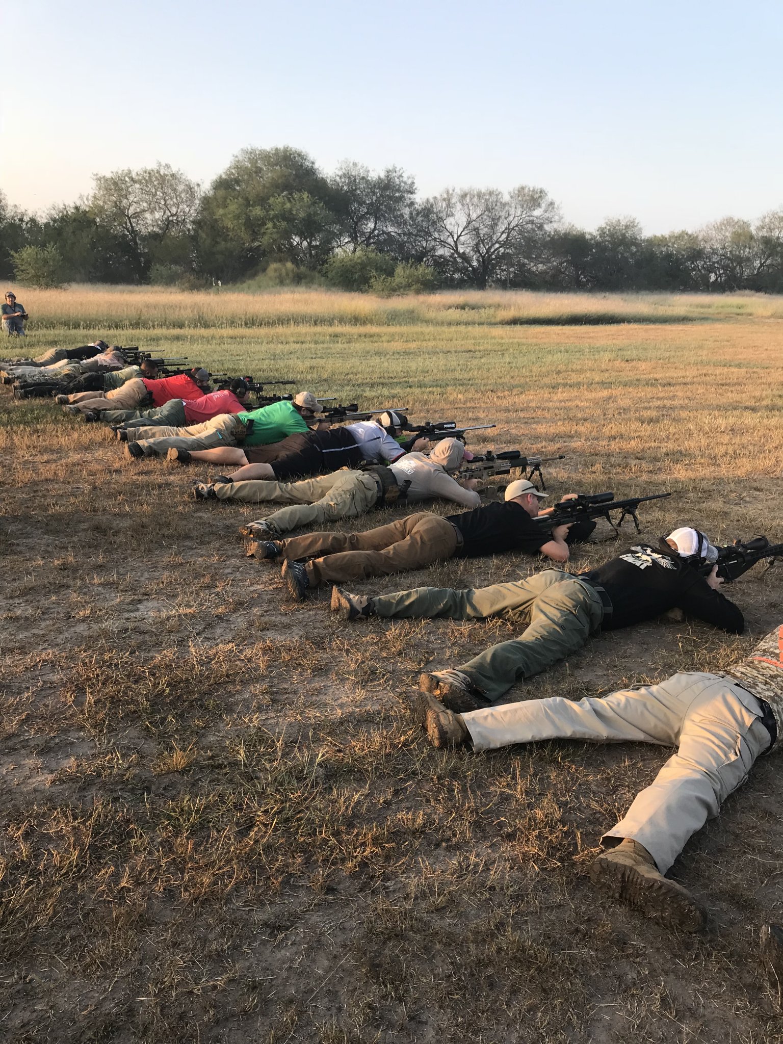

I don't know who this is, but there's never been guys shooting on both sides of me at a match.
Usually the closest bystanders to a shooter are the ROs and there's plenty of room to get far enough away from a shooter as to not feel the brake, unless you're the RO.

I’ve only shot one match. But out of the 10 stages 3 of the stages had shooters within 10 ft of each other shooting separate targets at the same time. So it was loud and I could feel the blast from the shooter on my left while I was shooting.
It happens depending on where you shoot. I have mad it happen many times. Less so now with the cookie cutter PRS stages though.
