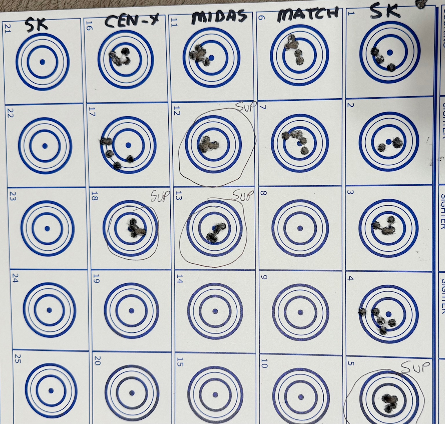

Suppressor has been noted to improve accuracy on my CZ 457 MTR. This is a short term effect. While it did initially improve accuracy with more than one type of ammo it will change during extended course of fire. The accumulation of deposits inside the can will change weight and then harmonics too. Also the crown will become fowled much more quickly.
I have been doing alot of experiments with ammo across a CZ 457 and a Vudoo. So far they both love Lapua Center-X best.
See attached photo. Can was a Spectre 2. Circled groups were with the can.
Top right 2 groups were not 5 shots. Was dialing in the difference for SK.

He is asking about a centerfire suppressor so anything Rimfire doesn’t apply.
OP you will get a small impact shift but accuracy should stay the same or better. Impact shift is normal.
