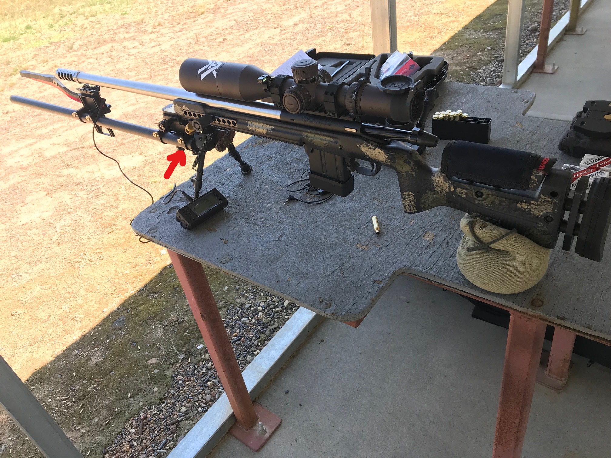

That said I would recommend getting the Magnetospeed Sporter and then getting a mount to mount it on so you will not have to have it touching the barrel/can at all. This way you get the ease of use of the Magnetospeed and the ability to use it on whatever you want and no effects on groups or POI or messing with people at the range setting up the chrono down range. There are mounts out there that are around $120-140 so with the Sporter and that you aren't overly expensive and get a great set up. Here's a pic of my Wiser Precision mount, which is a more expensive unit but there are less expensive. I'd never go back to an optical chrono. My Oehler 35 has sit around unused for many years since getting my first Magnetospeed V2 years back.
