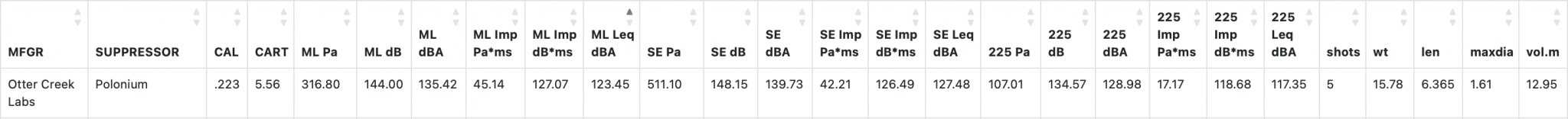

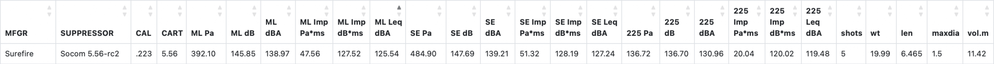

View attachment 8409176View attachment 8409177
Based on the metric that matters (shooters ear dBA), there is no discernible difference between the OCL and the Surefire...
I see no reason to pick the OCL over the Surefire, based on this single metric.
I'm not sure how the OCL compares to Surefire in ruggedness for hard use or back pressure. I know the Surefire is designed for that use, not sure about OCL.
Reactions: 1911hombre
The polonium is better with flash reduction and lower back pressure as well? I’m just seeing a db chart and yes Polonium is a little more quiet.
The Surefire is actually quieter at the shooters ear - the metric that really matters.
But the difference is so small that it would be indiscernible.
I believe the RC2 is designed to be low back pressure, along with other parameters optimized for AR-15/semi-auto use. Unsure about OCL in that regards - though I know they make good cans for precision use.
