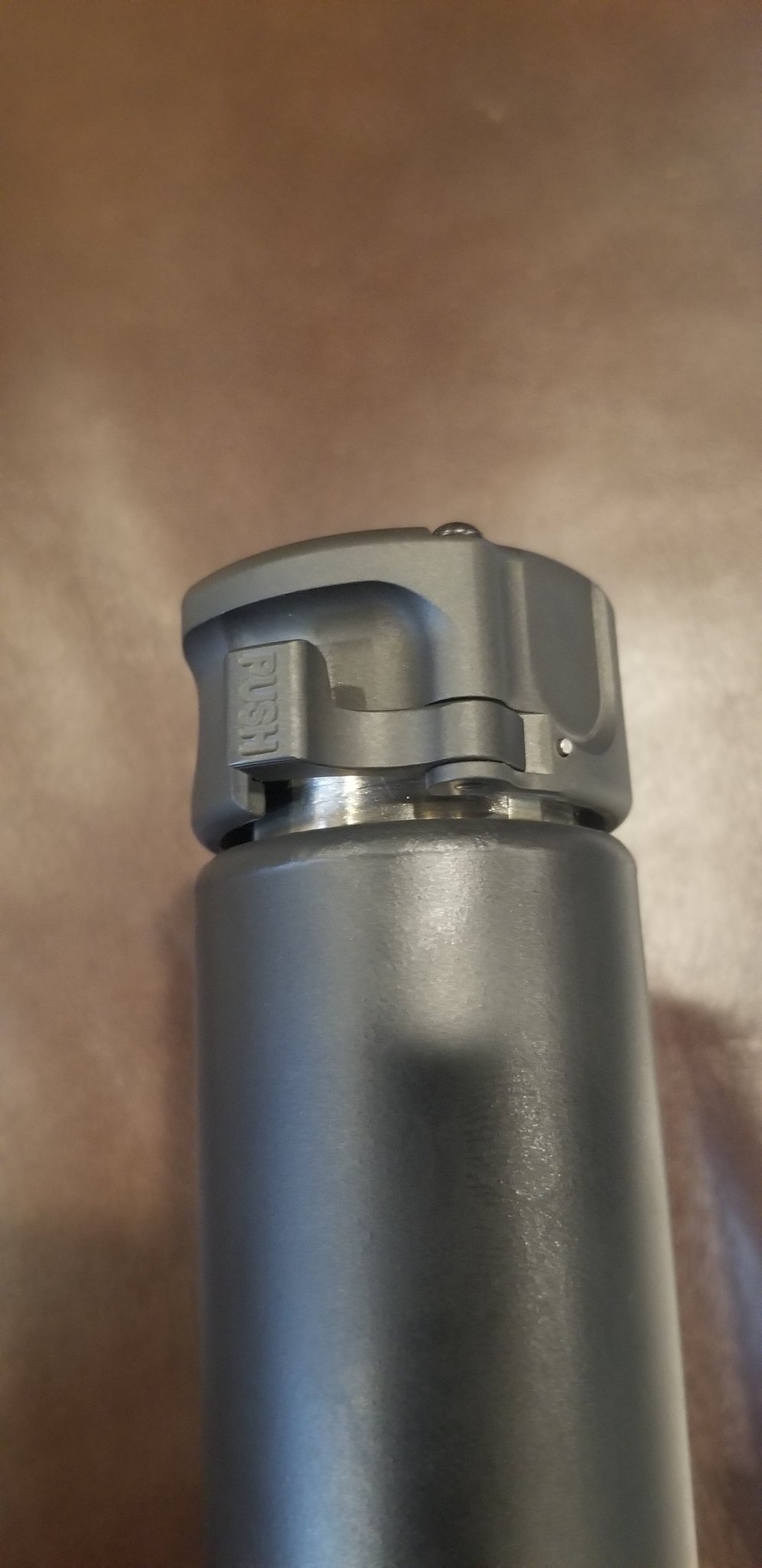

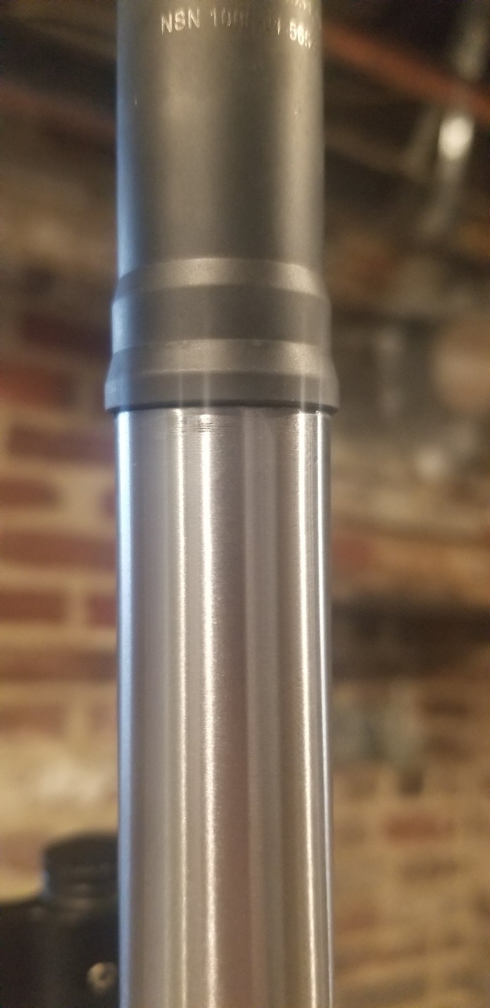

    What, if any, rotation do you get on your FA762ss with considerable hand torque? Do you notice any difference between seperate mounts?
    Absolutely none. Have had mind since 2011 or 12. It’s a beast and has easily seen more rounds than any other can I own. It’s extremely repeatable and always marries up to the same tooth on every mount.
    Thx for the reply. Check the video below. Am I not man-handling this enough when I tighten it? The only reason I ask this is because I have another rifle with the same mount, and I notice both a distinct audible and tactile difference when I mount the suppressor compared to this rig:

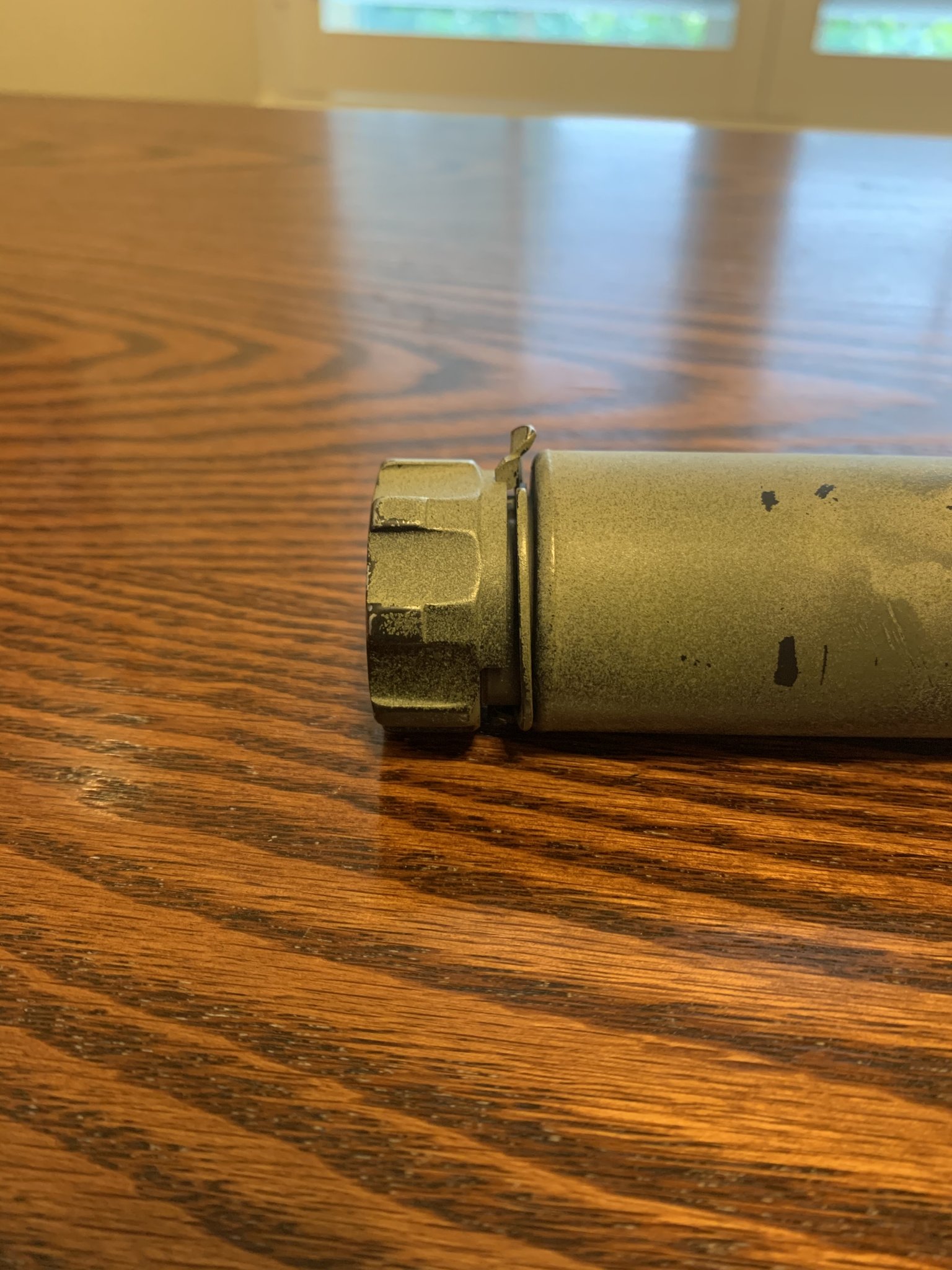

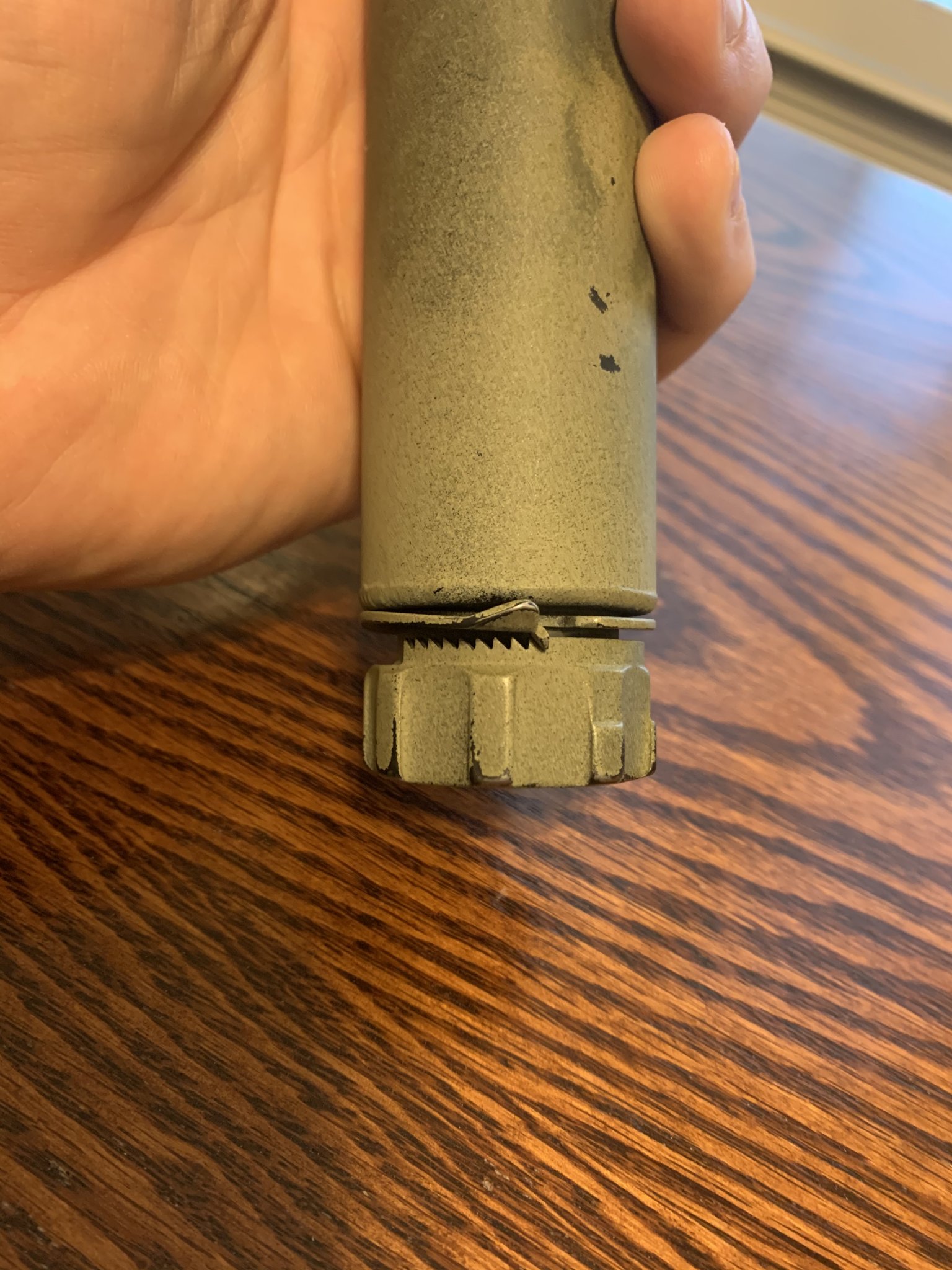

    I forgot they made two iterations of these things, only difference being the QD mechanism. Mine has the exposed flange that you have to pull down on to disengage, not the button style. I'll snap a pic
    Reactions: chrome
    Thx for that, yeah looks like we have different QDs. I've only had 2 shooting sessions with it so nothing leads me to believe its coming loose per se, but given that 1-2 degree rotation under pressure, now my spidey sense is up on it. Also knowing it locks up different on two different mounts is interesting to me. Probably warrants a quick call to SF.

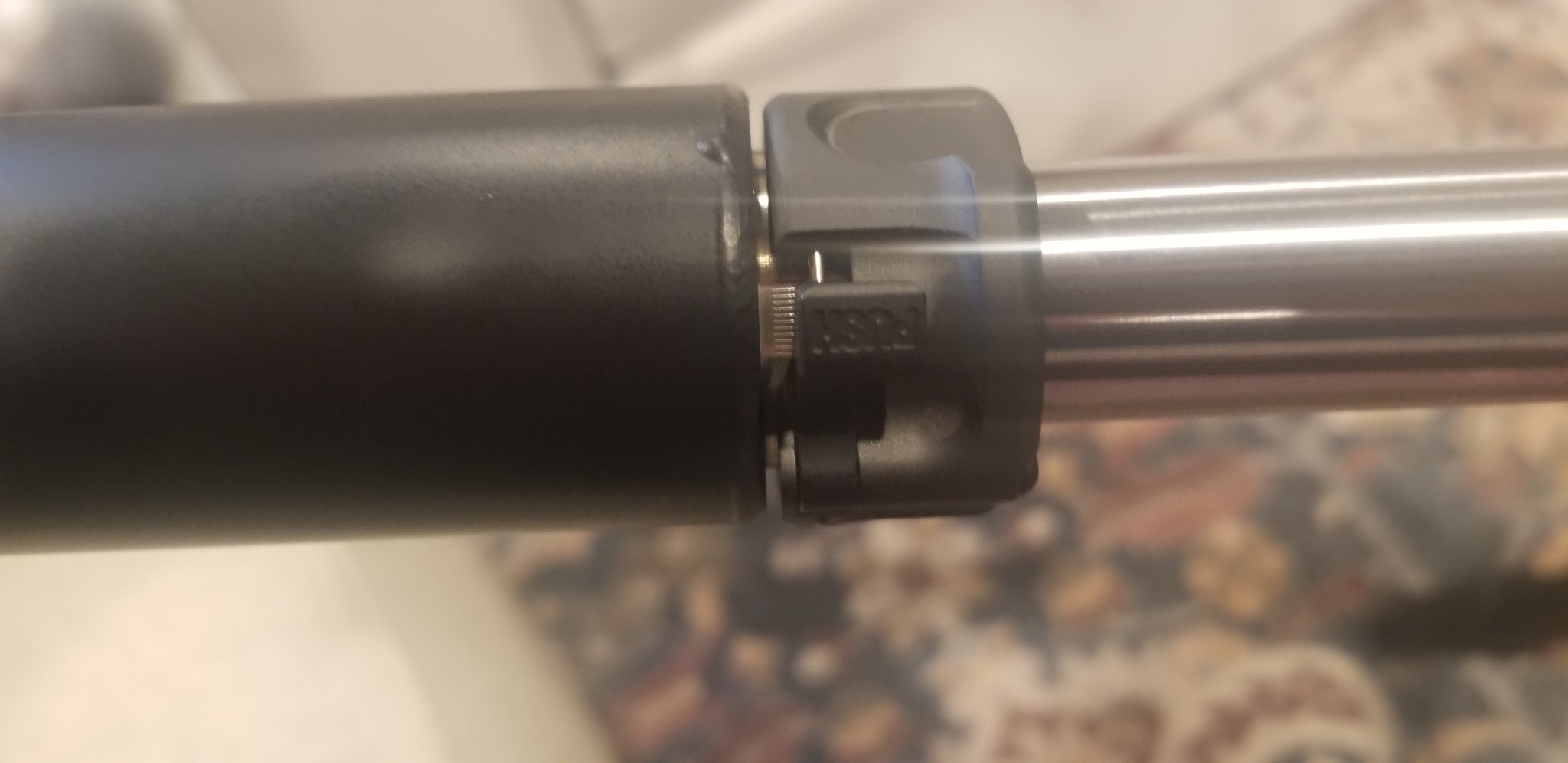

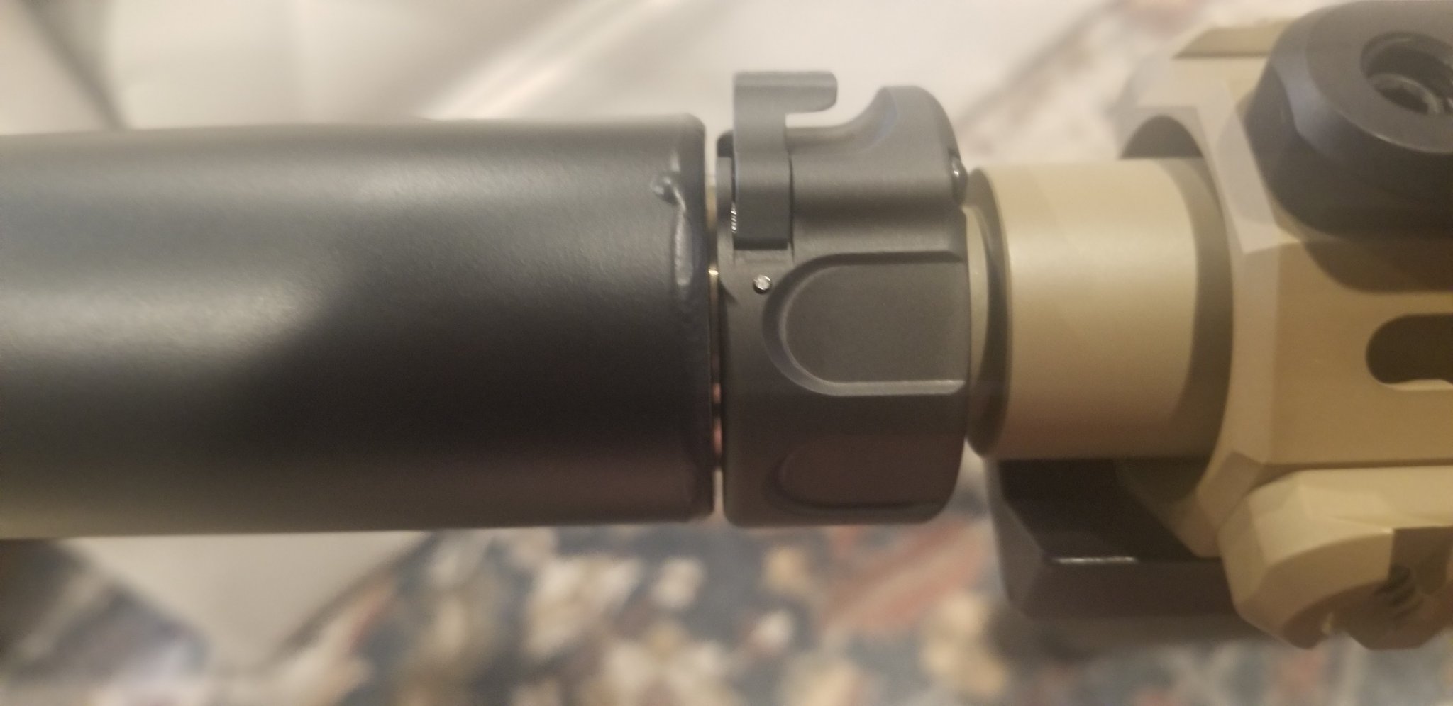

    So tried man handing it a bit more this morning and still getting a bit of wiggle similar to the video. On hold with surefire to get their take on it. But quick question, when y'all mount up your can, how much distance do you have between the collar and the tube? Here are mine below, first is the 6.5cm where I have the wiggle, and the second is the .308 where i have no wiggle:
    6.5cm
    .308
    Nope, no touching, super close but not touching. I think the distance between the tube and the collar on both looks relatively symmetrical as well.

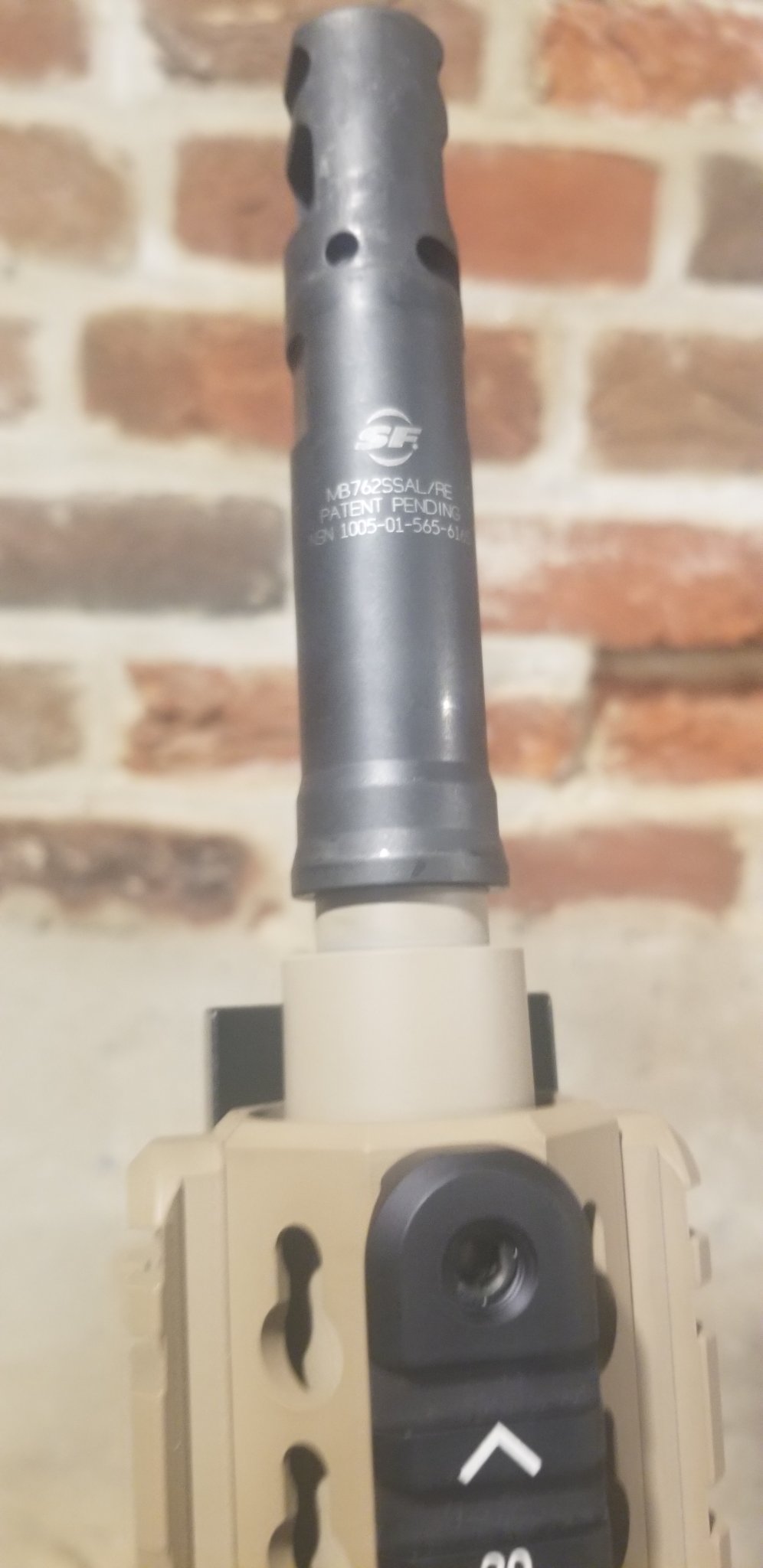

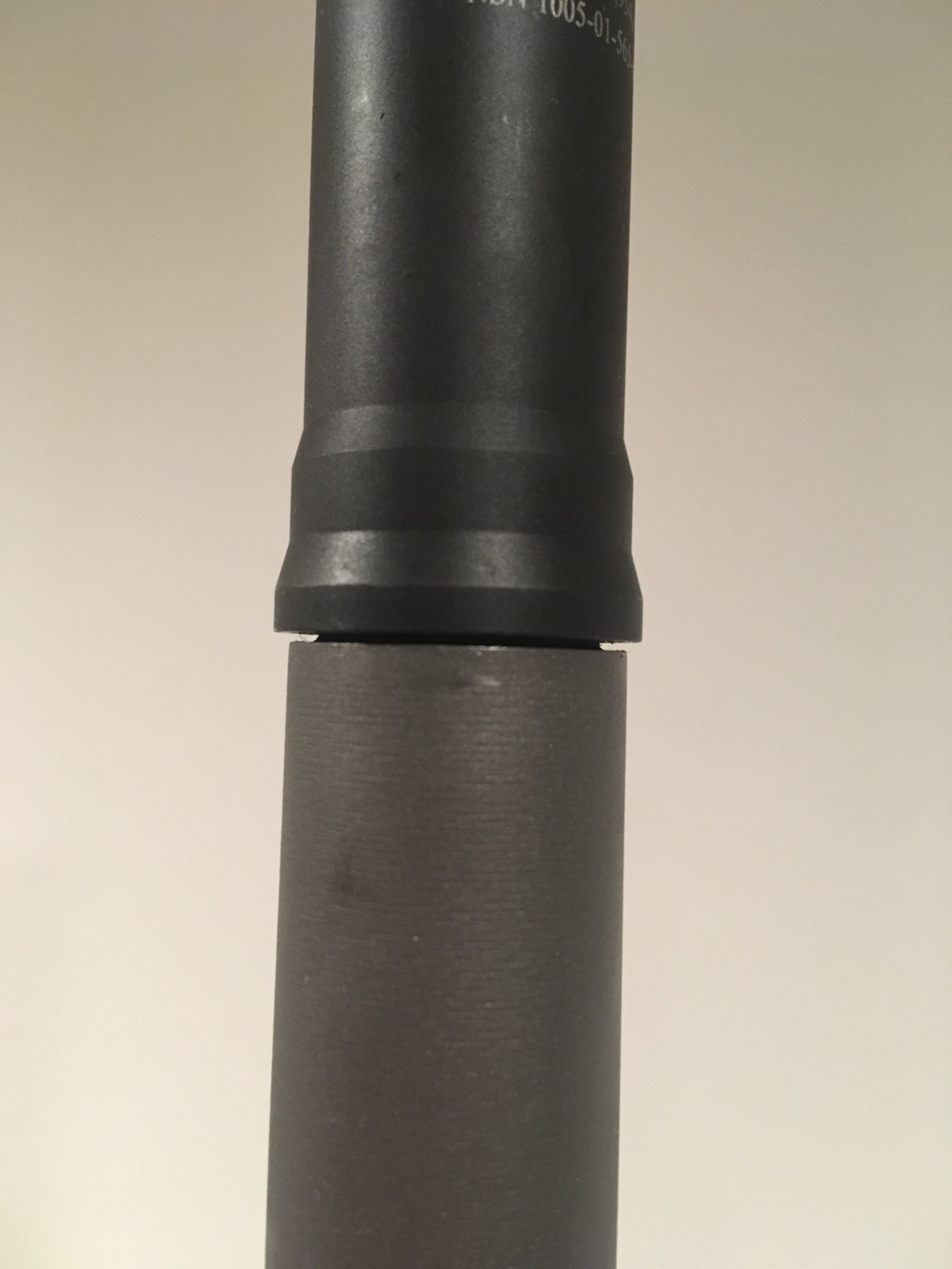

    Can you give us a better angle on that pic. I did have a barrel not cut for proper clearances. It can hit in multiple spots 1) One the fattest part of barrel diameter and also 2) on the Inside of the lock not on the smaller diameter. Try turning it on with about 60% force a few times, take it of and look for marks on barrel. See below pic for when I had original barrel cut wrong from smith. There is small line that is more shiny than the surrounding area.
    I sent the barrel to a different smith who cut the barrel shoulder back past that line, but then didn't go quite deep enough. Teeth were locking, but it was angling the can. Luckily we caught it doing the same thing and seeing the rub. Finished taking it down and can works great now. The lock nut has a cam motion to it when it tightens down.
    OP - did you put the brake on the 6.5 yourself, or did the smith? can you get the brake to wiggle at all or is it clearly just the can and how it engages with the brake that is introducing the wobble?
    Brake doesn't wiggle under the same pressure as I can get the can to wiggle, and I had a smith install it. Barrel was profiled and threaded by PVA
    Dude, you may have nailed this. I just attached the can on/off hard 5 times, and I noticed the below, it is VERY slight, but you can see something rubbing
    Here is the profile of the .308 barrel:
    i can tell just looking at that picture that it couldnt properly lock on without the appropriate relief cut machined behind the break. that is your problem. surefire can send you the machining diagram. i have one saved somewhere if you need.
    if the smith wont fix it theres a lot of good ones on here that will. LRI has done good work for me in the past on similar small fixes.
    Damn :( - I sent the instructions w/the brake when it was made, but admittedly trusted it to be right. Guess good news is I haven't shot the can off the gun!
    If you happen to come across the machining diagram lmk, I'll call surefire back again today to see if they can get them to me.
    Yeah. Seems like smiths don't know how to read or use the instructions... I had to give mine the machining diagram twice to get it right. He did, and finally did it well, but should have looked/followed it the first time.
    I believe you are looking for .775 or under.
    Reactions: chrome
    Also - you shouldn't have to take mount that off to make the cut. They should be able to make it with the mount on. Your marks are kind of the guide. Give a bit more relief and it should be ok. As long as they don't touch the back of the mount things should be good.

    Agreed, Surefire has been great, called them today, and they've already called me back asking for clarification and now we are exchanging emails with their suppressor SMEs.
    UPDATE:
    This thread was super helpful, especially the few who PM'd (especially @deltawiskey) and got me hooked up with a specialized M40 smith here in VA. 1 week turn around time and I have it back today. In short, everyone above was correct, profile of the barrel was the root cause to the can wiggling on me. Got it all put back together this afternoon, and it is rock solid in its lock up, and I can hear/feel the "tactile" clicks when I mount it on this rifle just like I do when I mount it to other FA762ss setup I have.
