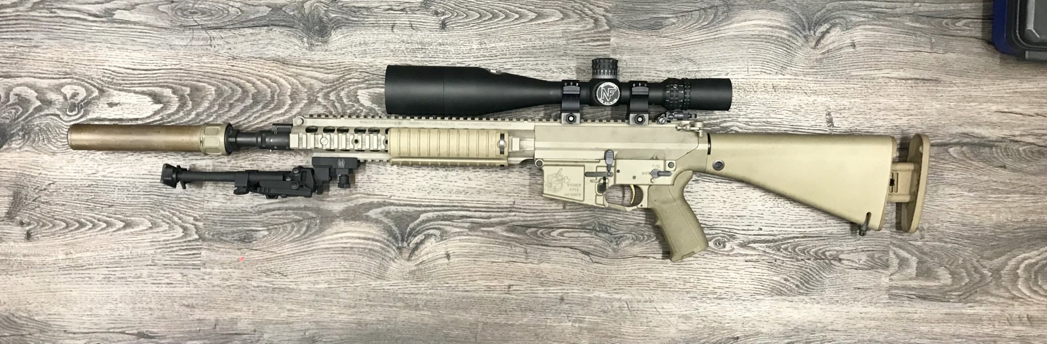

    Cool man. I had an SR25 ER and a NSW return MK11 can and it wasn’t a perfect lock up but it didn’t kill my accuracy. Mine only rotated left and right at the gate where it latched. But the muzzle was concentric still. Sadly I had to sell that gun and suppressor during my divorce to pay legal bills. She is missed.
    Sweet looking set up, man. Sorry to hear of the circumstances forcing its sale. My SR25 is an EMR the prev owner had Nefarious Arms dimple the barrel and trim to 18.5”. I have owned it for a year and recently added a long tine MAMS and LMT stock kit.
