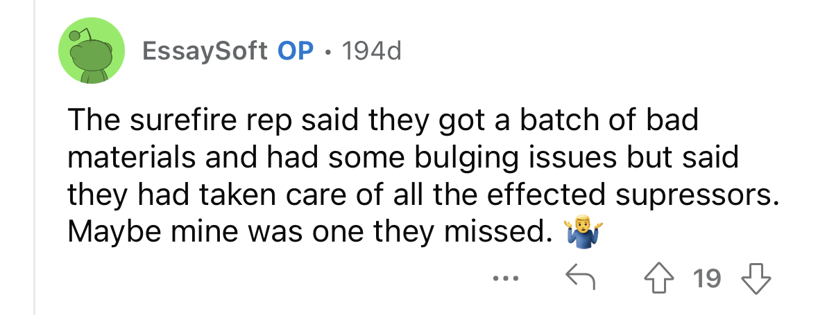

PS - when I first realized there were issues with the SPS, while awaiting my stamp, I contacted SF and they informed me of the same shared with this other SPS owner on Reddit:
They assured me mine was not part of the same batch - but who knows if my batch or copy has defects.
I would be interested to learn if you do call SF, whether yours was part of the affected batch(es).

Regarding the issues with defective materials causing bulging problems with the 300SPS, I have not experienced this. However, I had this exact issue with a Surefire 7.62 RC2. So the defective tube material was not limited to the 300SPS. Surefire’s customer service was outstanding after that incident. They had to replace the defective suppressor with a new one since the tube is the serial numbered part. That meant I had to wait another year to get the replacement. Surefire did cover the cost of the new tax stamp, so I was not out anything but time for the replacement. But the long wait was the reason I ended up going with a can with a replaceable end cap and a tubeless design for 300BO.
I still use my Surefire 7.62RC2 and 300SPS on all my bolt guns and large frame AR’s, and I wouldn’t hesitate to get another of either model. Anything man-made is subject to have the occasional problem. The important thing is how the manufacturer handles it. Surefire is good to go.
It’s great that they were willing to replace the entire tube / give you a new suppressor (as I’ve read they have done for others), but I saw pics from a poster on here or Reddit where they just laser cut the lower half of the tube of a customers 300 SPS and welded a new half tube to the bottom half leaving a visible weld seam.
