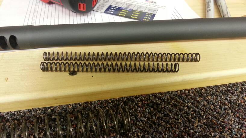

Here was the biggest reason for my troubles. What came installed in the 1086 from Surgeon in front, stock replacement spring sent from Surgeon in back (appears to be same length as factory Remington spring).
This isn't to say there's still not issues with the Timney in it though because I didn't want to go firing a whole box of ammo through his brand new barrel, but after changing to a factory Remington long action spring five in a row went bang.
