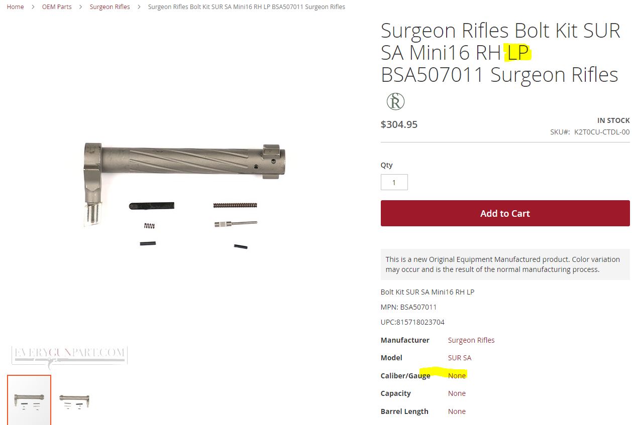

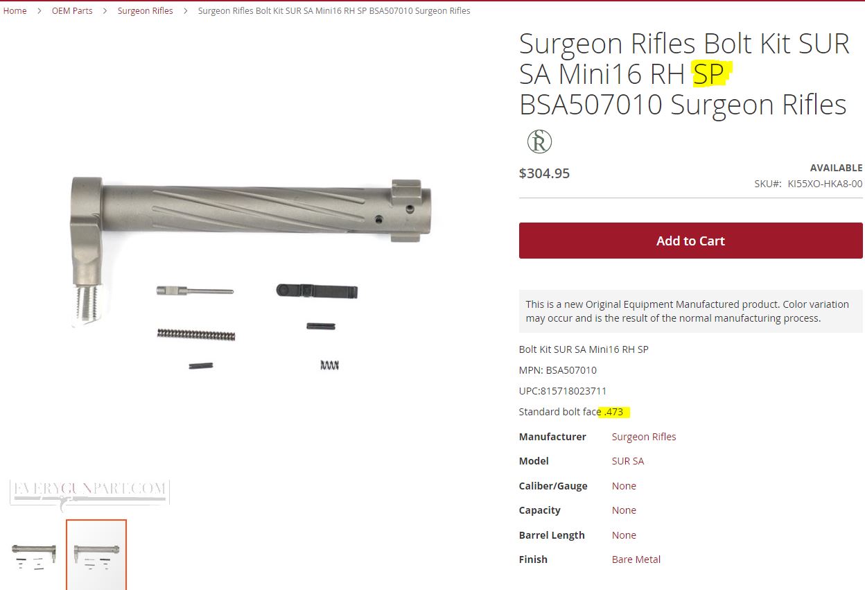

Long time lurker, first actual OP post. Maybe this has already been covered but i can't seem to find details on it. Been scoping around looking at buying a .384" BF bolt for my 591, however ran into a few issues with identifying parts that are posted on everygunpart website. my two questions are as follows:
1) What is the difference between 'SP' and 'LP versions of these bolt 591R RH bolt kits? references: SP bolt & LP Bolt. they both are Mini 16 extractor so it's not the extractor type.
2) I spoke with a gunsmith at Surgeon and he stated that they definitely make a .384" Bolt face bolt, however, i cannot find it anywhere on their parts site. I reached out to everygunpart, but the response was that they have posted everything they stock in their warehouse. the link above for the LP bolt does not specify what bolt face it is.
Can anyone shed any light on this?
Thanks in advance!
The .384 bolt face (.223) option is listed under each 591R action in which it's offered.
SP/LP is the reference to the firing pin hole diameter in the bolt face.
It's not much of a website for exact information is it?
Thanks for that, i forgot they offered two firing pin sizes. Thank you!
It’s quite a mixed bag as far as parts descriptions go. Of course they sell parts for multiple manufacturers so it’s not tailored to specific manufacturers like surgeon. I just want to find the bolt so i can build a .223 trainer!
