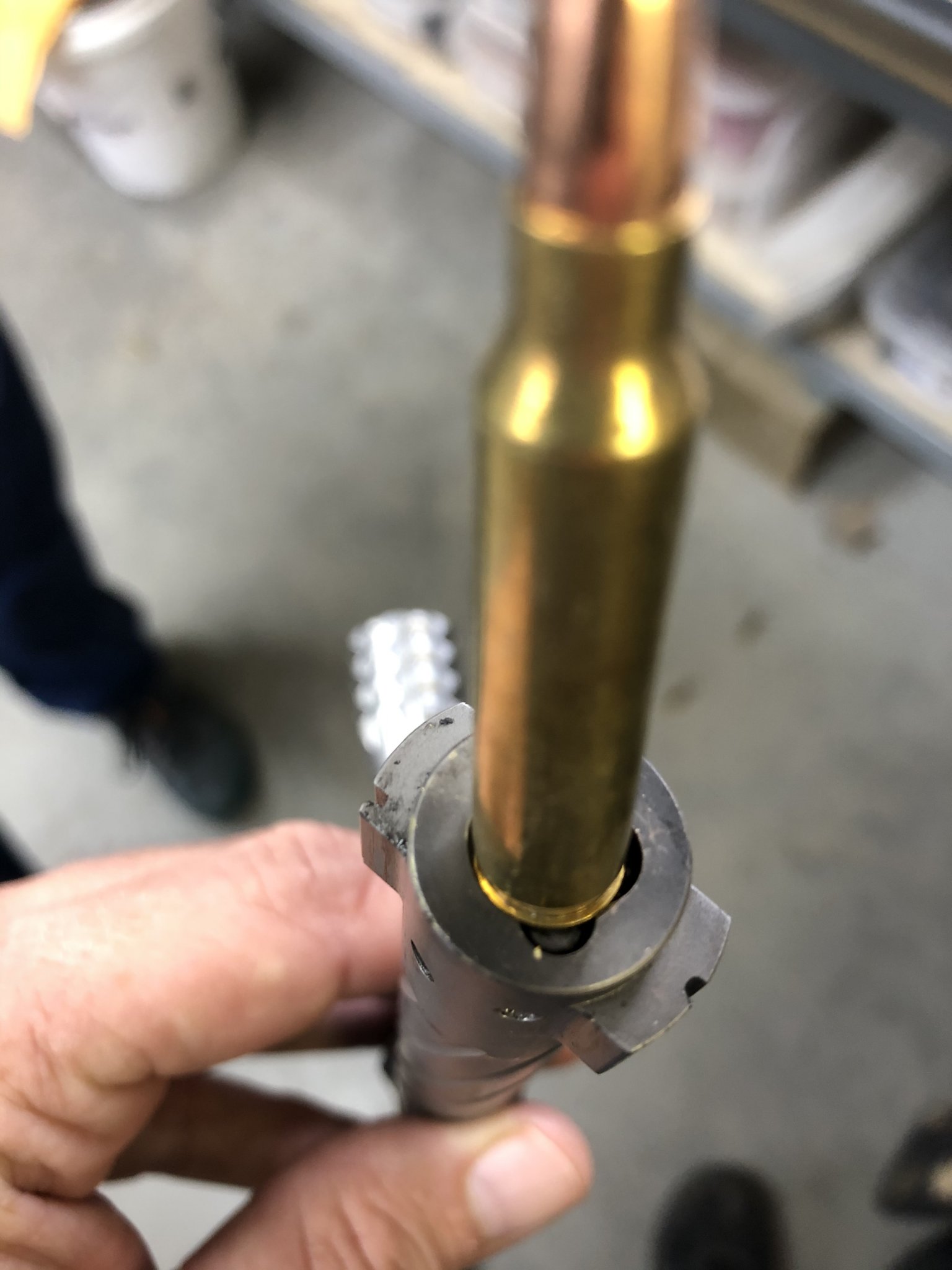

I had my local gunsmith chamber a .223 barrel for my surgeon action. It has a new bolt assembly that I just purchased from Surgeon. Without the extractor clip in the bolt, the bolt closes fine on multiple brands of brass both new and fired. With the extractor in it, it is hard to close the bolt. It appears to “ pop “ over the extractor and then it opens and closes fine, but does not eject the round from the bolt. We have swapped out the ejector and that makes no difference.
Anyone on here seen something similar? Any ideas to fix it? I am sure surgeon will make it right if it’s their problem. I just don’t want to wait forever on them...
Just ran into a magnum surgeon bolt doing the exact same thing.
On a magnum bolt, there’s probably a M16 style extractor that on Surgeon actions, will usually go outside of a typical .710” counterbore diameter when it snaps over the rim. On that one, I’d bet it was a gunsmith error.
The OP’s with the Remington extractor could possibly be a manufacturing issue, or extractor issue.
