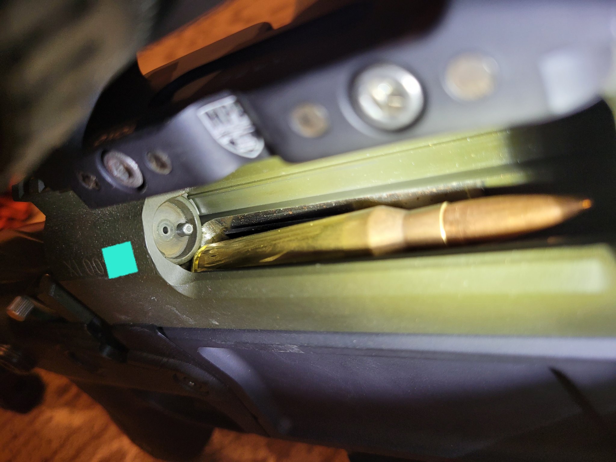

    I'm having some problems, I have a Surgeon XL that I put into a AIAX chassis and have issues with the bolt not coming back far enough to get completely behind the rim of the case. How would you guys go about fixing this? Thanks

    If the bolt only has to move further to the rear a small amount, you can machine a small amount of material from the face of the bolt stop.
