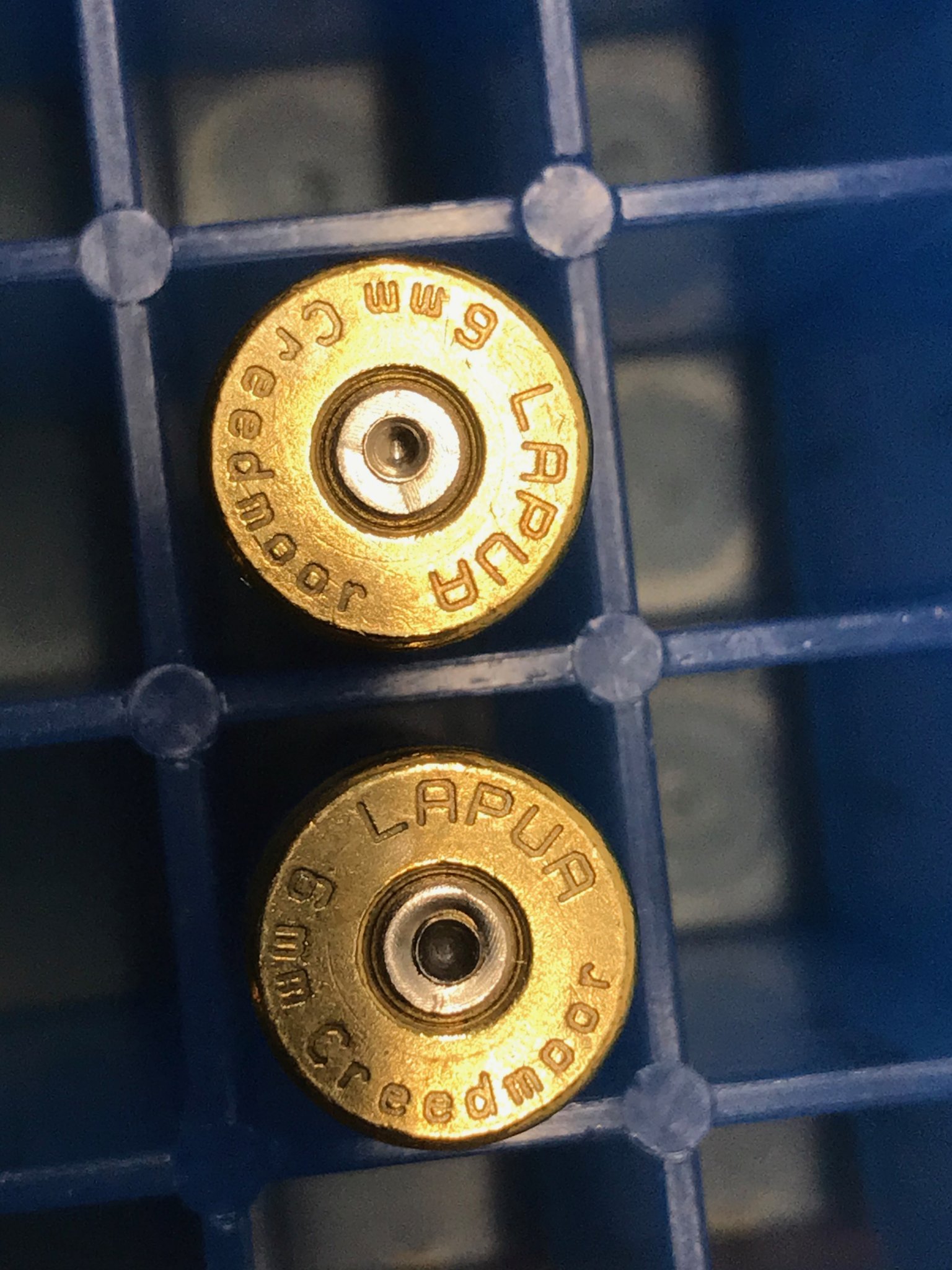

The primers
This is 40.2 - 40.8gr H4350

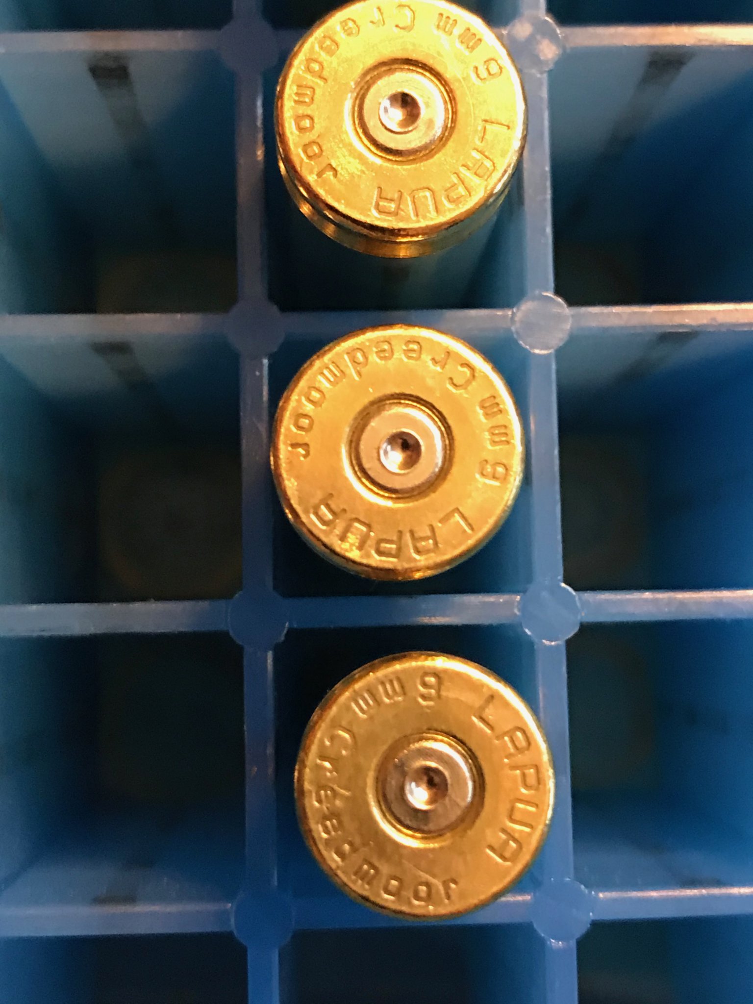

Same but looking down
This is 39.8 and 40.0gr H4350 looking down (my standard load is 39.8)
I am expecting that the primers have soft metal cups?
Providing my pressure are not high, are they safe to my rifle to shoot?
I would bet that the cratering is from a softer or thinner cup on the bench rest primers. The ar primer is a tougher cup by design for auto loading rifles. What’s your location
I've shot several thousand small rifle primers in my RPR without an issue shooting 6.5x47. However, I've heard I'm one of the lucky ones and that many RPRs need to have the firing pin turned and the bolt bushed like the Rem 700. Your primers look exactly like my SRPs when I use a Rem 700 before it gets sent to GreTan. I also generally try to use the CCI 41s because they help as well. But it looks like you were able to get away with it using the AR primers, but the softer cups are showing the need for firing pin bushing.

Tsonka, If memory serves the factory Hornady match 6mm Creedmoor (I'm thinking about getting a barrel in this but haven't yet) are like the 6.5mm Creedmoor and use LR primers. It's not an issue with the LR, it is an issue that shows up when you use a SRP in a rifle that has a firing pin and firing pin hole that is set up for "normal" 308/LRP dimensions. For instance, my son's Bergara, which is a Rem 700 clone worked just fine with Hornady 6.5 mm Creedmoor factory, and Federal and several other all LRPs. The LRP reloads were fine as well. I got some Lapua SRP and in my first tests got all craters and even one pierced primer. Sent the bolt away to GreTan, and the problem went away. Now that rifle gets a steady diet of SRP with no issue. The firing pin size/bushing issue is one reason I've not run anything but LRP brass in my 6.5 Creedmoor AR10.
