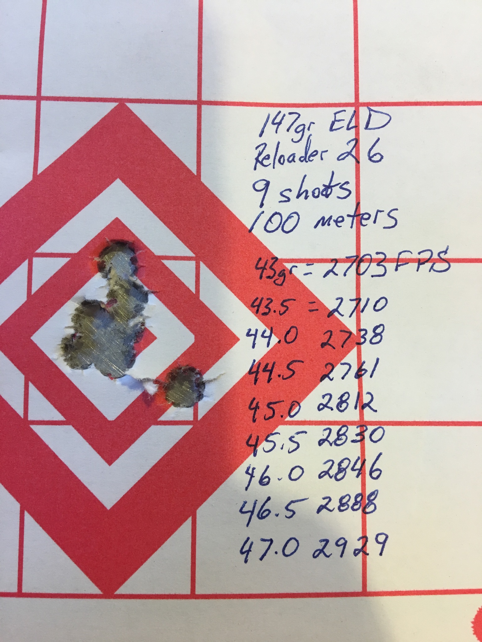

    I’m glad you posted your results with H1000 as I had posted a question last week about using Retumbo with the 147gr ELD. As far as I can tell, H1000, RL26 and Retumbo have similar burn rates with Retumbo being the slowest. Densities and case fill will be different from those powders. I have some Retumbo loaded up with the 147eld and plan on testing it this weekend.
    I have gotten excellent results with RL26 and the 147eld. I have a lot of data with it but to answer your question about group size for a larger charge range; below is what I found to also be a nice group for a slower powder over a large charge range. Maybe not as good as what you experienced but similarities that might suggest more flexibility for slower burning powders.
    Reactions: XLR308 and 10ring1
    Those are some impressive velocities and a nice group considering the velocity span.
