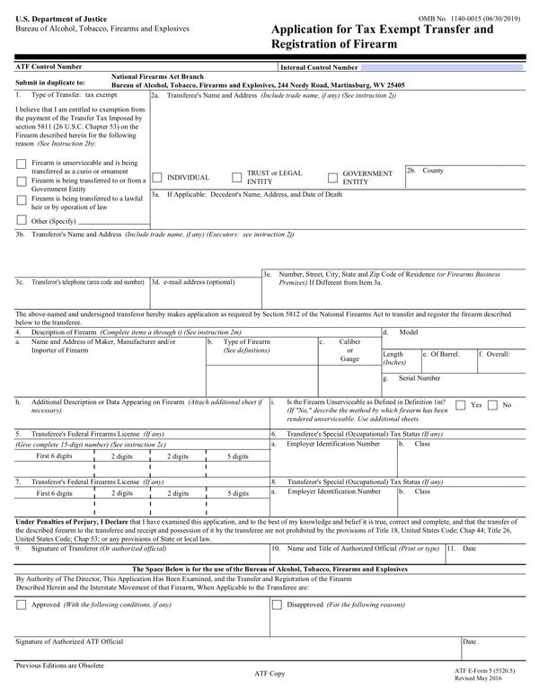

I have a couple of suppressors on individual form 4's. If I were to pass for some reason I was wondering how or what my wife would need to do to? I'm assuming she could surrender them to the local sheriff's office or ATF branch. Would that be correct? They are obviously in my name only. Thanks.
No. They get a free form 5 to an heir or can be sold on a form 4 to another individual.
In both cases the executor of the estate holds them until stamps come back.
You can leave them to anyone that's not a prohibited person, or sell them. Local guy died and left all his guns and suppressors to his shooting buddies. No big deal.
So, I thought there was a requirement that nobody else could access them? In case of death,legally an heir couldn't touch them.

According to the lawyers after you die they become part of the estate, which is why the executor of the estate can legally hold them. He's already legally responsible for everything else.
Easiest option is to form 4 them to a trust right now, and add trustees. Then any of the trustees can legally possess them even after his death.
A Form 5 is tax free, see the chevy_man post above.

So, how is my answer wrong? She can, with a form 5 and proof of death transfer them to herself or another family member.

For registered NFA firearms in the estate, the executor should take action as soon as possible to arrange for the proper registration of the firearms. Possession of an NFA firearm not registered tothe possessor is a violation of Federal law and the firearm is subject to seizure and forfeiture.However, we do allow the executor a reasonable time to arrange for the transfer of the registered firearms in a decedent’s estate. This generally should be done before probate is closed.It is the responsibility of the executor of the estate to maintain custody and control of the firearms and to transfer the firearms registered to the decedent. The firearms may not be transferred to another party, such as a firearms licensee, for consignment or safekeeping. This would be a transfer subject to the requirements of the NFA. The licensee may assist the executorby identifying purchasers and acting as a broker.

You can fill out the form 5s and leave them with your will for the executor to date and file.

Yes, she can sell them to a SOT or anybody she wants but only if she is the actual court appointed executor or if she transfers them to herself on a form 5 first. Or, per your trust advice, if OP wants to spend beaucoup money to set up a proper NFA trust then transfer each of his NFA to the trust so he can name her a RP on the trust.

It's not complicated. Write a will naming executors and heirs then form 5 them or destroy them.
