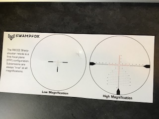

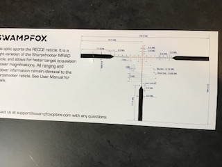

The box includes a nice reticle card which shows the reticle at 2X, 12X and the subtensions outlined on the flip side.

3. Reticle - I really like this RECCE reticle. This is the most subjective part of a scope, so YMMV. I like that at 2x the crosshairs give me a quick target acquisition and uncluttered view with a smaller illuminated crosshair in the center. It works for my purposes at 2x.
At 12x those thick crosshairs are gone and you have a nice milrad reticle with marks every 0.5 mils out to 14 mils left, right and down. The center is a small floating dot. You also have a tree with 0.5 mils dots. The center crosshair that is illuminated is 6 mils. No nonsense, nothing you don’t need. Not too fat at 12x and not too thin at 2x. Ive always likedthe Burris SCR2 reticle, but the RECCE, while very similar, is better executed, especially at 2x.
