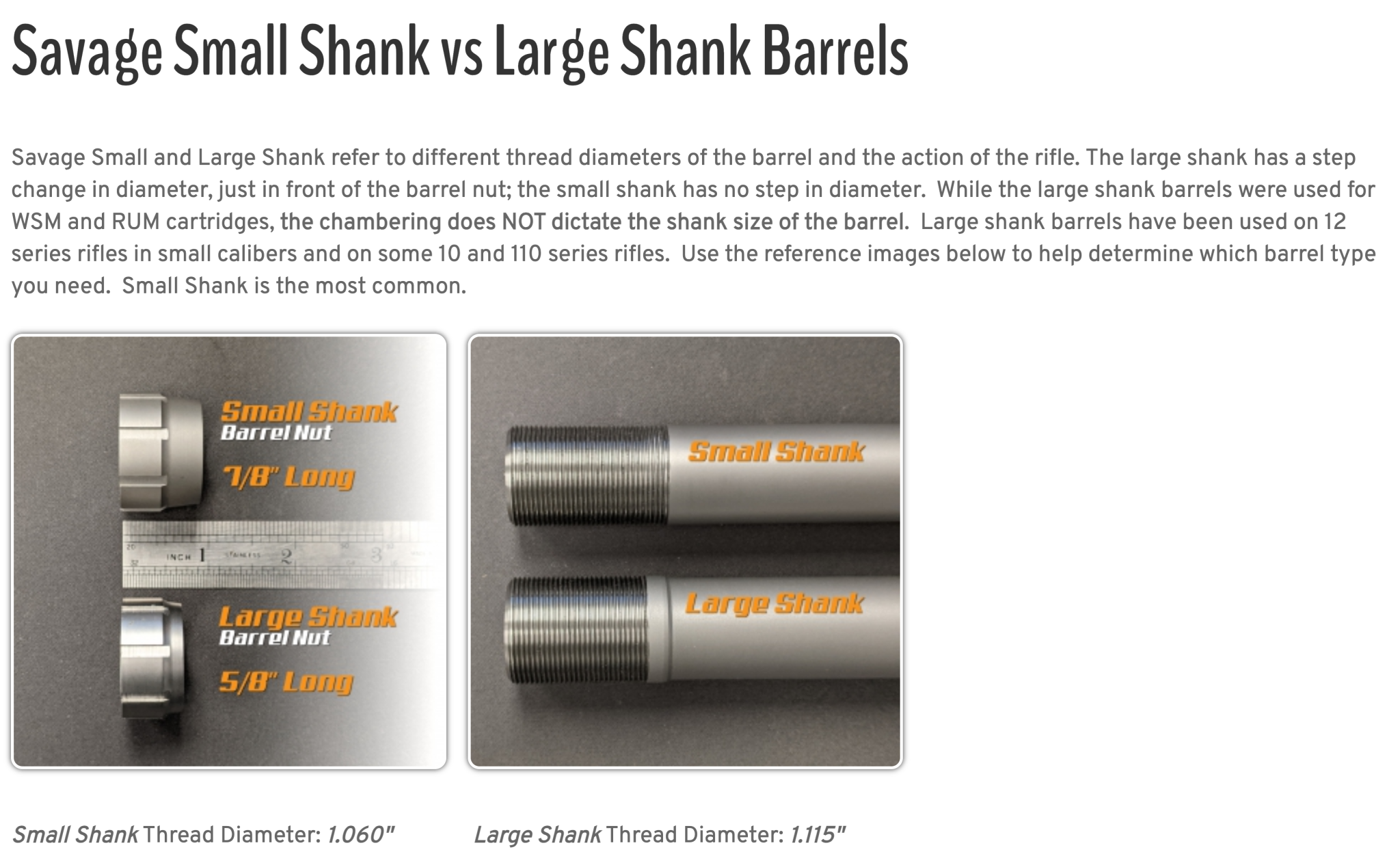

I believe that Savage only makes the 6.5PRC in large shank.
Measure the length of the barrel nut on both rifles.
Small shank barrels have a 7/8" long barrel nut while large shank barrels have a 5/8" long barrel nut.
There are aftermarket barrels for 6.5PRC made with small shanks.
Pacific Tool and Gauge makes a magnum bolt head for the Savage.
Thanks. Ah, Gotcha. I called Savage to talk to them about it, and they said something about the size of the shank. 1-1/8" vs. 1-1/16". I didn't understand that information was connected to the fact the only size 6.5 PRC barrel was a large shank. Thanks for clearing that up. I could tell from the images it appeared to be a large shank (I could tell by the length of the barrel nut). I called Savage with the serial number, and they confirmed it was a large shank. Savage also said they would not sell me a barrel, but I found a company called JA Outdoors they appears to buy guns and break them down to sell the parts. They sell Savage actions there, but I'm wondering if I need the entire action, or can I just get another bolt and bolt face for the PRC? I was thinking that might be the easiest if I didn't have to separate the action from the chassis, but just swap the barrel and bolt. Is it that easy?

The Savage elite precision with a large shank is for 338 Lapua which is a long action.
I don’t believe they make an elite precision in short action with a large shank.
That's what I would have thought too. I called Savage with the serial number and they confirmed the large shank. When looking at the barrel nut on it, I can also see it is the shorter length nut, in this image, so it must also be a large shank. Interesting.
