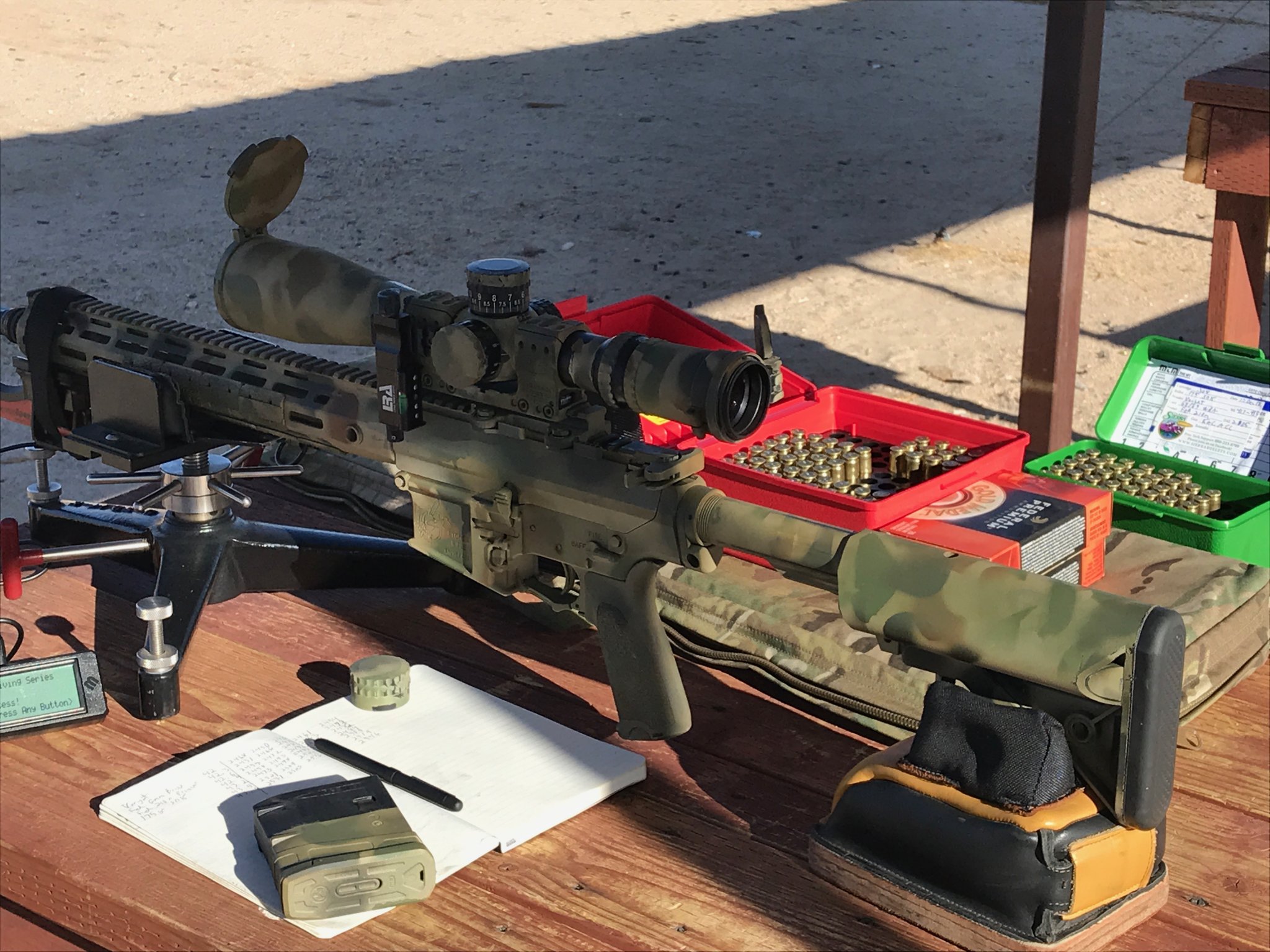

    I used this setup when moving from my AI AT to my SR25 ACC and back. Its a Larue QD riser mount which has a slight cantilever, and a Spuhr SP4001. Worked perfectly.
