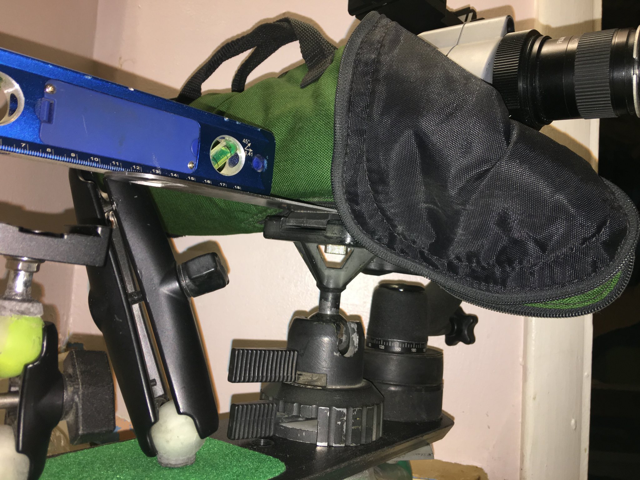

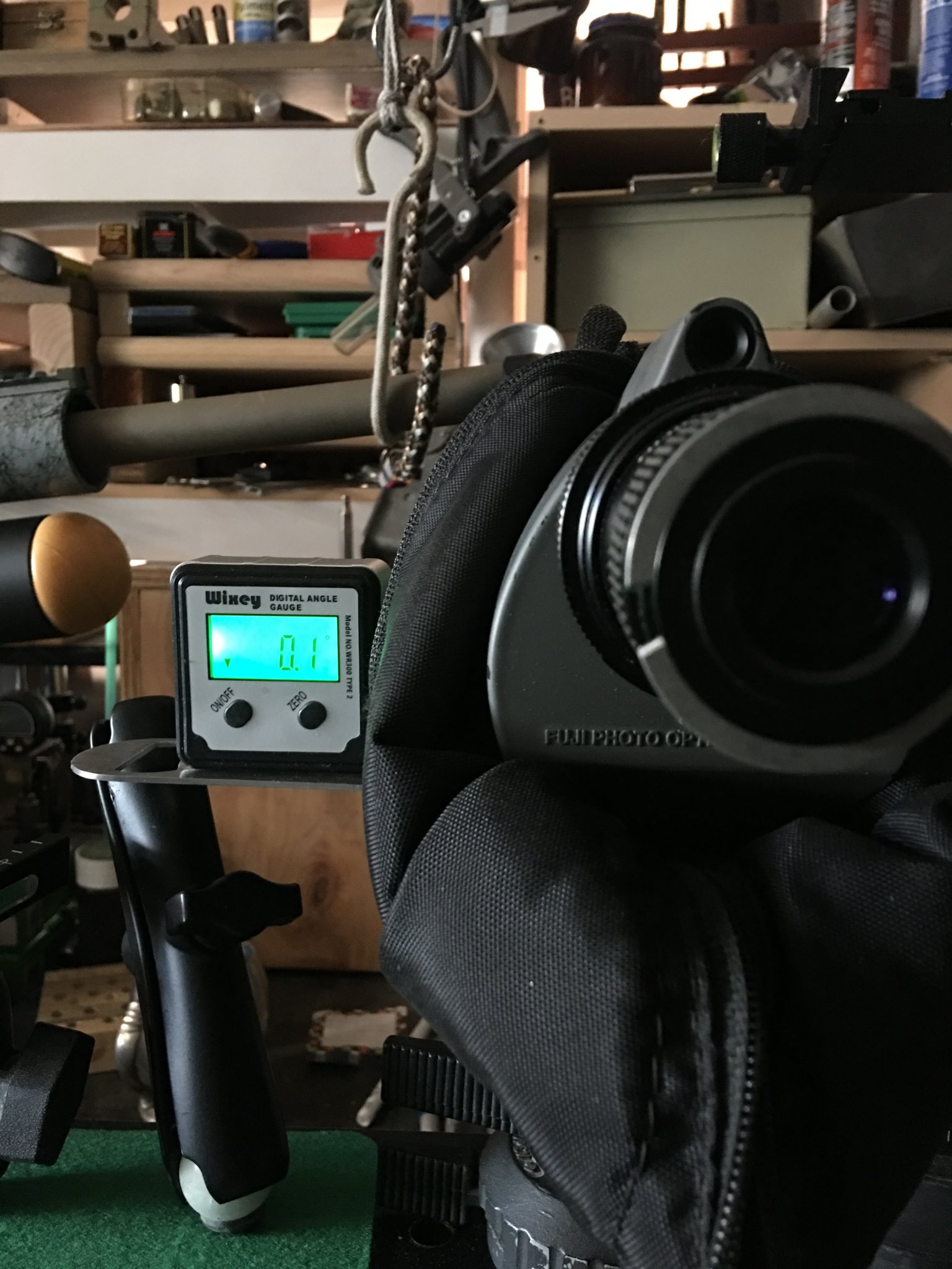

Attach a thin ferrous metal--magnetizable--sheet/strip/band between the quick detachable (usually Manfrotto or Swiss Arca) and the scope's tripod screw. Works great using magnetic levels and especially the electronic variety like the Wixey shown (attached).

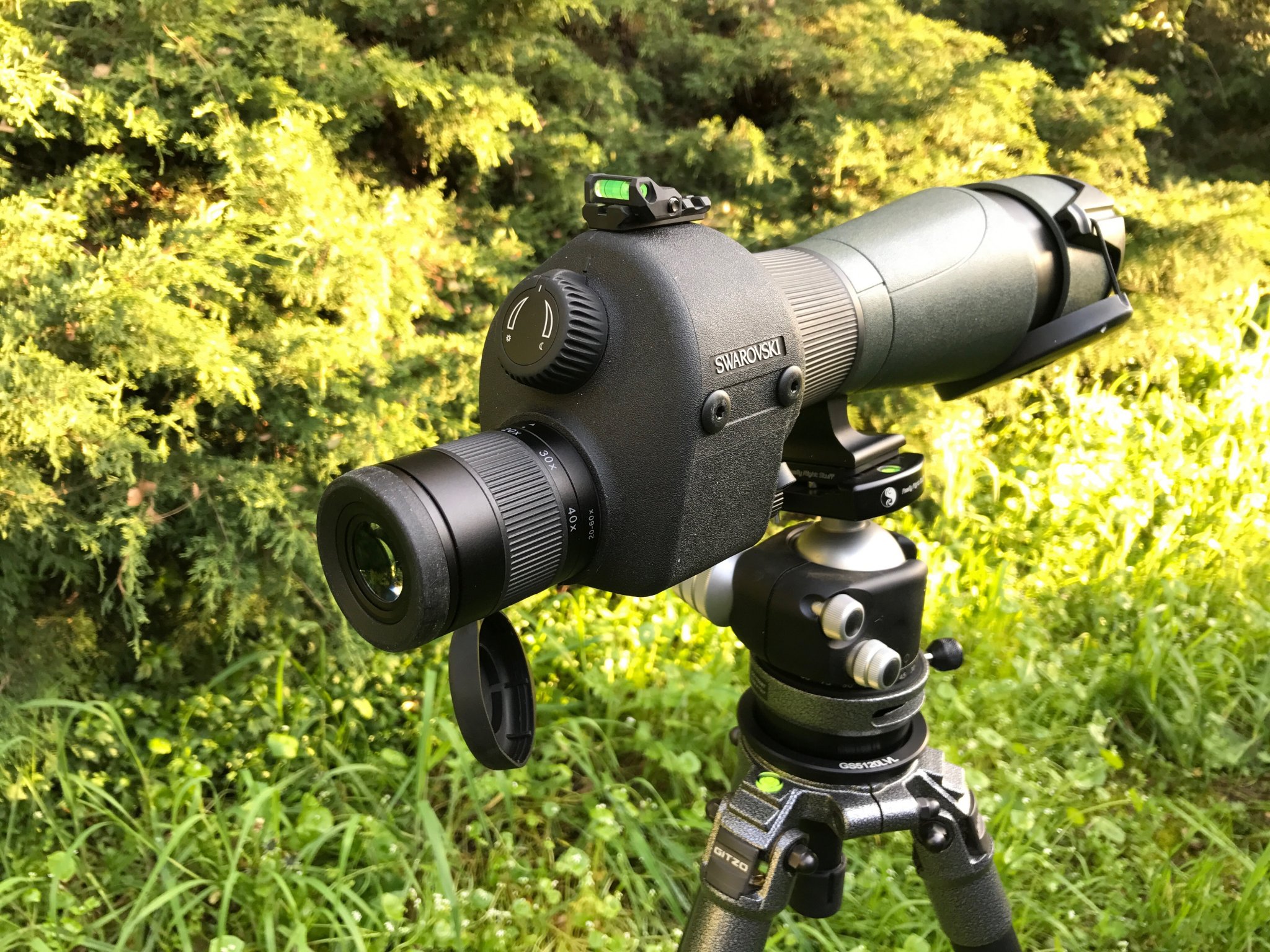

The rig in this picture is over kill. A level panning base and scope level is all that is required. I like to use the ball head to position the horizontal stadia through the target’s horizontal center line. Then pan the vertical stadia to align with the impact. Now the corrections can be directly read.
Cheers,
7054718
Quickshot,
What piccatinny base did you find to fit the top of the STR scope? I saw that Swarovski makes one, but the price was very expensive. Did you find another option? Thank you for your help.
Reactions: ManOfAction
Quickshot,
That is the Swarovski base; with a KAC level on it.
The bases are expensive because the kit includes two rails and screws. The top one has a sight cut into it. The side rail doesn’t.
Cheers,
