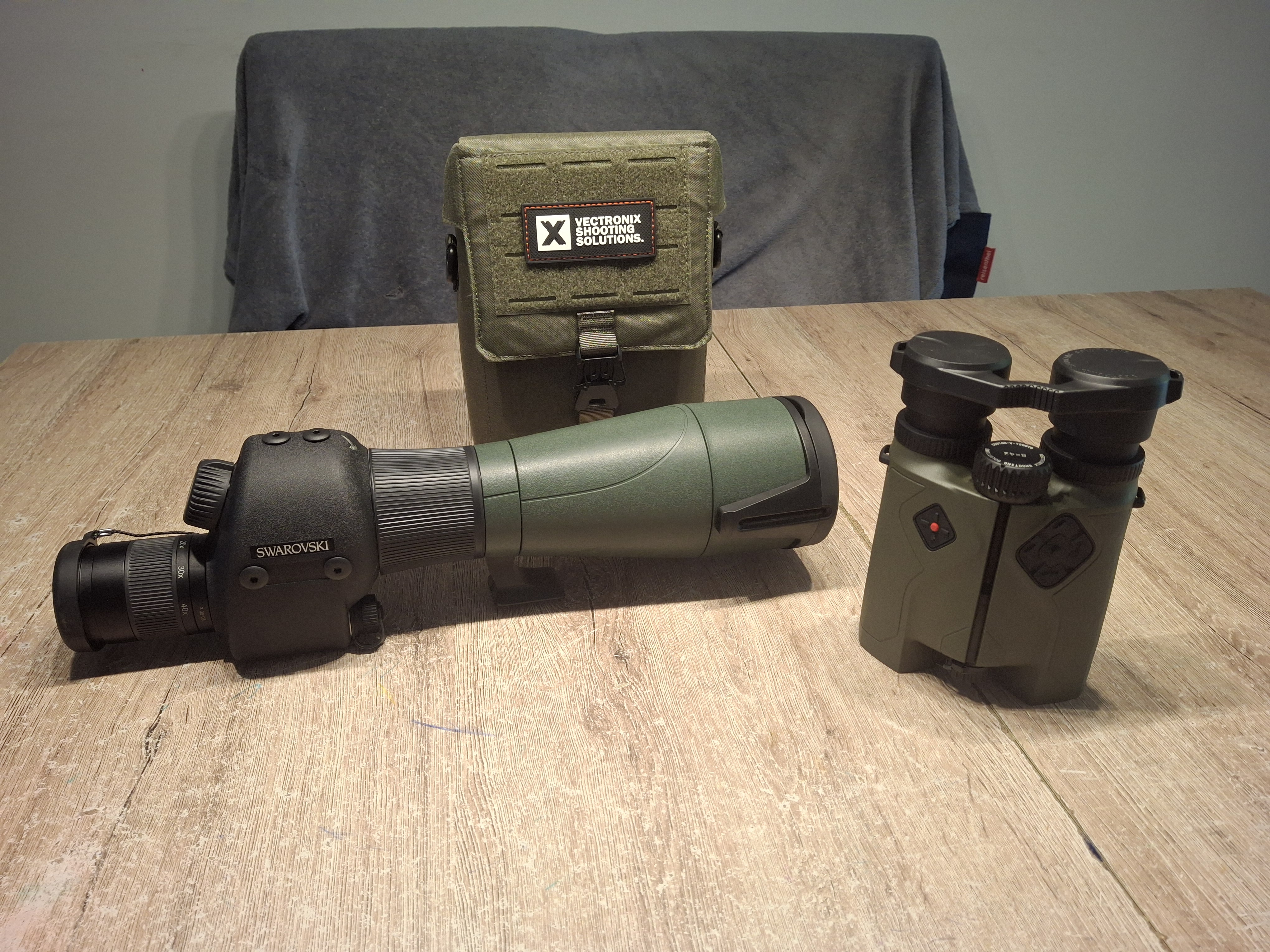

Buy the Swaro STR80. I’ve owned a STR 80, BTX 115, & I currently have a STX 65 plus Vector X 12. The STR 80 is heavy, but nothing compared to the BTX 115. You can turn off the reticle, which is really nice. The larger objective of the 80 vs 65 is better IMHO, & you can change out the eyepiece for a wider FOV. The Swaro would still have warranty service as well. I have used the STR80 to shoot steel at 1000y. I’ve attending LR classes years ago, where a Hensoldt was used out to 1000y. It was great.

If you gotta have a reticle, another vote for the STR80. I've owned that one, STX95, TSN-99, and the Hendsolt. Glass is fantastic in all of them, but the ability to turn the reticle off in the STR80 makes it the winner.

I've been using an STR for years, I like the hensoldt, but I liked the Swarovski. I enjoy being able to turn that reticle on and off and adjust the reticle brightness, i really like the helical focus wheel in the middle of the scope, it works better when wearing gloves. I've not been gentle with mine and it's held up fine.
