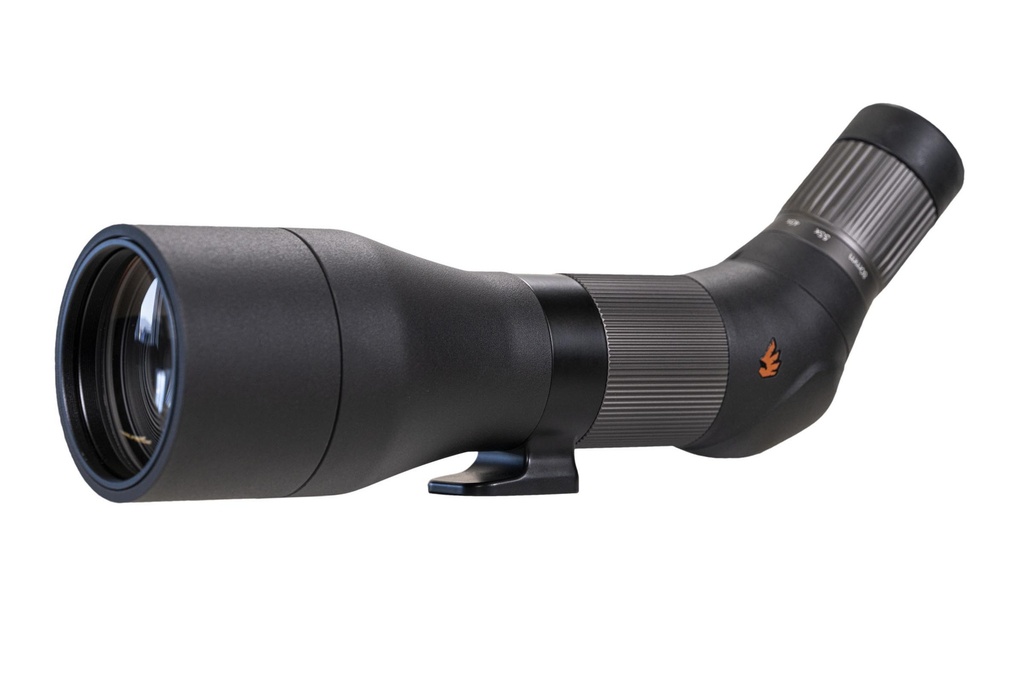

    Apparently, Tract offered a fixed reticle option, but it's no longer on their site.
    ETA: did some more digging and found a fixed mil reticle using a different link to the Tract site.

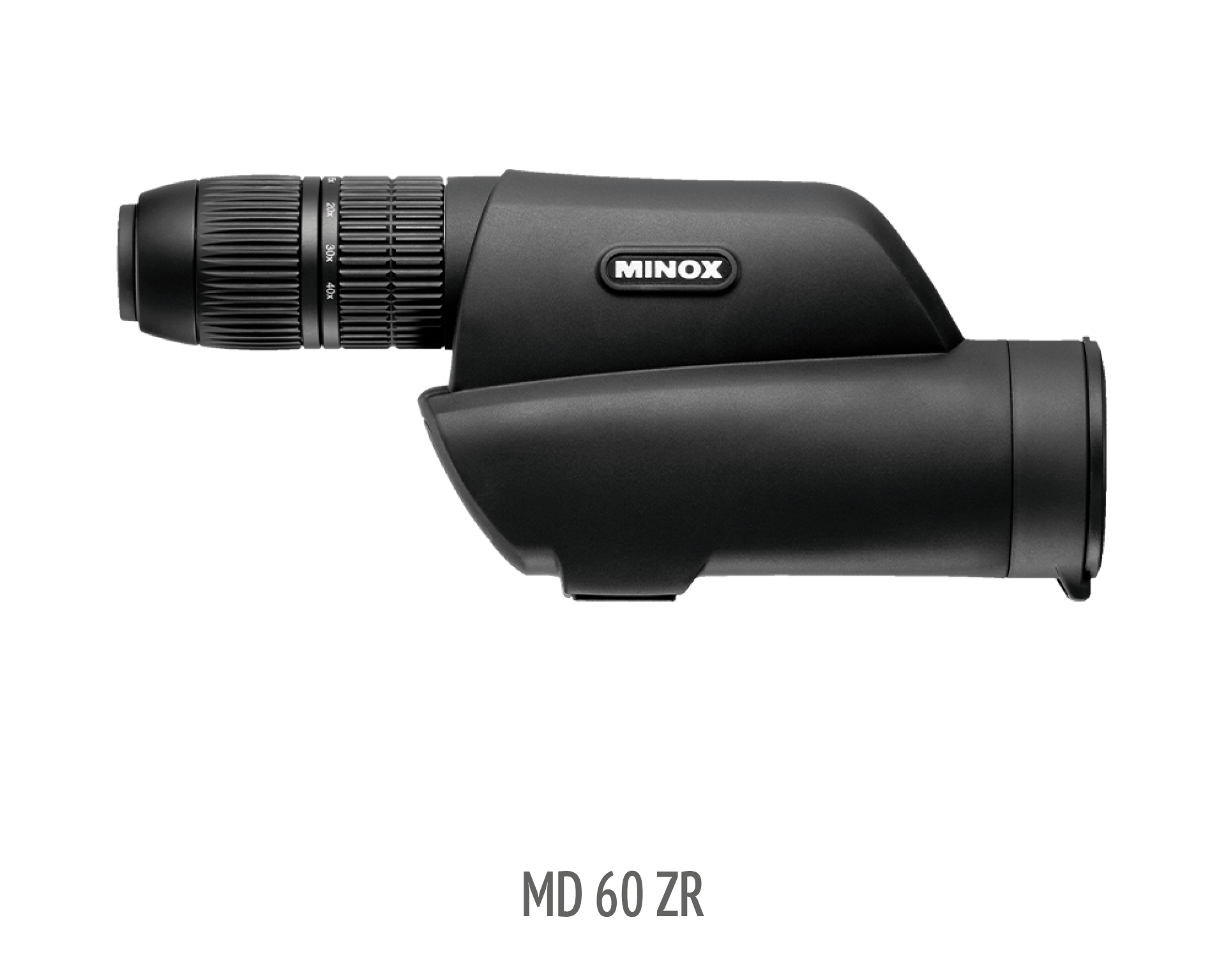

    Looking at the reticle in the Minox scope, it seems to be a good reticle without too much clutter.

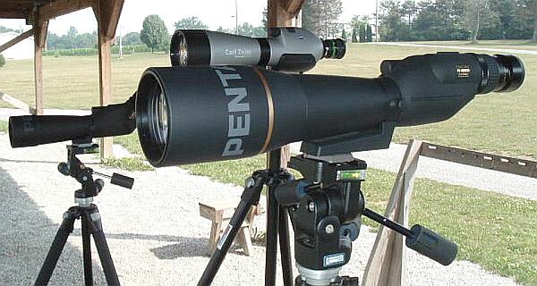

    If you know what you’re doing (I don’t) the star-gazing crowd has taken the Pentax spotters and added all sorts of weird eyepieces to them.
    See, the big Pentax (80mm, 100mm, the new 85mm) take standard 1.25” telescope eyepieces. I bet a machinist that mods telescope eyepieces could make many eyepieces work. You have to know something about optics/focusing too, obviously, so any old machinist won’t cut it.
    I hear some of the Pentax eyepieces are world class. Alway been tempted to buy the 100mm but prefer angled eyepiece setups.
