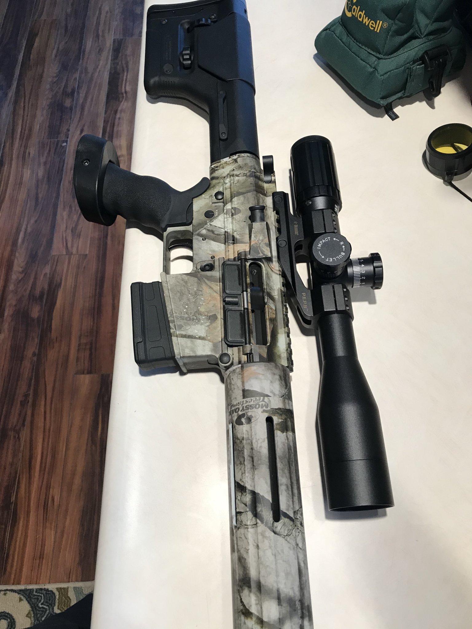

I have one of those scopes on my AR 10 so probably not relevant since you’ll want low rings on a bolt gun. Anyway, I have Burris PEPR Mount.
