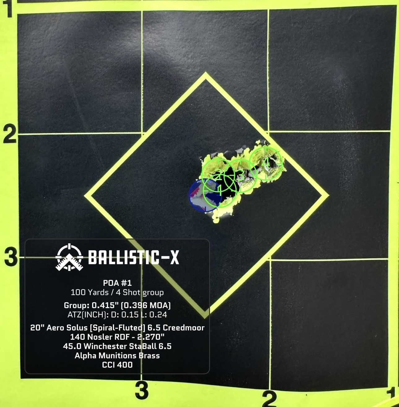

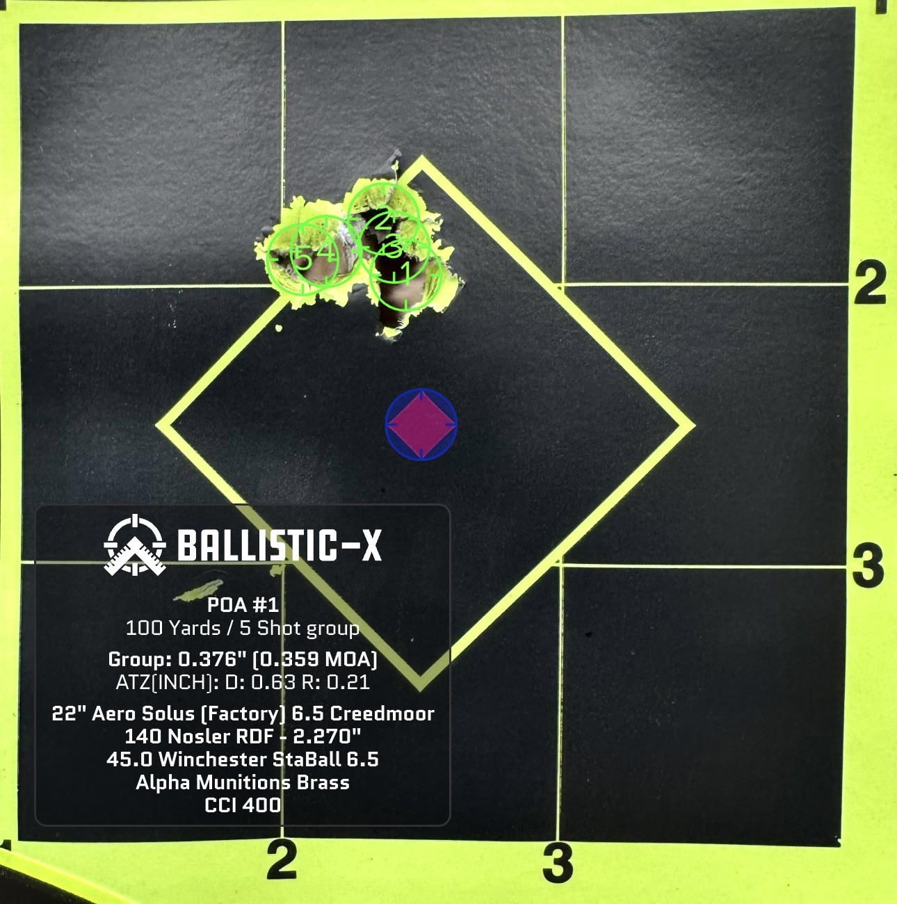

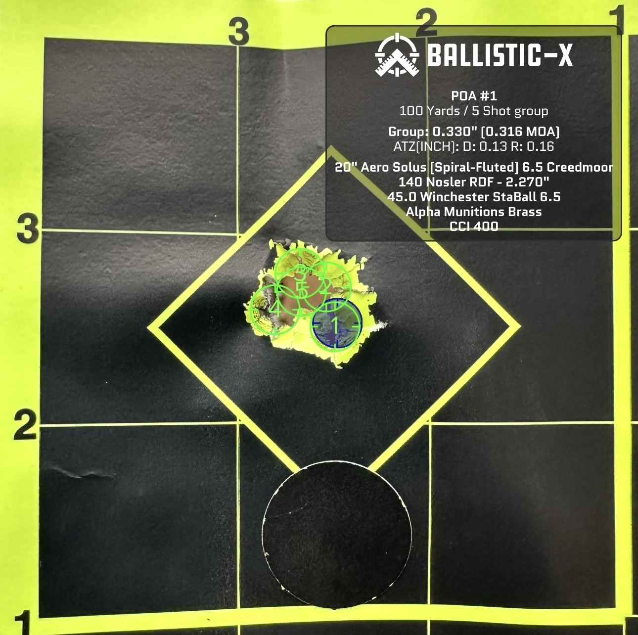

Aero Solus can be bought with a .478" bolt face, and then right now on sale you can buy BOTH a .382" and .540" bolt head for another $240. So you could swap anywhere from .223 to 6.5 PRC for an extra $240 on top of the cost of the action. They also take Origin shouldered prefits, and Savage small-shank barrels with nuts if you prefer to go that route. I prefer the shouldered prefits. You can also buy an action wrench from them for under $100, then all you need is a good torque wrench that will go up to 75-80 lbs. and a barrel vise. It's stupid simple to build and swap barrels and parts at home. Also, it has a tool-less bolt disassembly design, so you can remove and clean/service the firing pin by just twisting it just past the detent.
Are they as smooth as some of the higher priced stuff? Not at first, but they DO break-in, and several of mine that have a few hundred shots through them are butter-smooth. People will hate because it's made by Aero, and assume it's cheap, but they are actually really nice, and you get A LOT of action for your money. All of mine shoot amazing...

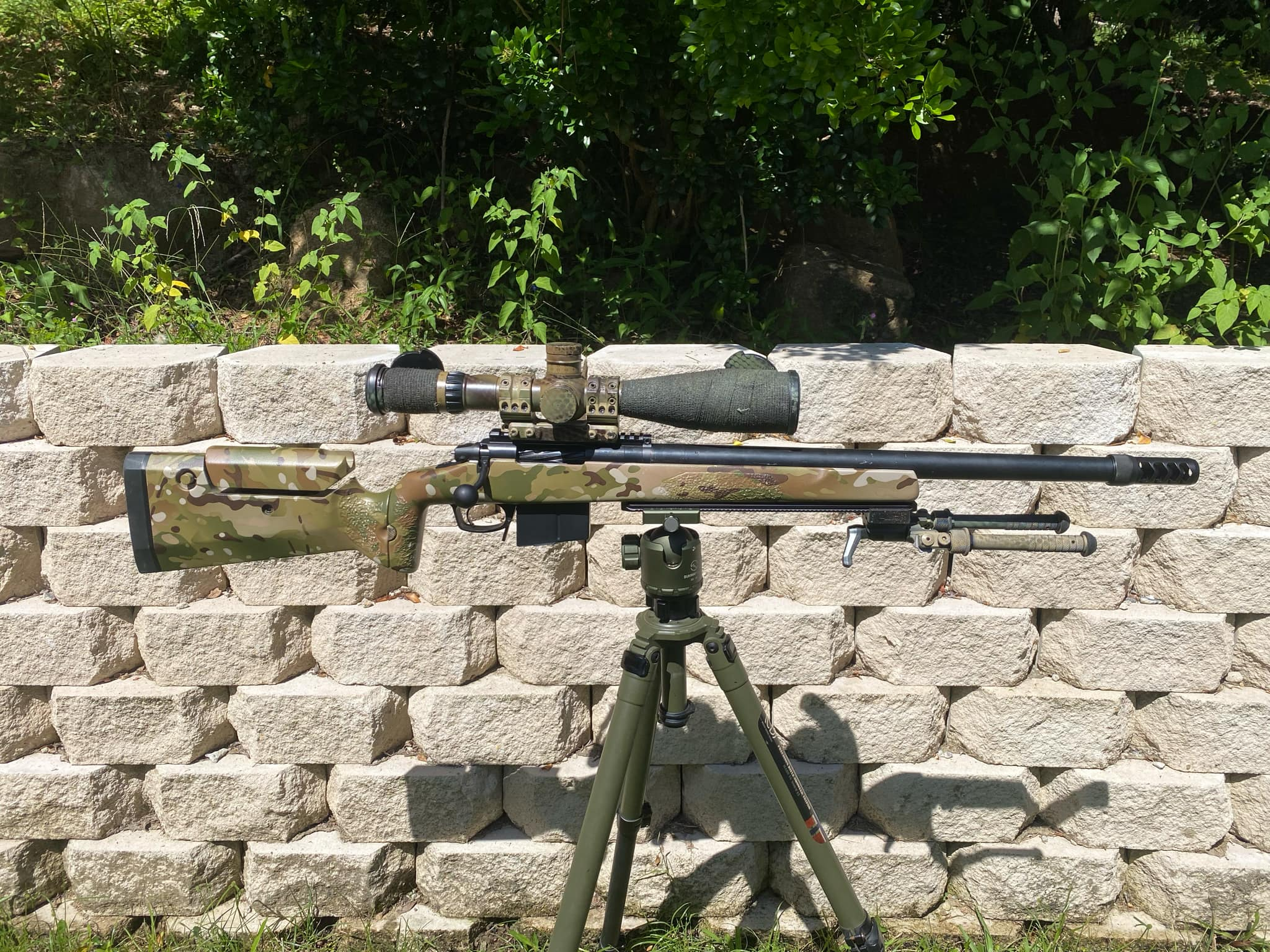

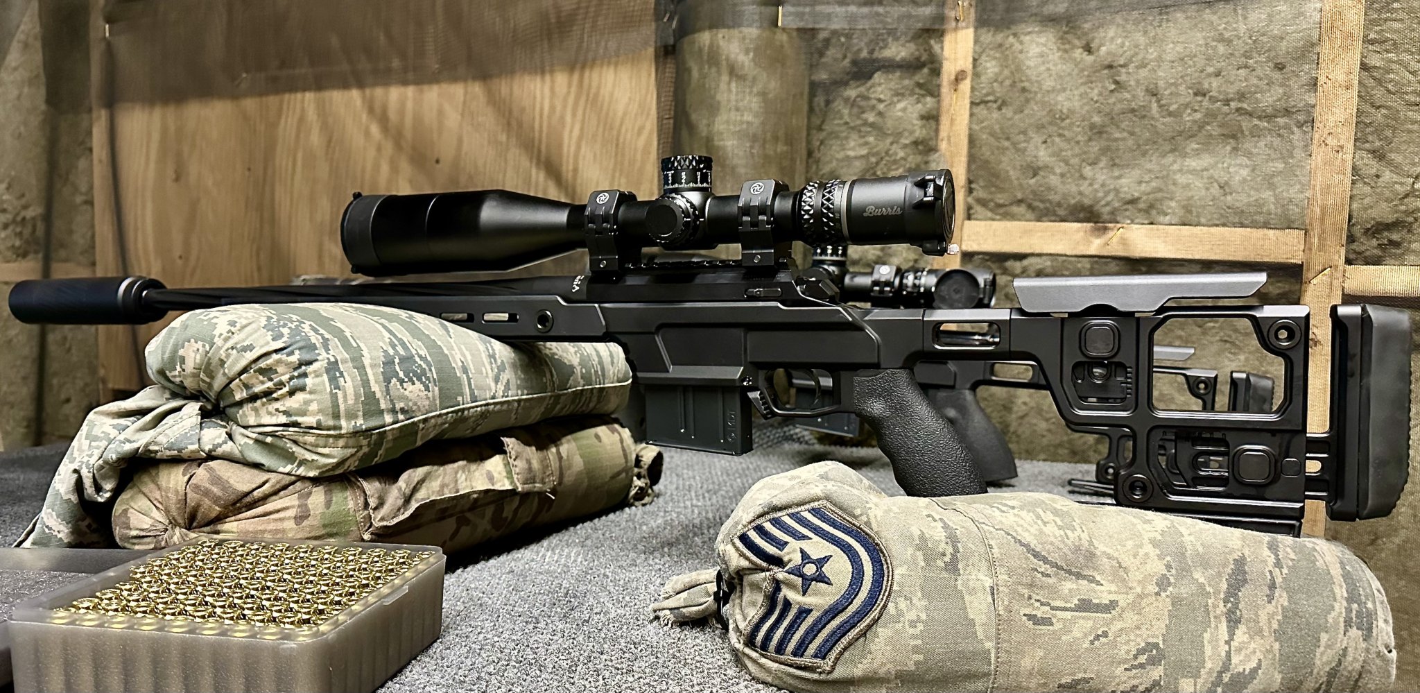

image_cropper_6F9908FD-0B59-467C-ABEF-81B0F1658A83-15323-00000CF398D5C24D.jpegimage_cropper_5E20E105-58E9-45C7-9BC7-7126BE276E8C-15323-00000CF4B7B8A4B1.jpeg

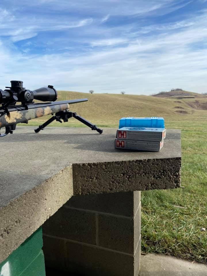

View attachment 8564058View attachment 8564061
I’m just glad to see someone else just uses sharpie to mark their barrels like I do. Lol
