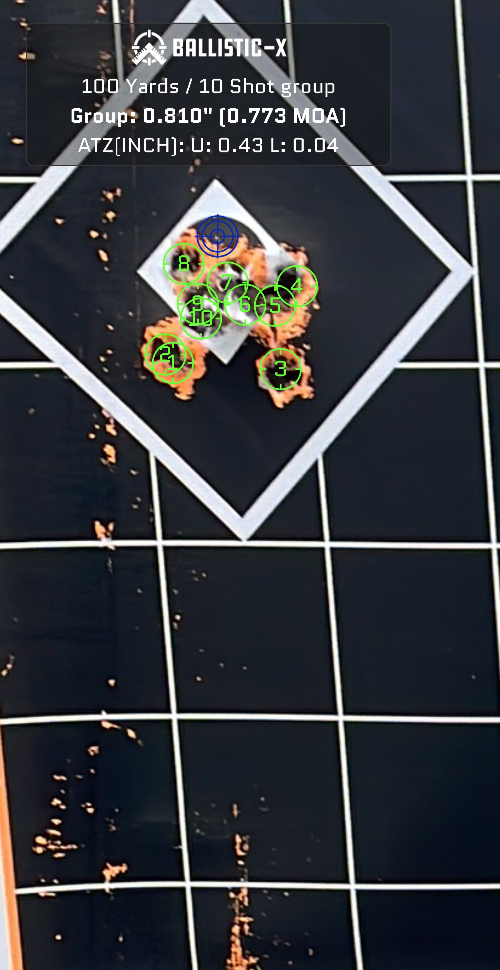

Bodem build some super awesome barrels 6 creed factory ammo.. zues qc
  • Ballistic-X-Export-2024-01-06 15:43:48.888010.jpg
