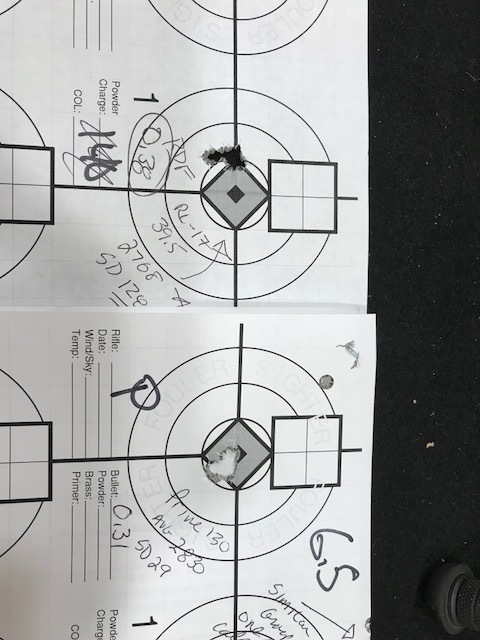

I just got my comp gun (Defiant) back from West Texas Ord with a Switch Lug and Hawk Hill 6.5/Bartlien 223--shoots great so far (See pic).
-- No load dev, juts some ammo I had laying around (and yes, this is 128 SD on the RDFs...but I didnt load them!)
A few thoughts;
- Swapping barrels with a vice is not a big deal; takes 5 minutes but I cant really do it at the range
- Switch lug lets me (or friends) use the 223 to blast around at the range, practice positional, shooting from props, varmint hunting, or just screwing around with my good glass, good scope and my comp gun. Then I can put my 6.5 barrel back on, reconfirm zero and go home. No running back and forth.
- The switch lug is just another option, and for me, makes life easier
- I do wonder about the torque...threads typically work best with some...I just "snap it on" a couple of times to be sure it is seated all the way and tighten the lug. Works fine so far.
I do know West Texas was simply AWESOME to work with, they do very good work, and Clayton and crew are good people.
