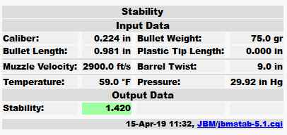

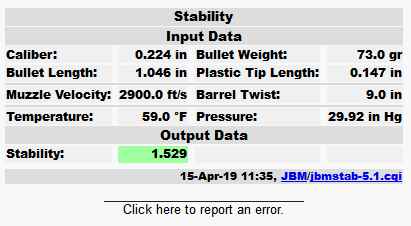

I'm shooting the 73's now in a 20" 1-9 twist. I'd like to switch to the 75 bthp because of the cost difference. You guys think I can stabilize the 75 in the 1-9?

Bolt gun. I was running the 73's because they had a bunch on the shelves local.Are you planning on loading to AR mag length or longer for a bolt gun? I don't believe the the 75gr ELDM's are designed to load at AR mag length (2.260"). They are very similar to the old AMax and need ~2.390" minimum. The 73gr ELDM's are specifically designed to be loaded at AR mag length. Just FYI.
Cool. I run both in my bolt gun with the same powder charge. I found the 75's don't like much of a jump, around 0.005"Bolt gun. I was running the 73's because they had a bunch on the shelves local.
Gonna try them over Varget because I can get it local. I'm switching brass too, my Win brass is done and I'm trying to decide on LC or GBW.The Hornady 75 gr. BTHP's are the best shooting bullets in my 20" 1:9 twist Remington 700 SPS Tac. I shoot them over TAC powder.

How did it go substituting 73gr ELDs with the 75r BTHPs?
Have a load set up with the 75gr BTHPs but would be nice if I could load some 73 ELDs instead for hunting purposes.
