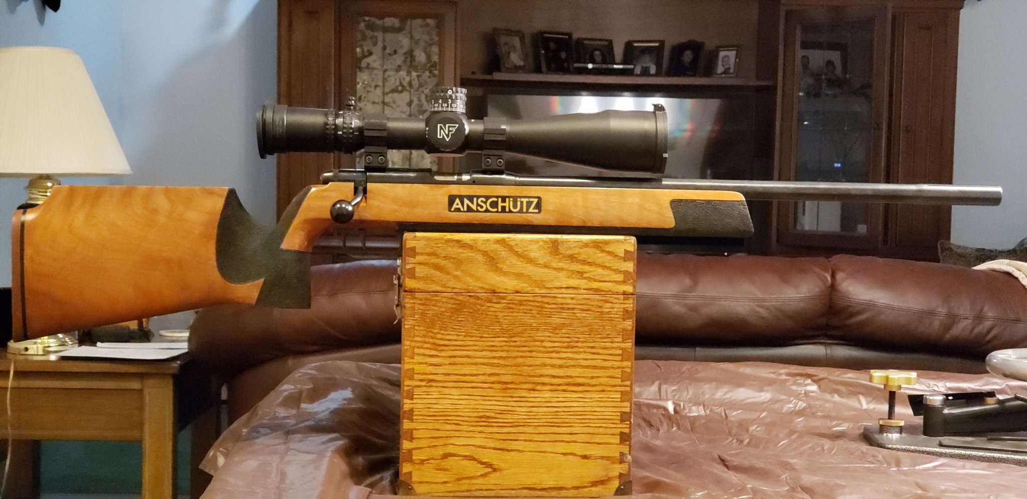

22 setup for ELR, 30 MOA rings with NF ATACR
Setup for 50 ft benchrest (NF will not focus at that distance)
