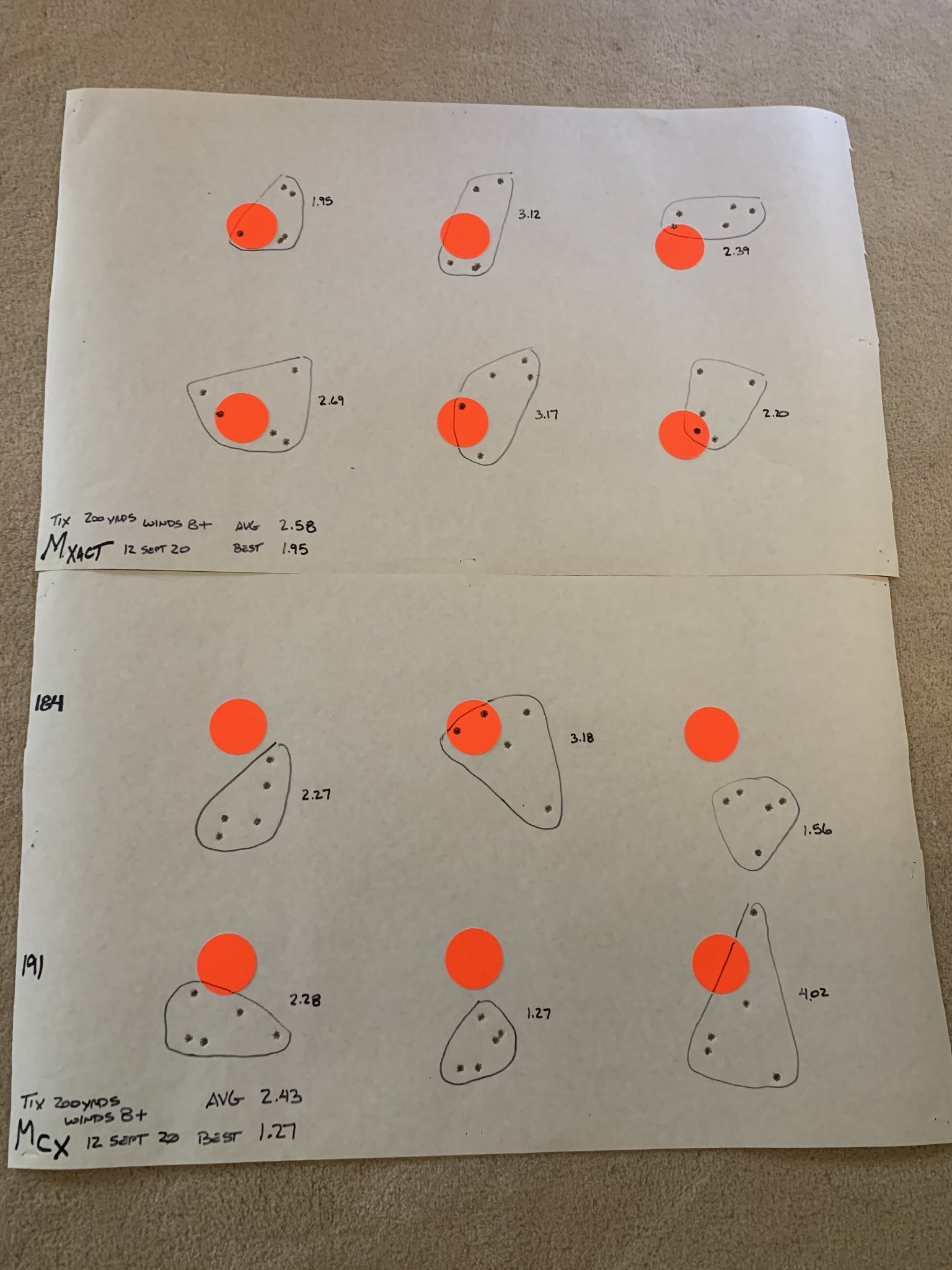

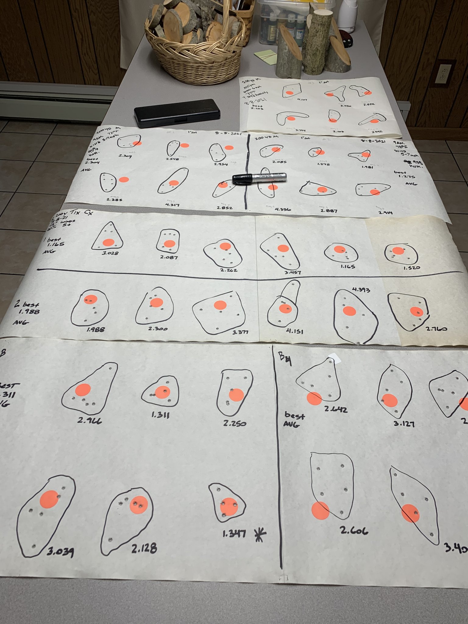

So today we decided to try out the Lapua Xact up against our 2 lots of CenterX we have.
Here are the results.
we both shot the CenterX per 6x5 rules just as a mixed lot. All 6 groups consecutive. ( just rolled right into 191 for group 4-6
as this is the first time shooting the Xact we were not sure where the POI would be so we shot some sighters and then shot the 6x5 using the Xact
you can see that we both seem to show that the Xact would not be worth the cost.
nice day today. We both won today’s shoot off. I can claim best average and she can claim best group.
anyway. I’ve been seeing lots of questions about how the T1x does with various ammo and wanted to post up our experience to day on A sample of 2 T1x
You both actually did very well at 200 yards with 22lr.
Very little lateral spread, mostly vertical caused by mv variations.
Typically I expect a total of 4 inches of spread from a box of decent ammo.
From a superb box of 22 lr, 3.5 inches.
If the box was damn near magic, 3 inches.
If you feel really ambitious, attempt 50 shots at a single aimpoint.
It will make you appreciate just how good y'er results are.
Well done to the both of you.

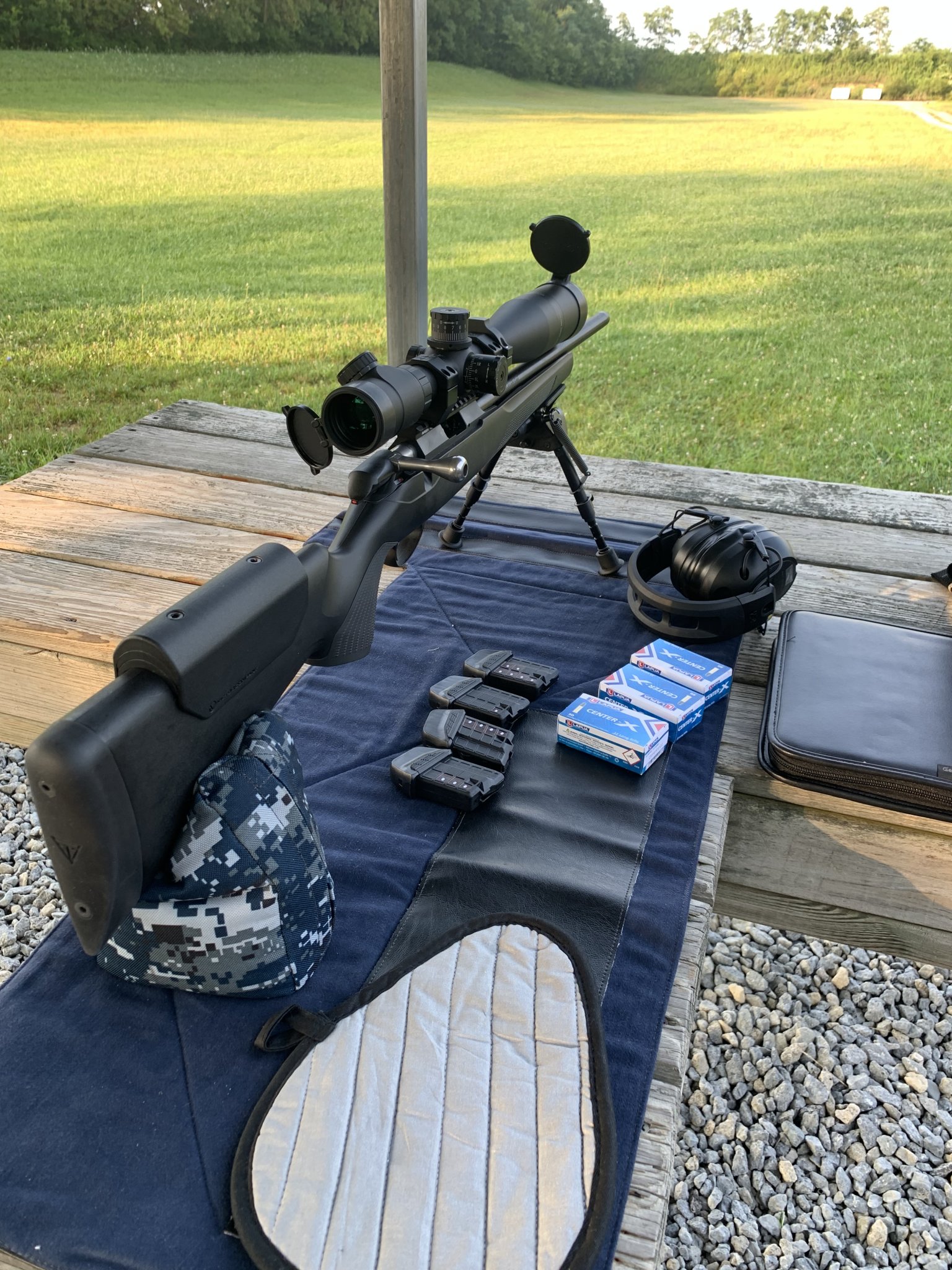

what you running for glass and rings on the T1X?
both guns set up the same
T1x is in OEM stock. Front barrel block removed and channel opened up a bit more for clearance. Front has 1 lb of #9 shot w/epoxy rear has 3lbs in mine , 4 lbs in hers. ( mine is neutral balance , hers slight rear bias Victor Titan rest. Tikka T3 butt pad. Tikka vert pistol grip
Harris bipod w/ podloc
scope is Sightron S3 6-24x50
rings are Seekins .97
area419 30moa rail
trigger at 2lbs mine 2.5lbs hers

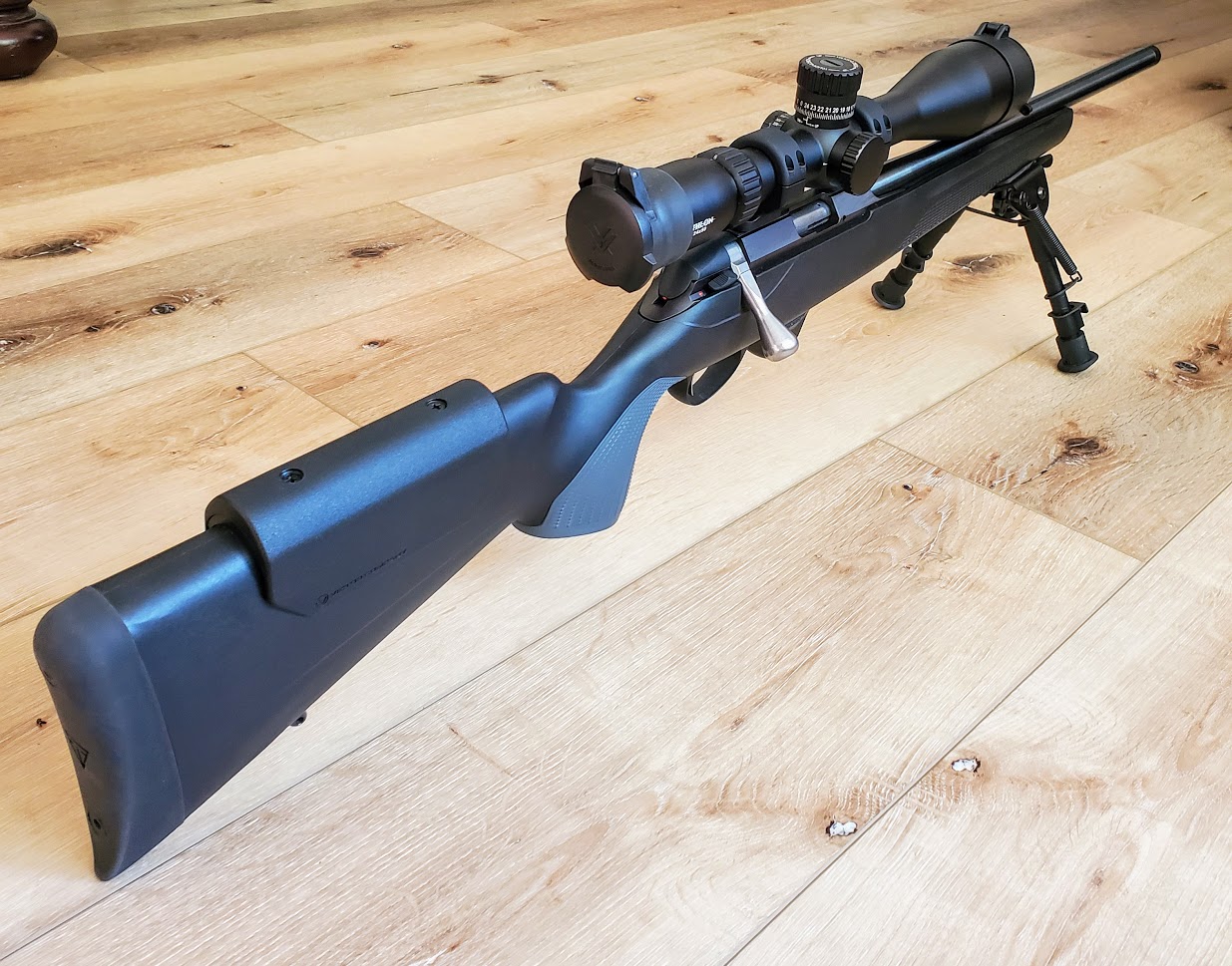

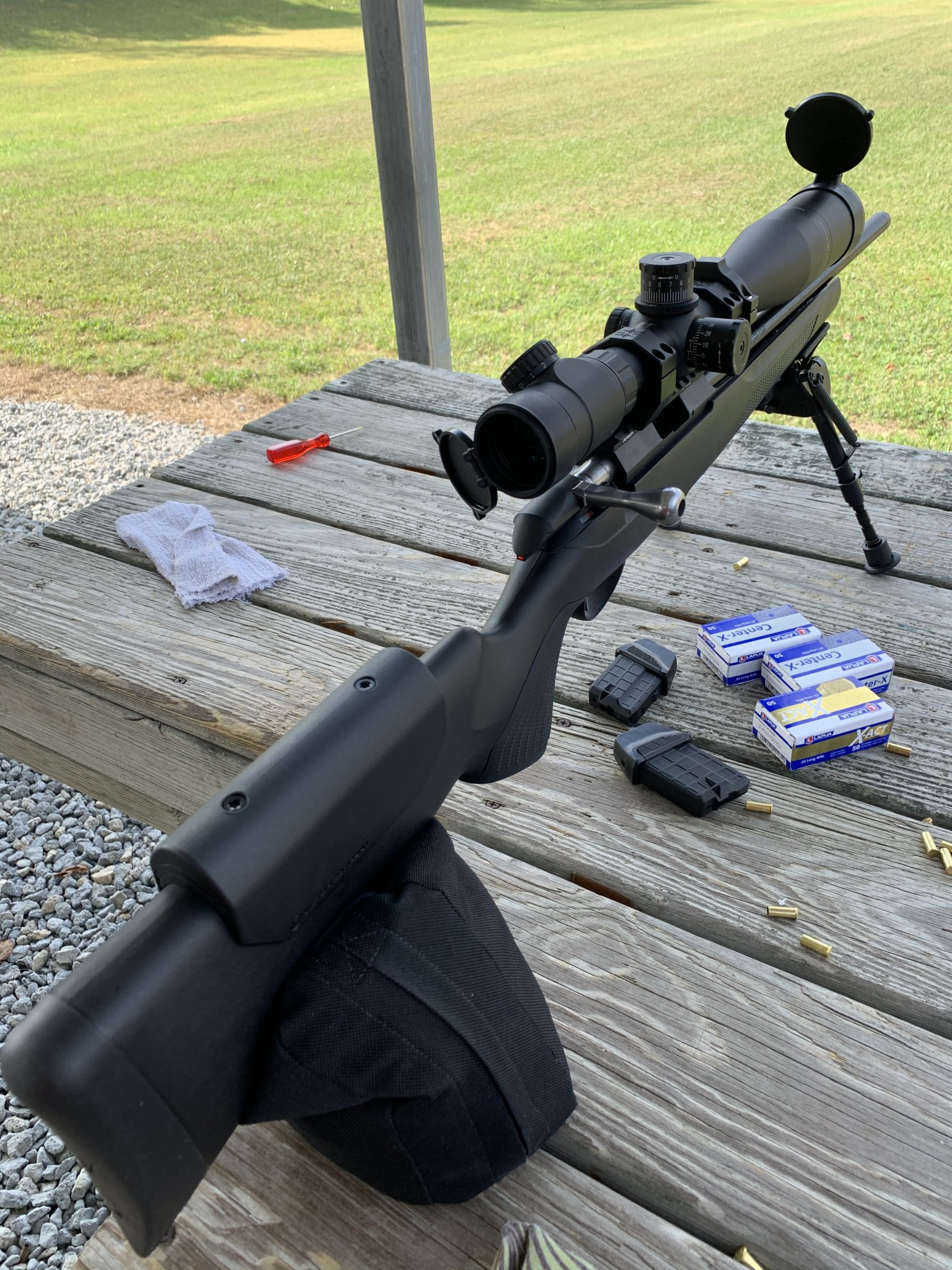

the cheek rest comes with a set of direction that if I recall correctly says to set it 1 1/4 inch back. I think I’m a wee bit back from that.
I’m using the 2 spacers that come with it and think sometimes about adding another
there are some things to think about with setting the cheek rest.
scope height for 1. This will be for you to decide how high you want the scope to sit up. There are charts to help you figure out what will clear this scope of that but there is more to it than just that.
you’ll need to figure out what is comfortable for you while shooting.
my rings are .97 to center while sitting atop an area419 30moa rail. With my Sightron 6-24x50 and the sunshade and caps on there it clears the barrel by about 1/8 inch
before I bought the rings I set the scope on the rail using pennies as a lift aid and had my wife steady the scope as I got behind it checking my neck placement / strain in prone / bench/ standing and kneeling and sitting to make sure I’m not having to tweak my neck to get a good sight picture
a straining view thru the scope isn’t something I can do for very long.
also you will need to figure your shooting garnets in the equation as well
if you set your stuff all up perfect during the summer , you may find that once you put a jacket on you can’t get behind the scope properly.
there is quite a bit to setting up a scope, rings, cheek rest etc.
Just wanted to mention that stuff
love the Titan rest. Didn’t like the cheap drywall screws it came with. Looks out of place on the gun
I went to Home Depot and picked up some nice black torx deck screws to mount it up. Looks like it was part of the gun now.

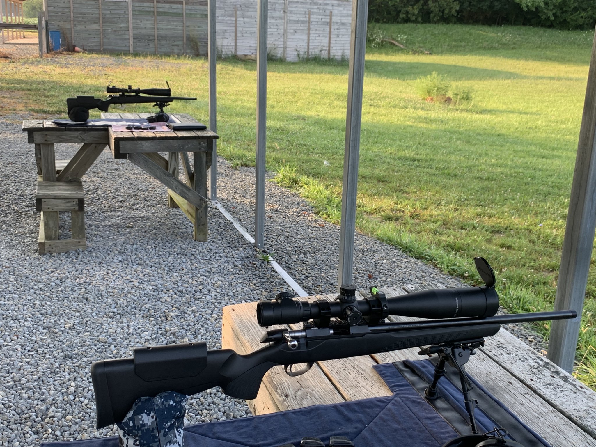

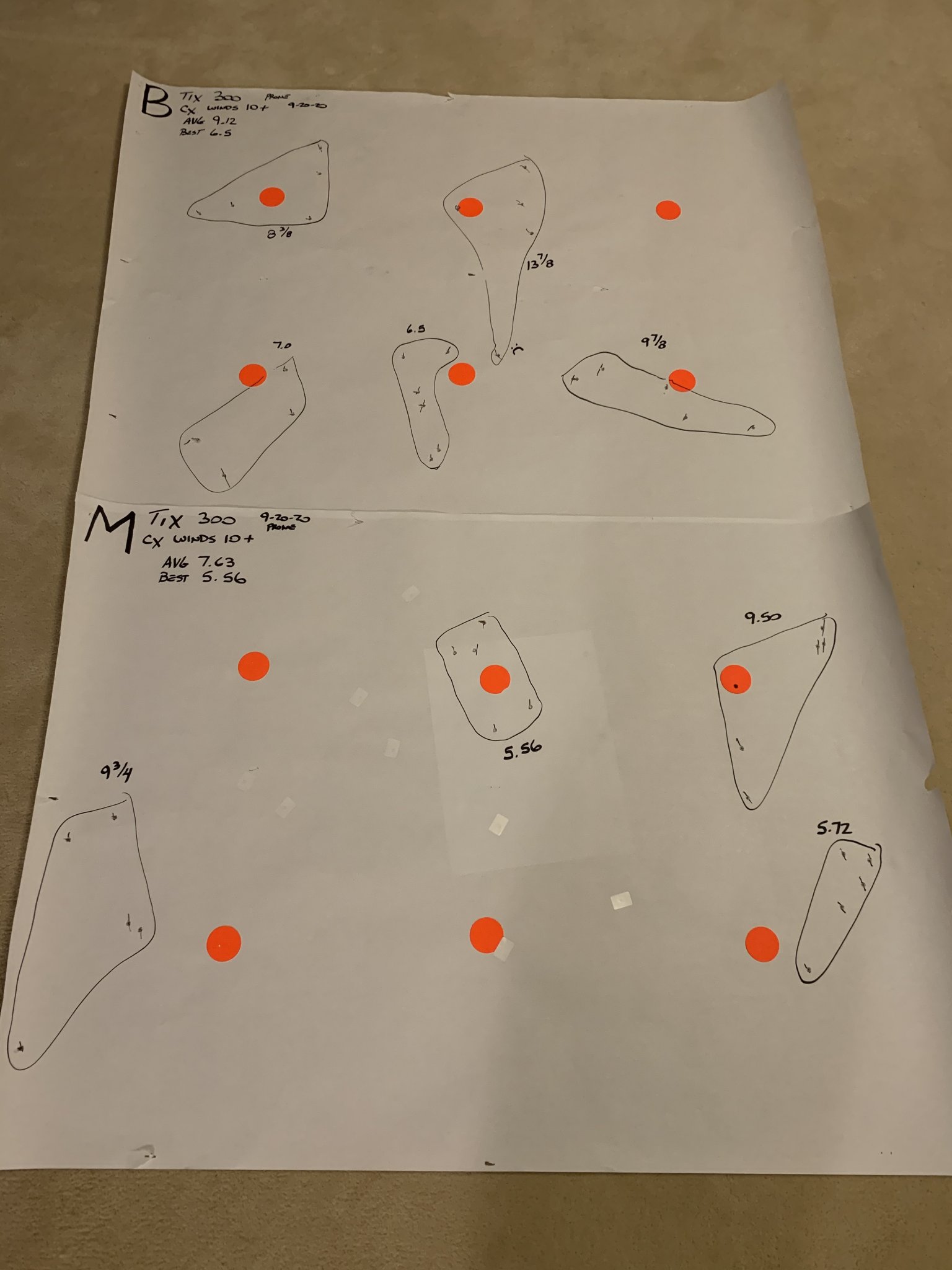

Today we got a chance to shoot at 300 with the CenterX. It was way windy today and we almost didn’t go but in the end we figured we would learn a bit and we did. These are the last of the shooting for the day. My wife ( M target ) shot 3 final groups for score. I shot 5 groups for score ( B ) target. In the end I was bested at our inaugural 300 yard windy shoot smack down. I’m doing the dishes tonight :).
I post these to help other see how things go as we learn the ropes on .22. We sure are having fun. My 1 group really had 1 come in low that messed up my average.
Enjoying your reports on the dual T1X's...Keep them coming!!! Beautiful little range and scenery...what part of the country you shooting in?
we are shooting in and around SW and central Ohio. These pics are from the Miami Pistol Rifle club outside of Cincinnati. We feel real fortunate to have good ranges here. We’ve had a great time at Thunder Valley and Rayners ( both within 2.5 hr drive ). as well as a few closer to home 0-300 yard ranges.
we learned a few things for sure yesterday.
my wife learned about multiple of 3 at 300 yards.
her target (M). Lower right group. This was shot using the middle bottom dot as POA. The dots are 12 inches apart. This was her first group on this board. She shot twice and in frustration asked me to spot with the spotting scope because she couldn’t see her hits on paper. I took a look and saw 2 hits way right. Asked her to shoot again. Now see 3 hits way right. Look at her scope. Yep ... 4 MOA right dialed in ( that’s 12 inches at 300 ). Told her to shoot 2 more but not to mess up as it would be a great group if she was consistent. She laughed and theM saw thru the scope where the group was. Then we talked about how adjustment had a x3 movement at the 300 yards we were shooting. We had talked about it but I guess it really didn’t register till then. Now she’s got it for sure.
I need to work on my prone shooting as I for sure wasn’t doing it all very cleanly. Also may need to figure out how to get my butt pad up about an inch higher. I may see about making an adapter to do this. I know a chassis would solve this issue but I’m trying to see if I can get this stock setup to work or not. ( just a strange personal challenge thing )

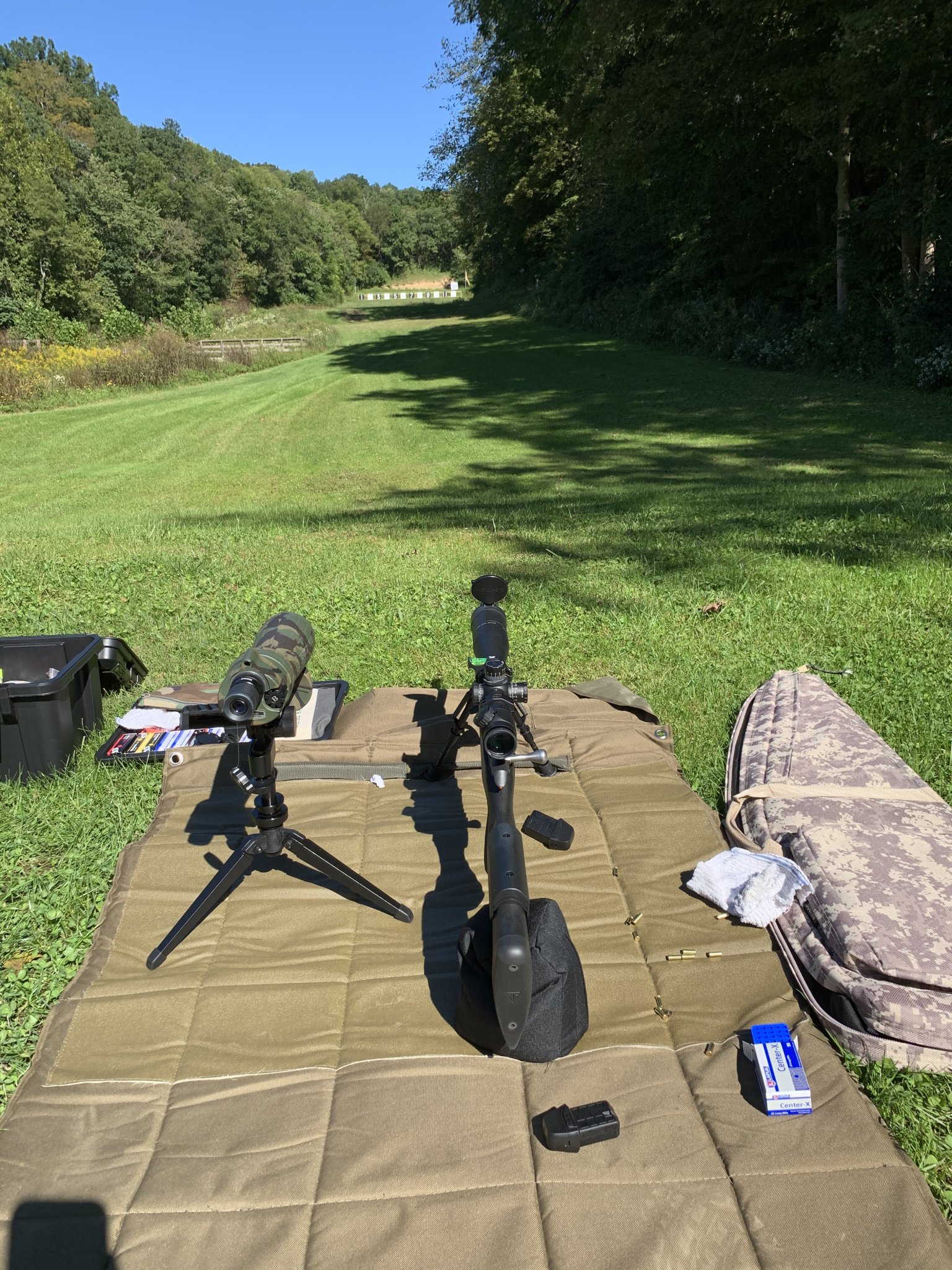

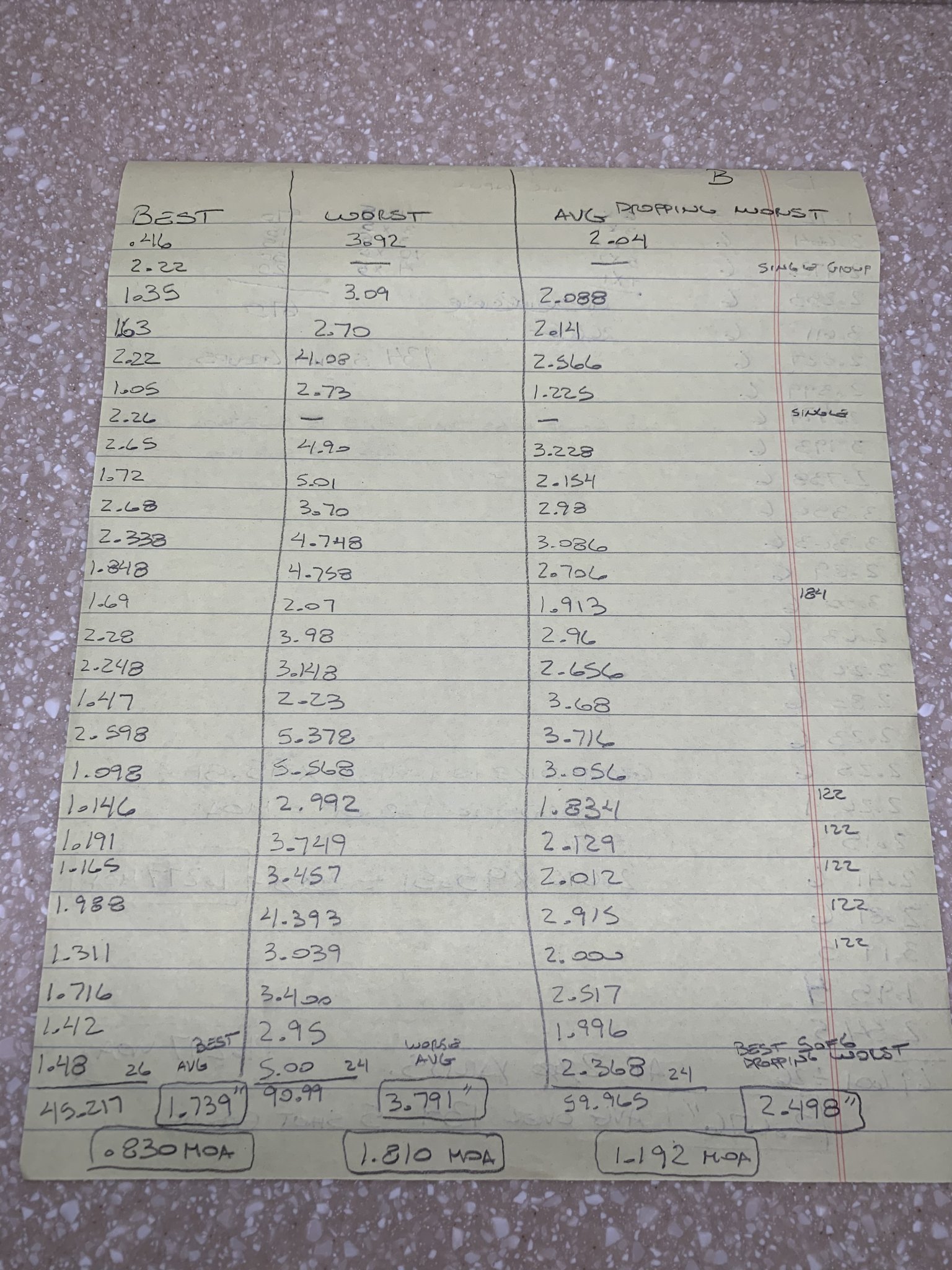

Here is a very windy 200 yard trip from a few weeks ago. Normally we would not shoot at 200 with winds like this but we were both interested in what would happen so we decided to give it a go. This is my target using the same lot 184 centerX as we used at 300. All in all I honestly was expecting it to look much worse. I didn’t try timing the gusts or anything. We had a wind flag at 200 but it was more for comedy than anything as it was pointing in every direction and never in the same location as was felt at the bench. 1 cold bore group then right into the 6x5.
Our guns have not been to Lapua for lot testing yet as we don’t have 1000 thru each of them. Just got this lot by chance. Lot starts with 23555 so it’s on the lower end of velocity ( no chrono to check ) Overall pretty happy with centerX
I will order up some Eley soon to see how that compares.
New guy question here, what is the multiple of 3 that you are speaking of?
sorry for not explaining that better. The scope adjustments are at 100. 1 click on my MOA scope is 1/4 inch of adjustment at 100 yards. So that same 1 click adjustment ( 1/4 ) moves the impact 3/4 inch on target at 300 yards.
so she had 4 MOA of adjustment dialed in on the scope.
at 100 yards that would move the impact 4 inches.
because we were shooting at 300 it moved the impact 12 inches. That’s the multiplier I’m talking about.

as for the ammo and performance. Our experience is limited to CCI SV, Wolf MT, SK Std+, SK RM, Lapua CenterX ( 2 sep lot #’s) and Lapua Xact. I will be picking up some Eley Tenex to try out soon. From that group of ammo we have found that we need to do our testing at 200 to really see the difference between them. What I mean by this is that for us, when the SK Std+, the SK RM, Wolf MT all shot very similar at just a pinch under an inch But when we stepped those 3 out to 200 is when we for sure could make judgments on how they were doing. For both of us the Wolf was consistent 4 inch groups at 200. So the Wolf MT is out for us. The SK Std+ and SK RM was interesting. My rifle shot the Std+ better than the RM. my wife had opposite results with RM performing better than STD+. I could cherry pick a group here or there where we could get under 2 inches at 200 but it was not the norm.
our consistent performer has been the CenterX. It was very obviously better at 100 than the other 3 mentioned above. It performed consistent in both of our rifles ( this is huge as I do not want to be stocking different lots for each of us).
the Xact shows good consistency but for us the price doesn’t justify what we saw for results. To be fair the Xact was purchased blind and has a lot # starting 24555. That indicates a slightly higher velocity and we do see it’s POI being about 1 inch higher at 200. I should have tried to find a lot of Xact with the same lot# starting as our centerX (23555).
that's a lot of writing to say that if it shoots great at 200 or 300 it will shoot great closer
if it’s shooting poorly at 50 or 100 it will shoot more poorly as the distance goes out.
I also believe in stepping the distance out as far as you can and shoot some 6x5’s on various days so you can see the performance pattern develop. We all get those nice unicorn groups but the bigger picture of performance comes from shooting quite a few on the same day if you can.
I didn’t mention the CCI SV as it was just bad at 200. No need to include it in our T1x shooting. I’ll keep that for the 15-22

Hello everyone. I wanted to update everyone on our Tikka’s over the last year. We shoot these at 200 exclusively and only shoot Lapua but the groups below include 4-5 diff lots. The most recent 6x5 posting is with our lot tested ammo. The guns are unchanged and still shooting great. We do have the occasional spent case to dig out of the chamber from time to time but other than that they remain flawless. I do plan to mess with the wire to see if i can get it to extract 100% but to date it just hasn’t bothered me enough to go there. . ( we are not yet shooting on the clock ). We did take both guns into the Lapua rimfire test facility and came out with a good lot of CX for me and Midas for her ( she is now registered here as ZenaWP(545’swife). Of course her gun liked the slightly more expensive stuff. The testing was very interesting in that it showed without a doubt that our 2 guns preferred different lots. We had a 3rd T1x there that day and it also preferred a different lot that our 2. They all shot great once that lot was found. Just interesting that 3 identical set up T1x’s would all favor different lots was a surprise to us. So we were shooting rounds of 6x5’s this weekend ( results posted ) and my wife said it would be good to average all our 6x5’s together to see what the overall average is to date. Her thought is that would show everything. The good, the bad, the ugly, good days and bad. Hot days, cold days, windy , etc. All groups were included. I see there is a running thread about shooting at 200 but since these results are a little off the criteria there we decided to not post in that thread.
For me. To date at 200 I have shot 134 groups. These were all shot using the 6x5 rules. That’s 670 rounds. When I average all those groups together I get an average group size of 2.676 inches. If I did my math right that’s 1.277 MOA
for her ( ZenaWP(545’swife)
She shot 83 groups or 415 rounds. Same scoring as me using 6x5 rules. Her average is 2.720 inches or 1.298 MOA
you can see that we are very close to each other. Our shooting skills are pretty evenly matched. The guns are also pretty equal in terms of accuracy. We will stay at it and post in here as we get more time at the range. We both agree that we are not shooting 100% clean so I’m not yet ready to say we have gotten as good as we can with the Tikkas. I have since given up on a chassis for these as they just shoot so good as is. Now it’s just me trying to do my best to see what these are truly capable off. We have had some great groups along the was but as everyone who shoots 6x5 it’s the average of 6 that matters most and I’m not yet able to have 6 flawless groups. That’s my goal. Shoot a clean 6x5
pics from this weekend. We had to pause in the action as these was cross traffic on the range. A mother and 2 lil ones.
Hi Folks. Both me and my wife are shooting identical T1x. We have both been working thru various brands and lots of ammo to see what works best for use. All along we were hoping to be able to shoot the same lot of whatever ammo was best just to keep ammo selections to a minimum.
We decided to go with the SK/ Lapua lines without really working thru either Eley or RWS
background is we bought these are .22 trainers for when we can’t get to the 1000 yard + range with our TacA1 6.5cm ( a bit of a drive )
so far we have been very happy with these T1x’s.
Our local range is limited to 200 yards and that is where we shoot these most of the time.
View attachment 7422179View attachment 7422181View attachment 7422184View attachment 7422186
Those look real good. I shoot a T1X factory barrel too. I’ve found 5 round groups from 50 to 200 do not represent the reality of ammo performance. At least 10 rounds per group are necessary to get a good look at what I can expect. I do also usually track the group size minus 10-15% flyers because shooting steel in matches would mean 85% hits. I’m constantly “calculating” practice ammo cost vs results. Lots of quality trigger time time is key for consistent performance , I find.
Wow that's some impressive results 👍
What kind of SD and ES are you getting with those groups? Gotta be unreal...
With my experience I'm not getting anything consistent @100m less than 1,5moa. @166 we are talking 4" verticals at best😱
lapua wax coated or sk's slug slime either shot really well for us It's all a matter of which you can get in the quantity your happy with hope your gun likes them for years to come .thanks for the post .
Thank you
I can speak to the SD or ES as we don’t have a chronograph to measure that with.
we still think that the groups will tighten as we get more consistent with our part of the shooting. I’m still having to work on my NPOA as I find myself pushing the gun into position from time to time.
we both seem to have 3 or 4 really good shots and then 1 just is a bit off. It may be the round or maybe it’s us. We aren’t ready to for sure blame the ammo just yet. Don’t get me wrong. I’m all about the excuses 🤪.
This is a pic from Sunday of all of our groups. Most were pretty good but there were a few that opened the averages up.
After perusing the results, it ain't all on you. Some is wind, some is shooter caused,
but most of what I see is mv spread and bullet defect caused strays.
At 200 yards, that extended time of flight, allows even the smallest bullet irregularities
to cause spin related trajectory wobbles that push 'em off line.
I'd like to see a few 50 at 200 yards, also.
But I might be biased. ;)

This is next up on my rimfire to do list. Ever since you started that 50 at 200 thread I’ve wanted to give it a go. 😁
Thank you.
Your reply has had me thinking quite a bit on how I’m keeping track of our performance to date and what it would look like if I subtracted out a 15ish % flier factor. Only way I could do that without going crazy with a calculator was to drop the largest group. I know … not the same but an interesting exercise for me anyway. Much caffeine and some free time made this possible 🤪
the results I have posted above include all the groups. Ugly ones and all. Always held on the same POA. Never tried to fudge in order to tighten any group up
you got me curious on what the best of the groups would average out to show. That led to pulling out the worst and averaging the best 5 out of 6. Then pulling the worst out of each 6x5 to see what those look like.
So… here goes. All shot at 200
if I pull the best groups out and average only those. These being the best of the groups over the last year in all conditions using a bipod and rear bag I get an average of 1.739 or .830 MOA.
using the best 5 out of 6 ( tossing the worst group ) I get and average of 2.498 or 1.192 MOA
using the worst groups and averaging those I get 3.791 or 1.810 MOA
Anyway. Just wanted to post up something I thought was an interesting way to look at our performance to date.
when I started shooting rimfire at 200 I really didn’t know what to expect or what the limitations were going to be. I keep learning as I go and hope maybe someone else can pick up a few things from this thread. Looking at the 6x5 thread will show folks best to date shooting but not what’s going on in between.
here are the numbers if you are interested in the details.
