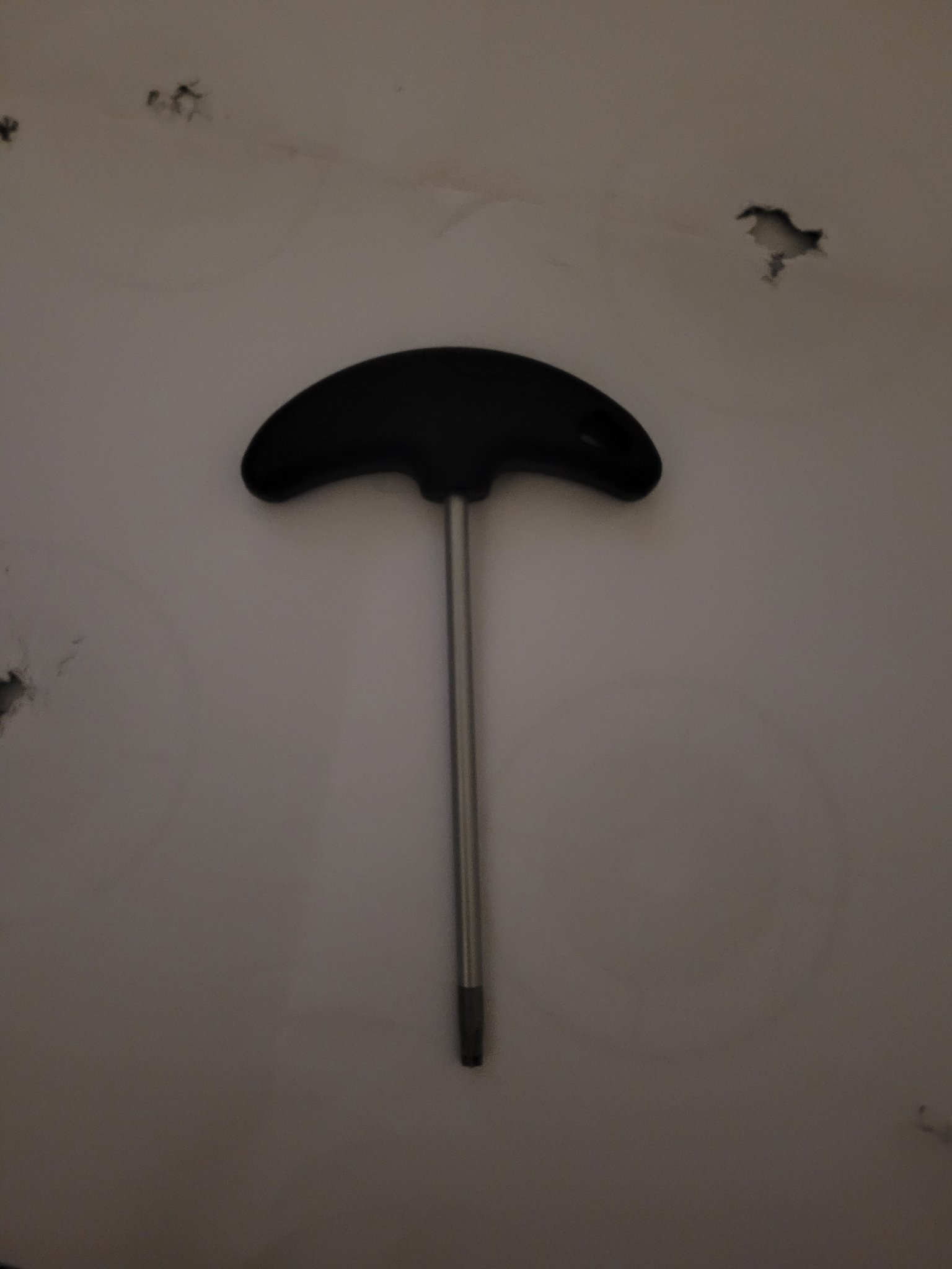

All screws in chassis are T25 Torx, they provided a T handle wrench which is nice (the only other thing provided in box was 2 QD swivels).

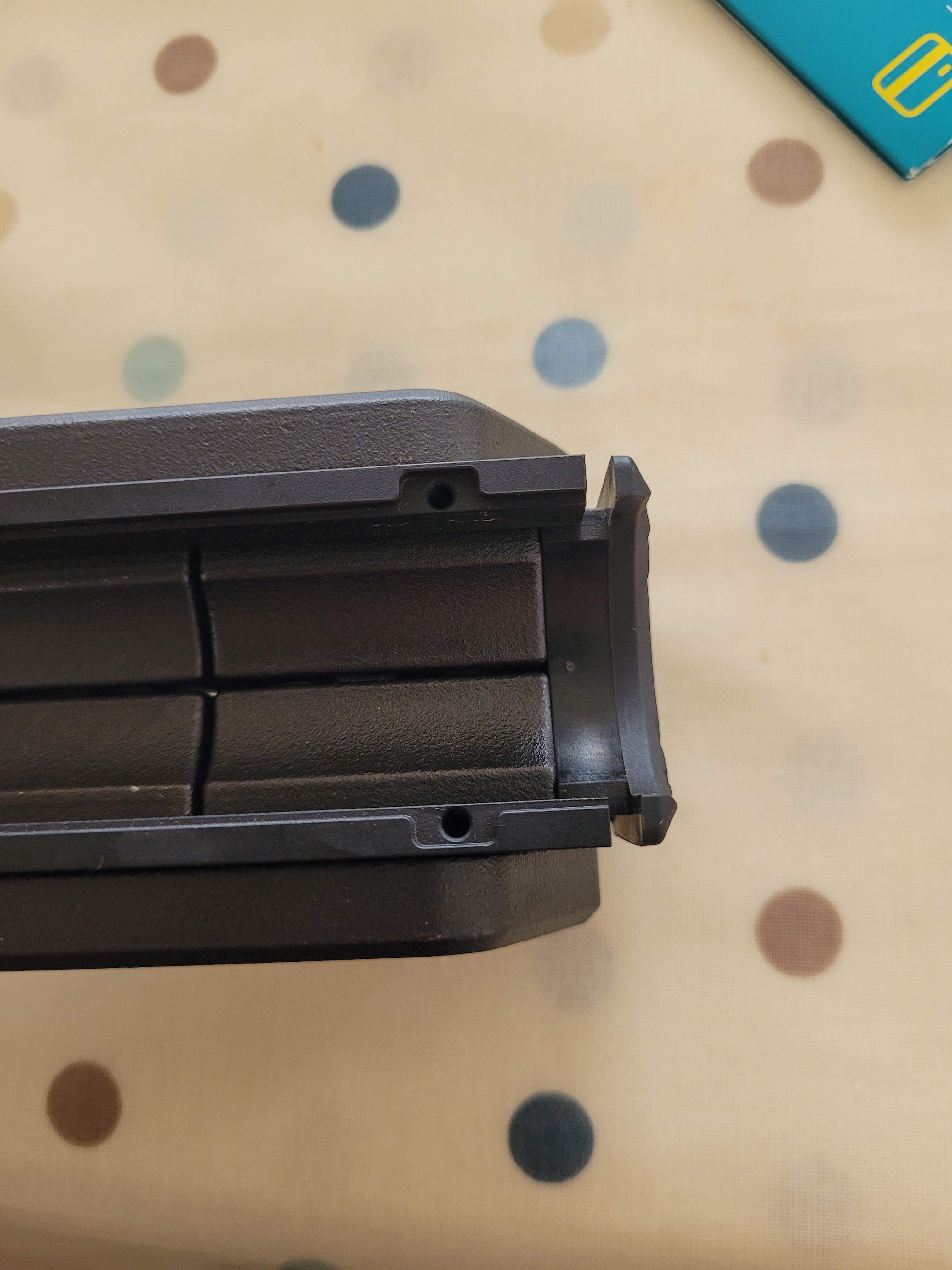

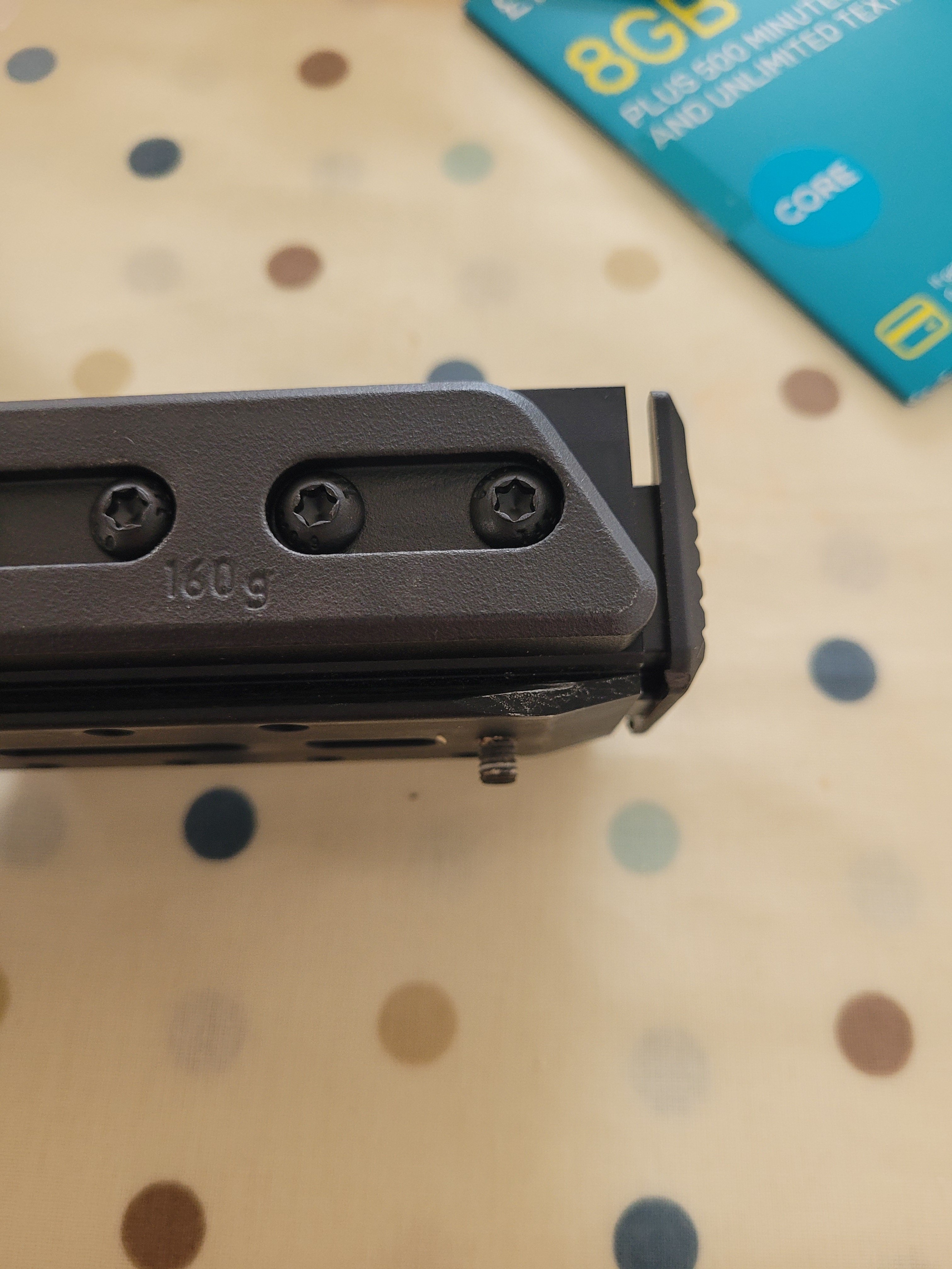

Forend:

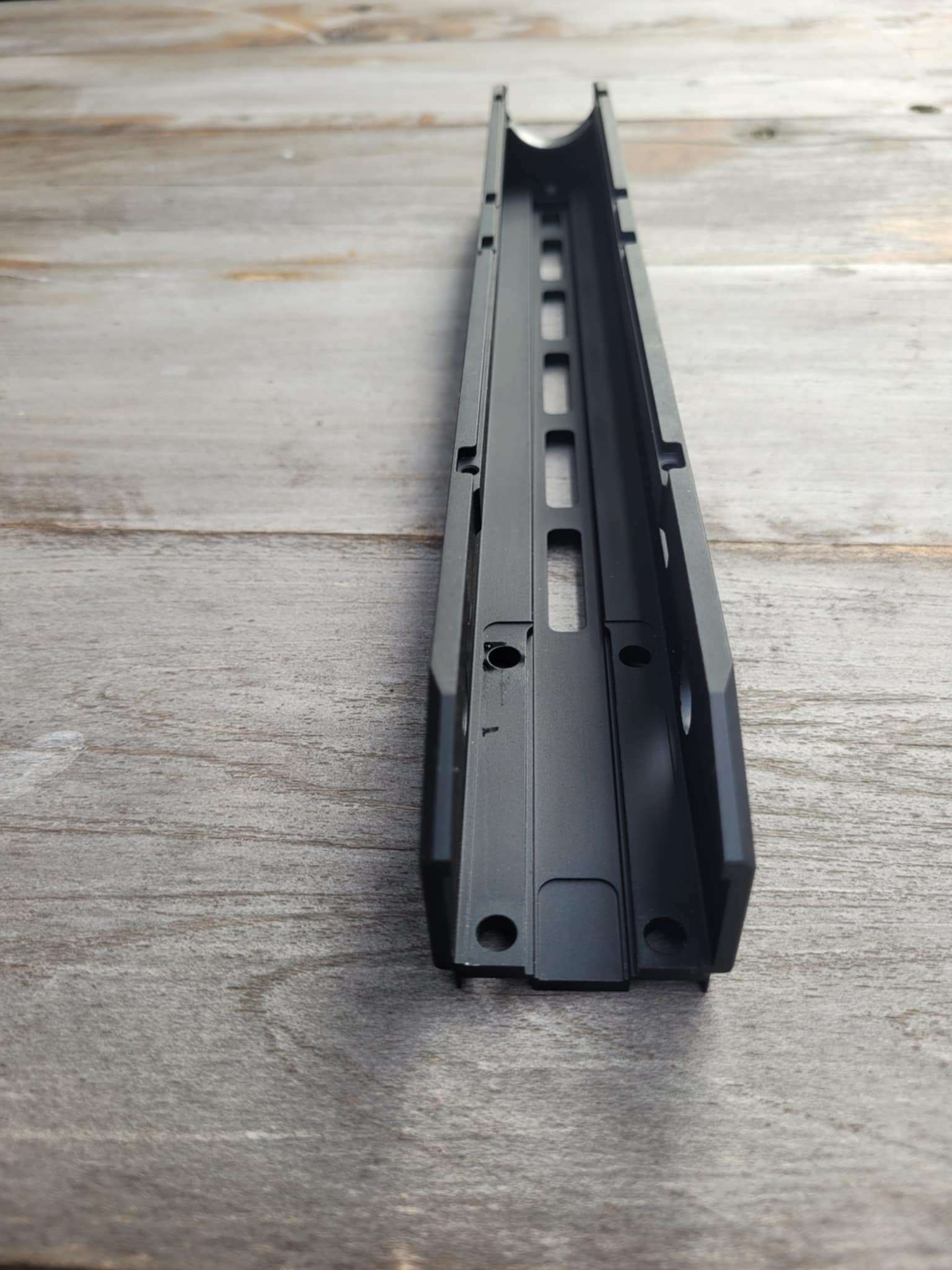

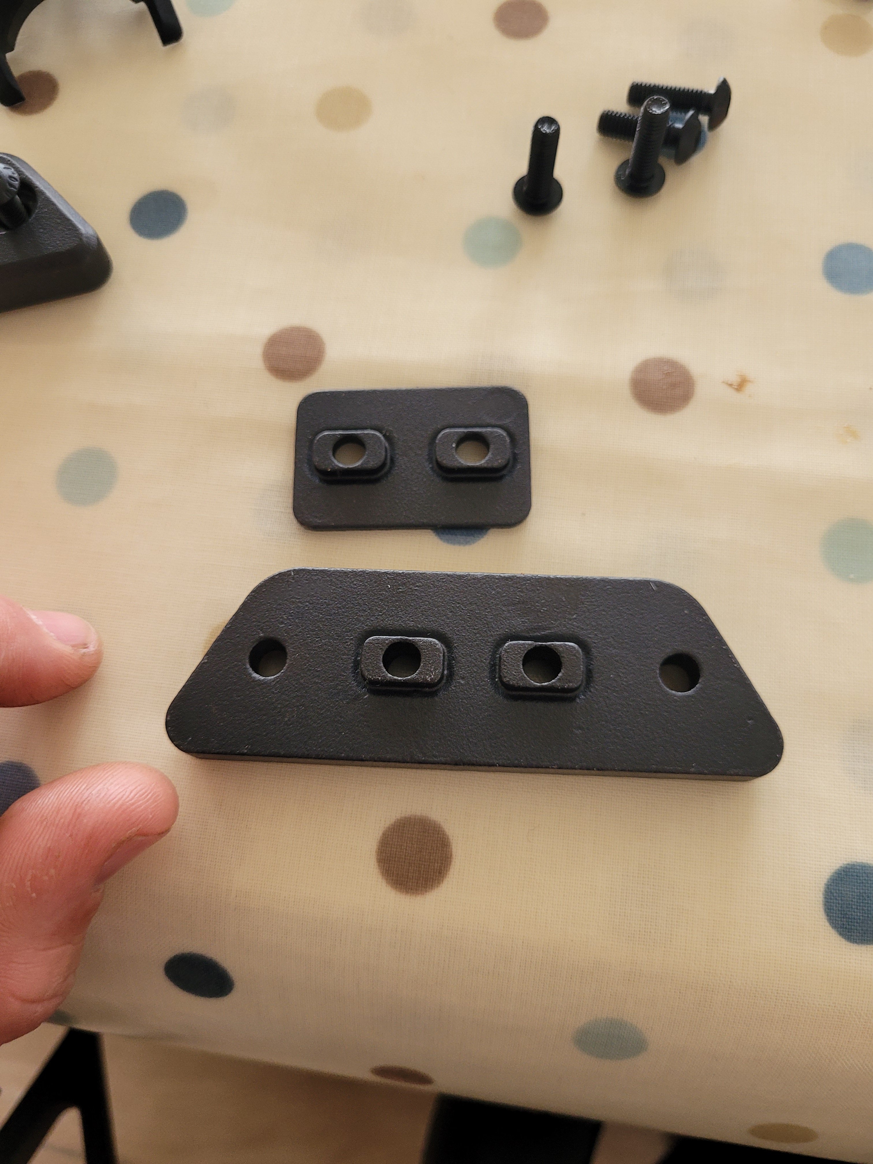

The Forend is very securely attached. It has 4 screws on the bottom and the two QD cups (not just the screws) go through the forend and give it almost no slop, even with the 4 screws removed. I know people were worried about this, time will tell if it's good or bad but initial thoughts are it's well thought out.
There is a lot of real estate on the inside of the forend for additional weight, Tikka say weights will be available that fit in the Mlok slots, they are 200g (about .4lb) each, so the 7 slot forend will be able to fit 1.4kg (3lb) of weight which is a lot. However they should just offer a steel forend (since they are swappable) could probably get it to weight around 2.5kg (5.5lb) and still keep the Mlok slots available for more weight.
I doubt this would ever be offered, but could be an aftermarket option.

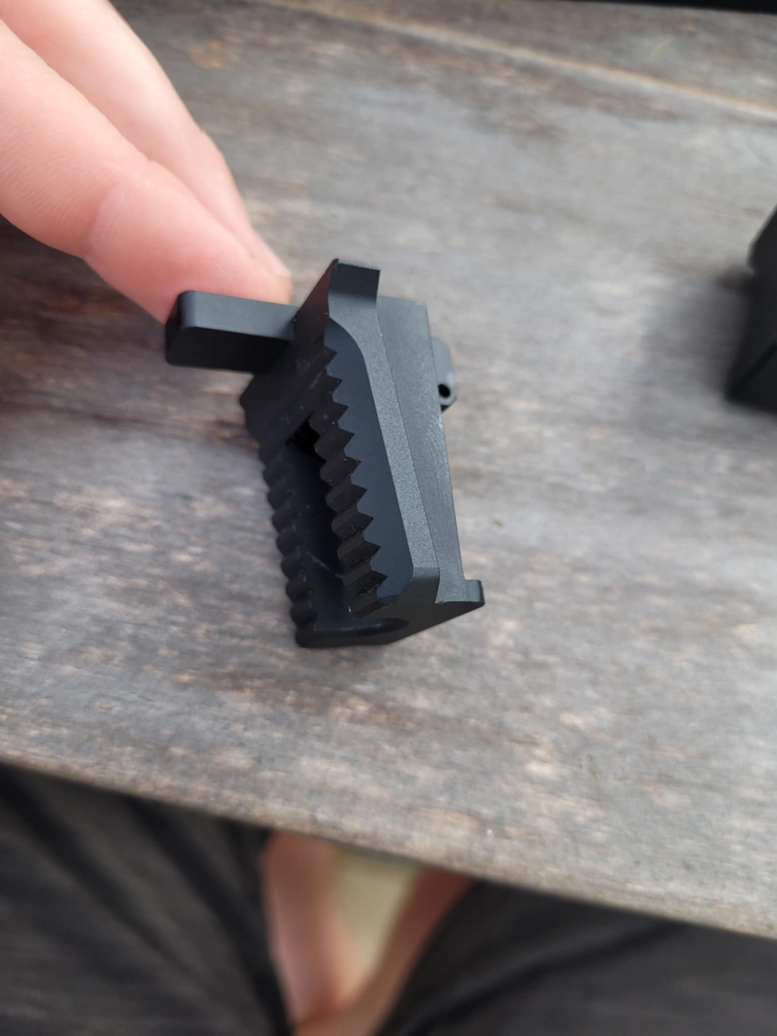

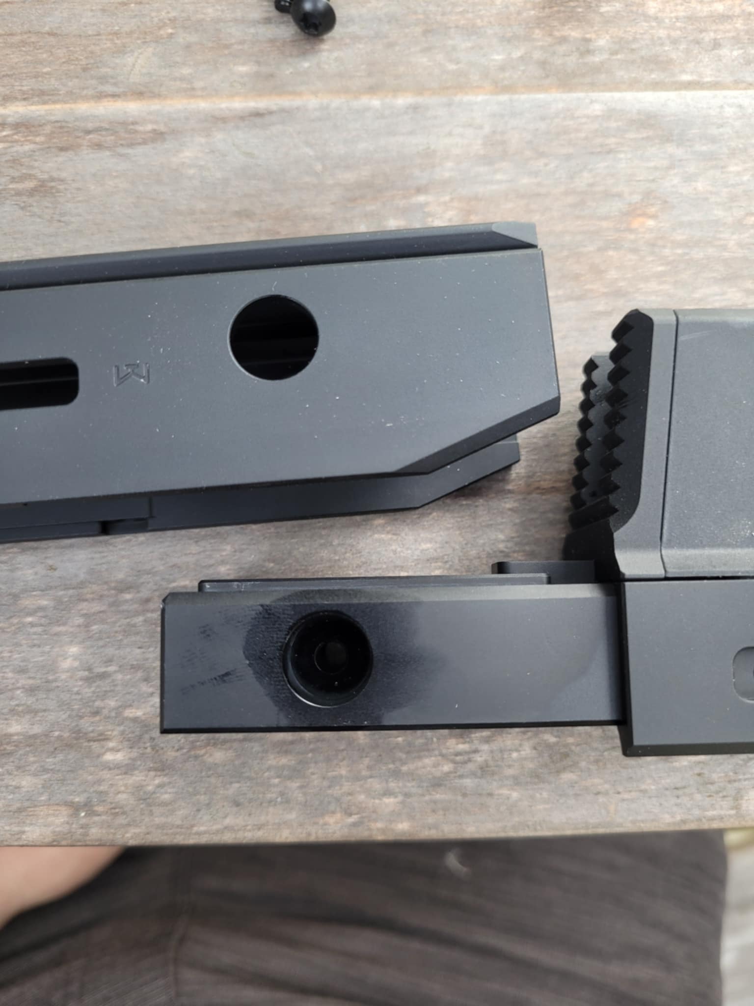

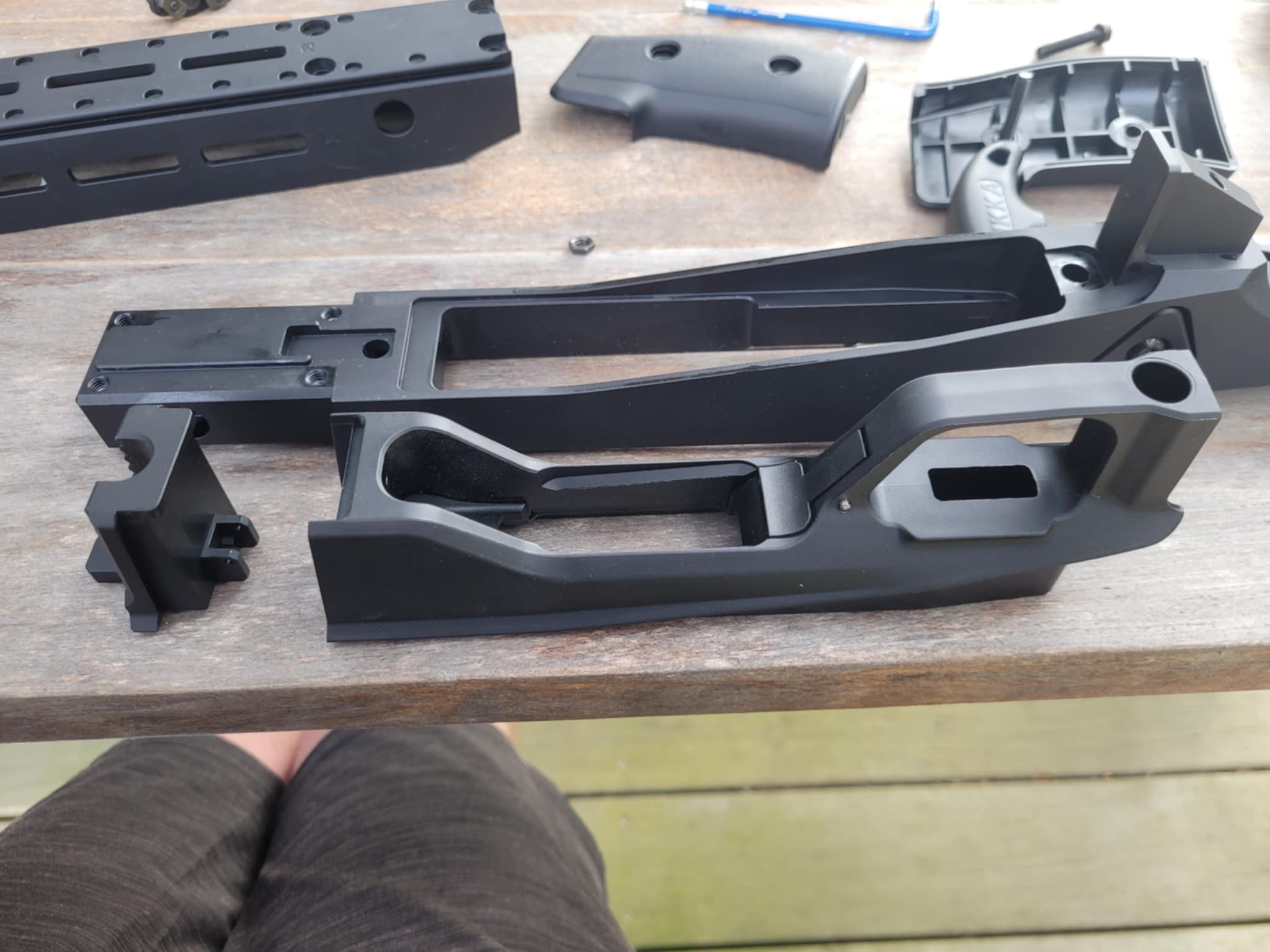

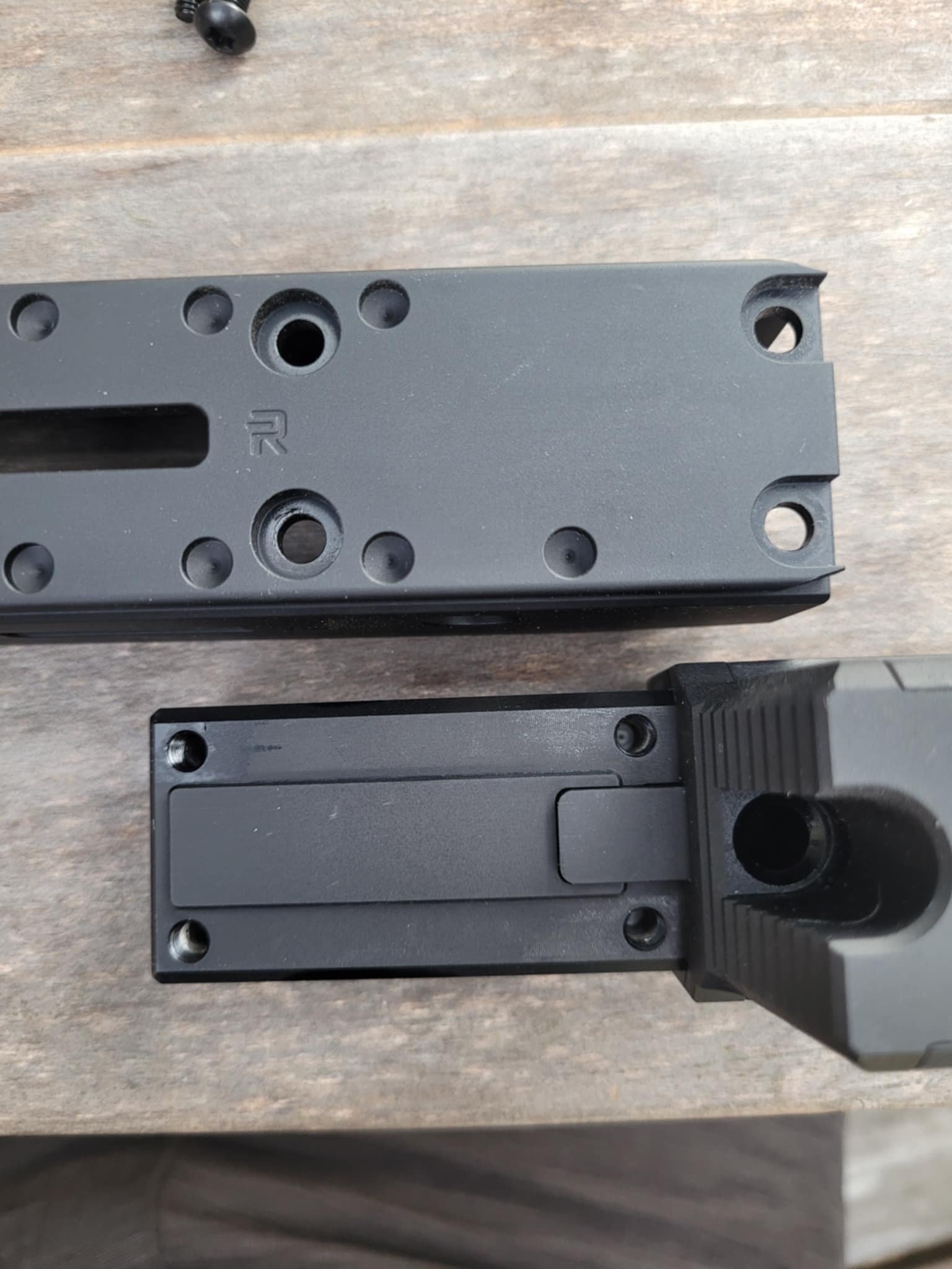

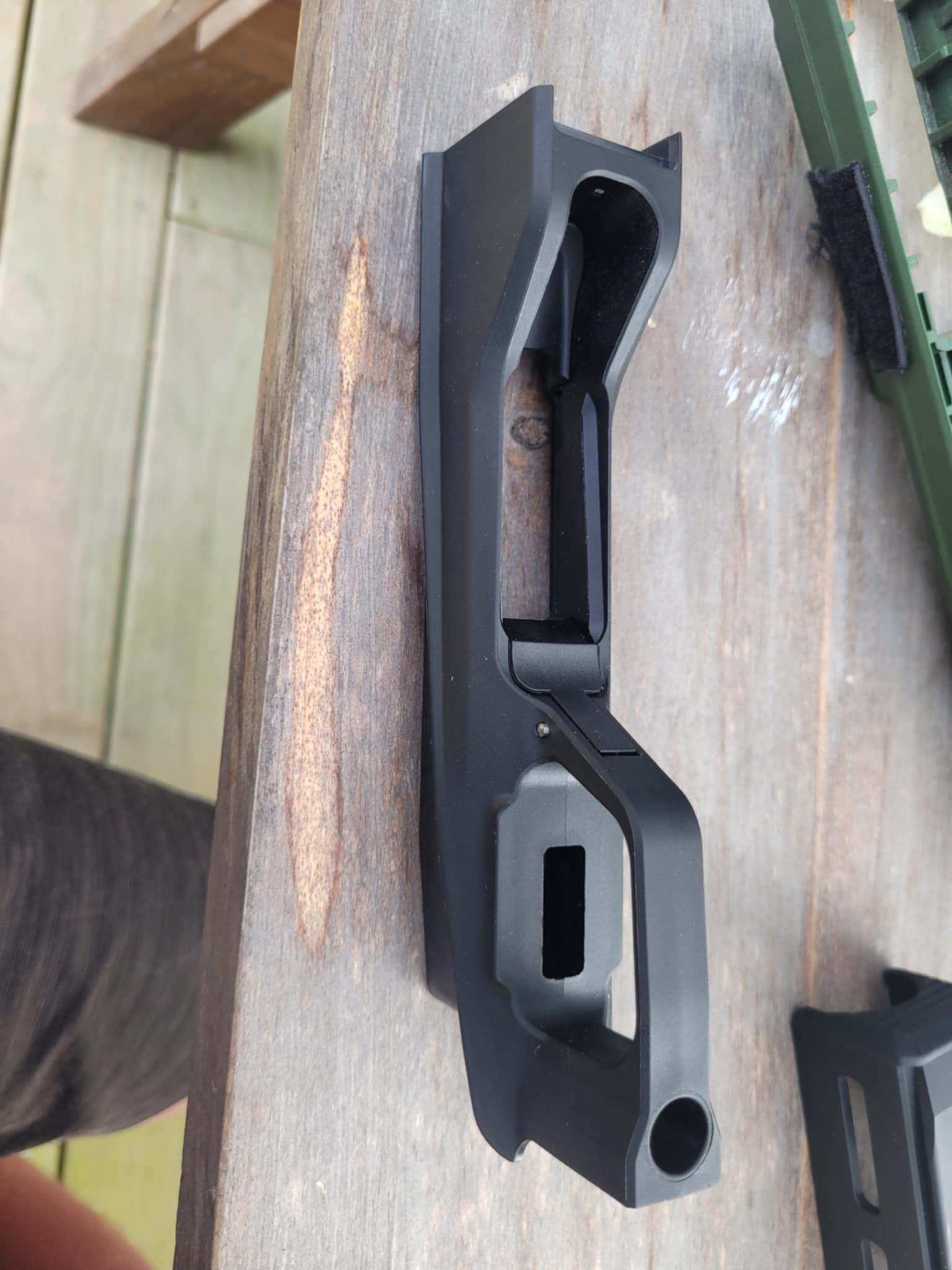

The replaceable mag well is probably the most interesting thing about the entire rifle.
You need to remove the pistol grip and the action screws to get the mag well off, it's a little snug but pulls off easily.
The barricade stop is actually aluminum and separate to the magwell, it slots into the main aluminum "back bone" so isn't reliant on the plastic magwell for strength.
I do like the ability to change the magwell, for centrefire I much prefer CTR magazines over AICS but the ability to have both options (when/if AICS is an option) is nice.
If Tikka ends up offering a XM (medium 3.2" COAL) AICS option it could make this chassis a really sweet option for running short mag cartridges for comp use, for hunting you'll be able to use the normal Tikka mags obviously.

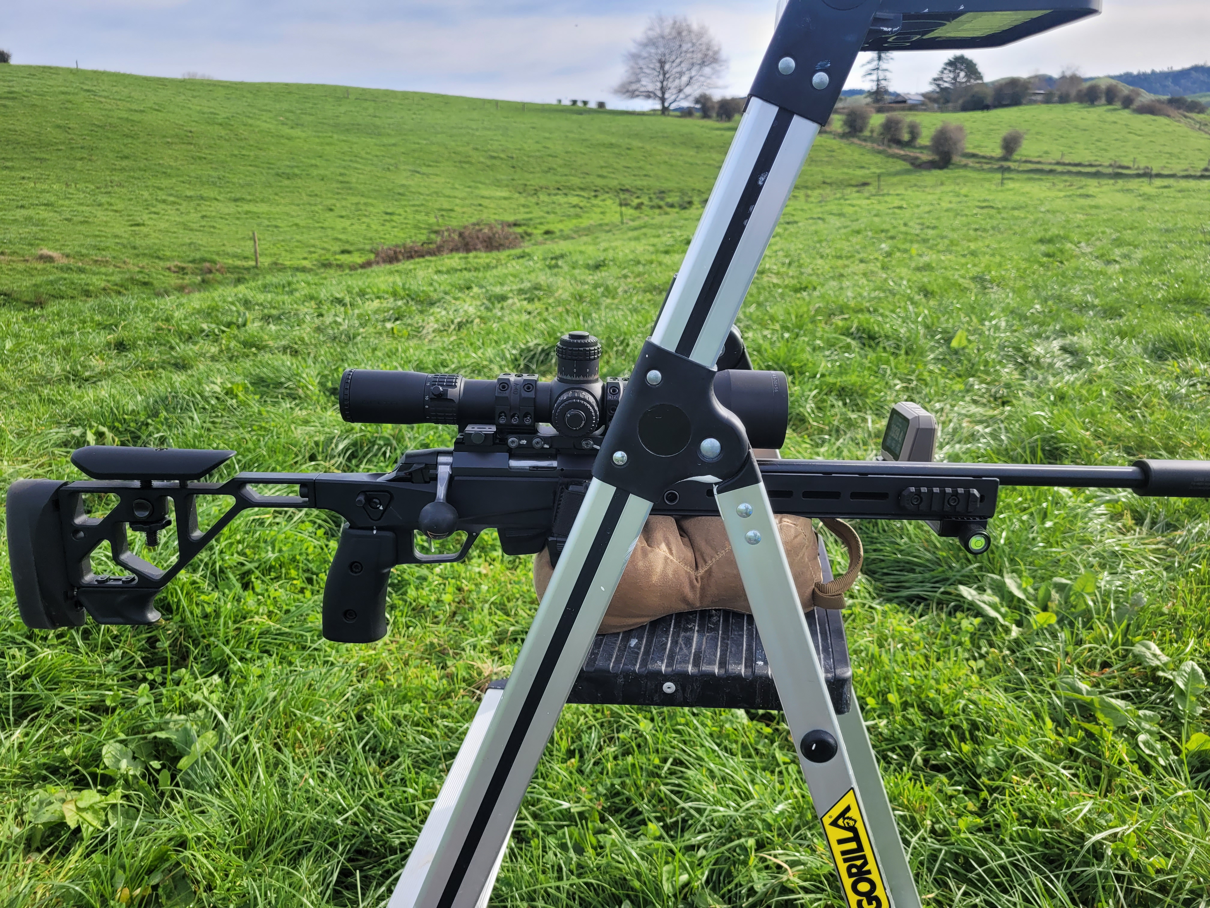

When first released my initial thoughts about this rifle was that it was a bit of an afterthought, it's like they designed the chassis 80% for PRS in the T3x Ace Target, 20% for NRL Hunter with the T3x Ace Game, and then thought well just make a T1x mag well and chuck our standard barreled action in it and call it the T1x Ace Target, as opposed to T1x Ace Game which is really what it is.
I thought there is zero chance this thing will be close to a PRS/NRL balance with that pencil thin barrel.... and well, yeah, I was 100% right.
If you buy the longer forend and load it up with as many weights as possible, put on a light weight scope, bipod, tuner/suppressor it MIGHT balance ok, but this rifle needed a heavier weight barrel.
I put my other T1x barreled action into the chassis and it balances just (as in barely) in front of the barricade stop, that's with a 25.5" medium plama (ish) barrel which weighs almost 2x (1.030kg vs 1.980kg).
Unfortunately due to the way the T1x action made you are limited on how fat of a barrel can be installed. 23.5mm (.92") is the fattest straight taper you could go.
Messing around adding weight to balance to rifle, I concluded a .92" straight taper 24" barrel would be needed to get it balanced ok.
Companies don't seem keen to offer super long factory barrels but I think a 22" or 24" option would still appeal to the "uninformed" buyers out there. If they offered this rifle with the longer forend and a 22"+ straight taper barrel then I think it would actually be a sweet option.
As it stands it definitely leaves a lot on the table.
The balance point with no weights added....

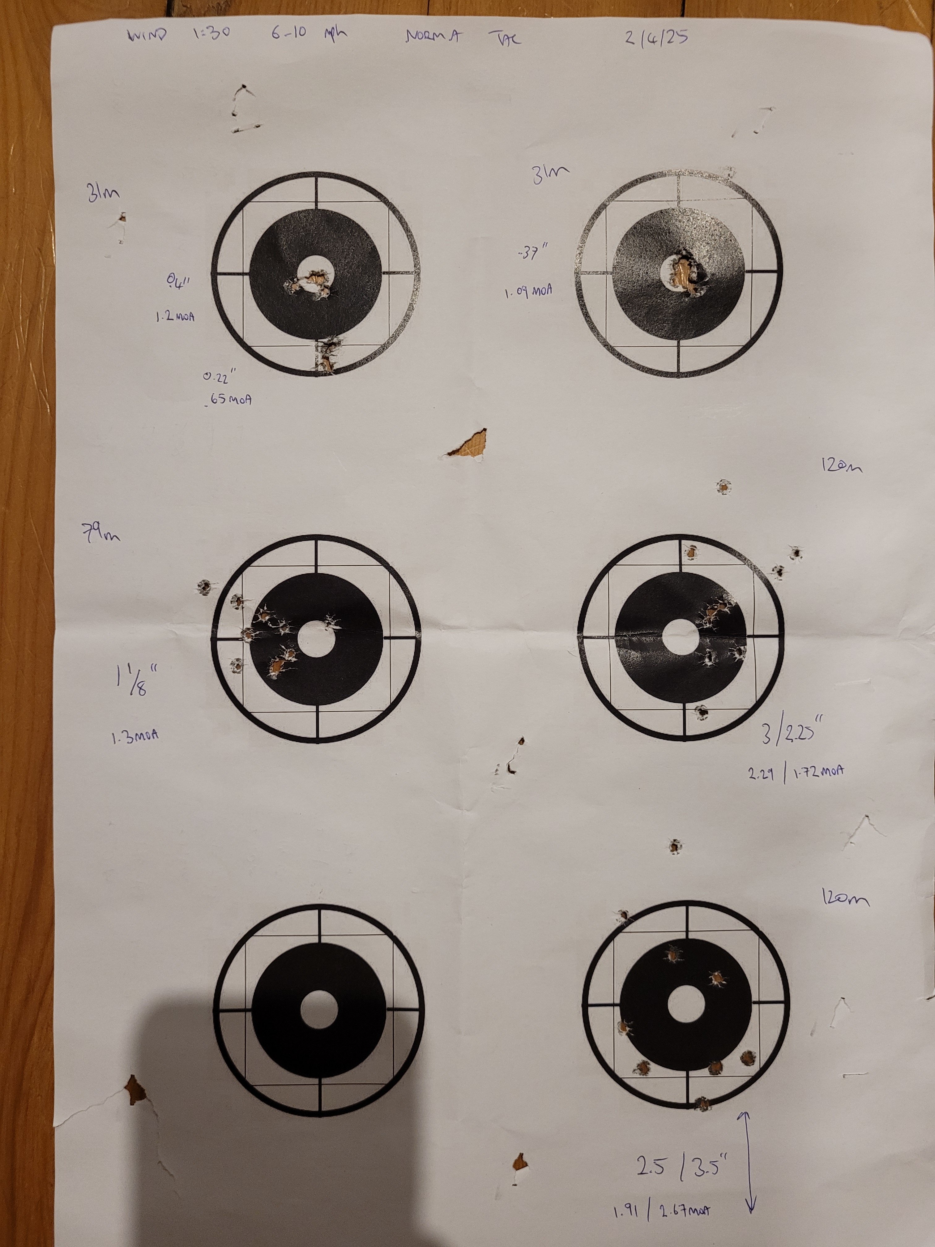

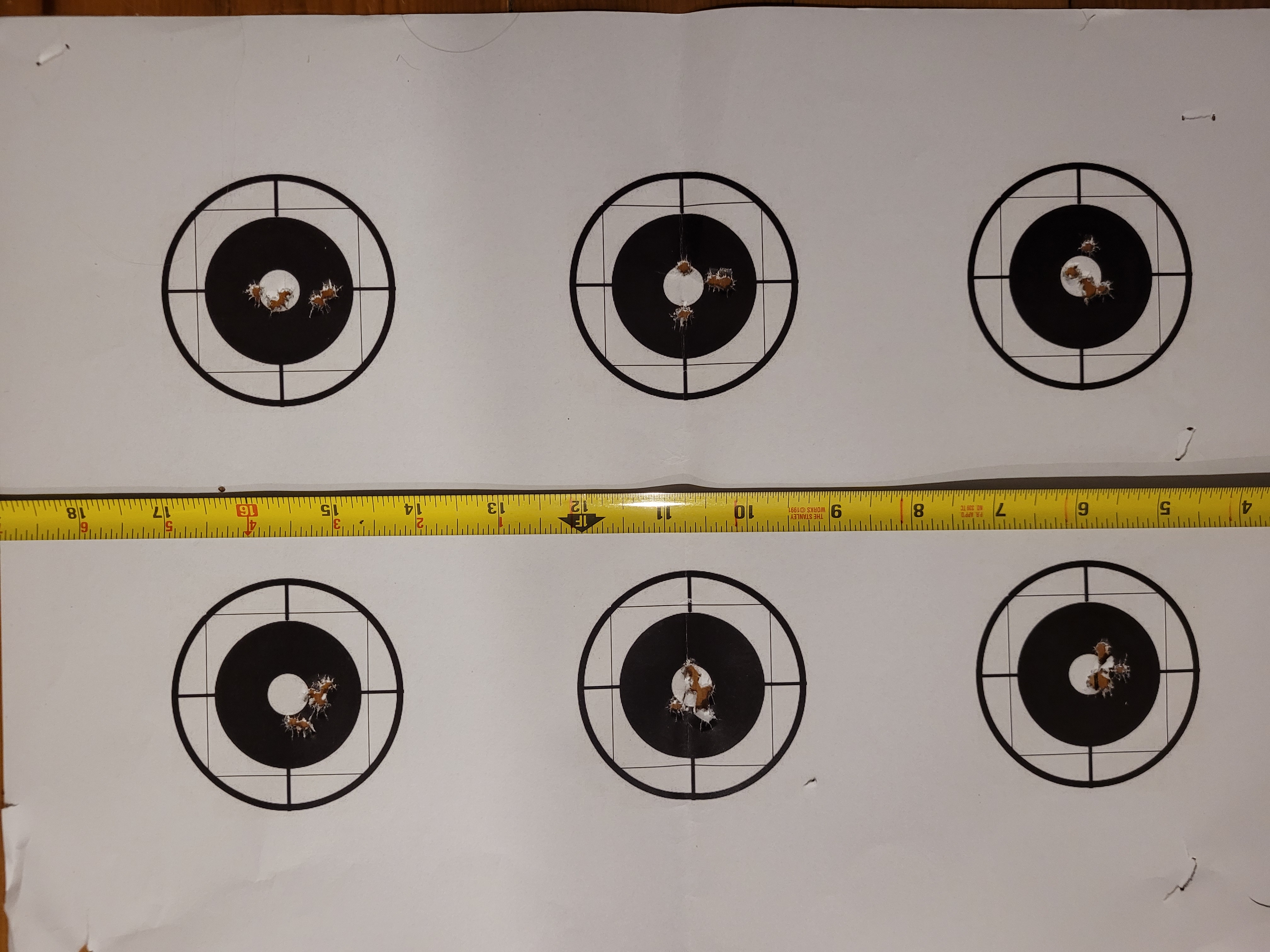

Here are targets from first outing, conditions weren't great 5 o'clock wind around 6mph gusting 12mph+.
I hadn't lightened the trigger or spent anytime adjusting the stock (only cheek piece) and was a fairly rushed outing.
First 2 pictures are 10x 10 shot groups, all at 30m (33yards), vertical looks OK but horizontal not brilliant. The few good groups measure around .3" CTC.
(Top middle is zeroing)
Two 25 shot groups at 102m (111yards), horrible position, wind still giving grief.
I'd say some of the vertical is me but to be honest 2" 25 shot groups at 102m with CCI SV isn't too bad IMO.
The ES of the ammo is saying 5cm (2") difference at 102m in Strelok, so guess I can't complain.

Not sure if you have seen the weights tikka is selling, but each weight utilizes an mlok slot on each side. So if you did buy all the weights, you would have no Mlok slots available on the forend. I see the aftermarket making a simple steel or brass bar that slides in the forend and is secured from the bottom to save on mlok slots. Which was my recommendation to Tikka in the first place.
Also, did you attach any Mlok weights to the forend and try to utilize the Arca rail? That was a huge issue with my rifle. The Mlok slots were too low on the forend and both MDT and Gray Ops weights interfered with an RRS and Area 419 Arca clamp.
Good write up, everything you pointed out as being cheap or bad quality were all items I wrote up as needing to change after myself and another shooter shot these rifles in October at the Gap Grind. The pistol grip, butt stock adjustment, overall chassis weight, accessory attachment points, the arca rail issue I mentioned, barrel profile(for centerfire rifles), chamberings(again for centerfire), and more. All items I presented that needed addressing and I dont think they changed a single thing. But I dont know if I should blame Tikka for not listening or the Product Manager at Beretta for not pushing Tikka to really make the best chassis they could have. To me, this chassis is like the Christensen Arms MPR chassis. Its ok but not optimized for really anything in particular, its just a chassis.
No I haven't tired any internal or external weights yet.
Sounds like the low Mlok slots are an issue on a few factory rifle chassis, definitely an oversight.
I'll try talk to Beretta NZ if I get the chance and let them know my thoughts, I know they were keen for people to start getting these rifles and for them to start turning up at matches. Here's hoping they can feed back to Tikka user reports.
Looking at the forend, I think you could easily make a large steel weight, some laser cut mild steel wouldn’t cost much at all.
Not entirely sure how you would secure it, but it can’t be difficult.
A large steel weight in the short hand guard would be about 1.25kg (2.75lb) in the target hand guard it’d be around 1.4kg (3lb).

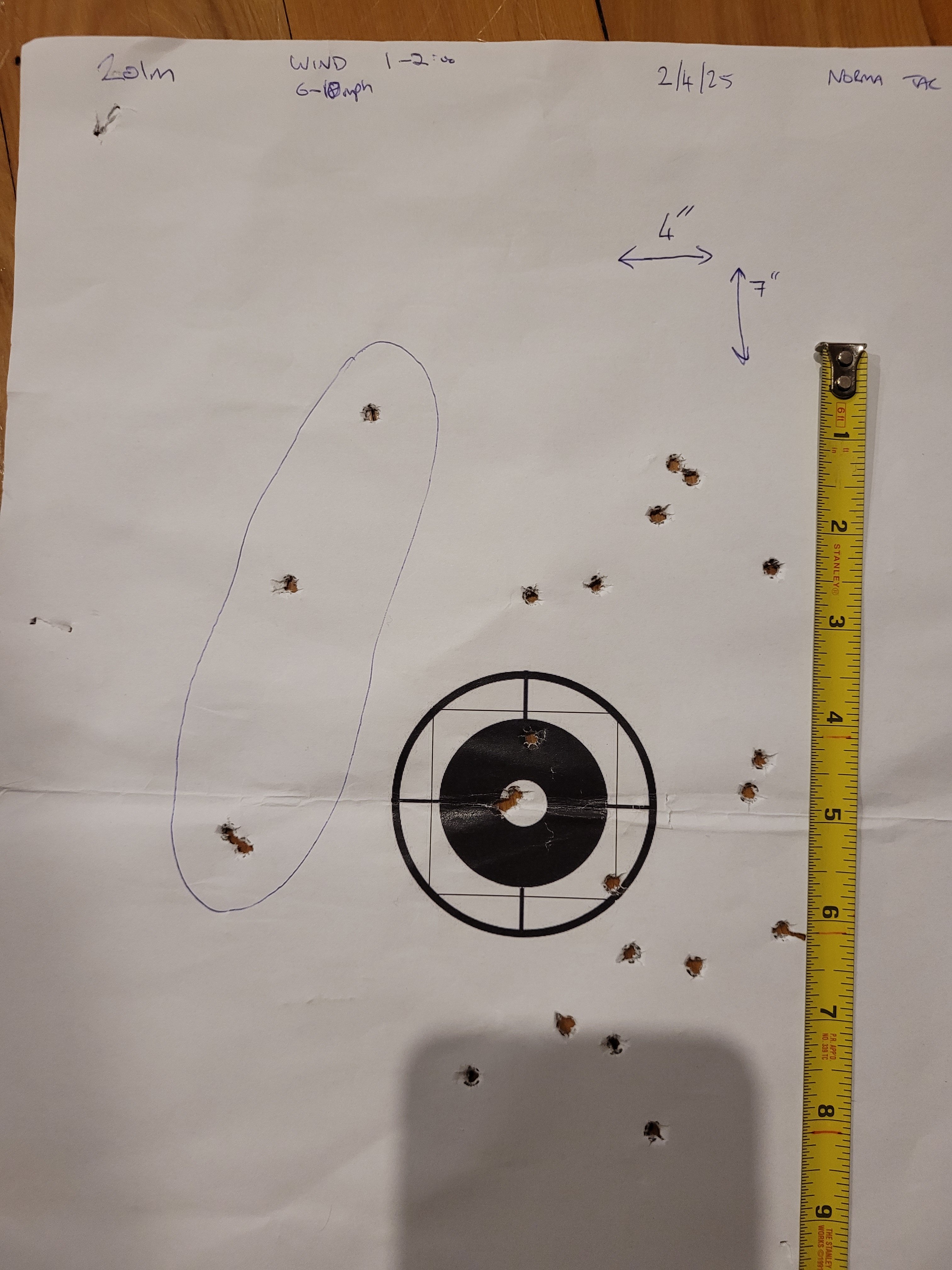

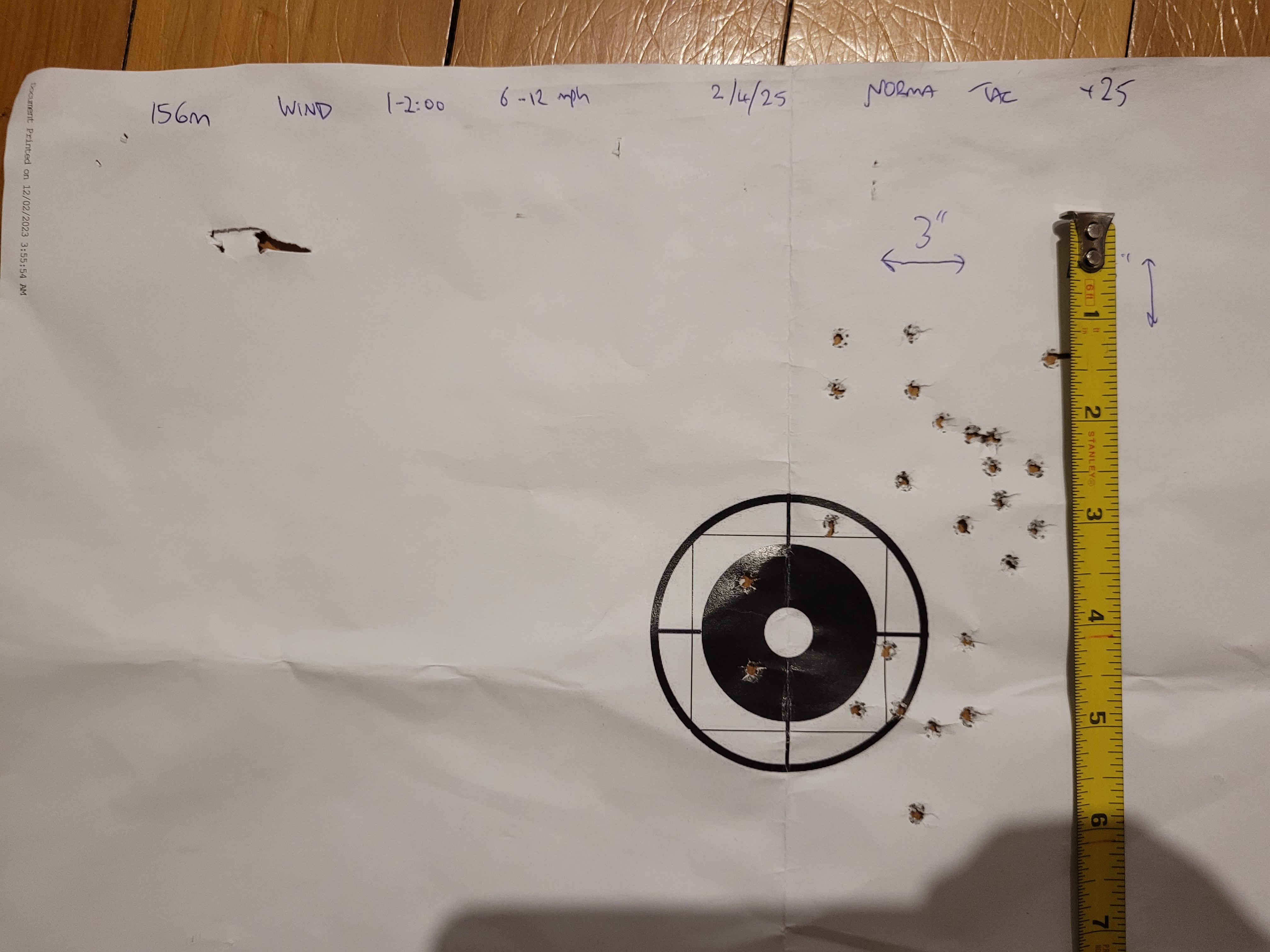

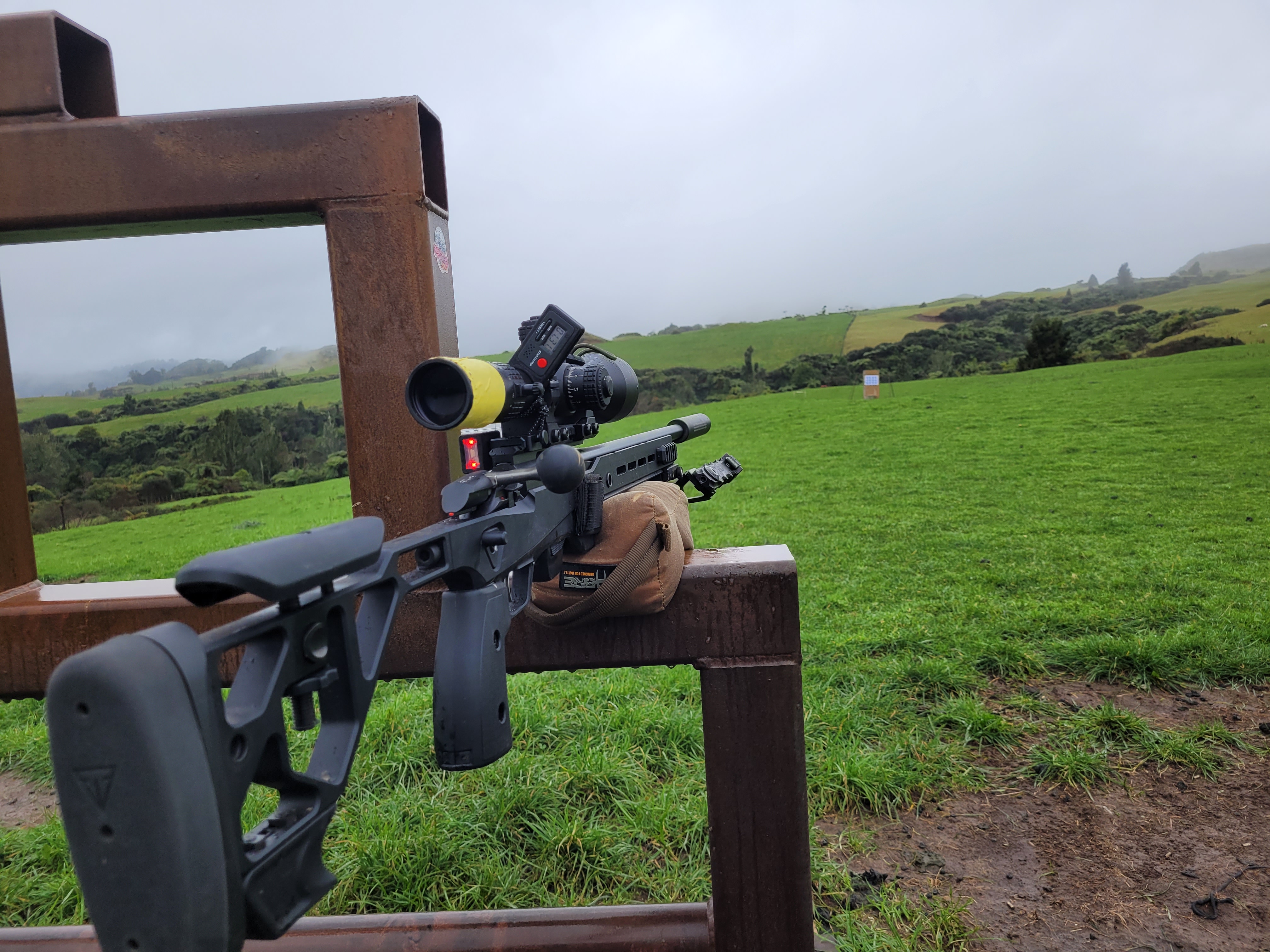

Been spending a reasonable amount of time with the rifle since owning it, some “dry fire” practise, messing around adjusting the chassis and actual shooting.
The first 500 rounds I put through it was the brick of CCI SV, unfortunately the weather hasn’t been great last few weeks, always have wind of 6-12mph ish. Have had a variety of issues with forgetting gear (bipod, rear bag etc) so haven’t been able to print any fantastic groups.
So for I really like the rifle, I think I’ve already said I don’t have any experience with a proper chassis (MDT ACC, KRG W3, MPA, etc) so it’l taken some getting used to. For the most part the chassis is really nice, not to difficult to get adjusted, comfortable to shoot, etc.
I spent a few hours practising fundamentals one day, shot 270 rounds and found the chassis to be great TBH.
I haven’t tried hanging any weights off it, so can’t comment on the interference with the ARCA rail, so I really don’t have many complaints.

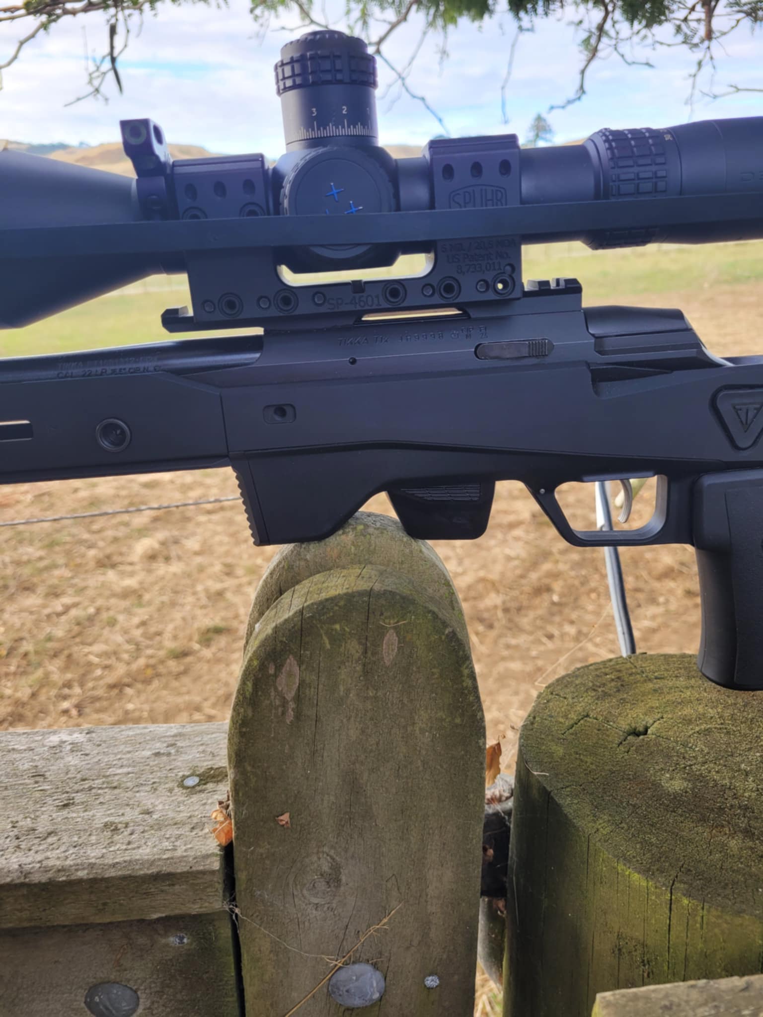

I’ve done a little bit of varmint/small game shooting with it and the chassis again is great for that. It doesn’t feel as heavy as it actually is, and handles great for offhand shooting. Done some dry fire practise with a sling and again it feels great.
I still think the rifle is somewhat fundamentally flawed, if it were called the T1x Ace Game I’d say the rifle is excellent, but as a Target model aimed at PRS/NRL it is just lacking. If it had the long forend and a longer/heavier barrel then I’d say this rifle is great.
I’ve mainly spoken about the chassis so far, in reality that’s the only thing that needs reviewing as the barrelled action is the same as people have used for years now.
The rest of the rifle has been great, I added a Tikka rubber bolt knob and the action cycles very quickly, and easily, basically just cycle it with my index finger.
I’ve had no failures whatsoever ever, ejection is very good, no feeding issue, no extraction issues.
Trigger is adjusted down with the standard spring, it’s still a tad heavier than I’d like so an aftermarket spring is needed, every now and then I feel like there is a tiny amount of creep, but I think a different spring would make it either go away or not be noticeable at all.

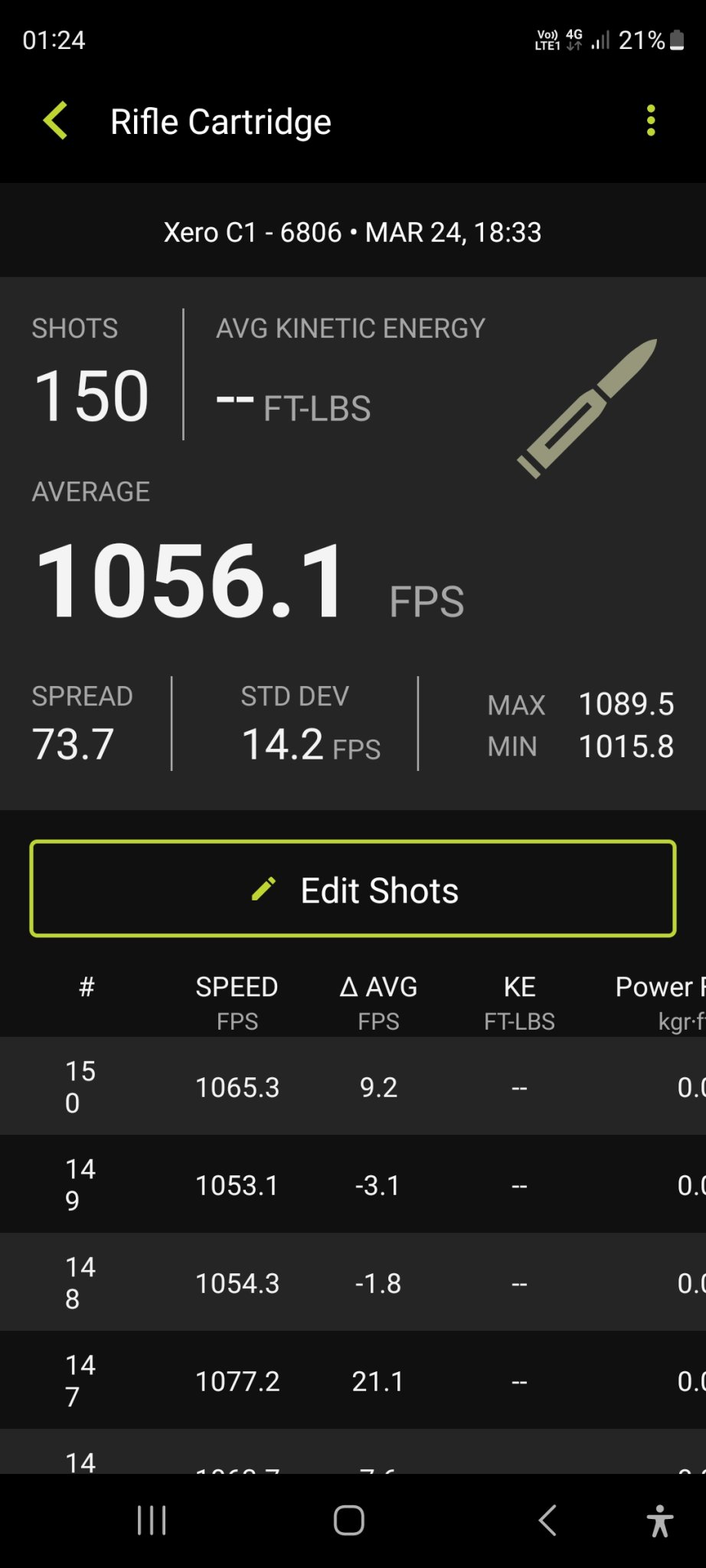

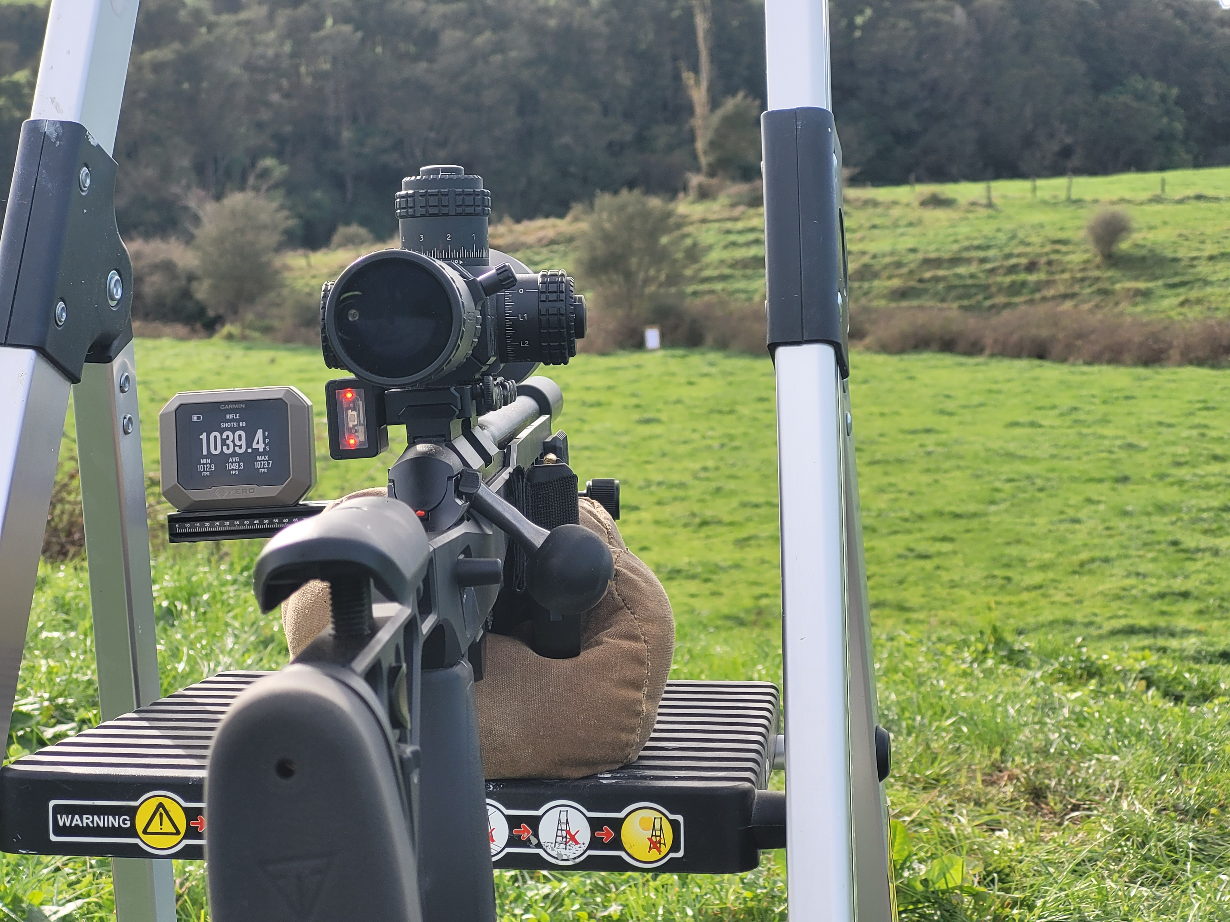

Almost every shot has been over the Chrony.

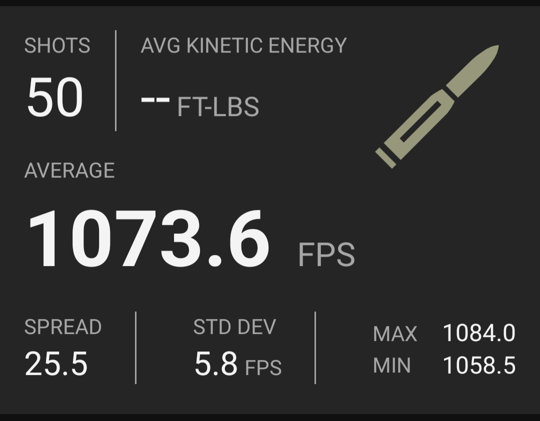

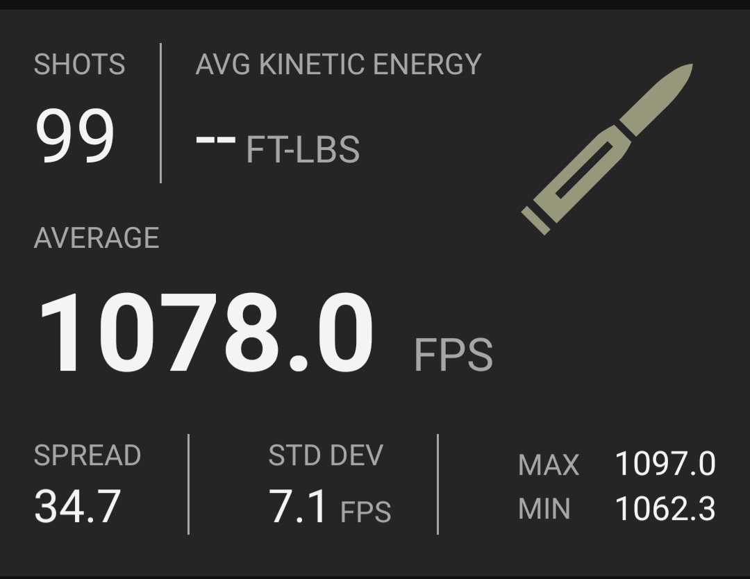

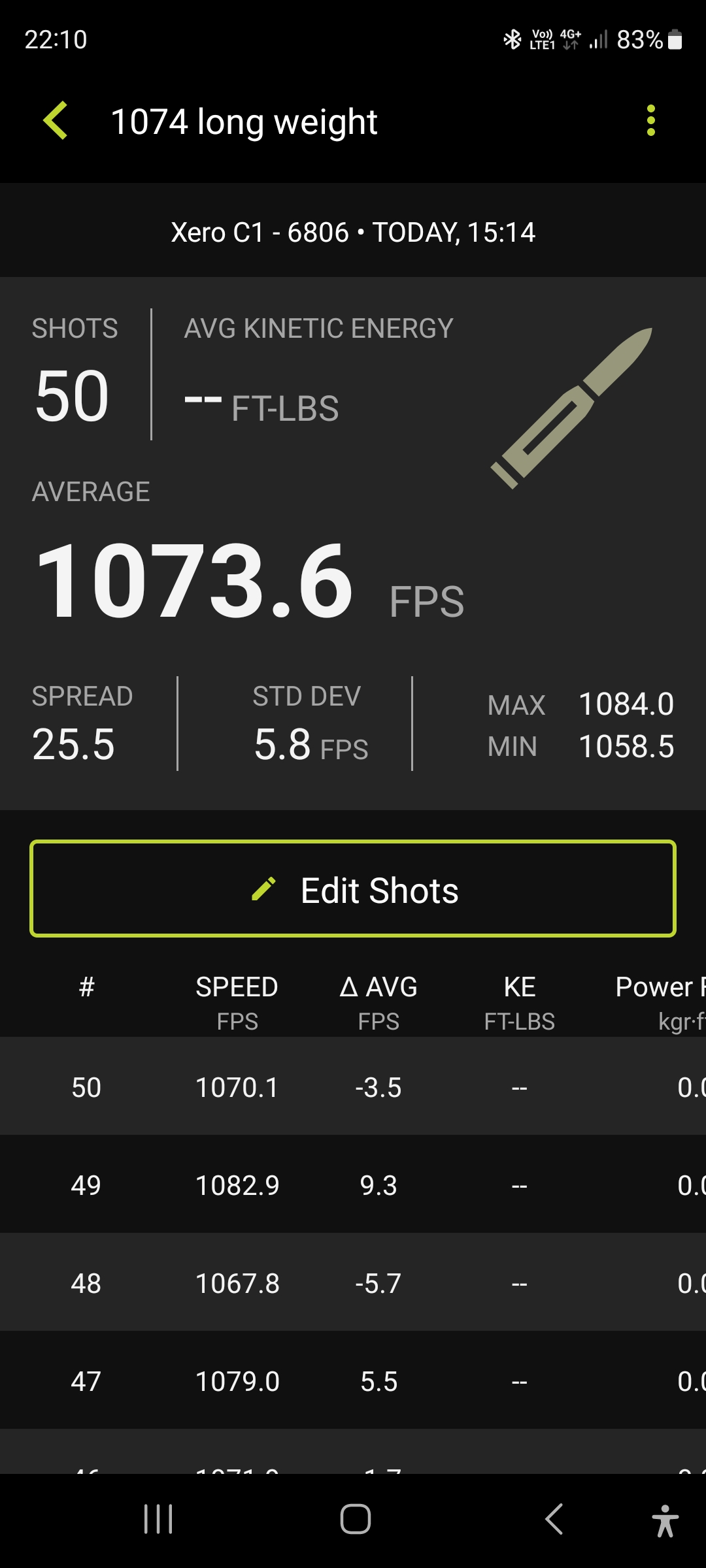

The 500 rounds CCI SV had an ES 81, SD of 13.43, if you look at the ES for individual packs of ammo (50 rounds) the highest ES I saw was 65fps (which is great for bulk ammo) however adding them all together it bumps up to 81fps.
I was having issues where I'd shoot a few great groups and then get some bad fliers with the CCI SV, turns out the front action screw was loose...
So the groups I shot were actually pretty good. These are my attempts at 6 x 5 at 50yards (46m), gusty wind 6-12ish mph from 1:30.
I've now started testing Norma Tac I had left over, this stuff shot great at close range with a ES of around 40fps in my 25.5" T1x, but the accuracy at distance wasn't great so I stopped using it.
Split over two days (pretty much save weather) ES 61, SD 11.36 for 145 rounds (forgot to turn chrony on for first 5). 50% higher ES over my longer barreled T1x, but accuracy is better in the Ace.
The 5 circled shots in last picture are the first before I dialed on a bit more wind.
Other than the 31m groups, the aren't amazing but not horrible either, the 79m groups has a lot of horizontal from the wind, and the 120m groups each have a high flier( I think one was me, and the other was a very fast cartridge).
I ran the numbers for my expected group size from the ES:
79m: .8" (groups were 1.125" tall)
120m: 2" (groups were 2-3.5"" tall)
156m: 4" (groups were 4.75" tall)
201m: 7.1" (groups were 7" tall)
Sorry for the mix of meters and inches...
Also a mix of 5, 10 and 25 shot groups...

I've put around 1400 rounds through the rifle and shot my first match with it now.
Haven't had a huge amount of time to shoot since buying the rifle but it'll get used more and more from now on.
First match didn't go well, which I think was mostly due to my ammo (Eley Club which seems to vary alot between batches) however the rifle performed well, and have no additional complaints about the rifle.
Managed to pick up some Norma Tac ammo very cheaply (cheaper than everything else, even bulk HV crap) and it's shooting that very well.
My 30m groups are all easily into one ragged hole and almost always under .25".
The ES/SD is fairly good so I'm printing decent groups at 150m and 200m isn't too shabby, it's not anything close to Eley Tenex accuracy but it's really not bad.
Have another match in a few days which will hopefully be the first real test of the rifle.

Probably time for another update.
Managed to get some Eley Match down in NZ. Tested 3 different batches, one shot horrible (not accurate and terrible ES) but the other two shot great.
Seeing around 28-32fps ES over 50-100 shots and accuracy is good.
Decided I would try running a suppressor for added weight out front.
I was a bit apprehensive as previous experiences with suppressors in 22lr didn't go great, however I found a locally manufactured suppressor that has been designed to not lockup with fouling (so easy to clean) and with stainless baffles meant it added a reasonable but of weight.
With about 1500 rounds though the suppressor now I think I'm happy to say it's going well. Accuracy doesn't appear to have suffered, and if I clean it every 500 rounds or so I don't get fliers/increased ES (the problem I found previously).
The added weight makes the rifle far better balanced, and the added length seems to make the rifle generally handle better.
I've spent a reasonable bit of time tuning the chassis adjustments, and have to say I'm pretty happy with the chassis.
I've switched around scopes and mounts and ended up in a pretty good spot now.
I can comfortably and quickly shoot my Delta Stryker on 25-30x and not be hunting for a good sight picture, the rifle didn't feel great with a 1.2" (ish) height mount, but with a 1.5" tall mount everything feels great.
I have approximately 3500 rounds through the rifle now and have to say I'm pretty happy in general.
The rifle has has given virtually no feeding or ejection issues, and generally just shoots.
I did find 2 of my older t1x magazines don't play well with the Eley EPS projectile, but my other two (I'm guessing newer mags) work 99% of the time. The issue is the flat nose hits the back of the barrel tenon as the magazine feed lips must be worn out on the older mags, I'm guessing this means non-EPS projectiles were scraping a bit as they went onto the chamber so these older mags might need retiring.
I've bought a new magazine to see how that goes, and so far have had no feeding issues.

During an extended shooting session, with around 600-700 rounds through the rifle and suppressor since the last cleaning, I shot this 5 shot group at 30m (33yards) off a PRS skills style barricade. Was keen to see how a well fouled suppressor (and lessor extent rifle) would do on paper.
The rifle balances well with 824g (29oz) of bipod and 220g (7.5oz) of suppressor, balances as you would've wanted it to from the box.
I went out and bought some Tikka weights today, the store didn't have many but I bought all they had, added about 1.1kg to the rifle and now it's a pretty nice weight and balances well (with bipod and suppressor).
Tikka have introduced an external weight now which you can pair with the internal weights. The external ones don't hang down and obstruct the ARCA rail, and they replace the little side panels that come with the internal weights.
They are kind of a stupid shape as they overlap each other and don't really make the best use of the forend real estate.
2 pairs of internal weights combine with one pair of external weights.
I put off buying weights for this rifle as I bought it for factory class in the IPRF22 competition. I've now learned that I am actually allowed to run a factory rifle with added weights if they are made by the manufacturer. So I rushed out to buy as many weights as I could, as the competition starts this week.
I wanted to longer forend too, but it wasn't available.
The internal weights are hellishly expensive, but the externals aren't badly priced.
They were easy enough to fit but the forend end cap now doesn't fit, so a bit of an oversight from Tikka.
