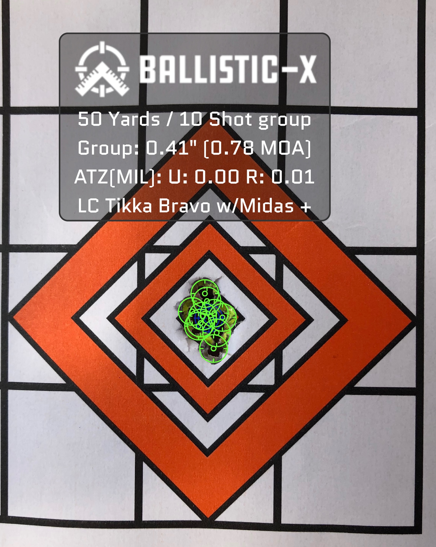

First day shooting T1X mounted in a KRG Bravo with Midas+ ammo. My rifle seems to like this combination. I agree with others about checking parallax. You might also want to make sure your cheek weld and sight picture are consistent.
