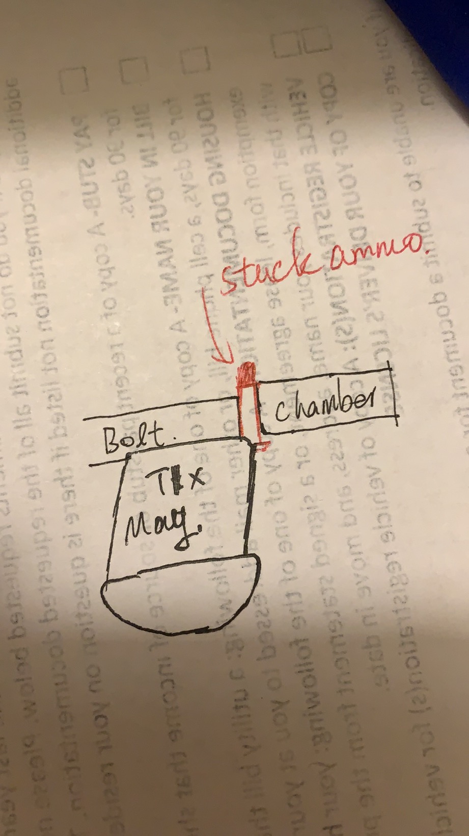

Add a pic for what is going on...
Sorry for my poor drawing.
I do not own a Tikka, but a Sako Quad.
No such problem with it but I once finesanded the feeding lips it smoothened it out.
Take slow-mo video of the round chambering and will probably show you.
But one guy here removed the stock and moved the magazine insert forward or backwards to resolve such problem.
The magazine insert is probably held by two screws.
Good luck!

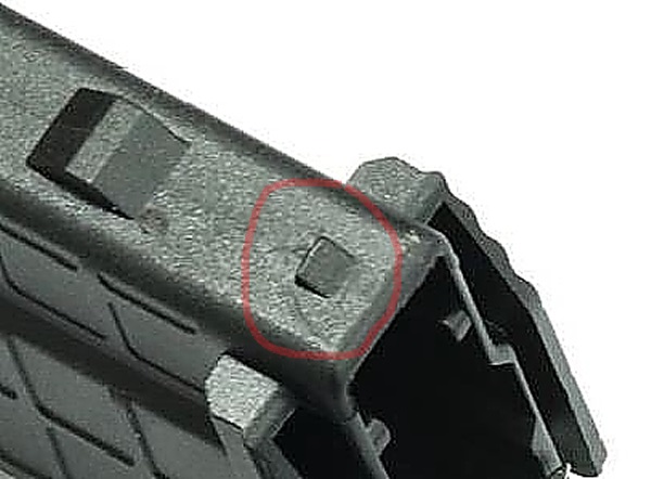

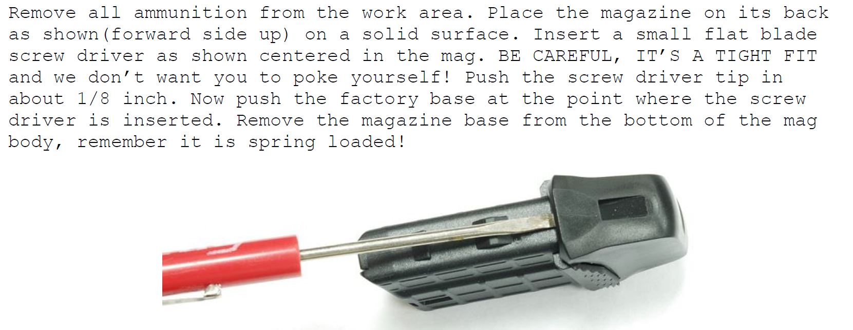

I copied this from DIP website maybe it will help you....
This is the notch that you are lifting the base over to clear and release.
