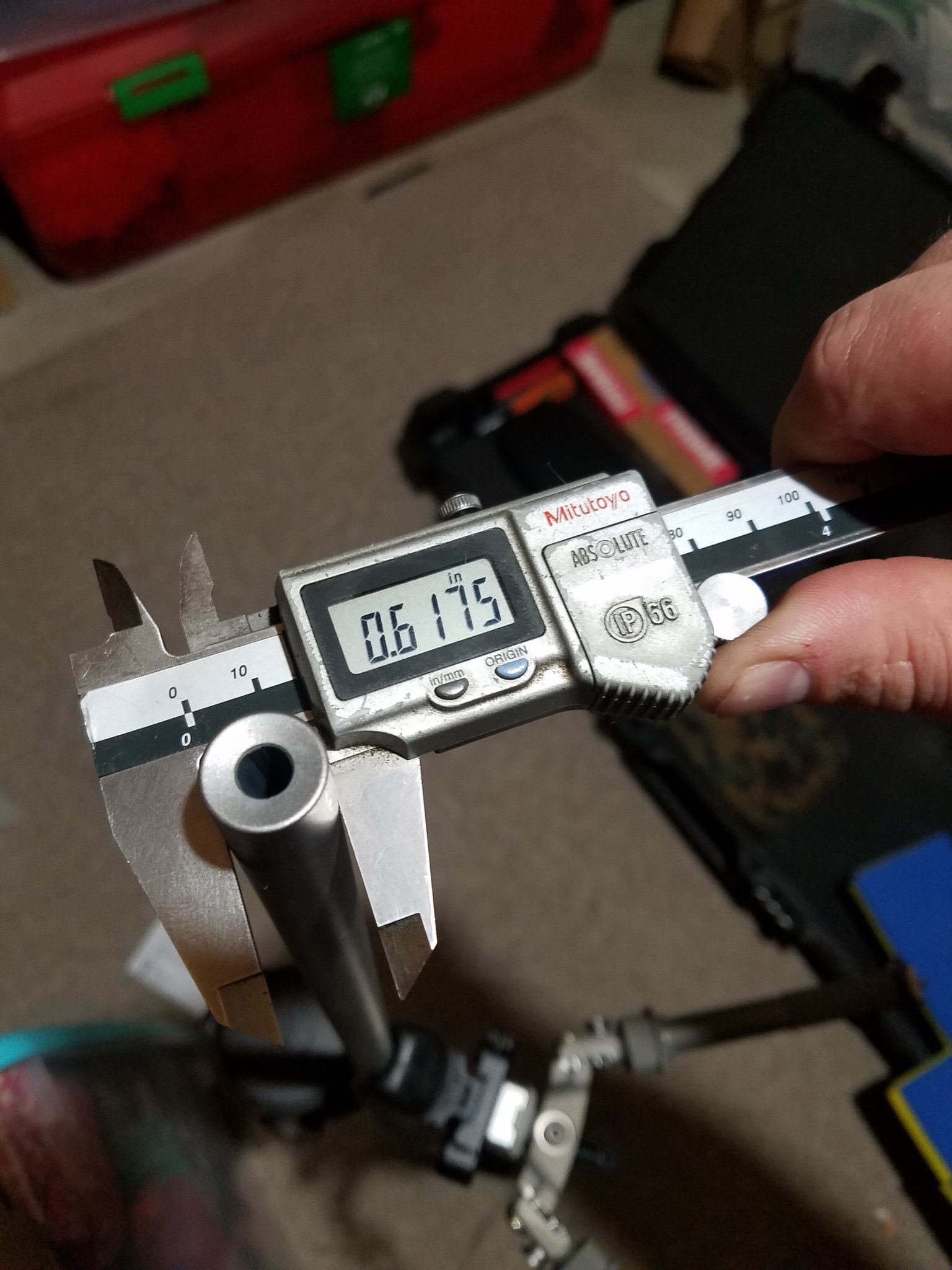

You are sol on 5/8. I measured my t3x lite 0.600" back from the muzzle and measured 0.6175". It is smaller at the muzzle. That is smaller than the published minimum for 5/8-24 class 3 threads which is what you want.

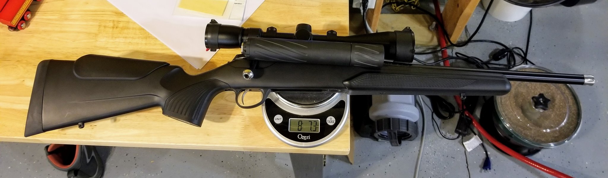

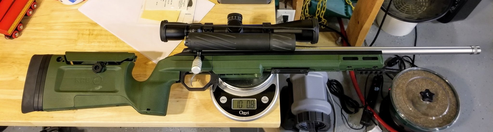

Here are a couple of rifles that fall in line with what you are trying to accomplish - I'm going to list everything attached to these rifles so you can add/subtract weight as required. The top rifle is a T3x Lite in 6.5CM that I had chopped to 16.5" and threaded 1/2-28. In this picture, it was mounted in a surplus varmint stock that weighs ~3oz more than the "Lite" stock. The scope is a Vortex Razor LH 3-15x42 with Butler Creek caps and a Banish 30 suppressor.
This rifle is a stainless T3x Lite in .22-250 that has been shortened to 20", mounted in a KRG Bravo. The additions that are tough to see are the KRG polymer m-lok pic rail at the front of the forend, a Magpul 2 slot ARCA rail, and a QD sling point on the other side of the forend. The scope is a Vortex Razor HD-LHT 3-15x50 and the can is a Banish 30.
1.5 pounds is the difference in actual weight. If I was going to sit in a blind/hide, I would take the KRG Bravo. If I was going to hike, I would take the OEM stock which seems to carry and balance a lot better (but that may be that there is 3.5" less barrel on the 6.5CM). If you don't already own a suppressor, get one on order. Shooting these rifles with the shortened barrels is obnoxious without a can.
I would have no problem taking either to the range for a plinking session, but make sure your expectations on the rate of fire are inline with these lightweight barrels and what they can handle. Ultimately, I'd suggest making your rifle into a suppressed hunting rig and, if the need arises, get another one to play with at the range.

Published sizes for just the thread od is 0.618-0.625. Recommended od for shoulder diameter for 5/8 is 0.725. A face mount break for suppressor use is possible but not everybody makes one. Only one I've seen so far is thunderbeast but I don't know their requirements for sizes on one.
You can get it cut for 9/16-24. 0.662 recommended for shoulder size. Worst case scenario in that you can't get a face mount type you can do that with a barrel chopped to 18". Depends on your muzzle device though. Direct thread can youre more in trouble. Brake attached can be worked with. A 1/2-28 brake could be opened up.

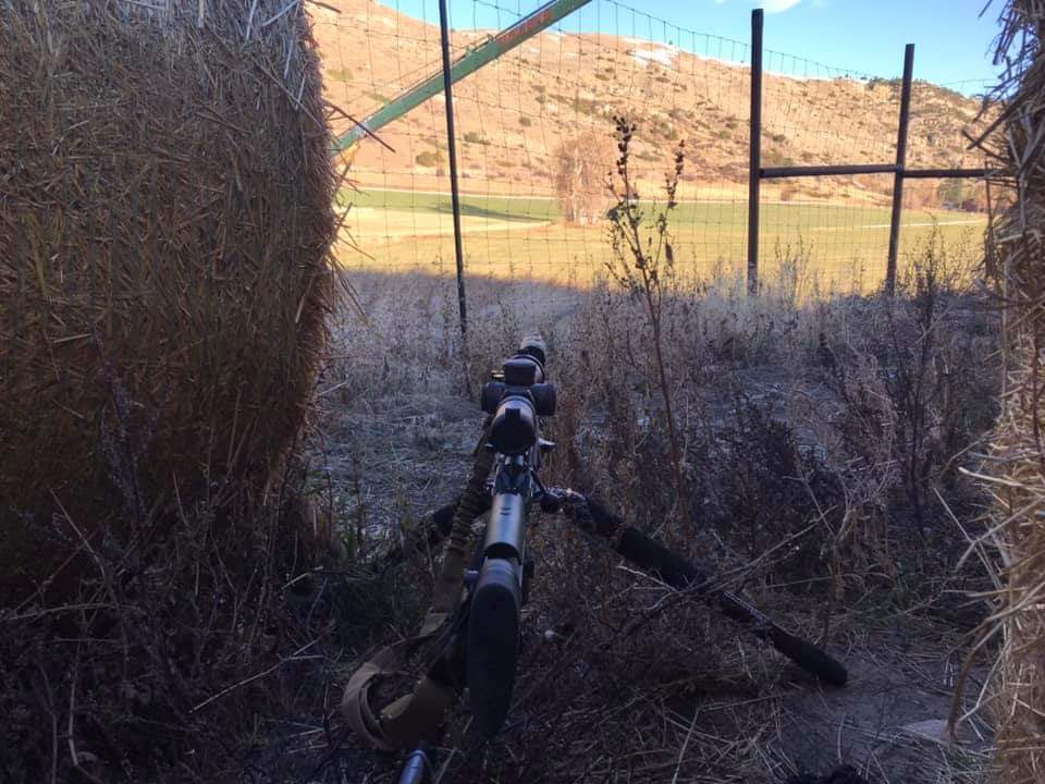

Speaking of overwatch hunting - that bottom photo makes it look like you're hunting a golf course. :)

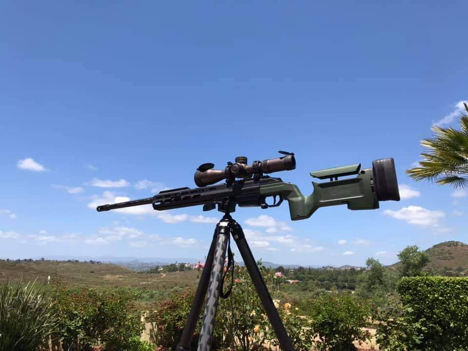

There have been a lot of good ideas in this thread but there is one that I am not sure has been mentioned.
If you're thinking of going with an 18" light palma barrel, you could always just purchase a 20" CTR and sell the current T3x Lite setup. I am not sure if the current rifle has ever been fired, but it should be easy to get rid of right now. Plus, if you want to get a KRG Bravo or XLR Element, you can sell the CTR stock/magazine down the road for $120+ in the PX. The CTR comes threaded 5/8x24 and the stock will fit the barrel...
My T3x Lite barrel was ~1oz/in, so you could conservatively estimate the CTR barrel at 2oz/in and say that you'd only be gaining 4oz by sticking with a factory 20" CTR vs a new barrel from McGowan in the 18" range.
LOL! You're the second person that has said that, but in actuality, that's a hay field, recently mowed and bailed (I'm actually hunting from the hay bail lot). That hay bail lot is about 20 ft higher than the hay fields and gives 200* FOV overwatch position before you start having to worry about shooting over a road (that heads right up into the Beartooth Mtns). It's pretty cool in the early morning to watch the mulies come down the ravines out of the mountains, and see the whitetails up come out of the river bottoms...
