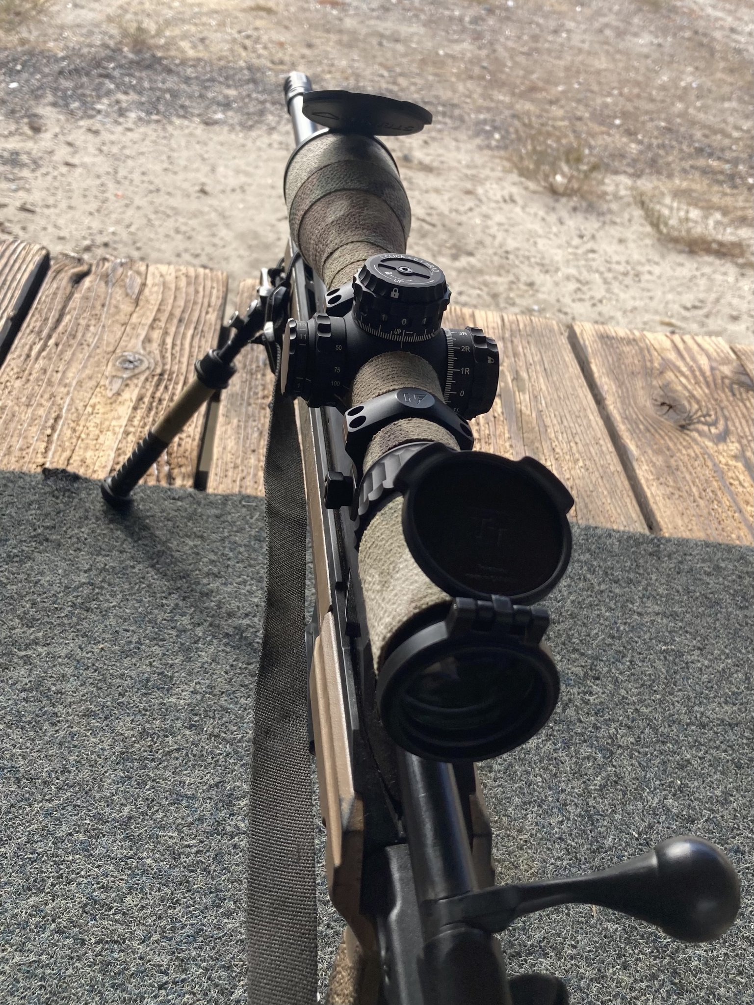

I have a T6Xi 5-30x56 with the SCR2 Mil reticle. I literally got it this week. It’s a phenomenal optic and a massive upgrade from my previous scope (PST II 5-25x50).
I admittedly don’t have a ton of experience behind Leupold’s but I can vouch for the quality of the T6Xi. Their zero adjustment and locking system are stupid easy / simple too

My twin to yours just showed up today and I got a little time with it late this afternoon. Initial impression is promising.

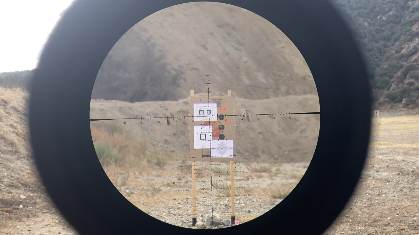

I spent a full day yesterday with the T6xi zeroing it in and doing positional tripod work at the range (mostly at 100m). I’m a big fan of the SCR2 reticle and the image is impressive from 5 to 25x. I can see more CA at 30x but still a clean image.
One thing I also like is the parallax adjustment functions significantly better than others I’ve used. I’ve tried multiple scopes where the sharpest image to my eye for objects at 100M+ (at infinity) was 200yd compared to the infinity setting. This scope seems pretty on the money for sharpness and being parallax free at the listed distances.
Ability to reset zero and not have to remove caps for the zero stop is super convenient. The small added goodies like Tenebraex caps and throw lever add up too. Let me know if you have any questions based on the small sample size OP.

What power is that left photo set to?
