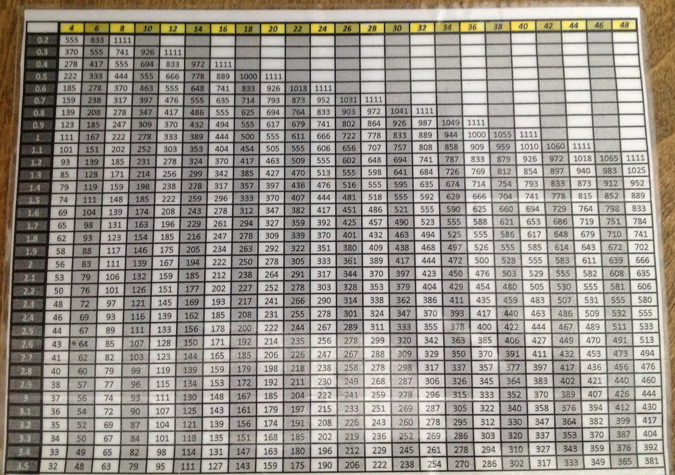

    I love UKD stages. There are several matches that include UKD stages and various combos of KD and UKD in the same stage. I would recommend practicing "milling" as much as you can. Then....make a cheat sheet, like the rest of us, which charts the distance to target via the size of target and the mil reading once you're on glass. The hardest thing to get right is.....how many mils does the target REALLY consume on the reticle. At 500 yards with the mirage kicking.....the difference between an 18" target measuring 1 mil vs 1.1 mils is really tough to determine. And the differance in distance between the two readings is 54 yards !!
