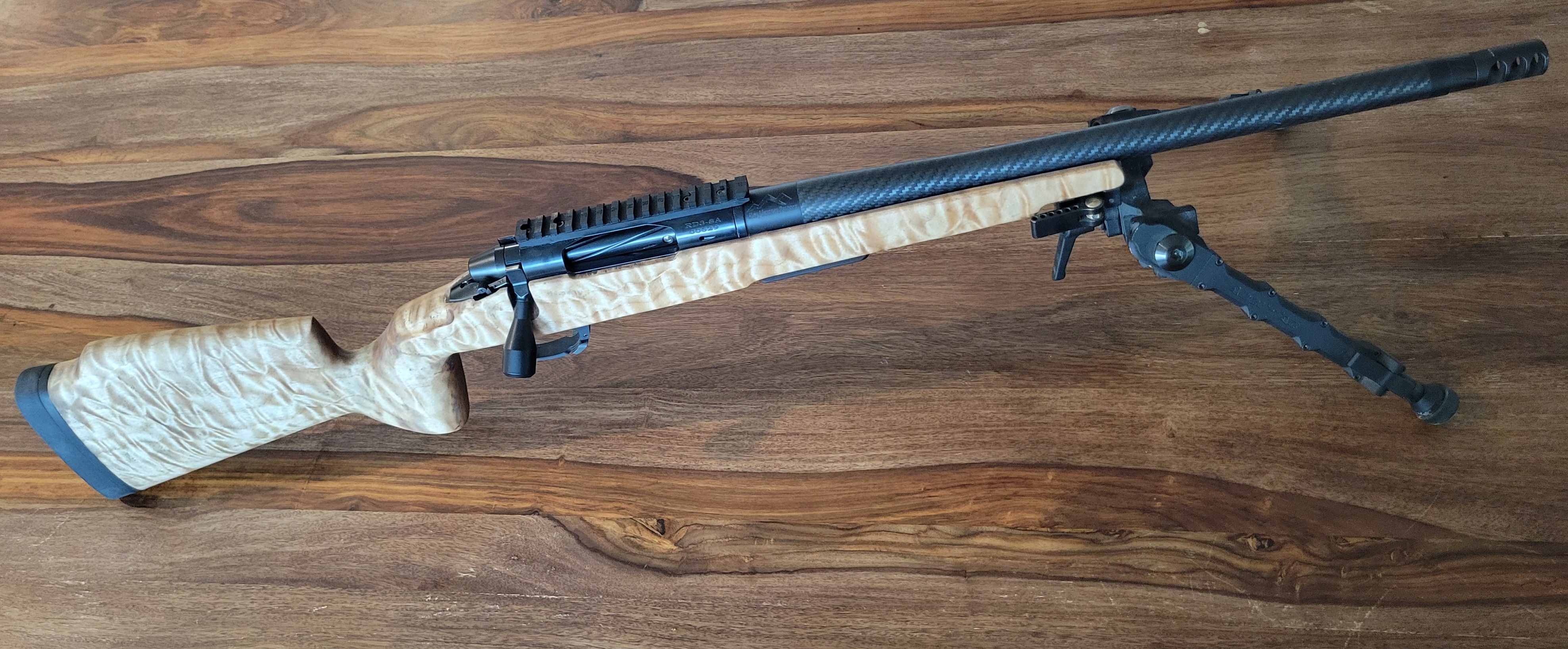

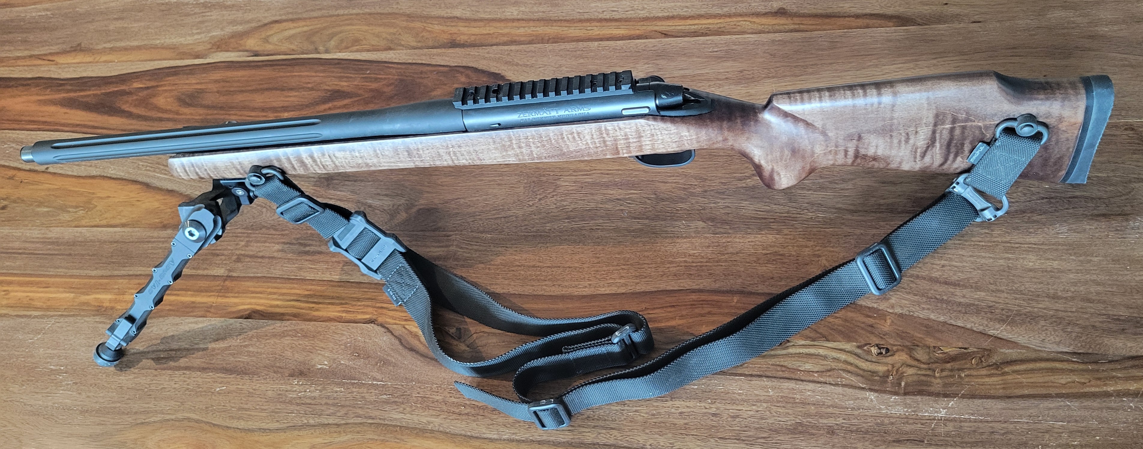

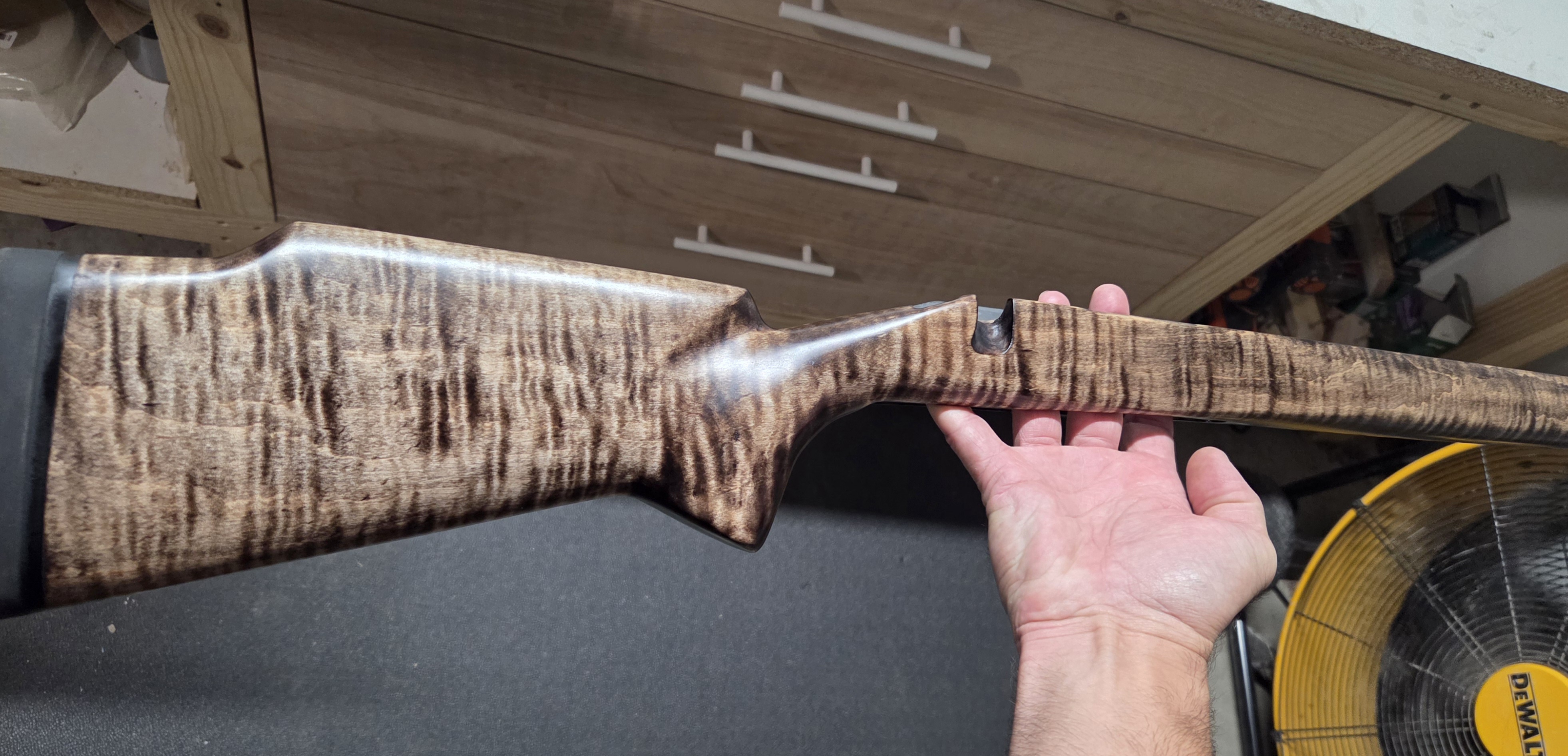

ROUND 1 - Target / Bench Rifle

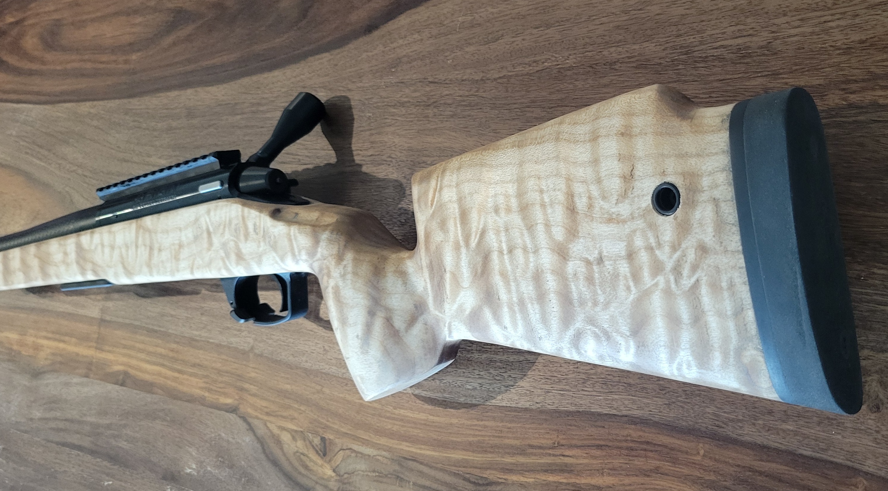

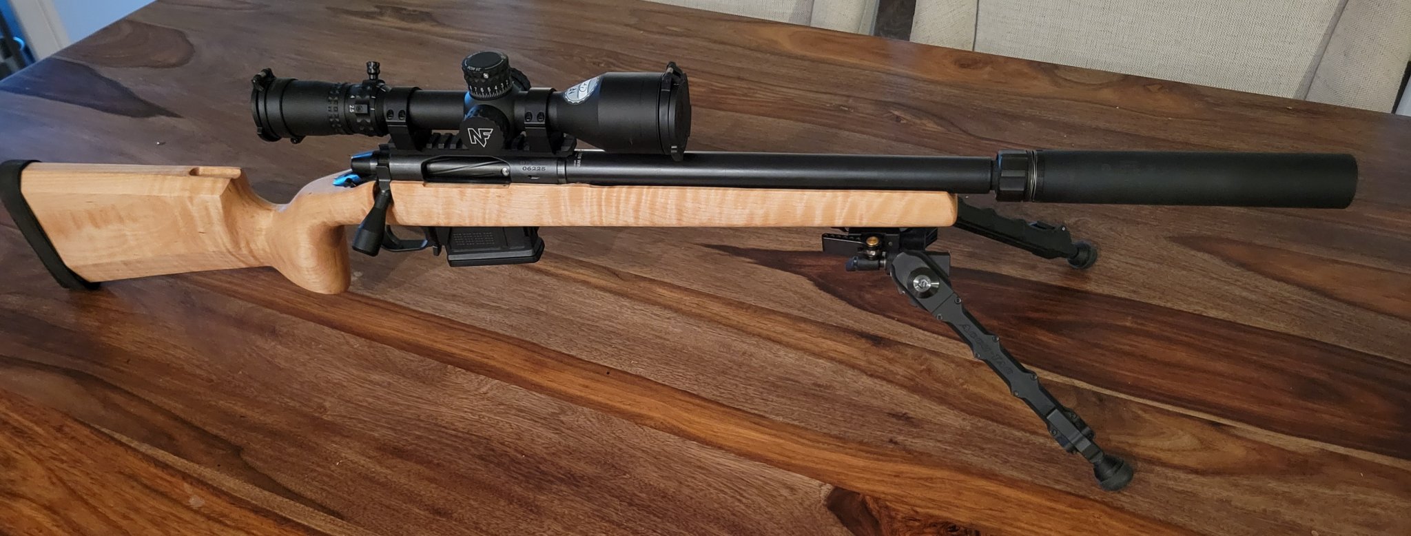

After 10-12 years of shooting aluminum chassis and stocks made with some sort of composite, I felt it was time to get back to wood.
Maintaining the form, fit, function of more modern stocks was important, but I wanted to gain the warmth, feel and beauty of wood.
I looked around and didn't see what I wanted, so I decided to make it myself.

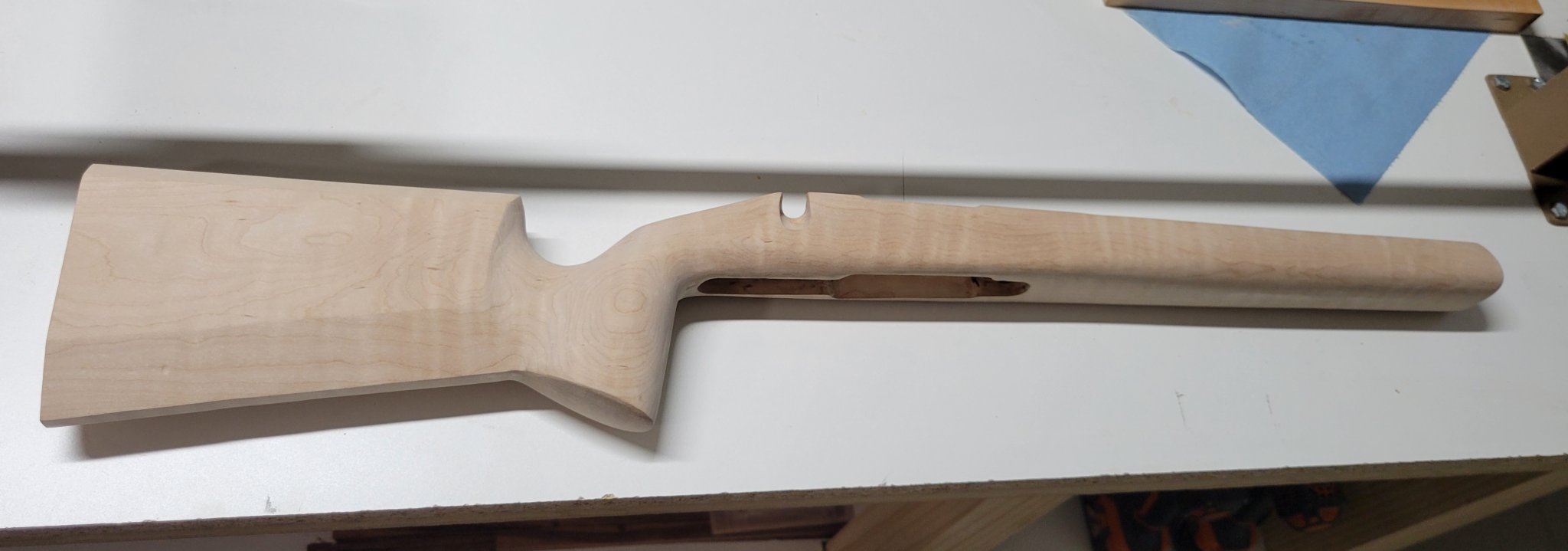

The Process:

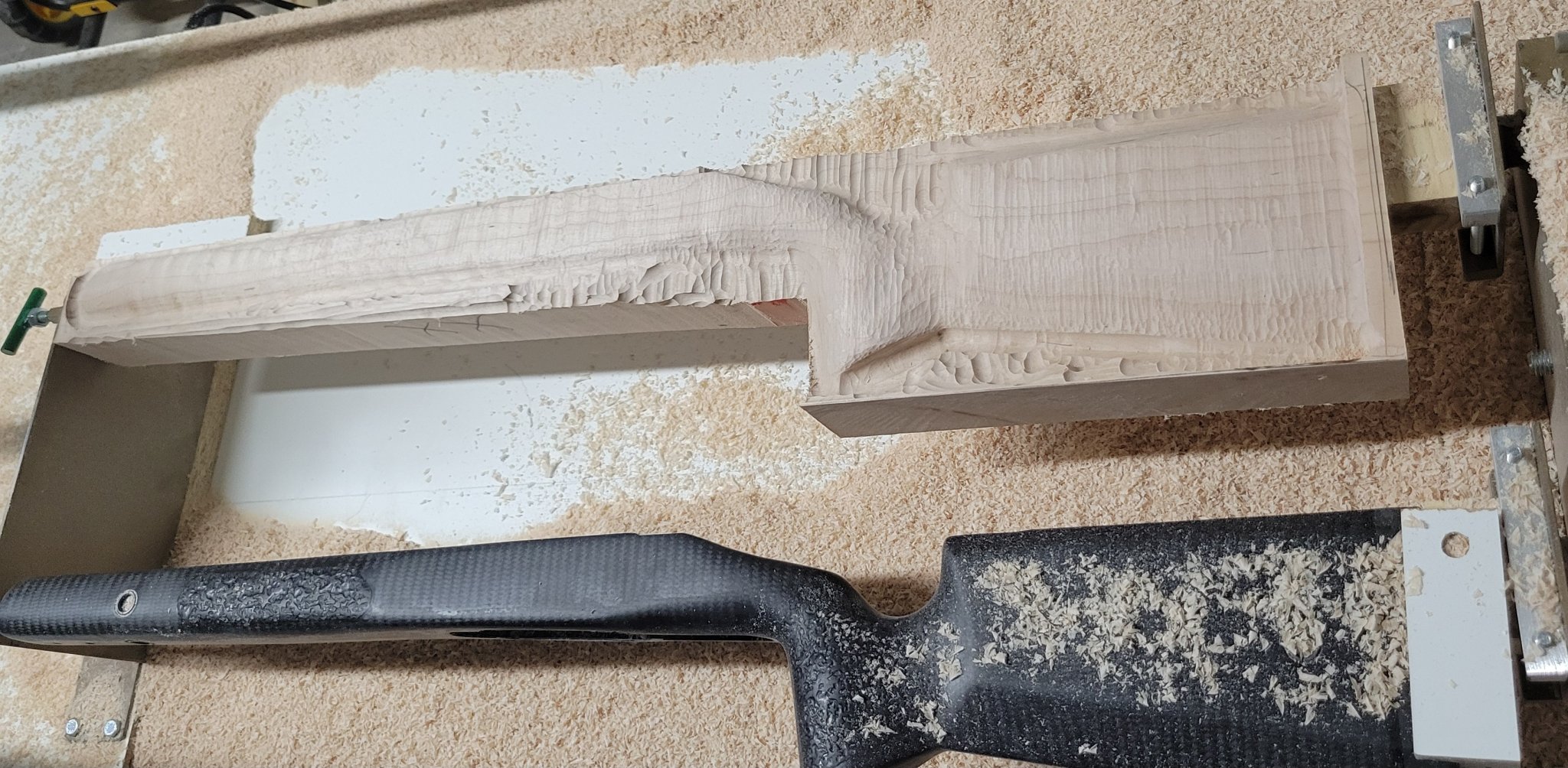

- Source curly maple blank
- Carve (rough pass) with router
- Contour and smooth (fine pass) with router
- Cut the inletting (action, bottom metal & barrel channel)
- Sand... there was a lot of sanding!
(80, 120, 180, 220, 320, 400 grit)
- Fit recoil pad with belt sander
- Add picatinney rail for bipod (drill and counter sink t-nuts)

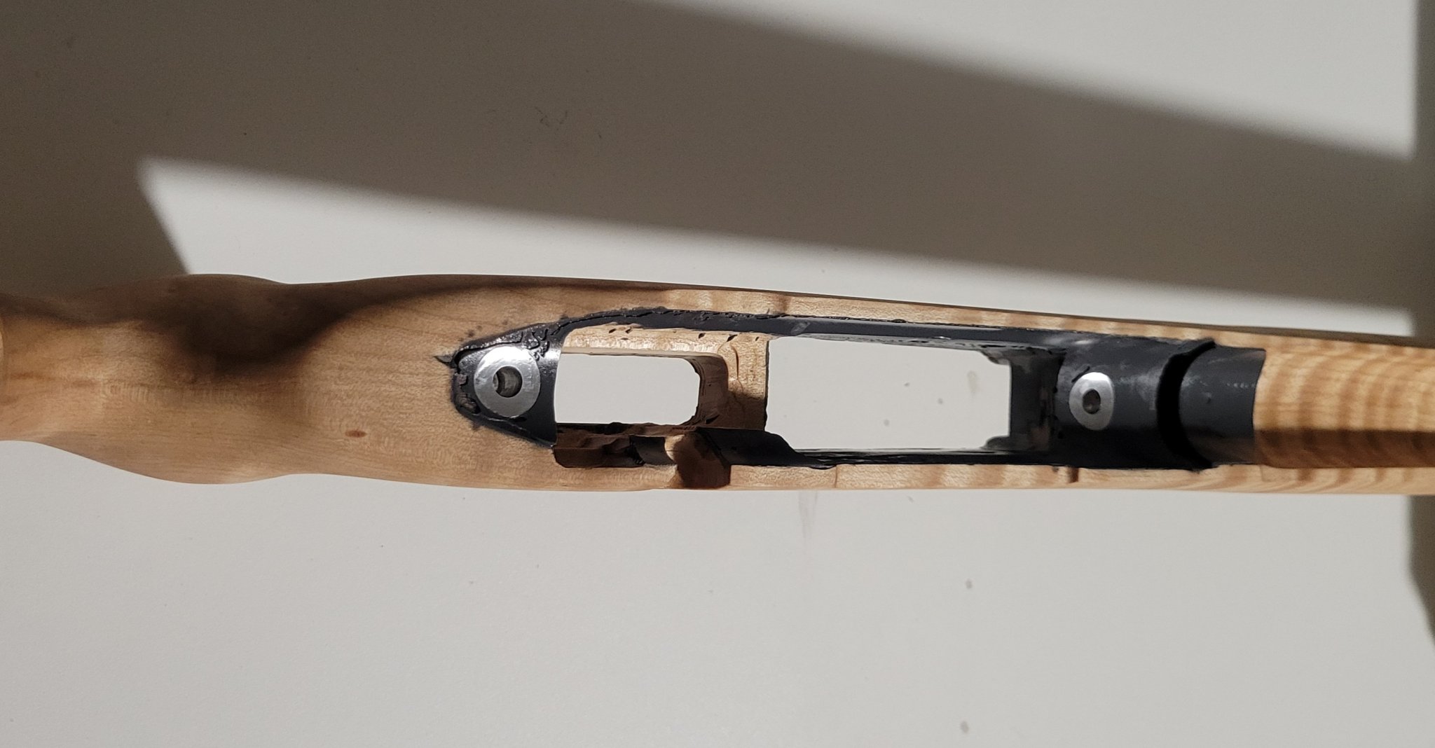

- Drop in pillars (checking action/bm fit, alignment & feeding from magazine)
- Epoxy bed action & bottom metal

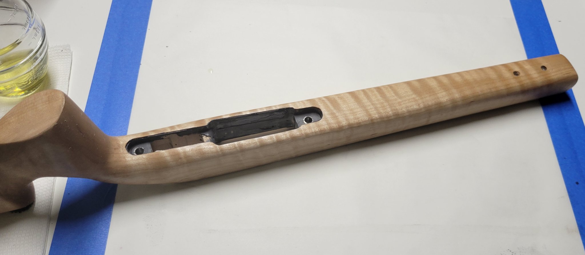

- Apply tung oil finish (2 sealer coats cut 1:1 with mineral spirits for deeper penetration)
- 100% Tung Oil sanded in at 600, 800, 1000 and 1200 grits

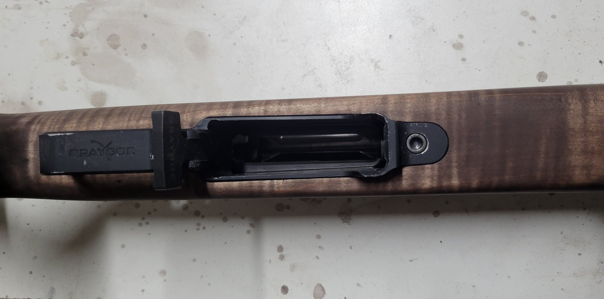

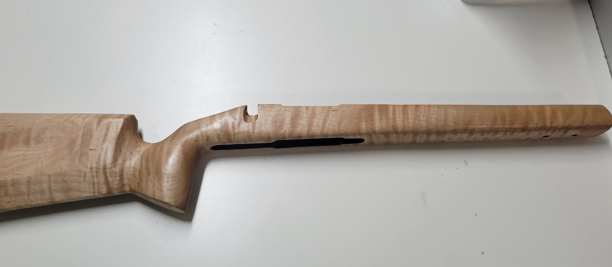

The Results:
I have several more blanks on hand, now what to do with them?...

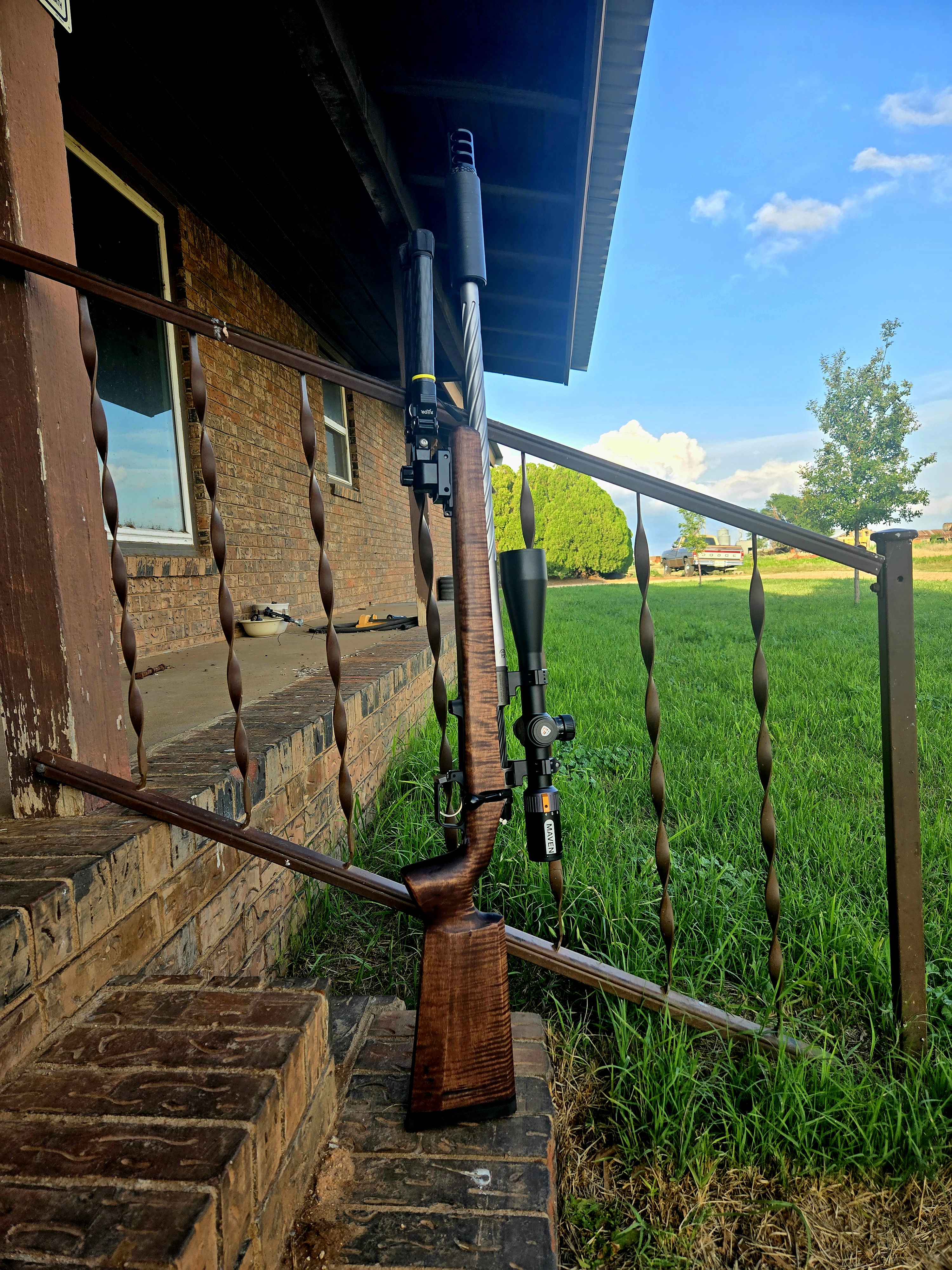

I have wanted a curly maple prone stock pattered off the Robertson Composite original for years. They have a very thin pistol grip and would need a metal rod in the grip, but man would that stock set my AI Coopermatch off. Anshutz rail stopped 3/4 from the end of the stock, WTC cheek piece and a three way buttplate.
Wood stocks have a different recoil for sure. Much more shuttle and subdued compared to aluminum or even synthetic. As well as a warm feel while shooting them.
Only issue is they are so damn nice nobody want to take them out when there is a chance of weather :)

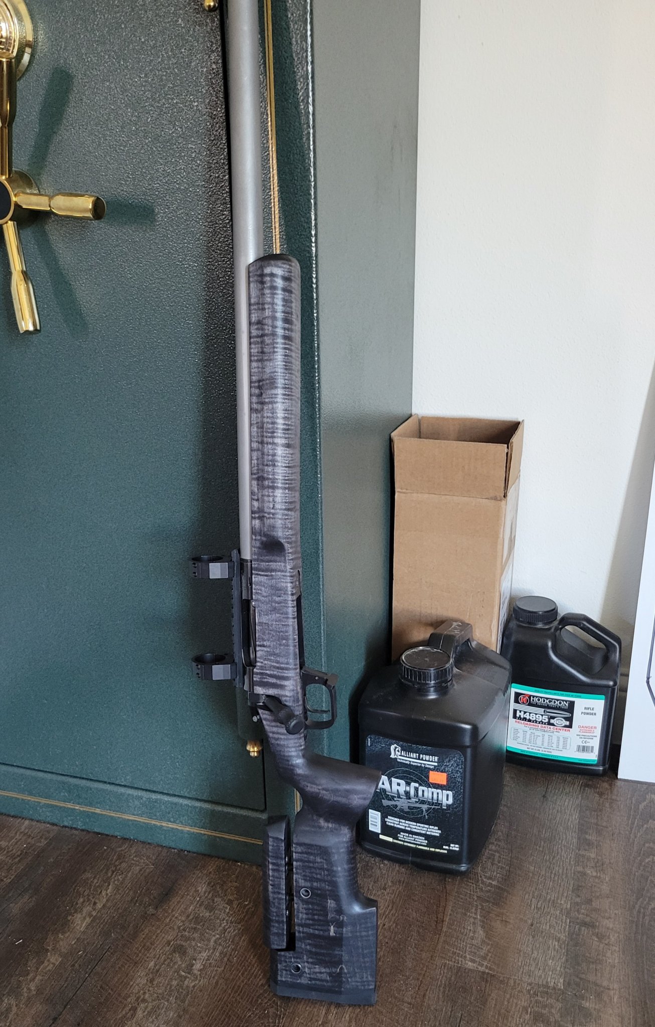

Made it out to do some quick pressure testing. I wanted to see what lighter bullets and faster powder could do from the 14.5.
Ten rounds per bullet/powder combo loaded in 0.4gr increments, shot at 100 yards, same POA.
Start and finish loads of AR-Comp represented below.
125 Speer TNT (cheap paper puncher)
44.4gr @ 2621fps
48.0gr @ 2858fps
130 Barnes TTSX (deer & hogs)
41.8gr @ 2574fps
45.4gr @ 2746fps
I did not observe pressure signs at the highest charges, but don't see any reason to climb higher.

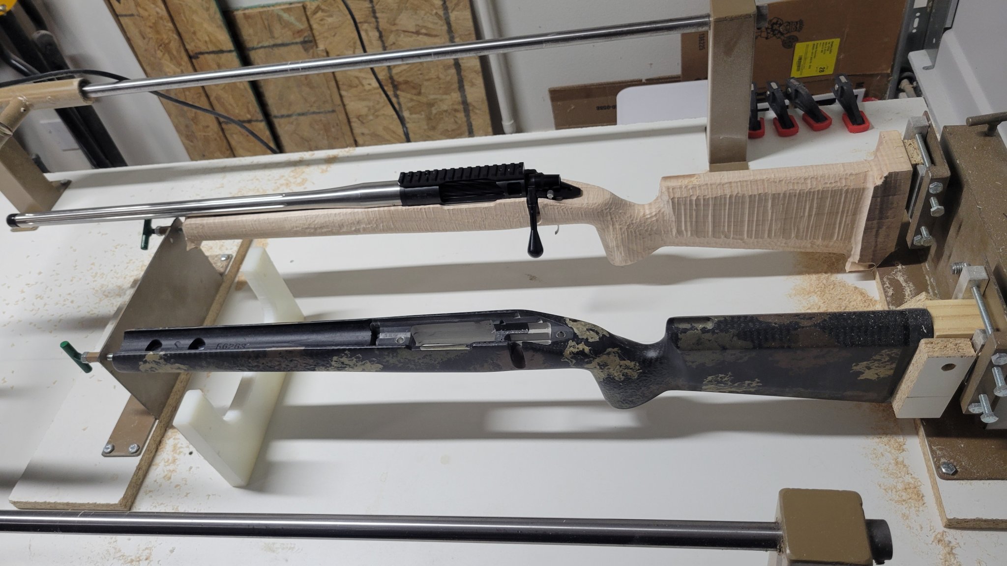

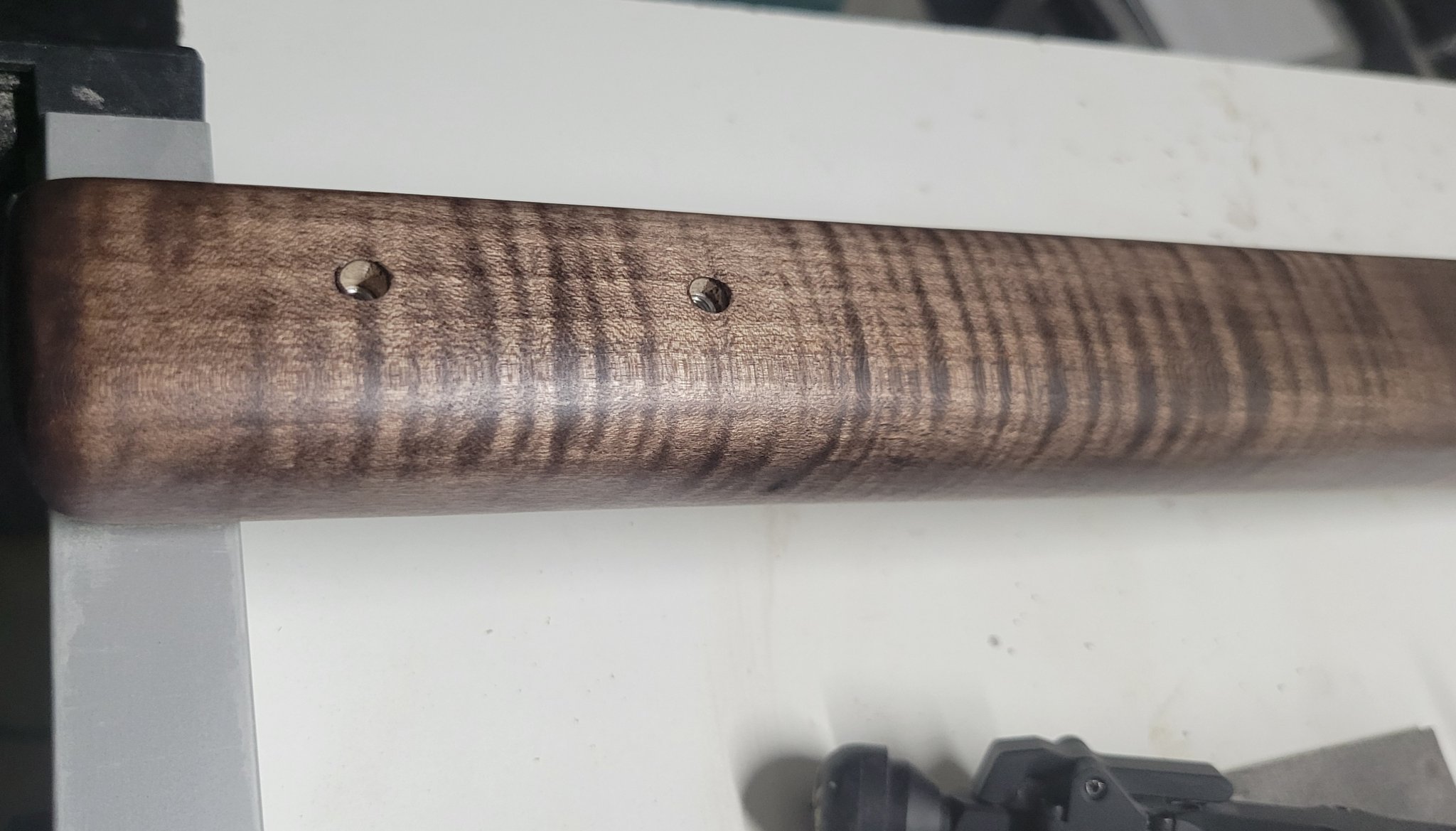

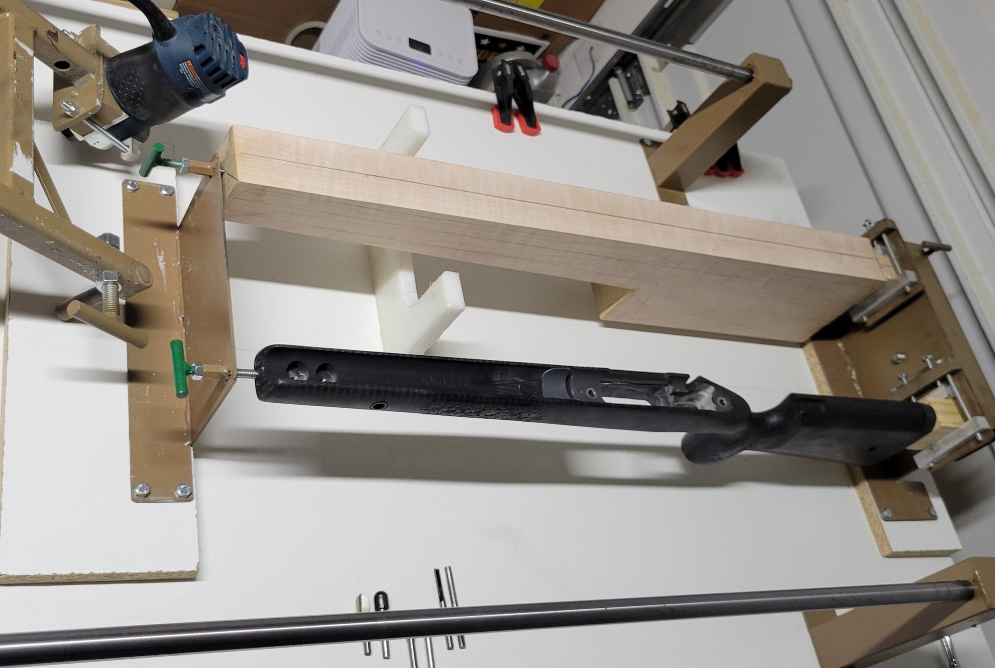

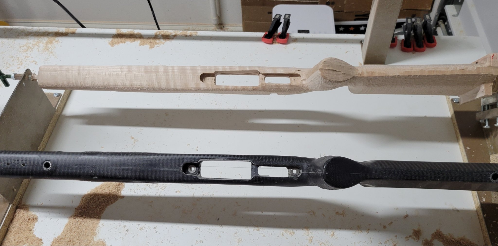

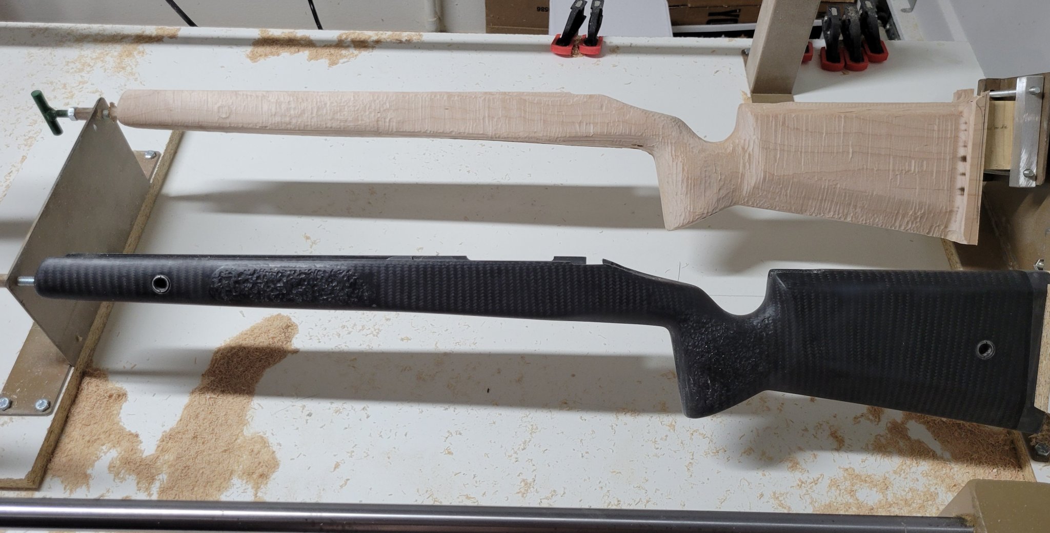

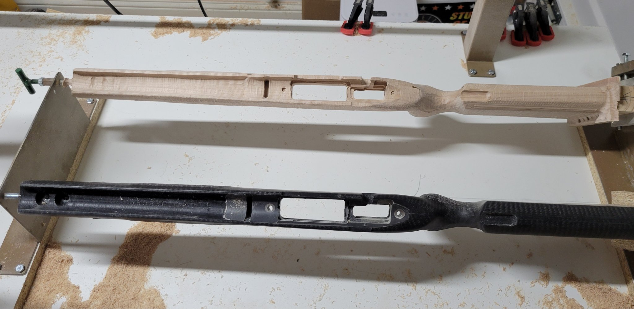

This intimidating piece of maple might become home to a Zermatt Rim X, but I need to find an action first.
I take it that’s a duplicator in your pics (but different than ones I’ve seen). Do you use it for some commercial work of yours or was this set up just to do this stock?
Right now it's just a hobby. Something to keep my mind right after the kids go to bed and on my off days.
I have several hunting and target rifles I plan to make stocks for, then a few 22s for the kids.
I'm in the process of sourcing more stocks to use as templates. I'd like a bunch of styles on hand to suit the purpose of each rifle.

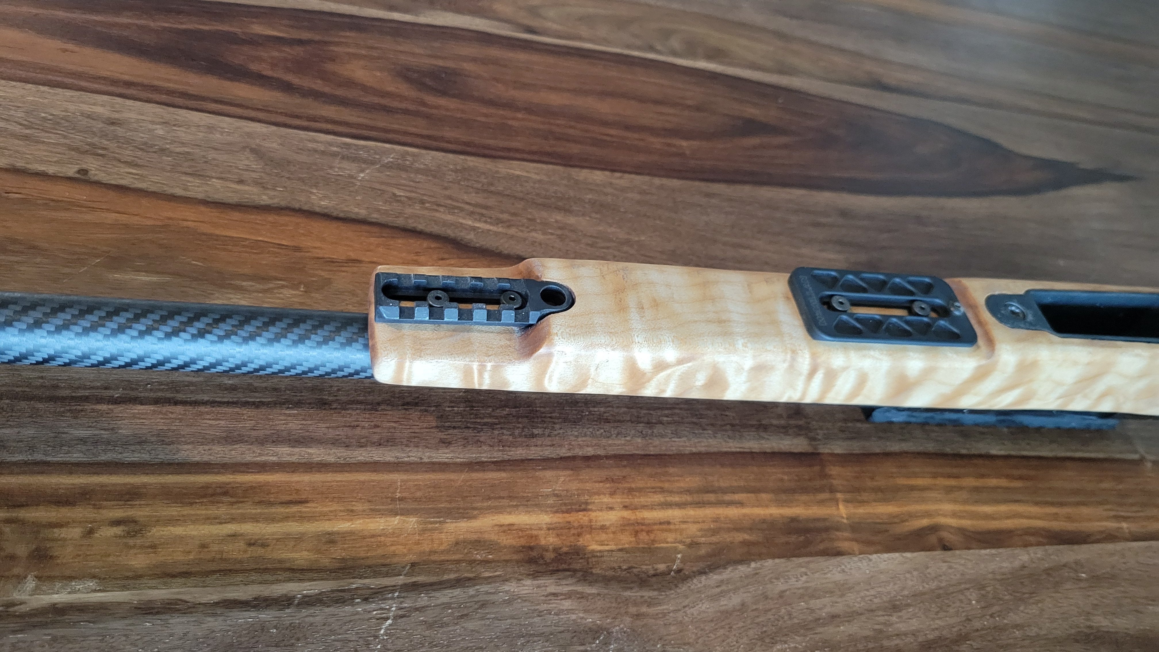

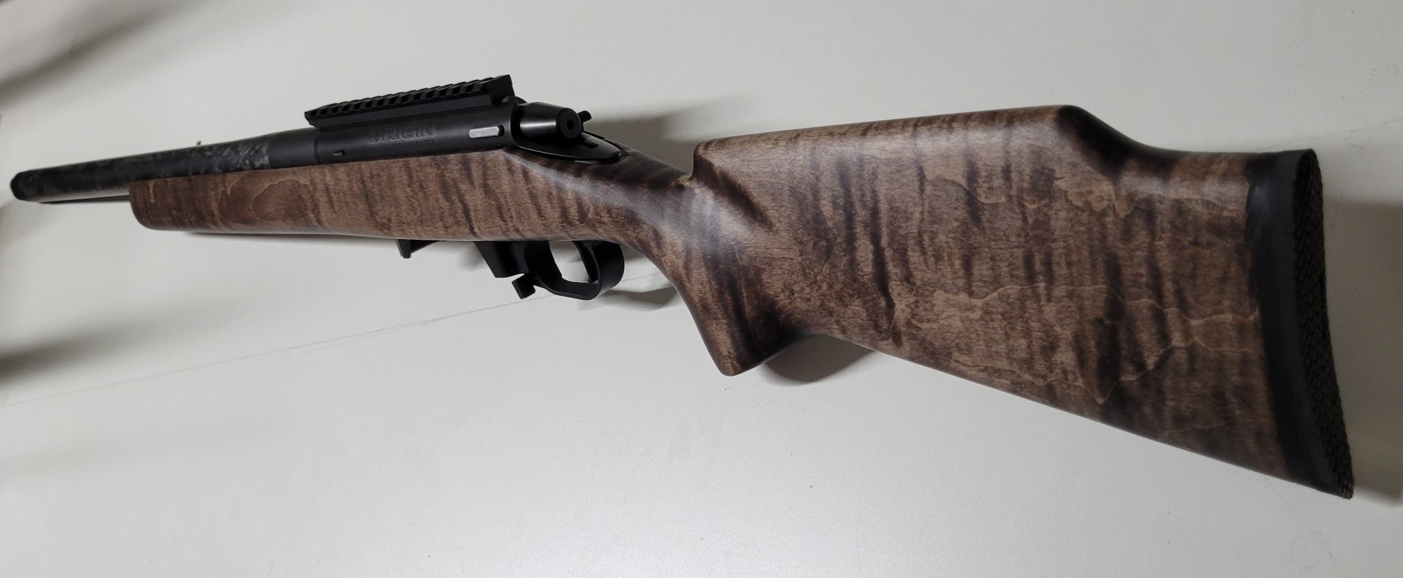

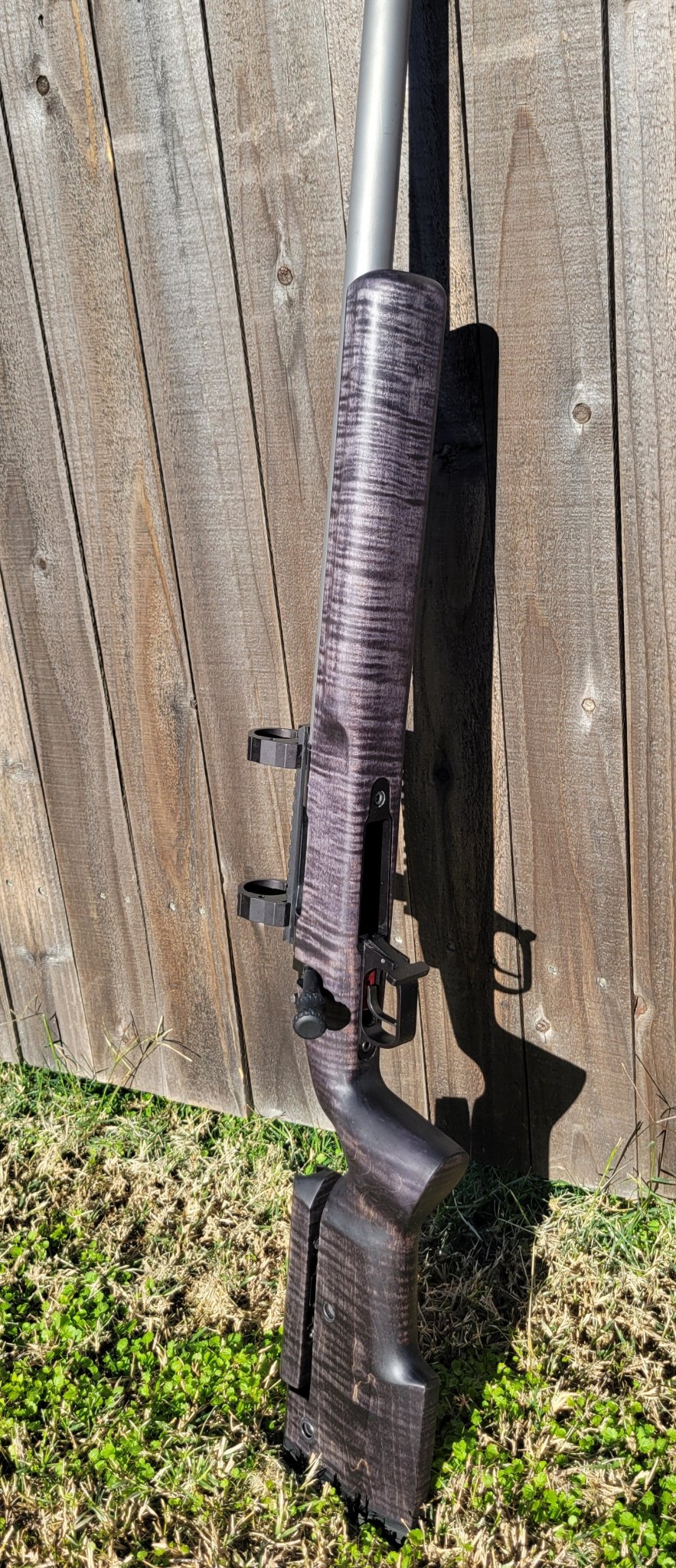

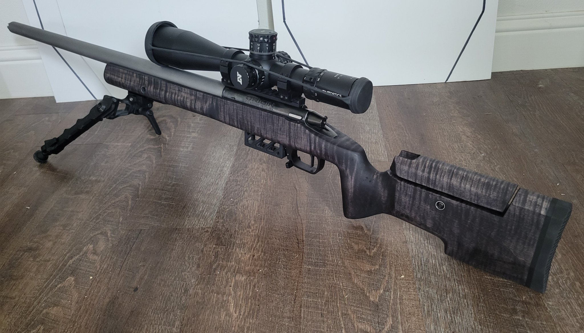

ROUND 2 - Compact, Lightweight Hunting Rifle
Origin SA, Competition Bolt with TT Diamond.
PVA, 16" Proof CF 308 Win

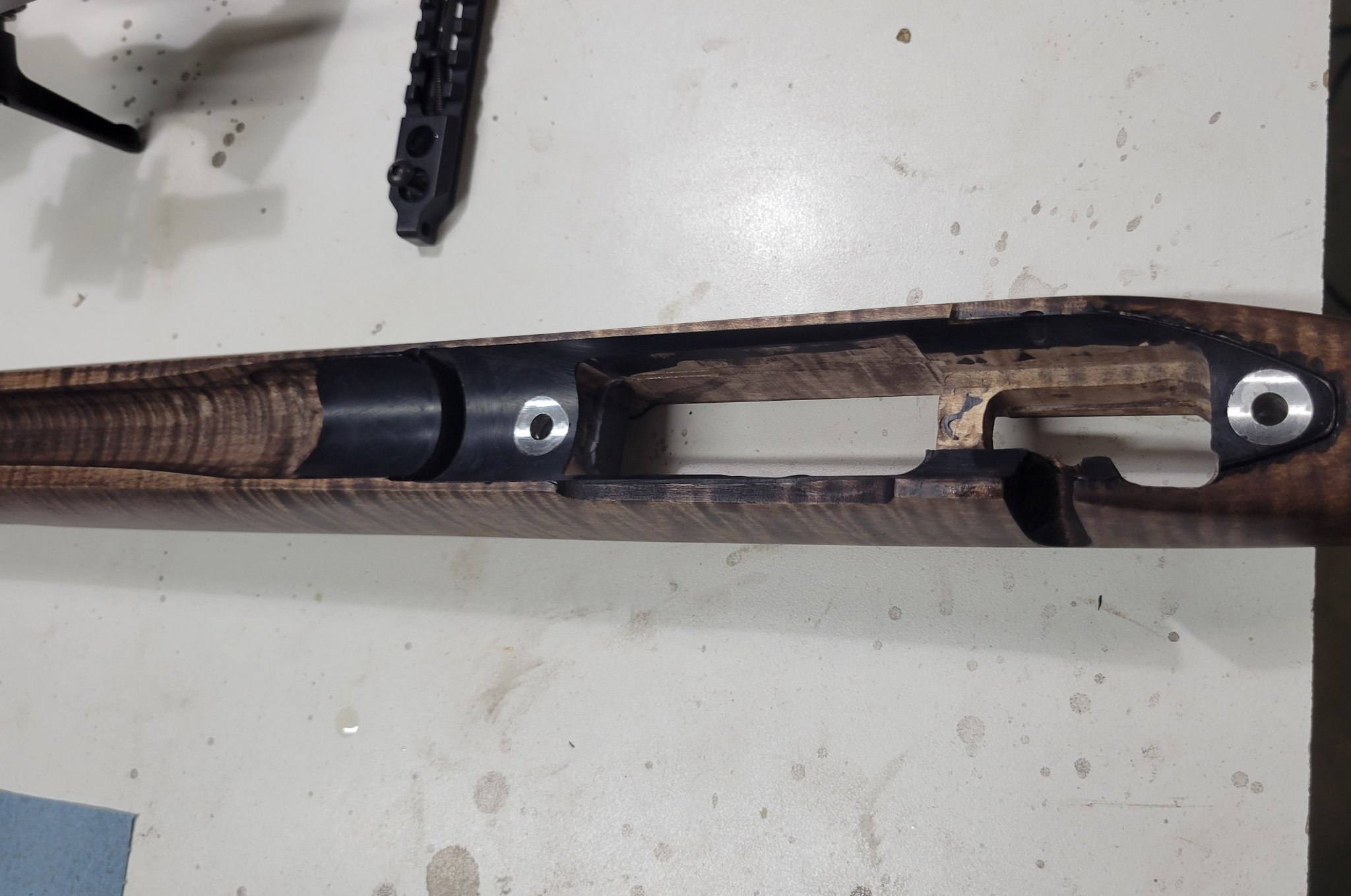

Hawkins DBM
Pillar & Epoxy bedded
6lb 6oz as pictured

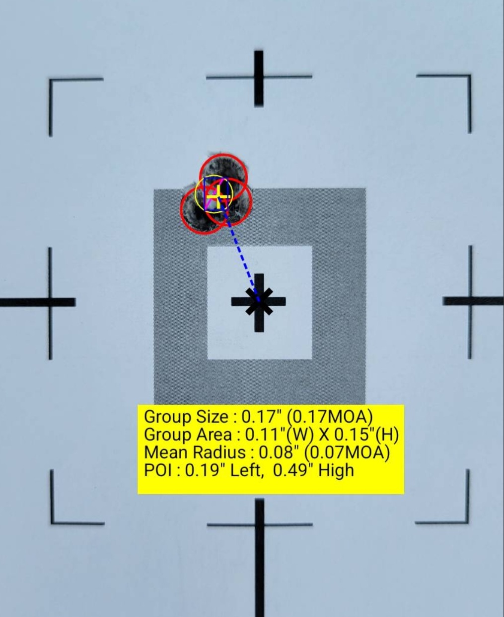

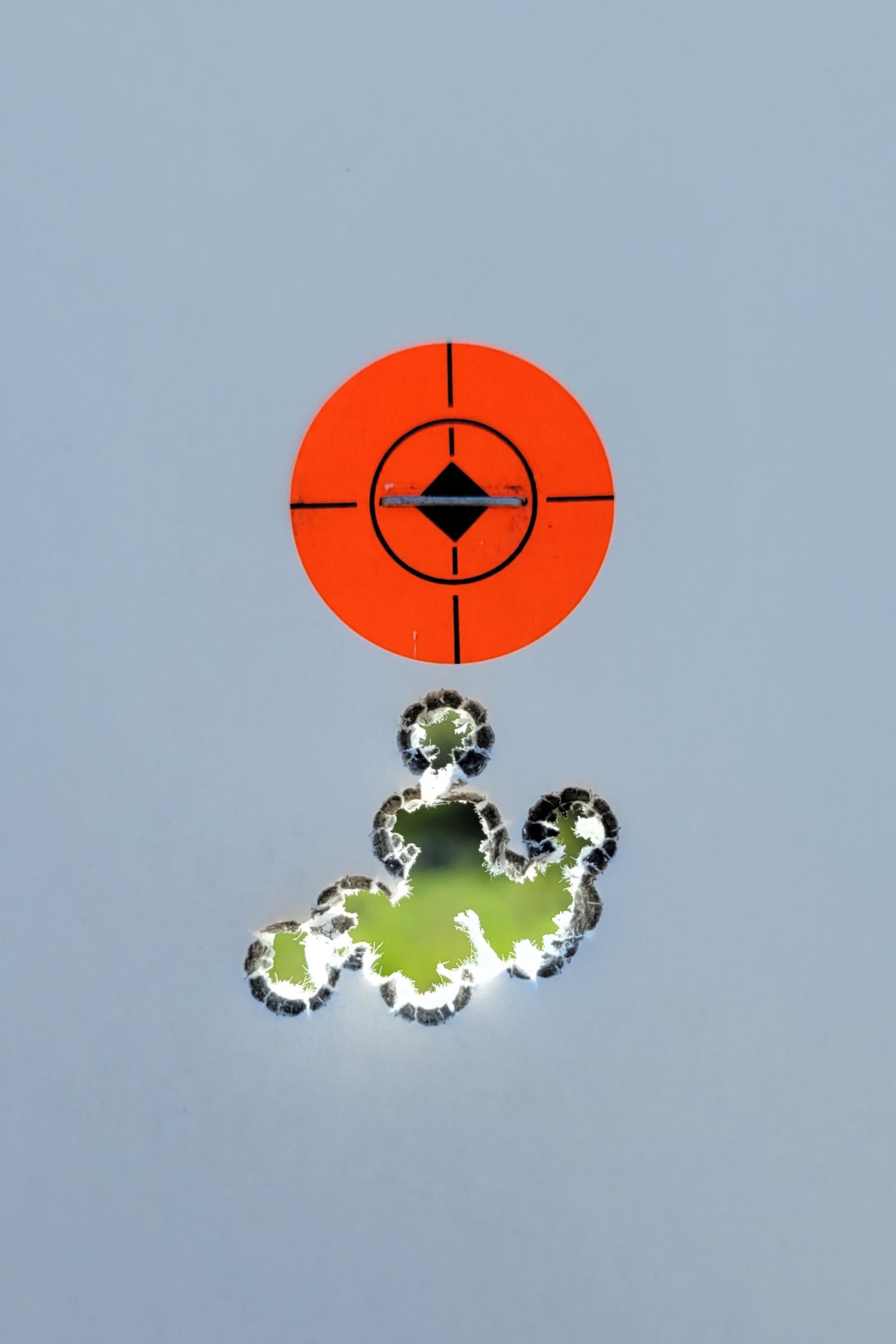

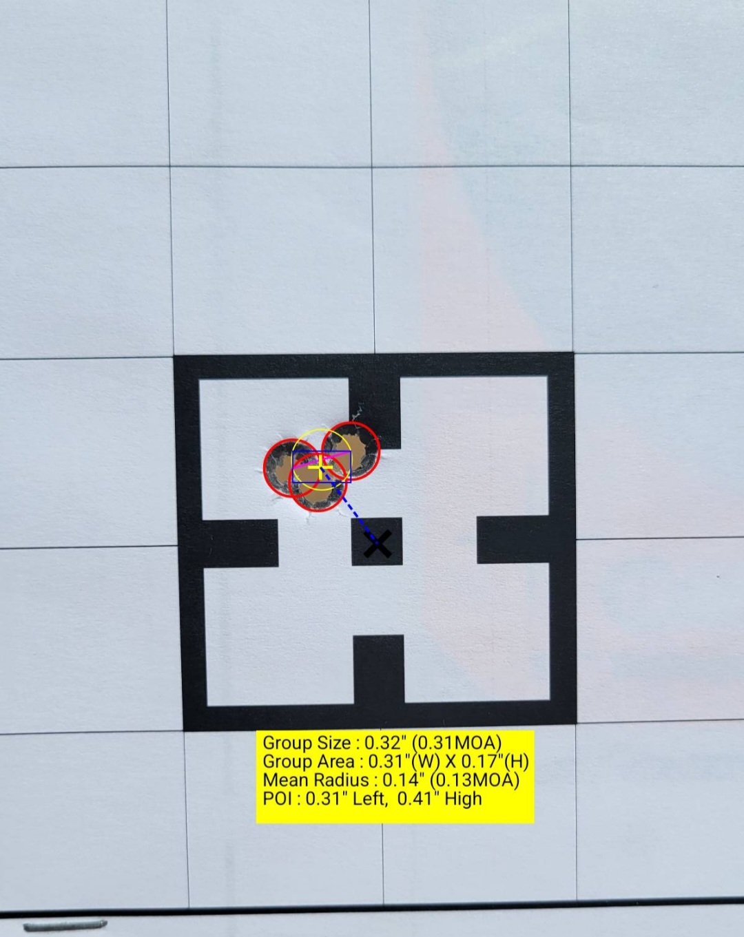

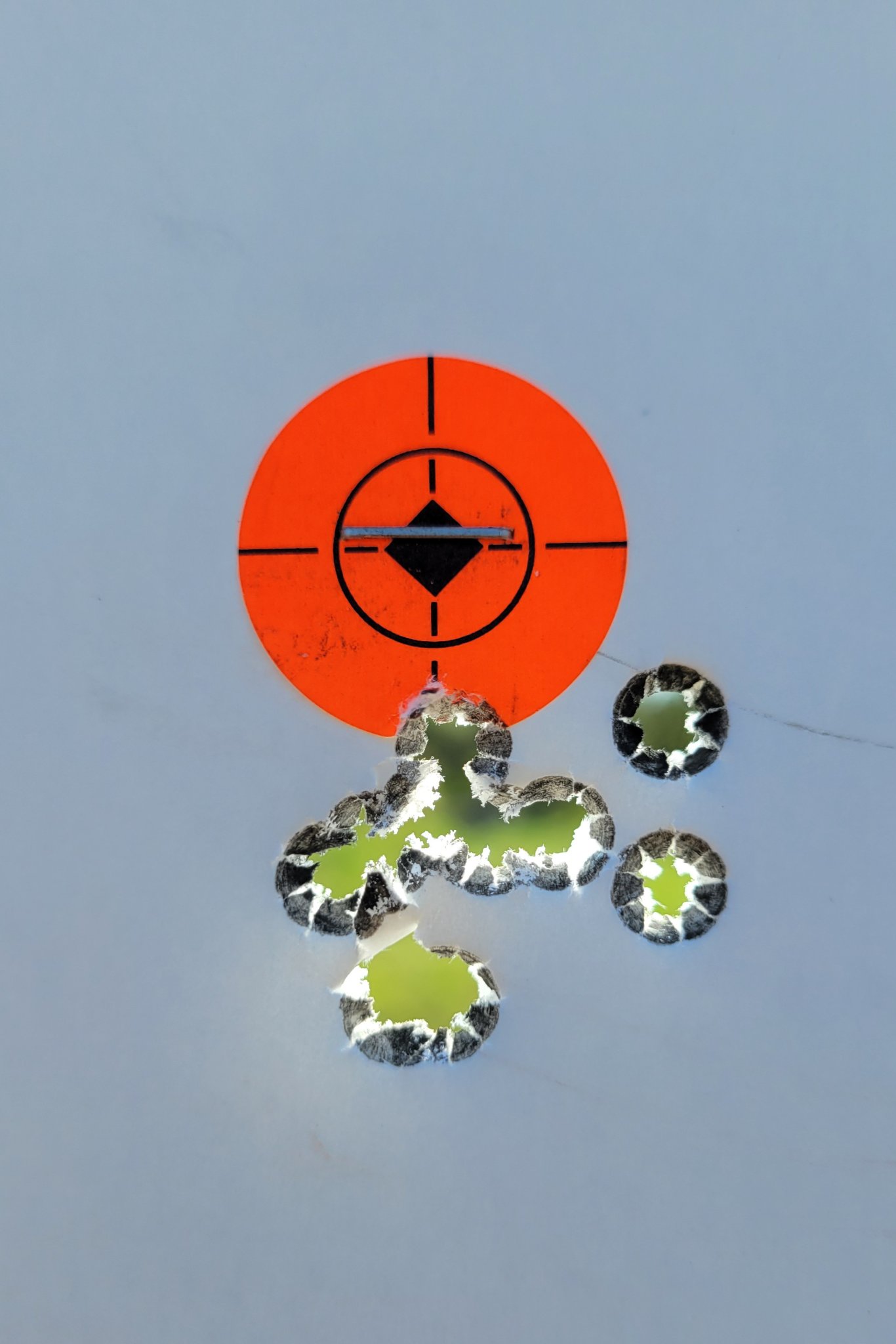

First five shots through this one... two sighters at top left corner, followed by a three shot group on the bottom left.

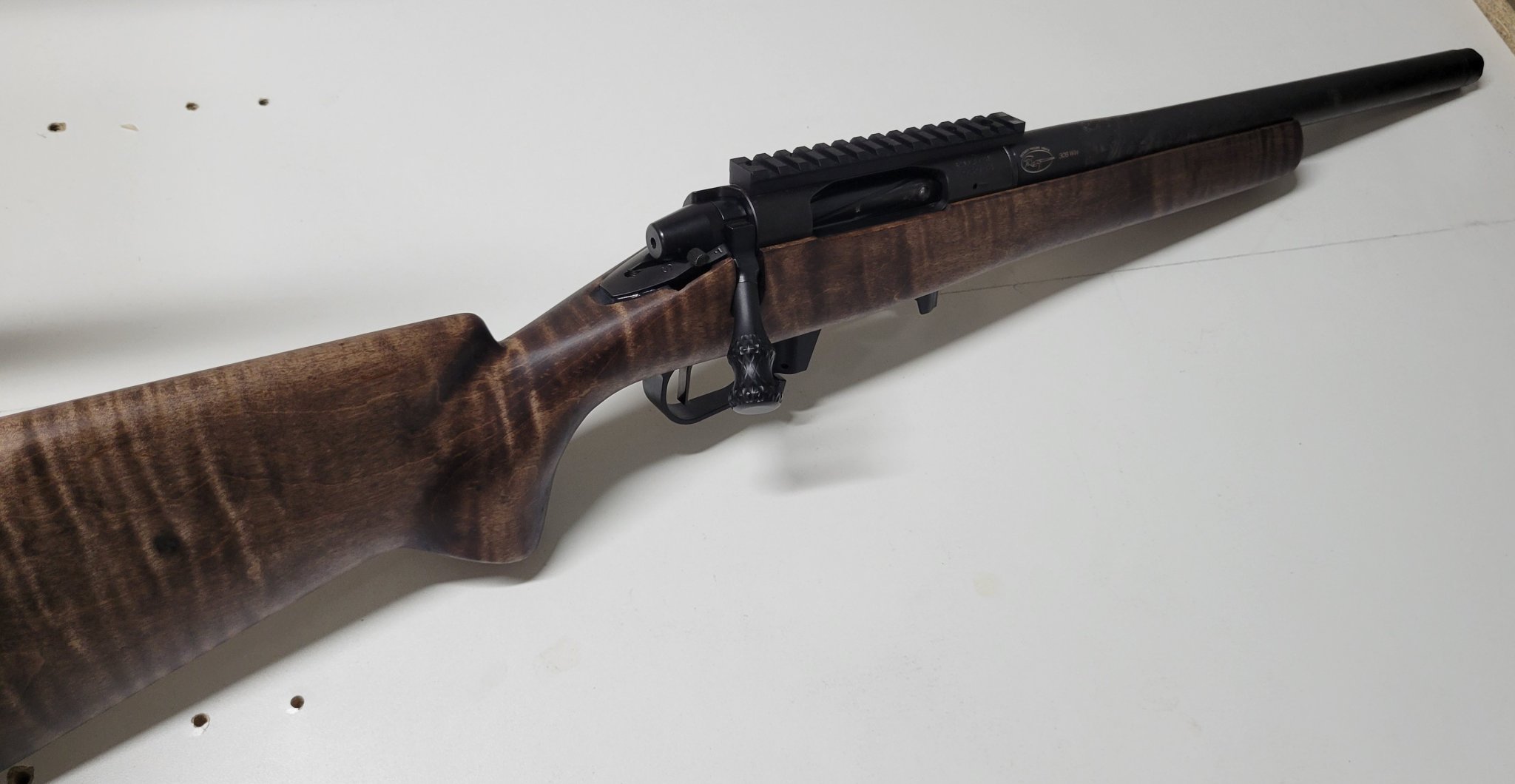

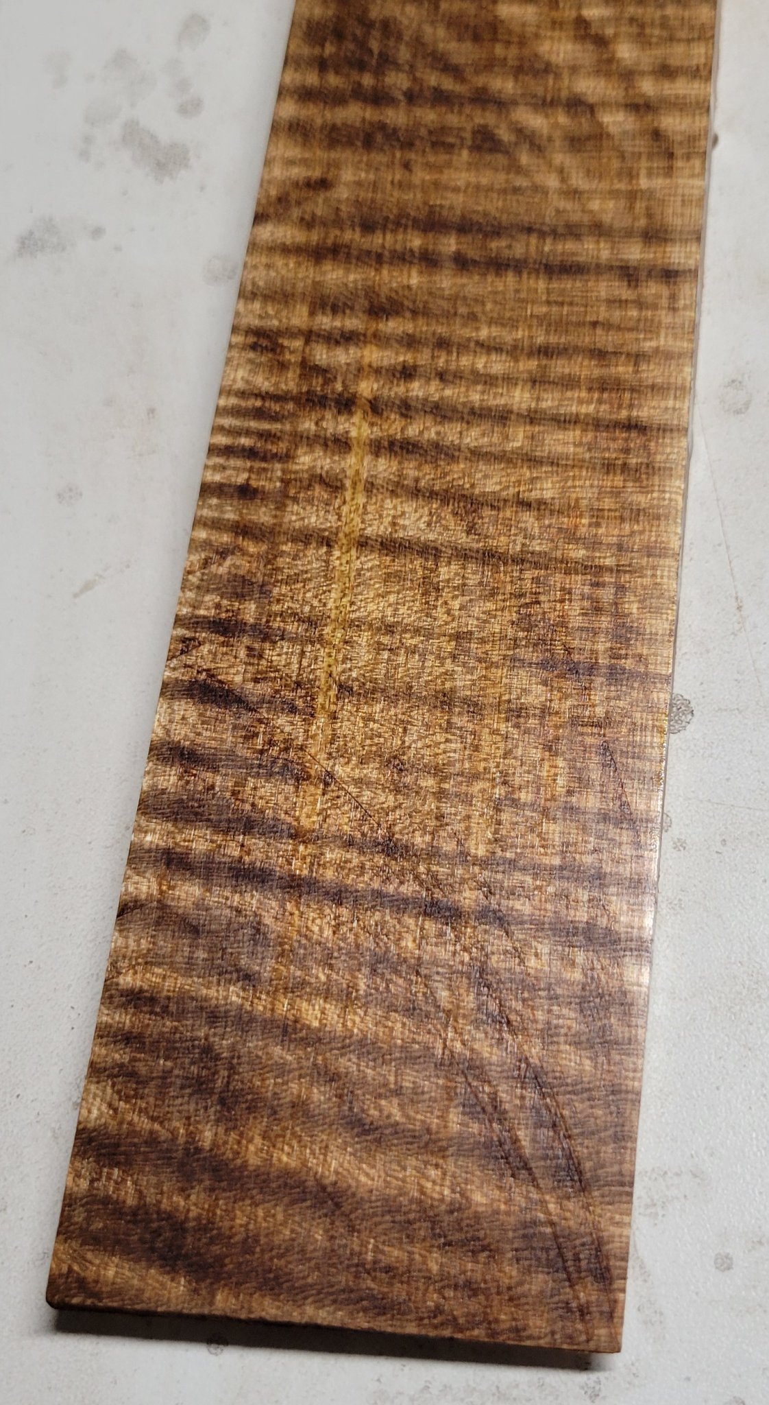

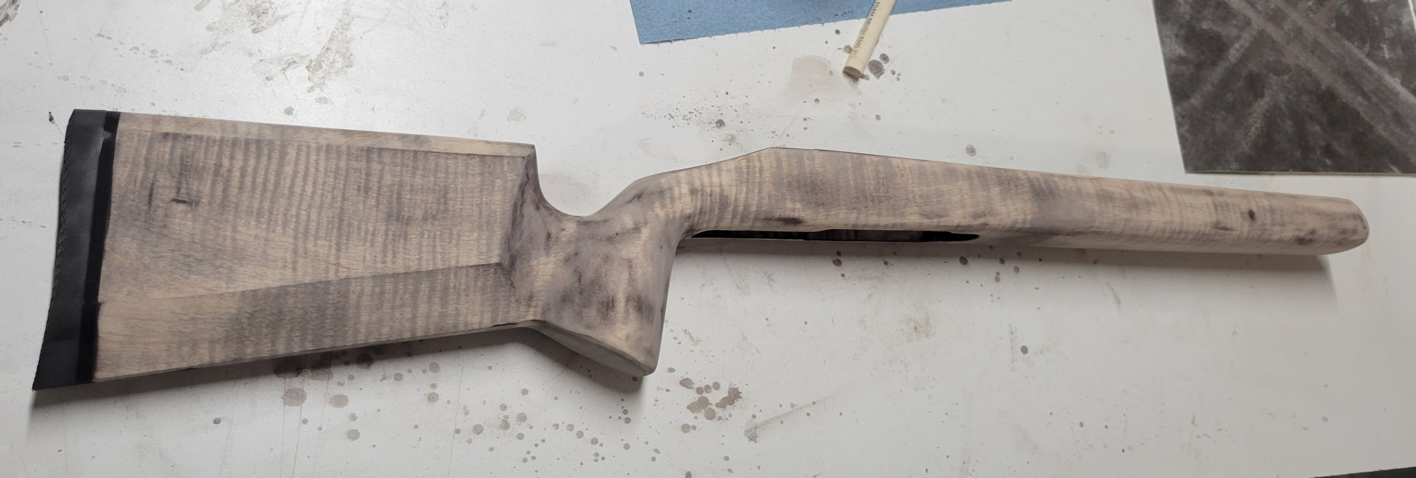

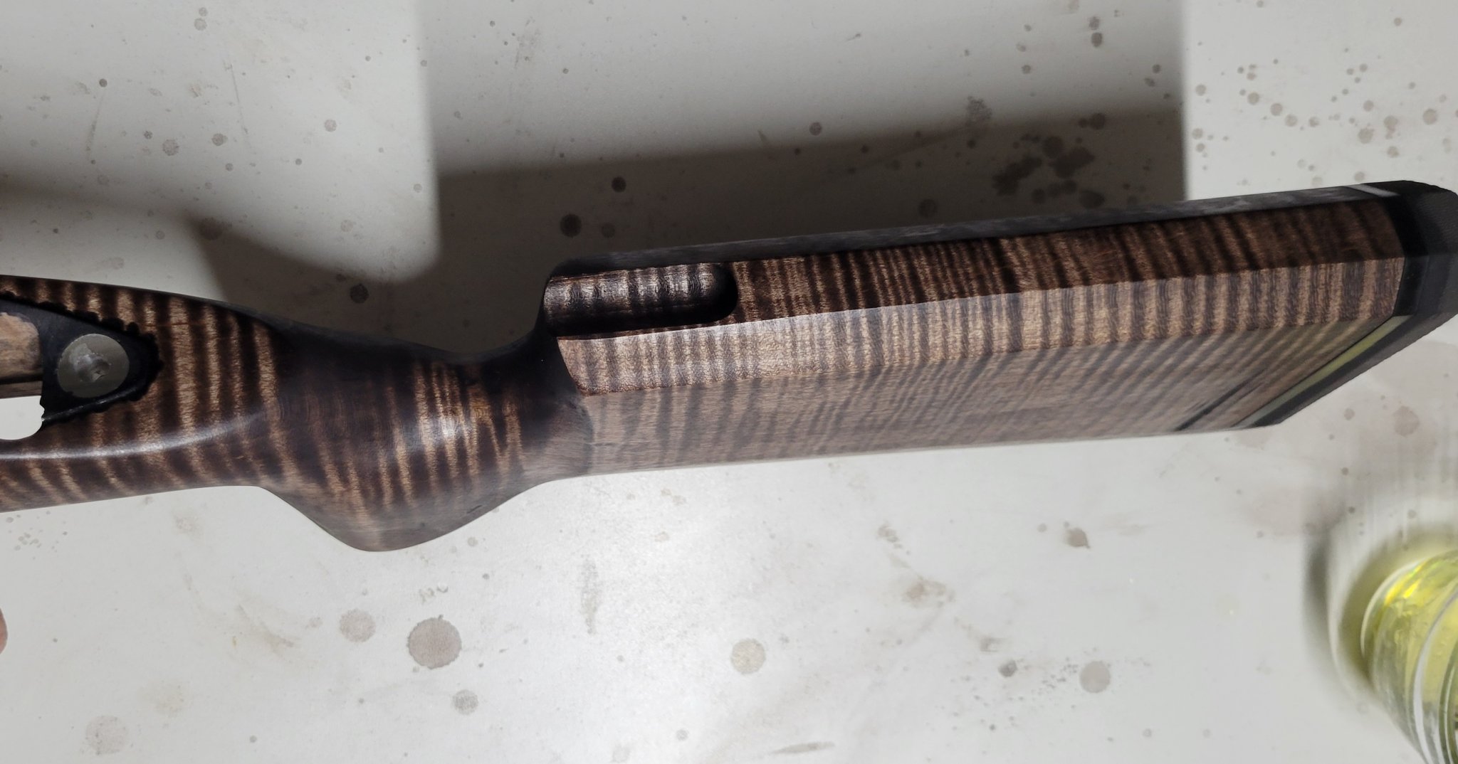

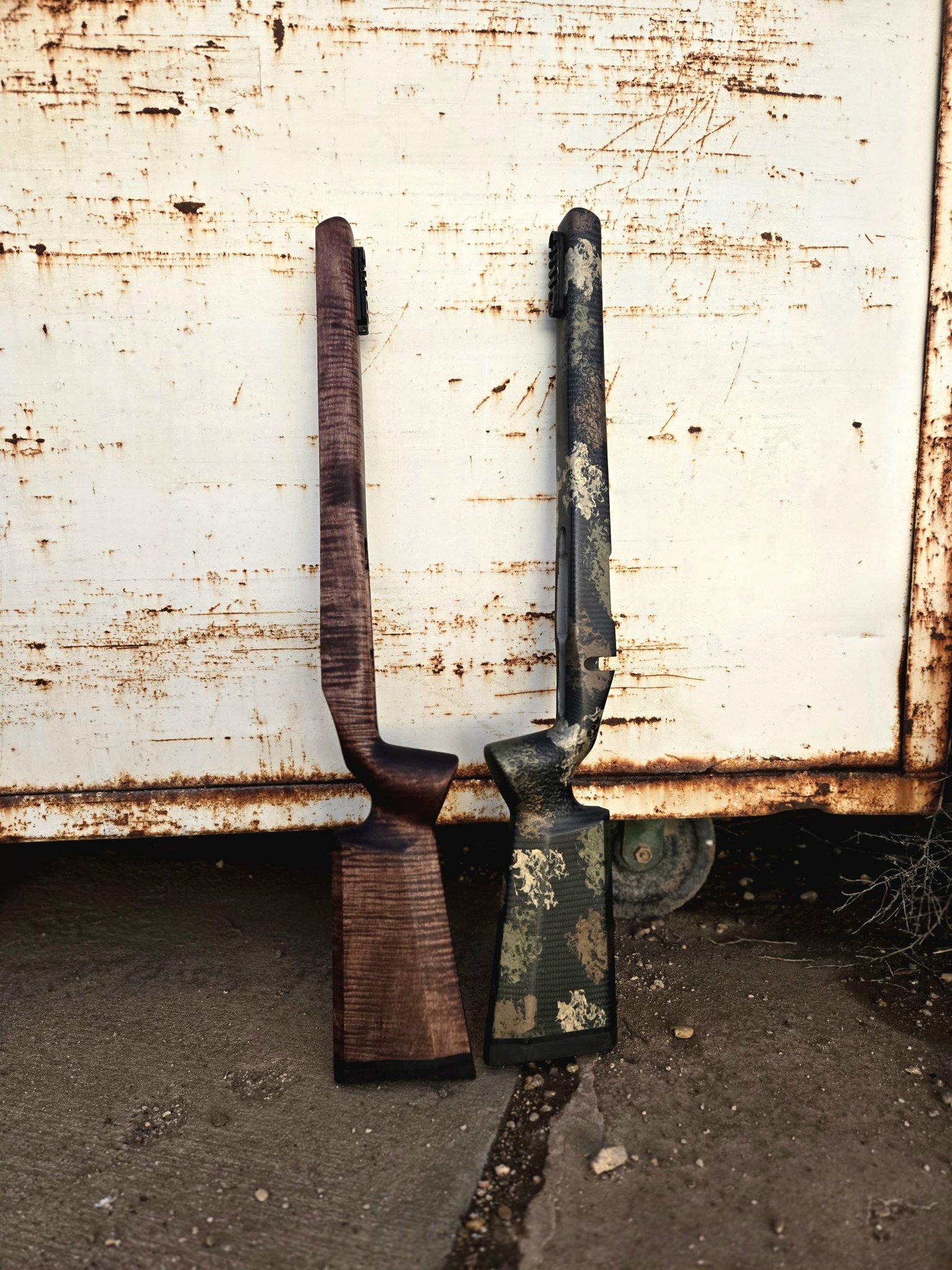

You'll have to excuse the saw marks, I didn't bother sanding them out just to test some color combos on scrap wood.
Coffee Brown, Copper (Med Brown / Red), Vintage Maple

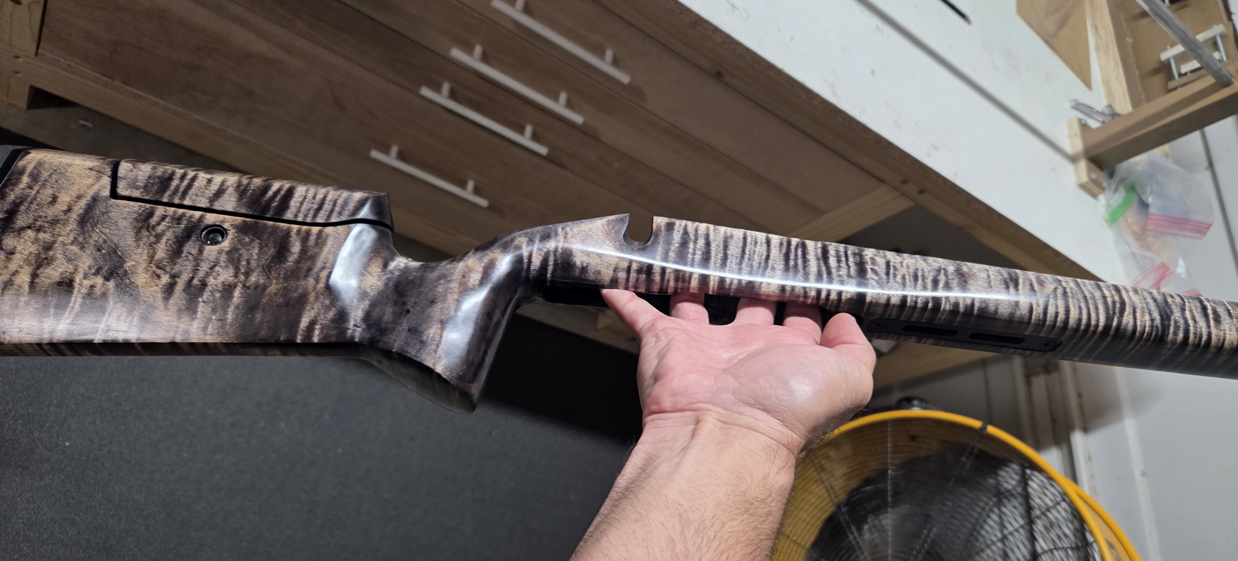

This one really "dances" in the light.

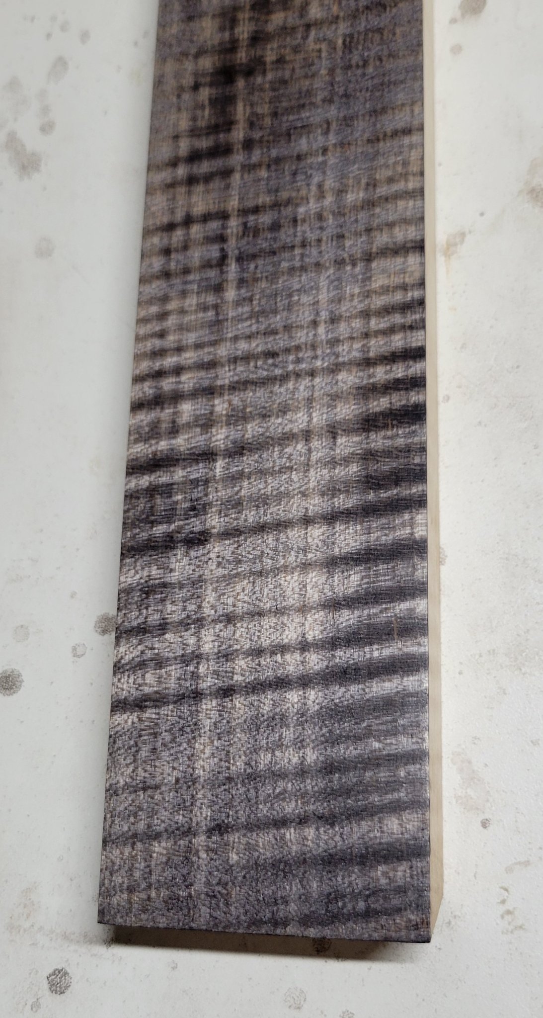

Black, followed by thinner coats of black. Reminds me of the salt and pepper laminate stocks and would look good against black or stainless barreled actions.
Reactions: 806guns and Modoc

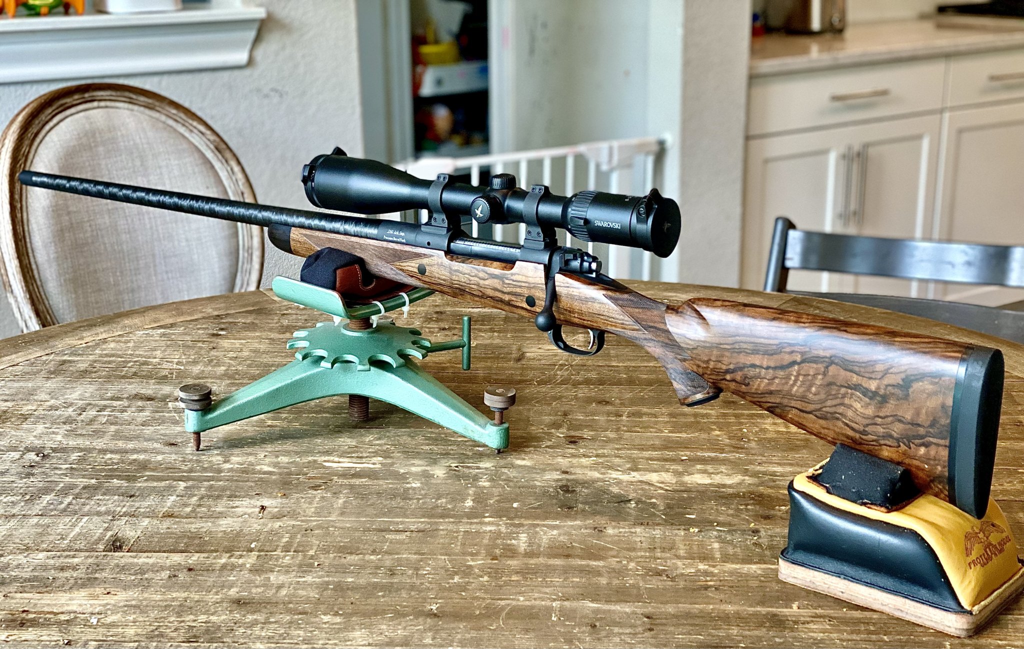

I love it and have thought about doing the same.

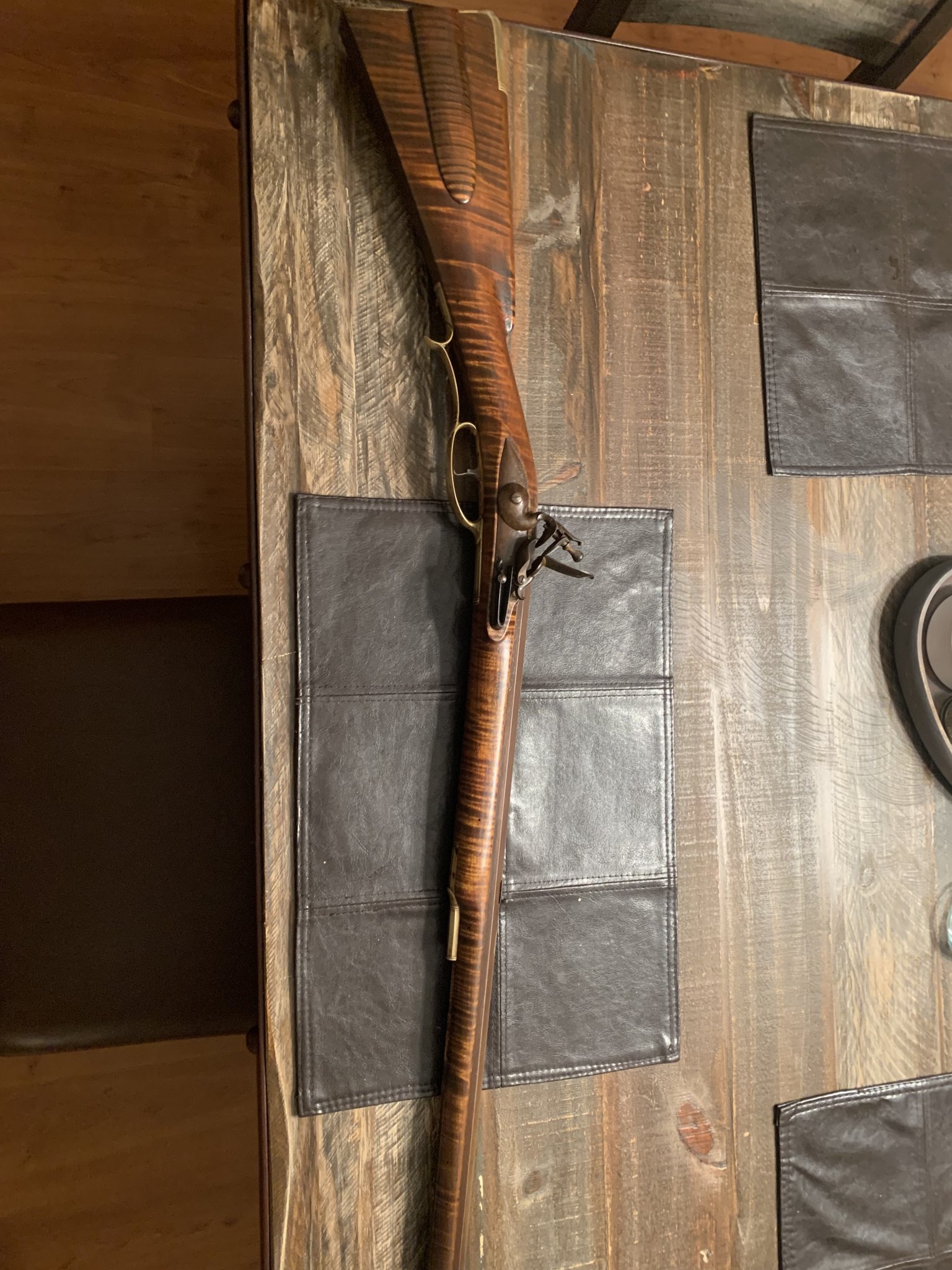

Closest I have gotten was by complete accident with my Turkish Walnut M70 280 AI...put a 26" Carbon Wrapped Bartlein 8 twist on it and it stacks 180gr Berger VLD's with regularity. The stock actually started out for another more conventional build and the stockmaker sent me pics saying it wouldn't hold checkering so I sent the turned stock back to the wood supplier to inspect. He called me 3 months later and said he found no issue with the wood and had another smith that said he could finish it if wanted. All I had laying around was my 280 AI barreled action so I sent it to him and I was blown away when I got it back.

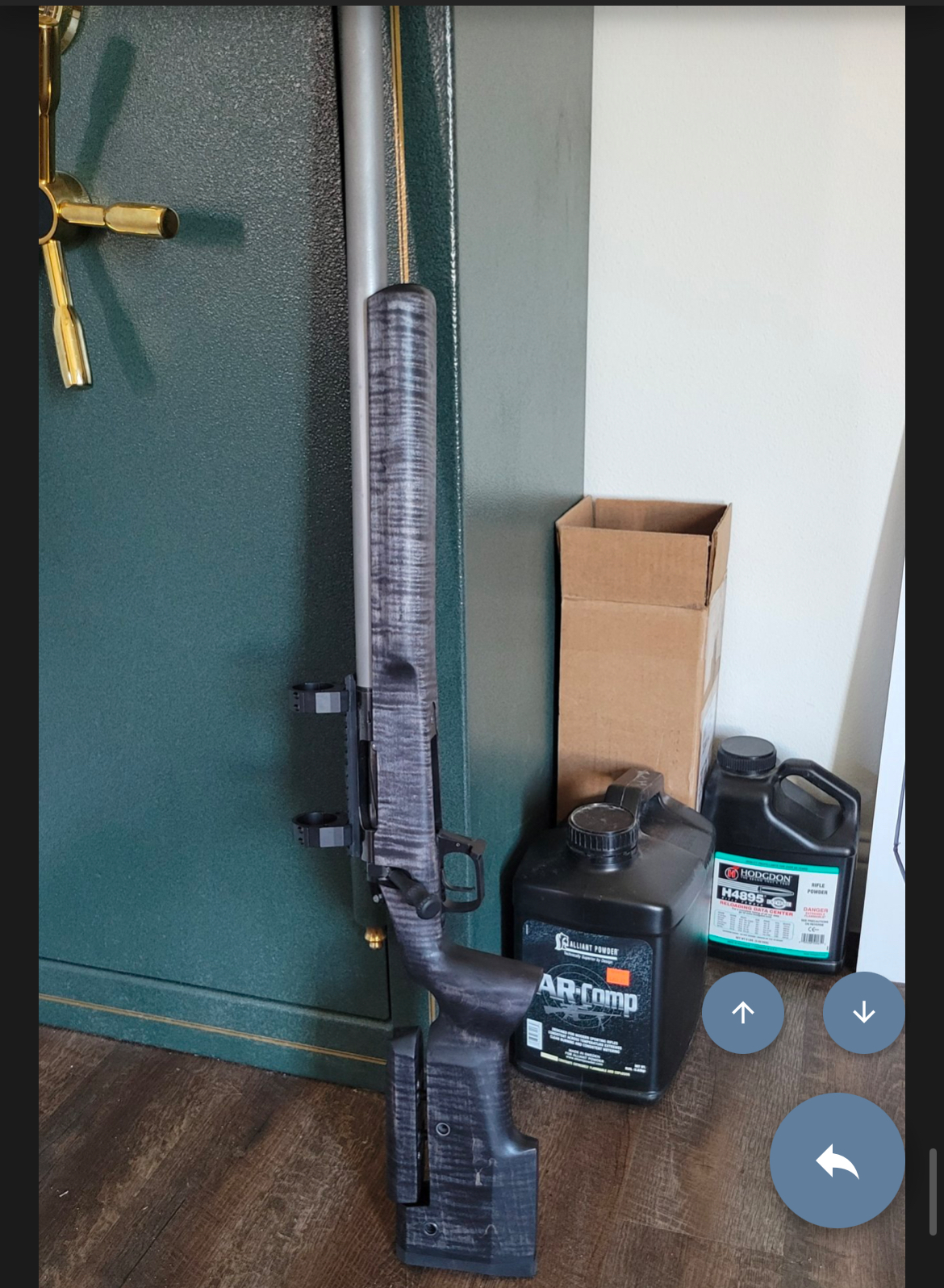

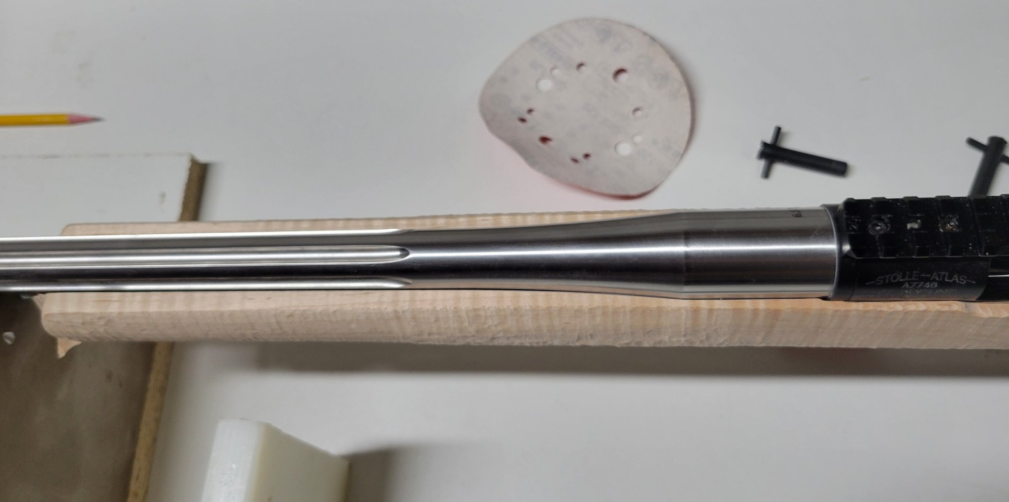

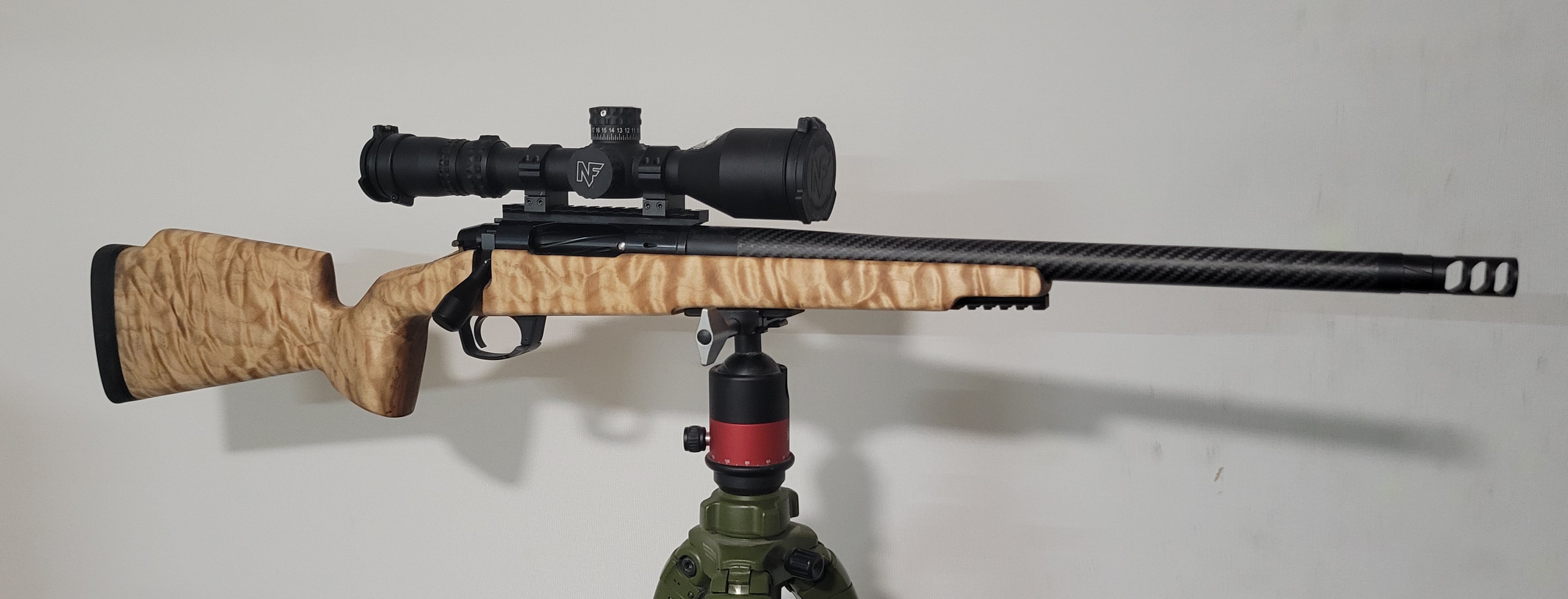

ROUND 4 - PRS/Competition Rig
Origin SA
Competition Bolt Knob
Proof Comp Contour 223, 26" threaded 5/8x24
M5 Bottom Metal
Triggertech Diamond, Flat
Curly Maple - Adjustable,
Pillar and epoxy bedded
Freebore has the 77gr SMK at 2.390 to touch, and the 80.5gr Bergers at 2.520" while keeping the bearing surface above the neck shoulder junction.
Should be great for PRS tac class with 75 ELDM or 77 SMKs, then you could run the 80.5 or 85.5 Bergers in Open division.

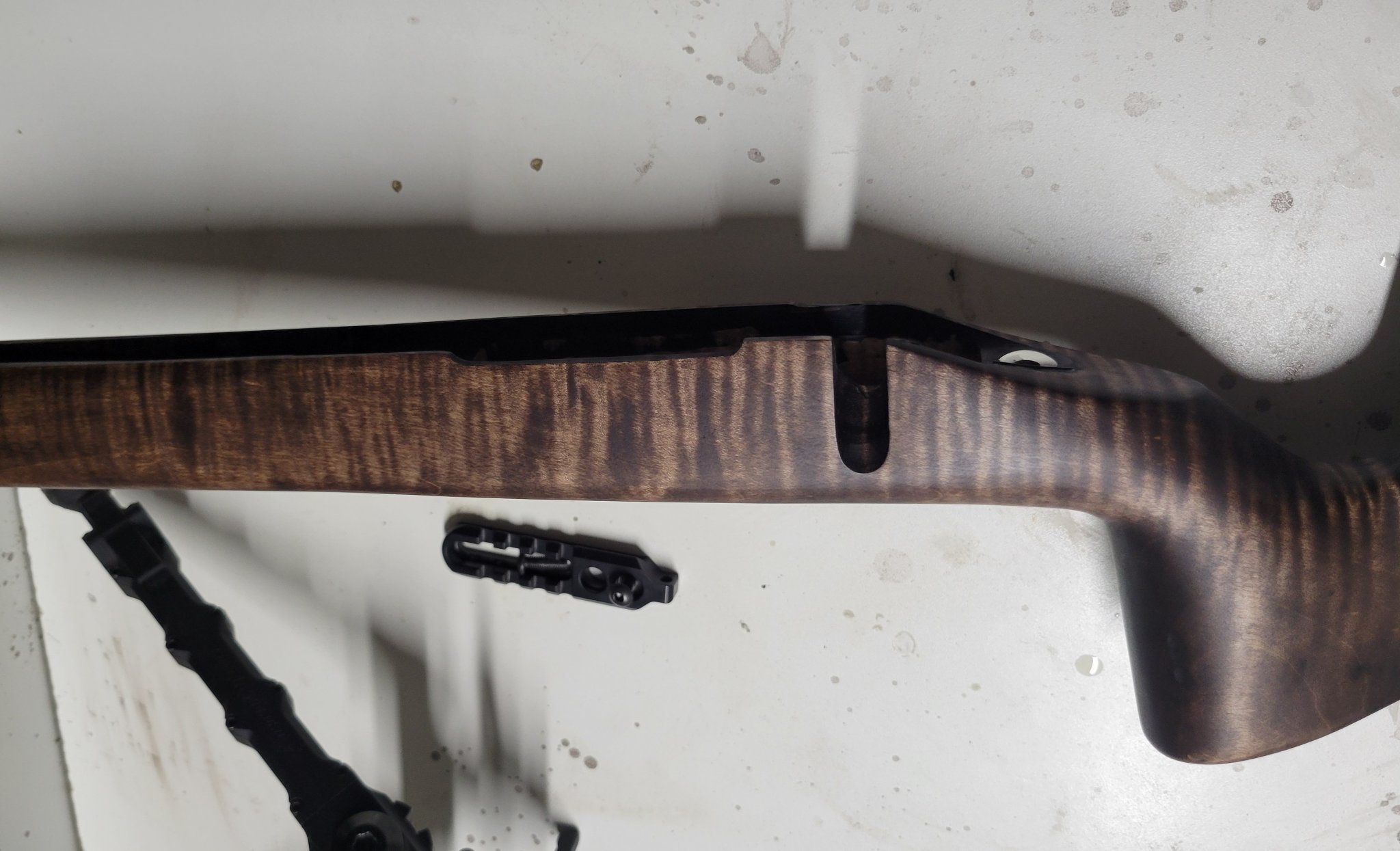

Stock is almost done, I should be able to shoot some groups Friday.
Black with subtle fade to silver to compliment the black action and stainless barrel.
