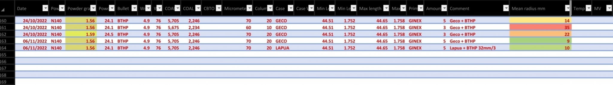

I use excel to record all loads I create.
I too standardize each load in my head (bullet, case, powder, charge, primer) but was just thinking of creating a table for different loads to make it easier to check an old load even after many years.
So I do not have to look from here:
I use the acronyms of loads (like H75.56) also in kestrel. (Manufacturer+Grains.powder decimals)

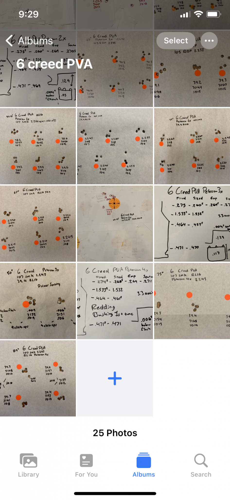

I write all the load details on the target for each charge and then take a picture of it, add the pic to an album on your phone of just that one barrels sizing information and targets. If you do it as you go you get a chronological ledger of what you did and its results followed by the next tests etc. You can see and track your progression and you always have it at your finger tips wherever you go.
