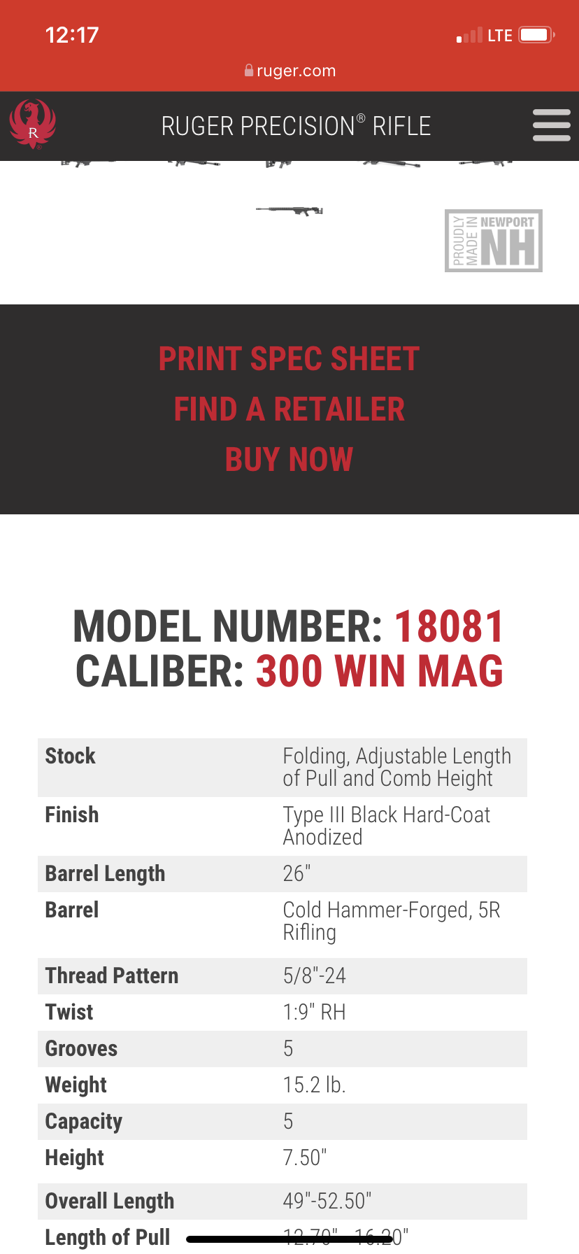

They are 5/8" - 24 TPI
RPR 300WM specs
Reactions: cheeko and Baron23
Thanks, and forgive my ignorance if I am wrong, but can you confirm what it means exactly? is that 5/8" total thread on the barrel at 24 Turns Per Inch? I ask because I am not sure how much thread there is on the barrel without taking the muzzle brake off, which I prefer not to do until I have the thread protector here.
That is a standard SAE thread (not metric). 5/8”’refers to the major diameter of the male thread. 24 is the threads per inch.
5/8x24 muzzle caps/ thread protectors are easy to get. Or any machinist could make one in steel or aluminum or brass in a matter of a half hour tops.

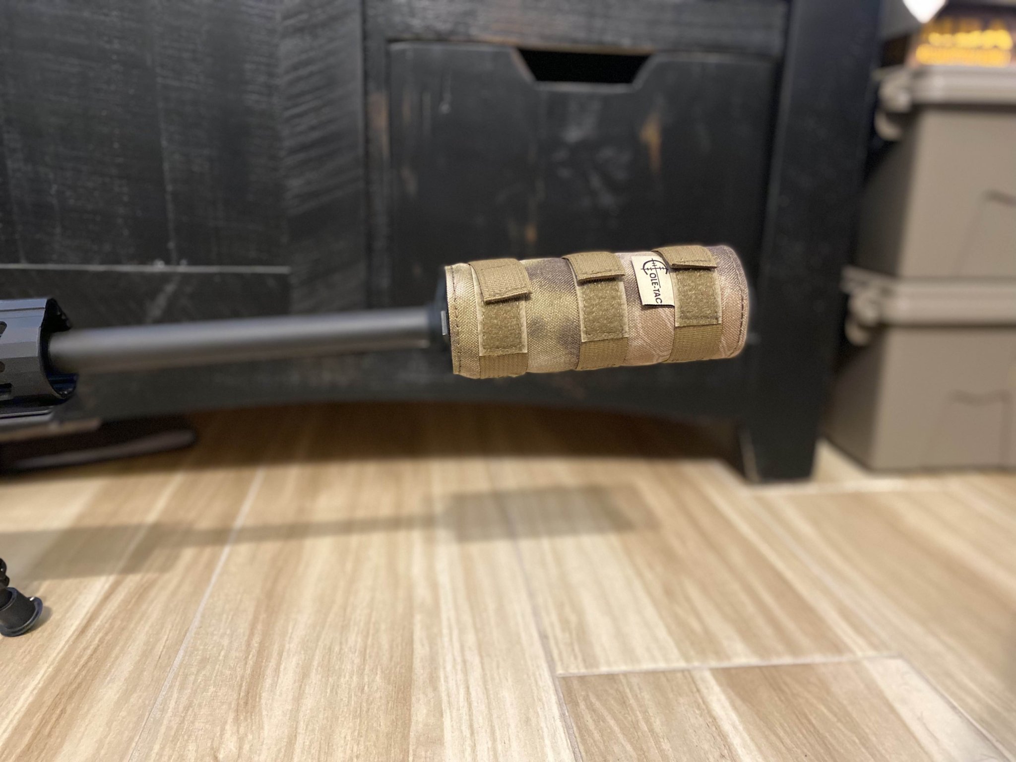

Given that you can buy a .300 win Mag-rated suppressor off the shelf in Germany for a couple of hundred bucks and not so much as a signature except on the credit card slip… And the Euro penchant for not annoying neighbors while shooting… I’d dump the brake as well.
.300 win Mag is not a caliber that needs to be braked. Except when you want to annoy the folks on the line next to you ;-)

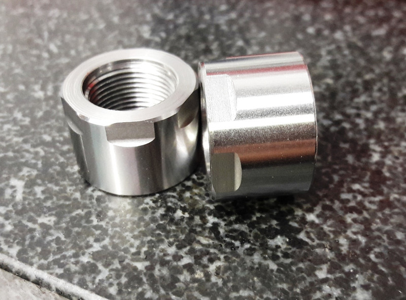

Thanks, so, yes, I assumed that's what it meant, but I don't know how much thread there is to cover. Is it a half inch? an inch? Obviously it will make a difference to the "depth" of the cap/thread protector.

I put a thread protector on my RPR. Limited shooting since then, but it seems to have improved the groups a bit...
No idea if they would ship just a thread protector over to you, or if you would even want to pay shipping. PVA makes thread protectors to cover just about all barrel diameter to protect the entire shoulder. Have a few of them my self and they are all I buy.
Edit to add. You may just be better of going to a machine shop with a simple drawing of what you want exactly if you can't find a company in your country that sells what you want. You may pay a little more though. Would get it made out of stainless, or even brass like mentioned. Not sure I would do aluminum my self, but don't see why it wouldn't work for at least the life of the barrel or longer.
Thread length from shoulder to crown, OD of the protector to match up to the OD of the barrel at the shoulder, and of course drilled and tapped at 5/8-24. Have a couple flats put on for a wrench or knurled so you can get it on and off would be a plus. I don't use a wrench on my PVA protectors, I just finger tight as I use a suppressor. Most times the threaded part is all within a certain length that most protectors cover, or are a little longer which does not hurt anything. Just measured four barrels for the length of the threads and they were all between 15mm and 15.8mm so get it made at 16mm long and you should be good for your current barrel, and any new barrel you get. If you do get a machine shop to make one, may as well get more than one in case you loose it, or need another in the future.

Heheheheh very nice. As you have an RPR, could you tell me, is it in .300wm? And if so, do you have an exact dimension for the internal diameter the thread protector has to be, as well as how much thread is on the barrel?
Mine is 6.5 creedmoor, however, Ruger’s website says the threads on the 300WM are 5/8-24. Any 5/8-24 thread protector should work, the ultimate difference between them being esthetic rather than functional.
Thanks for this, however, on investigating, the internal diameter of this thread protector is only 14.5 mm and the barrel of the RPR in 300 wm is over 20mm in diameter, so this will not work.
The barrel being over 20mm doesn’t have any play here. The thread protector won’t screw past the shoulder of the 5/8x24 threads. Which is what your barrel is threaded at

Take the brake off and suddenly you’ll see the barrel is 5/8” in diameter where it matters. Standard muzzle threads are .7-.75” long. Anybody in the gun world you buy a thread protector from will make it cover that much.

As a follow up. I have since tested and put the scope on the rifle and it is a dream. I had a purpose built 300 WM before that frankly is a really awesome gun, but the RPR is awesome out of the box. And VERY accurate. I would say it matches my 1/2 MOA rifle that was specifically built for that, though I still need to put it through its paces at long ranges.
