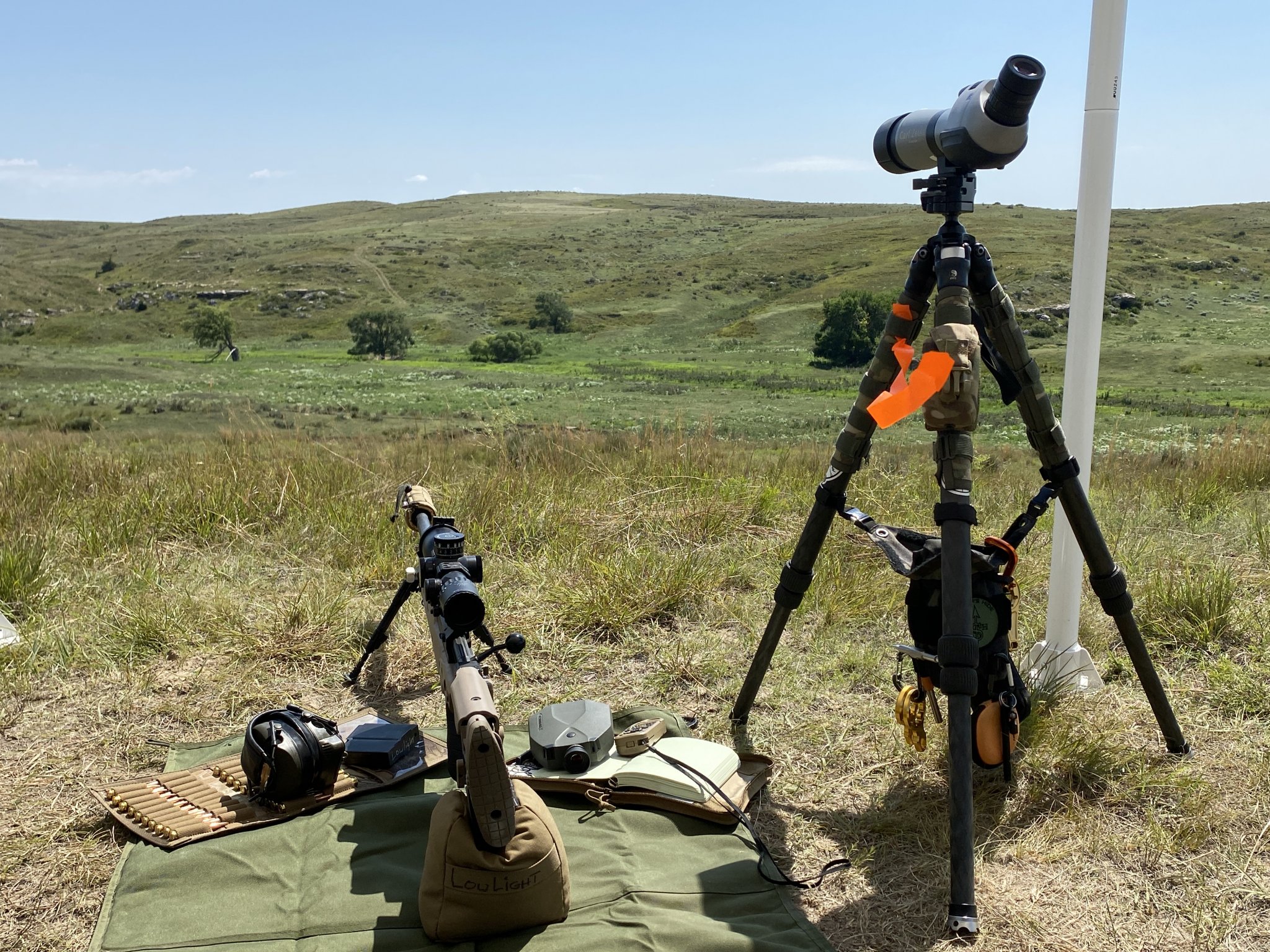

    This past weekend we had a class at JM Precision in Imperial Nebraska. We love this location not just for the local charm but the terrain we are shooting in. The conditions are tricky at times but they often teach us something about our shooting.
    With the small canyon and surrounding hills the wind will often do weird things. As an example we had a large and small plate at 1240 yards. The prevailing wind was 8MPH from the right and the call to hit the small plate was left edge. Yet you’d have no problem hitting the big plate with a right edge hold. The difference was the location of the plates and their proximity to an outcropping and ledge that would swirl the wind. Basically the wind bounces off the hills and pushes the bullet in the opposite direction, no voodoo but you have to know and see it to correct for it.
    In my presentation about wind I talk how terrain can have an impact on the bullet. Terrain is responsible for localized changes that may or may not effect the bullets path. It’s cool when it happens and we see it every class here in Nebraska. It can be shadowed, it can also get underneath and cause lift, it does a lot of crazy things when it gets going on this range. Which for everyone on the line is super fun.
    I love calling wind for students on this range. It great to see the looks the moment you give one an opposite call of the previous. Heads prairie dog up and echos of, did he just say left filter through my ear pro. The moment they hit it, all doubt falls away, he is seeing something I am not so they go with it.
    My point in this, we pay attention to every single shot on this range in regards to windage because you have too. We have Marc on the student watching process and fundamentals, and me on glass analyzing and adjusting to keep the students on steel without wasting too much ammo. This even works in elevation, hey have him come down .3, Marc will reply, No he dove in the bag, have him take another shot and interestingly the student hits center the next shot. They were .3 high at 700 for the first shot but now they are right back on target. The rear bag shifted in recoil, the rifle rocked back and the muzzle went up. Recoil management tells the bullet where the barrel is on release.

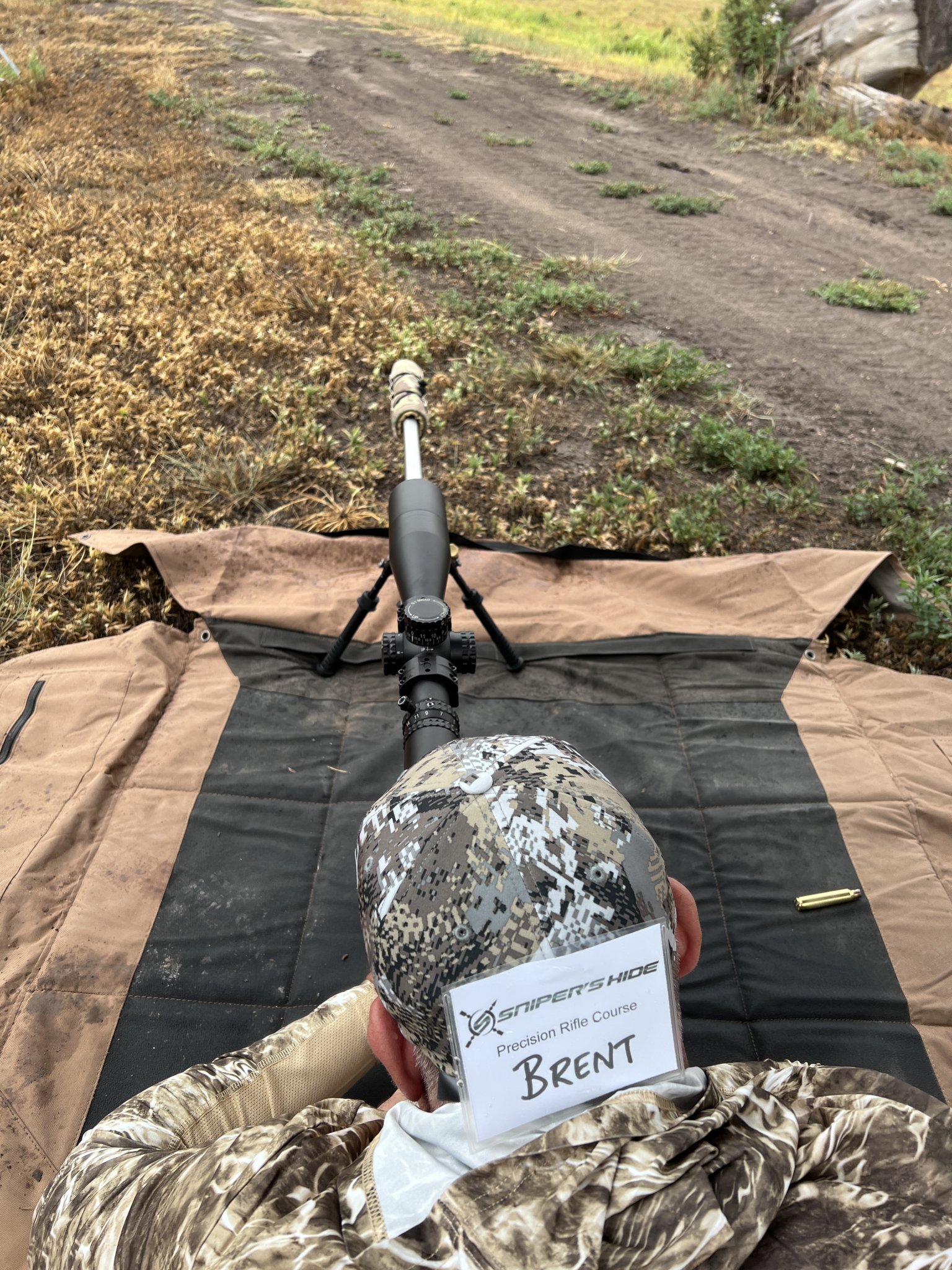

    We build shooters into marksman, because we focus on the shooter and not the noise. In the case of the lefty’s in the class the issue was they were heavy headed. Meaning they were pushing the rifle over and because they are often crooked behind the rifle they don’t’ see it. If you look at my fundamental evaluation I have a section that asks, is their head straight or rolled, as rolled heads will push a loose bipod. We fix them by loaning them a bipod like an Atlas CAL, TBAC or Elite Iron. One that will lock up tight with a pod lock. We will set the bipod slightly inboard so when they push, they push the rifle straight. Why we switch bipods for them, to demonstrate to the entire class that a bipod fixes cant in the prone, not a level. However in this case I recommended both lefty’s invest in a level as they need to learn what level looks like. I am not opposed to the idiot light mounted on the rifle, there just needs to be a reason. A level is a training tool and not a shooting aid, if you are using the level to correct your position you are not correcting the problem. Each time that level says you are wrong, that is a clue saying you have a problem in the prone.
    Many lefty’s will have a right handed rifle, one of ours did, but consider the right handed shooter with the same problem. They are not just pushing the rifle over with their head, but pulling it over with the bolt. The wrong bipod or one that is not correctly adjusted will let them. With most people being right handed, we see it a lot, hence the call it to fix it with the scope.
    Fix the shooter, don’t adjust the scope. You can mechanically fix these problems through adjustments in body position, changing adjustments on the rifle, like LOP, Scope placement, cheek piece, etc. It takes the right eye to recognize the problems, which is why the short cut is to call it a drift. Sure we will do with a problem student, dial in windage to keep them on target rather than chase them shot after shot. But in the end we don’t’ let them get away with it, we just know we’ll need time to fix them. We have a limited amount of time so the fix is not always immediate, it takes reps.
